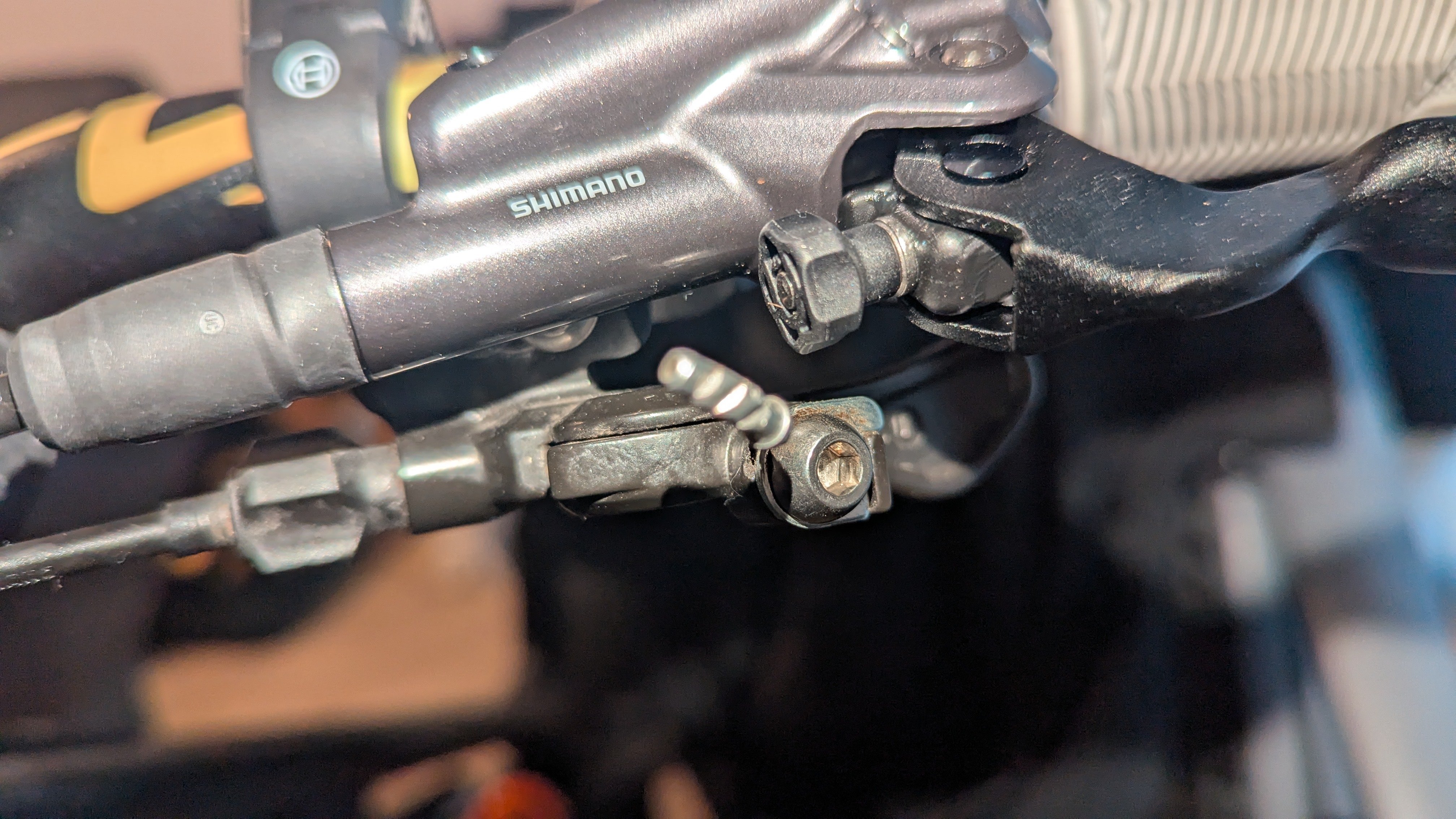

Changing the brakes on the canyon strive on to the Shimano xt 4 pots from the db8 stock brakes and face the same annoying Shimano component compatibility issues. The xt lever clamps have a much smaller slot in the clamp and just like the front brake side needing a shifter mount adapter I'm now facing the exact same issue on the Shimano lever mounted (left side) mounting to the Shimano dropper post EV bracket and for the life of me I can't find a clear answer on what part will mate the two together

Do you mean the "i-spec" clamps? They allow for two Shimano fittings to be mounted to one handle bar clamp. You have to get the correct one though, as there are several iterations. Sram do it better with their "Matchmaker" clamps. They are a design classic and must have patented it before Shimano could come up with it.

Exactly that Steve I think I have found the right one but waiting on a email to confirm

Unless I'm misunderstanding something you shouldn't need an adaptor.
The brake levers and dropper lever are both I-spec EV.
The dropper lever bolts onto the brake lever with a 3mm hex screw.
It's the same setup that I have albeit my levers are M6100.
Unless you're missing the threaded square insert thingy from the brake lever clamp, it should just bolt together.

The square adapter bit is exactly what I was missing 😁 all sorted now but tbh it should come with the Shimano brake kit
