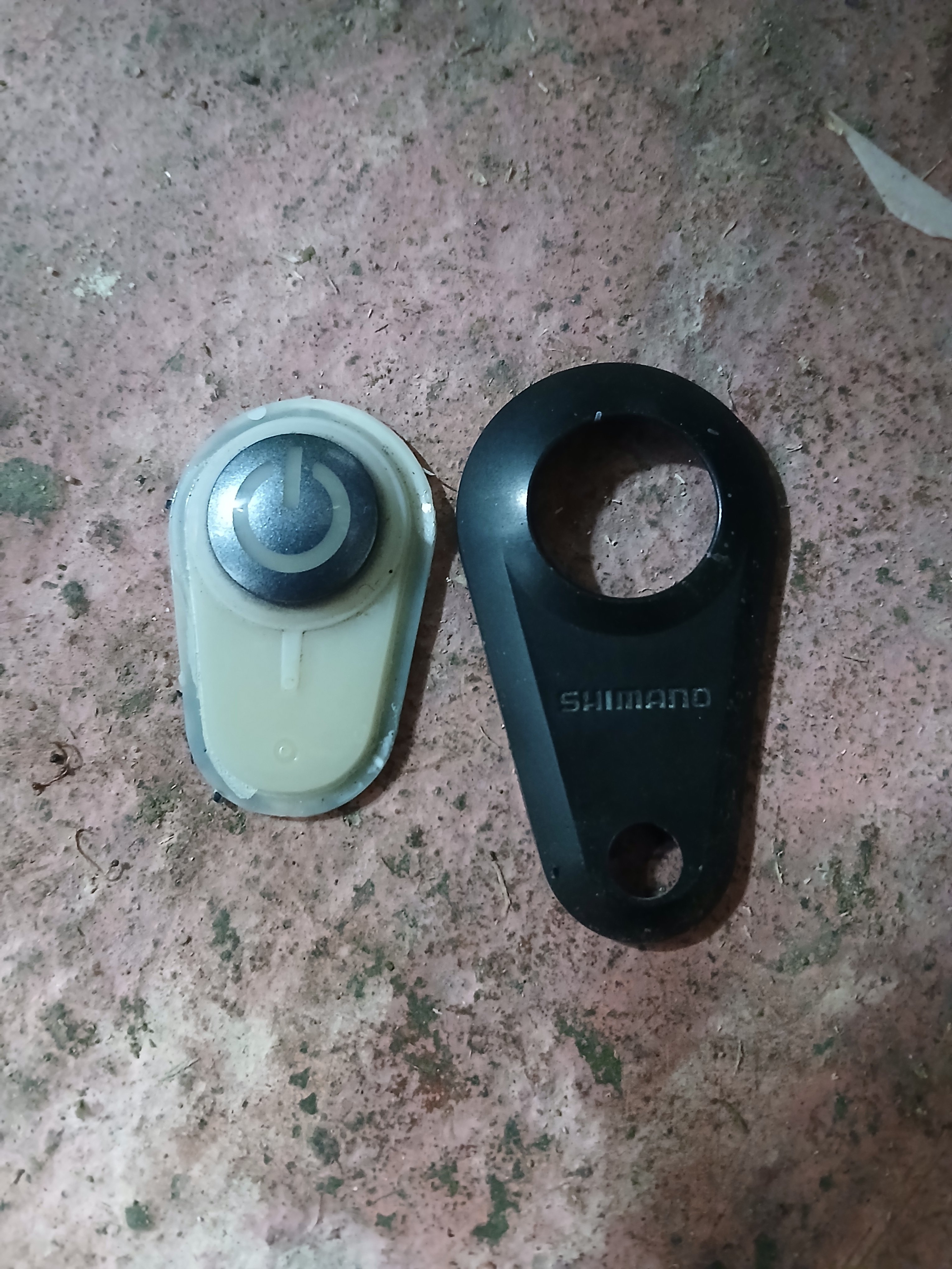

Hi guys, as you are the first result on google for "satelitte switch E7000"

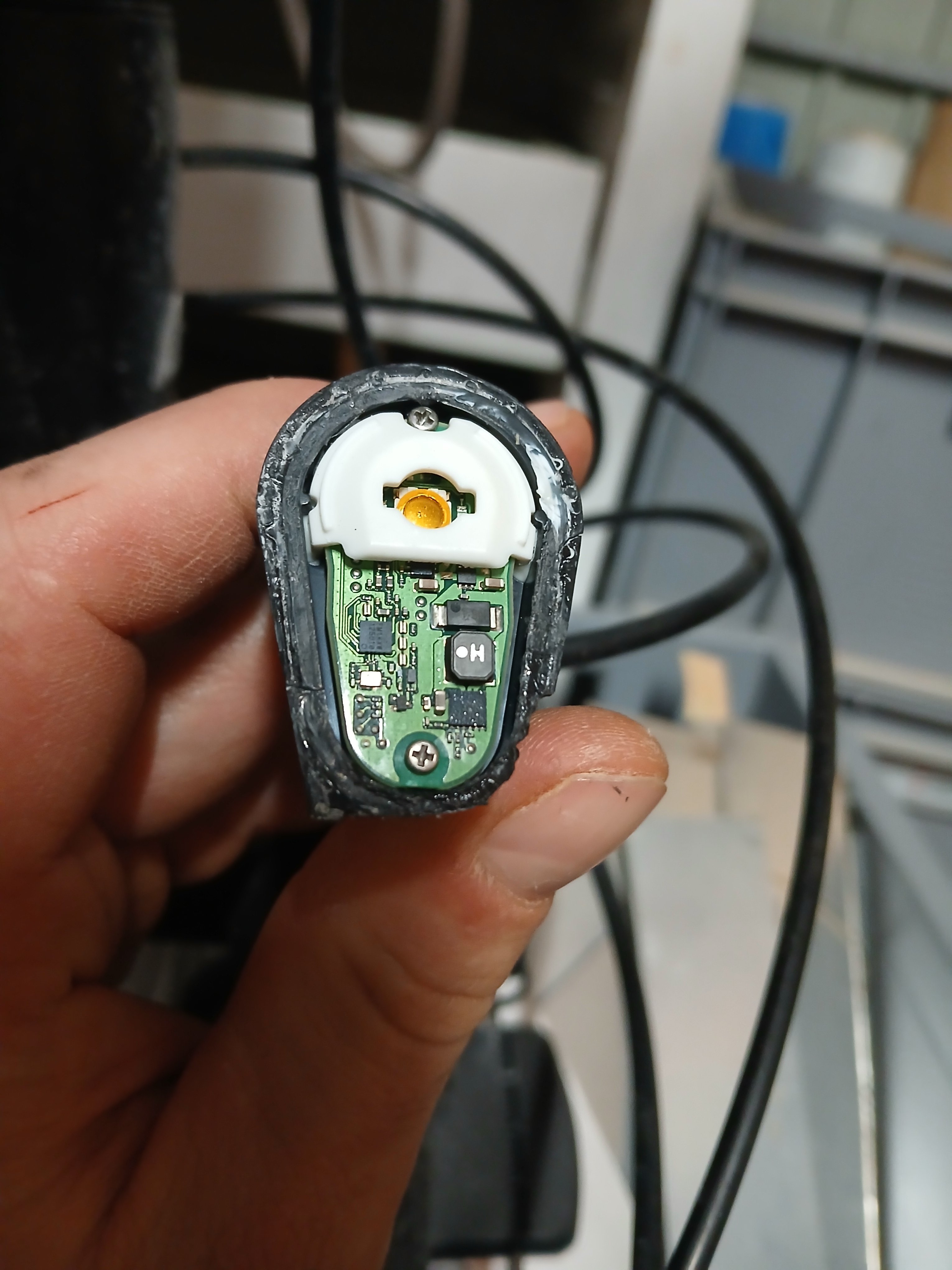

So I share with you my repair of this problem, it pretty simple just change the cell, replace with a not crapy one, good brand more than 1000mAh.
the button you see open here is the EW-SW100 from shimano, for E7000 but I guess it's the same in the EW-SW310 for e8000 motor.

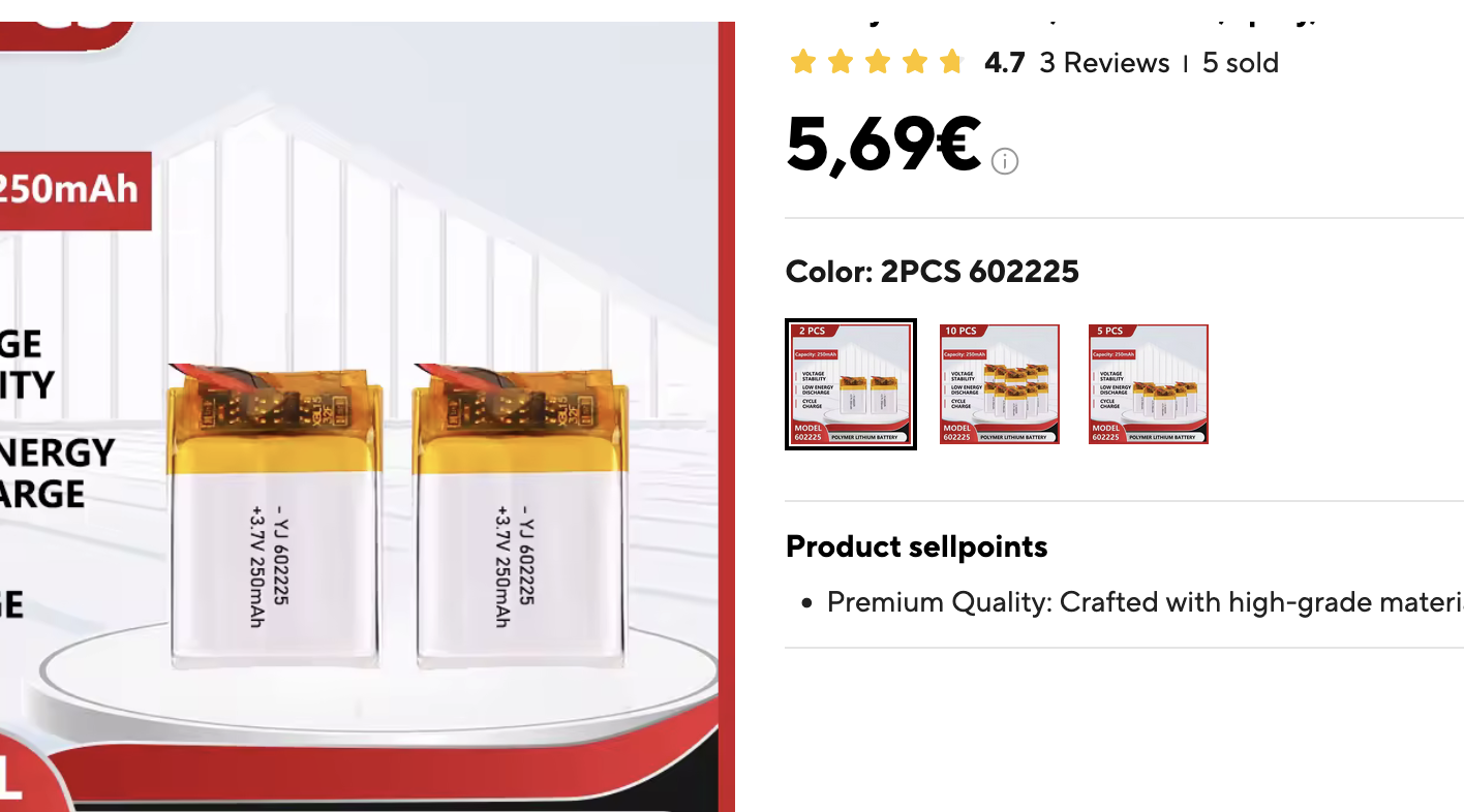

Seems to be the same problem on the E7000 and E8000 satelite switch, a 80 euros switch with a lot of cable to replace. It's more simple to just change the battery. Way less expensive as a cell can be found for under 5€.
This is the kind of battery found inside sold for 5 euros 2PCS on Ali. :
Use a small cutter knife to open the button. And solder new battery in place. Hot air can be usefull to disloge the old battery.

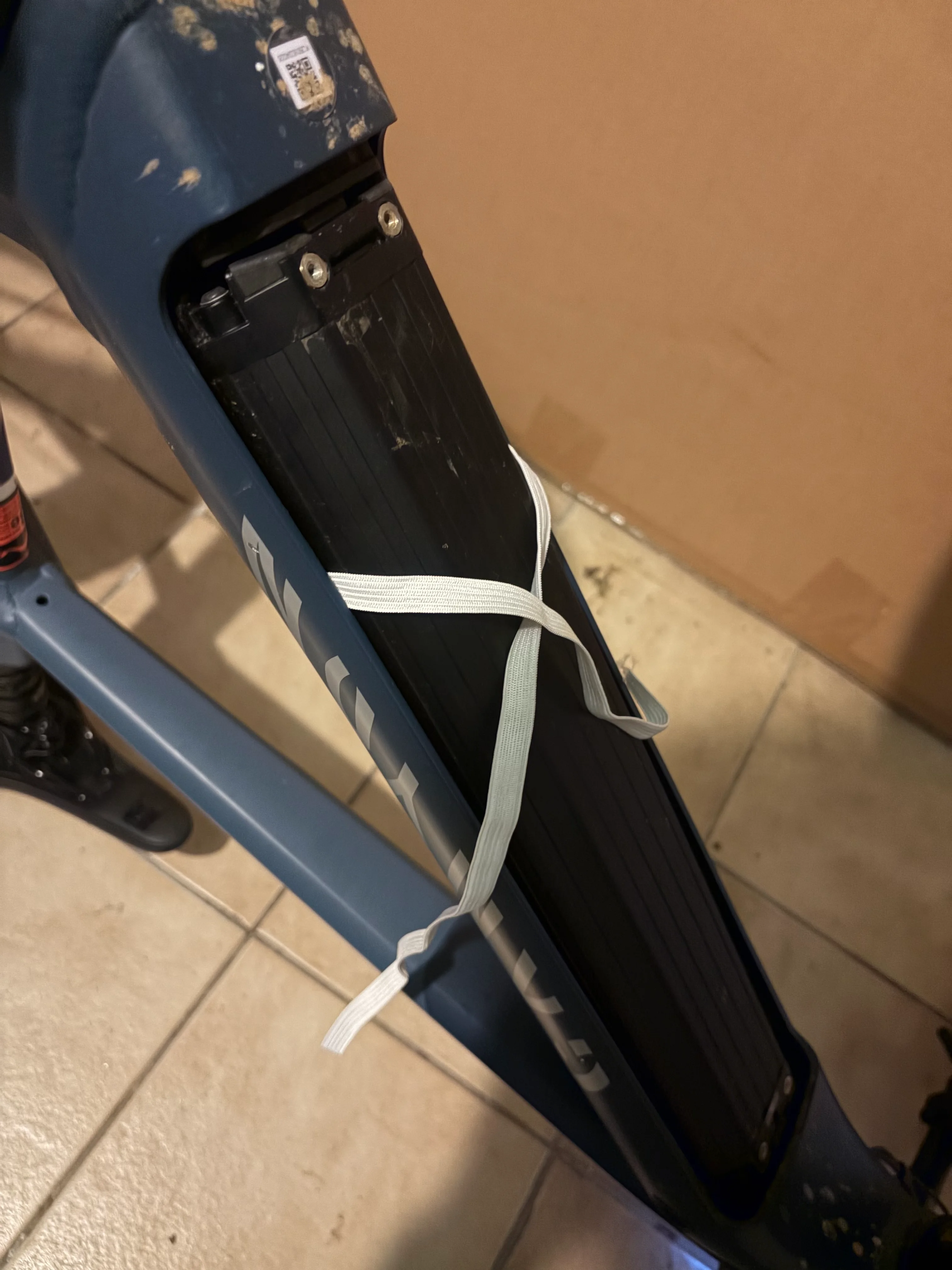

Same issue here on a Grand Canyon:ON 9 — the frame hole isn’t even aligned with the battery button (seriously Canyon…).
Quick dirty fix if you’re stuck:
Taped a small metal washer onto the battery button, wrapped an elastic band around the battery, pushed it in, then gave it a sharp pull — bike powered on instantly.
Definitely not a long-term fix, but good enough to get a ride in while waiting for a new switch.
