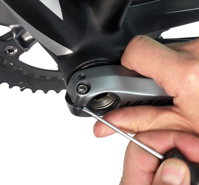

I cannot get the drive side crank arm off of my Rise M10, it moves 2-3mm, but will not come off, all videos I have seen show it just comes off after removing the crank bolt and the two retainer bolts...
Very strange won’t come off, they are basically Shimano cranks from Acoustic bike. Check bolts loosened & tab removed then may need tapping on back of crank arm with rubber mallet
Are they Shimano cranks? There's a retaining clip to prevent them from falling off if loose. You have to move it out of the way:

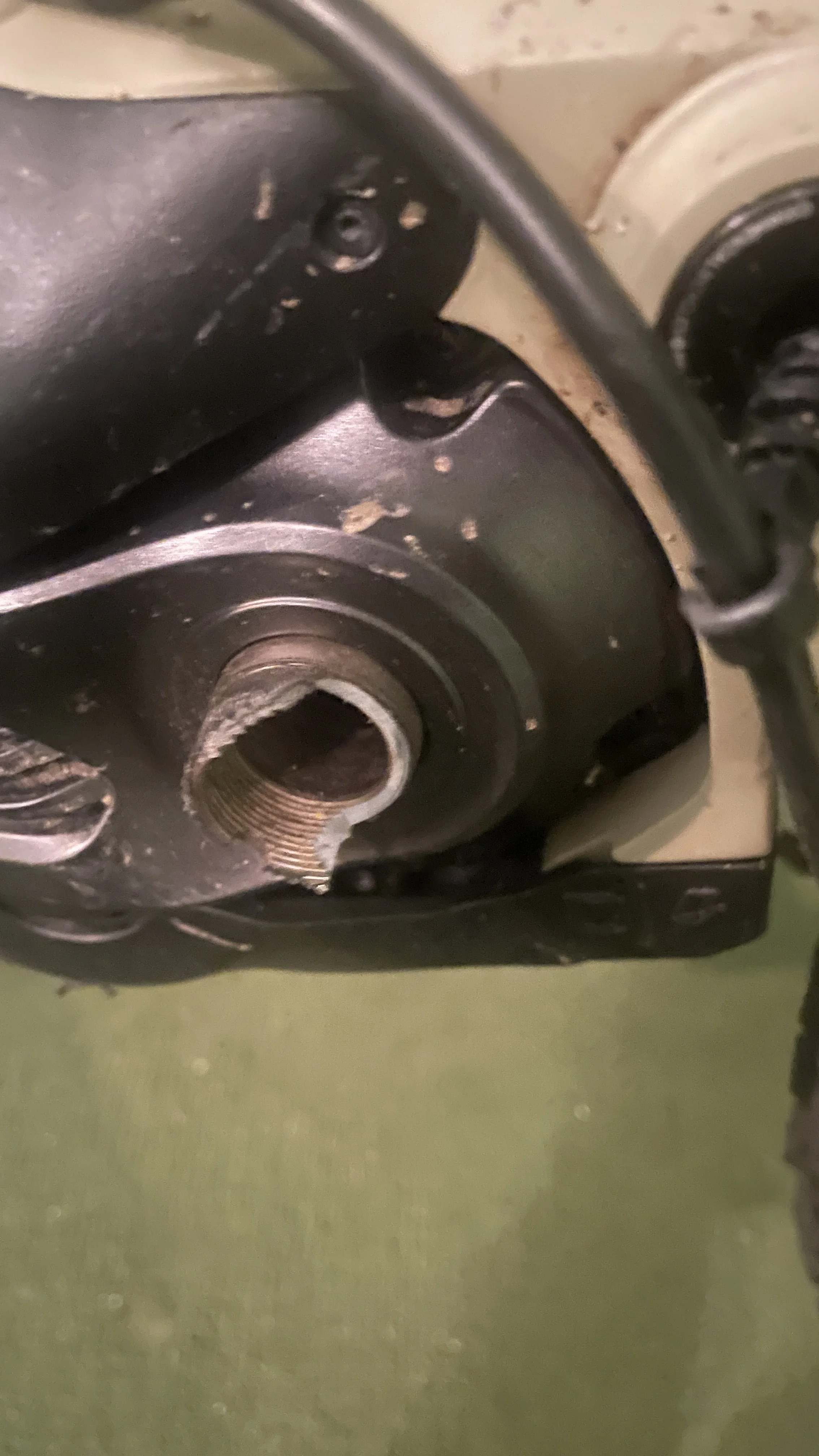

hi guys... new to the broken EP8 axle here...
Suddenly it feels so wicked that Shimano does not allow nor sell replacement axles, doesn´t it?
Commencal is offering a 20% discounted new unit, good support but repairability index of e-bikes is so so bad
