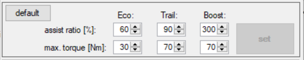

I don't know exactly where I got it... but everywhere from the net, I guess. Isn't it like public domain info:
Mode: Assist ratio-% / Max torque
Eco: 60% / 30 Nm
Trail: 90 % / 70 Nm
Boost: 300% / 70 Nm
The difference between Trail and Boost is in the Assist ratio, which is the percentage how much the motor assists on top of your own input. Both give the maximum torque of 70 Nm and after that there's no difference, motor is giving all it has to give, no more.
In Boost you just need less input from your legs, but if you're fit and strong, it's not a big deal, you'll reach the max assist anyway in Trail, too.

Thanks for explaining. I hadn't realised that's how it worked. And yes I often topout the assistance bar in Trail.
Makes more sense now that boost doesn't always drain my battery hugely faster than trail does. (I also run trail in MID tho)
