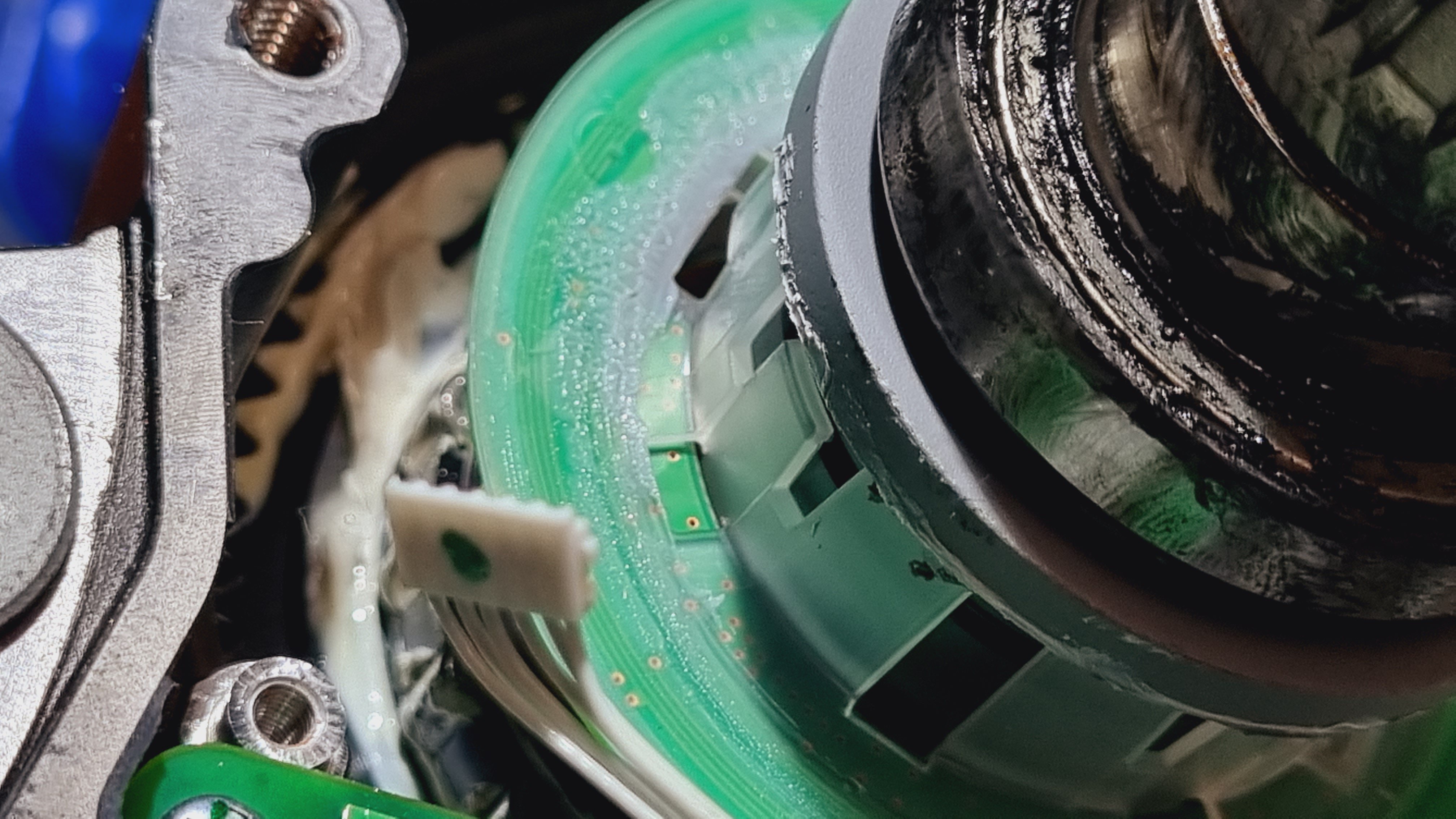

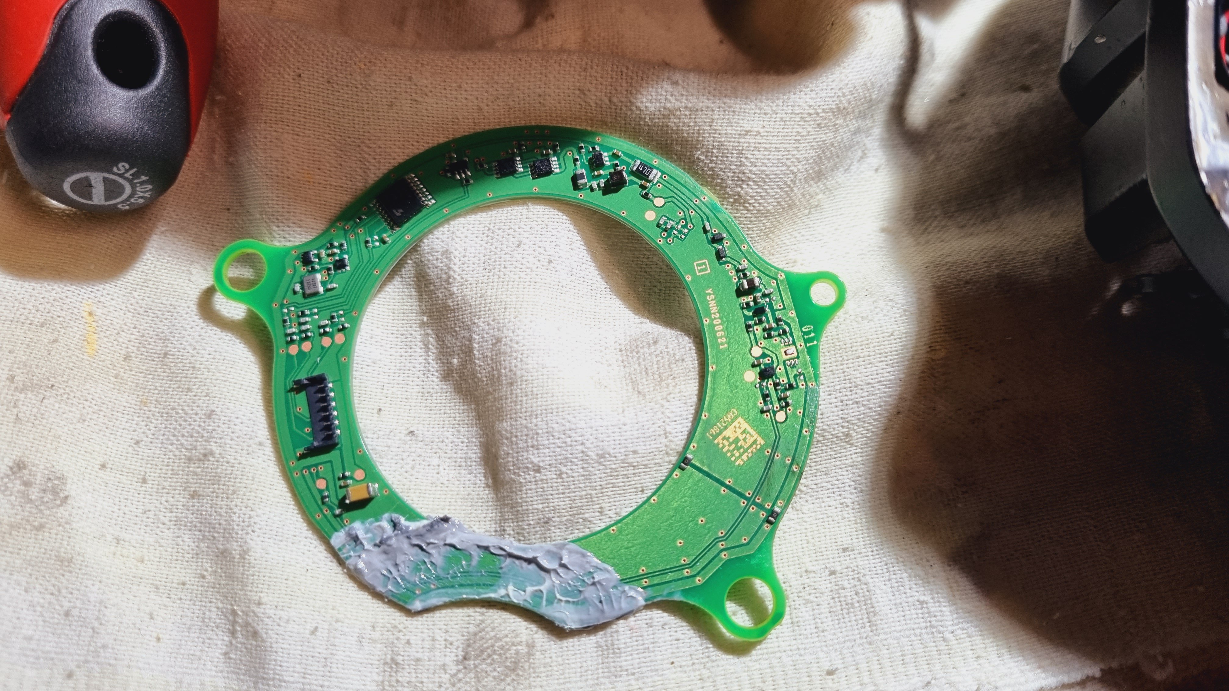

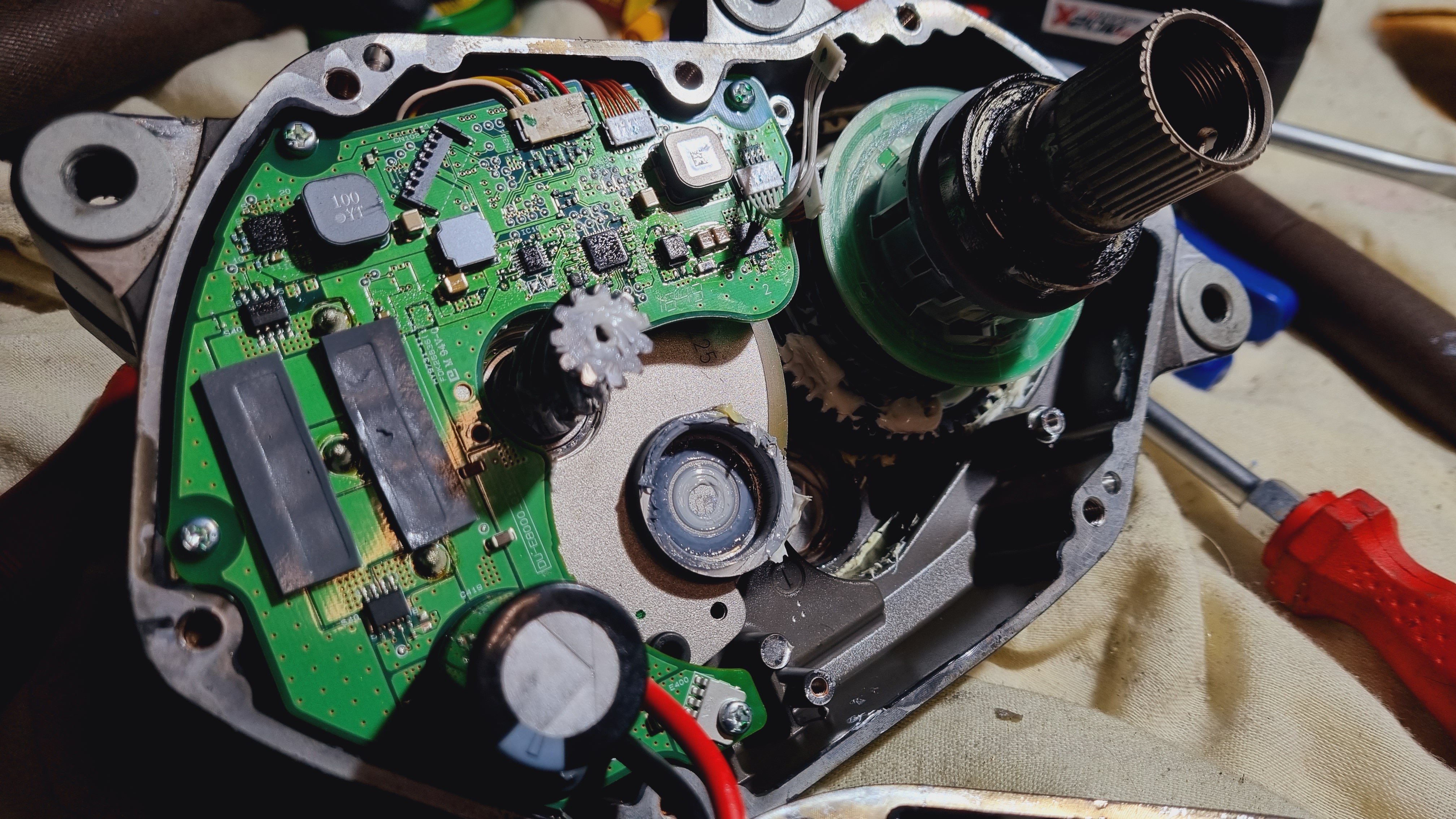

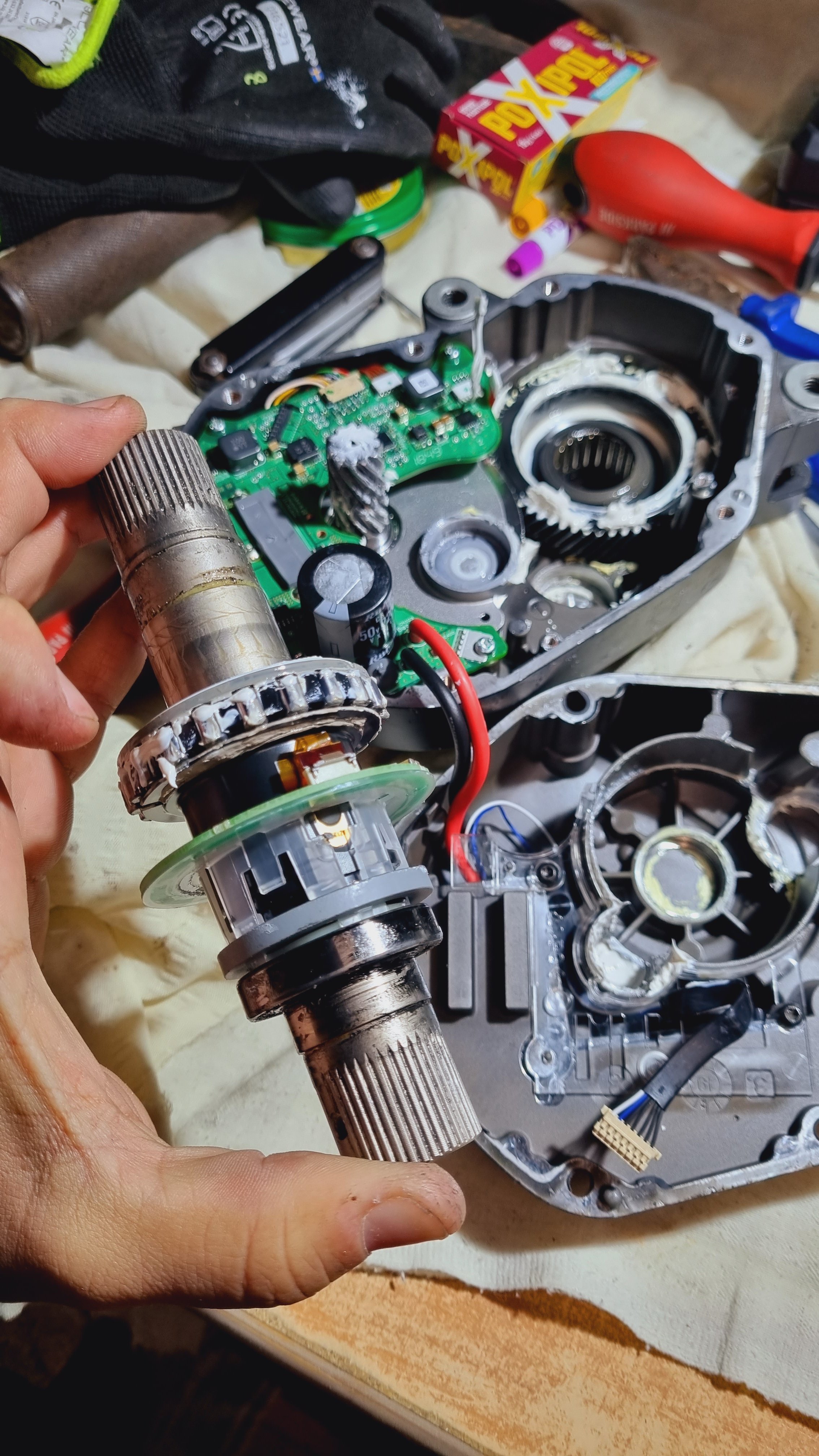

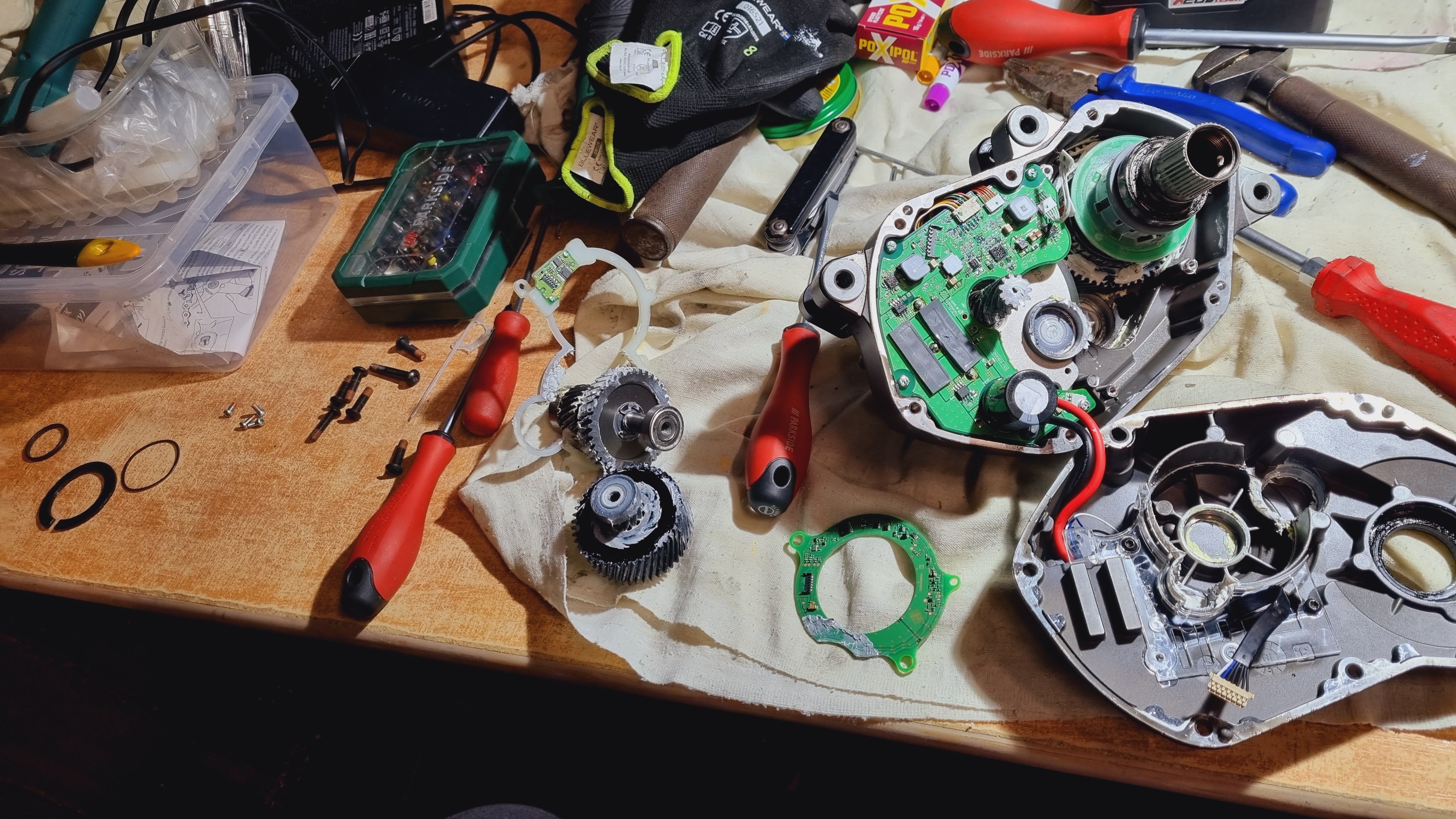

And how about Your e10 error :)? Today i was change tooth from 36to 32, and 36 one more time, and error was gone! :) Error was born when i setup Tooth to 32. Strange, and easy to repair... Second thing is clearing place between two flat rings at axle.. it was a lot of grease. Maybe this is the problem

Currently opening my motor also because of E010 -> W013 issue. What did you do here, did it help with the problem?
