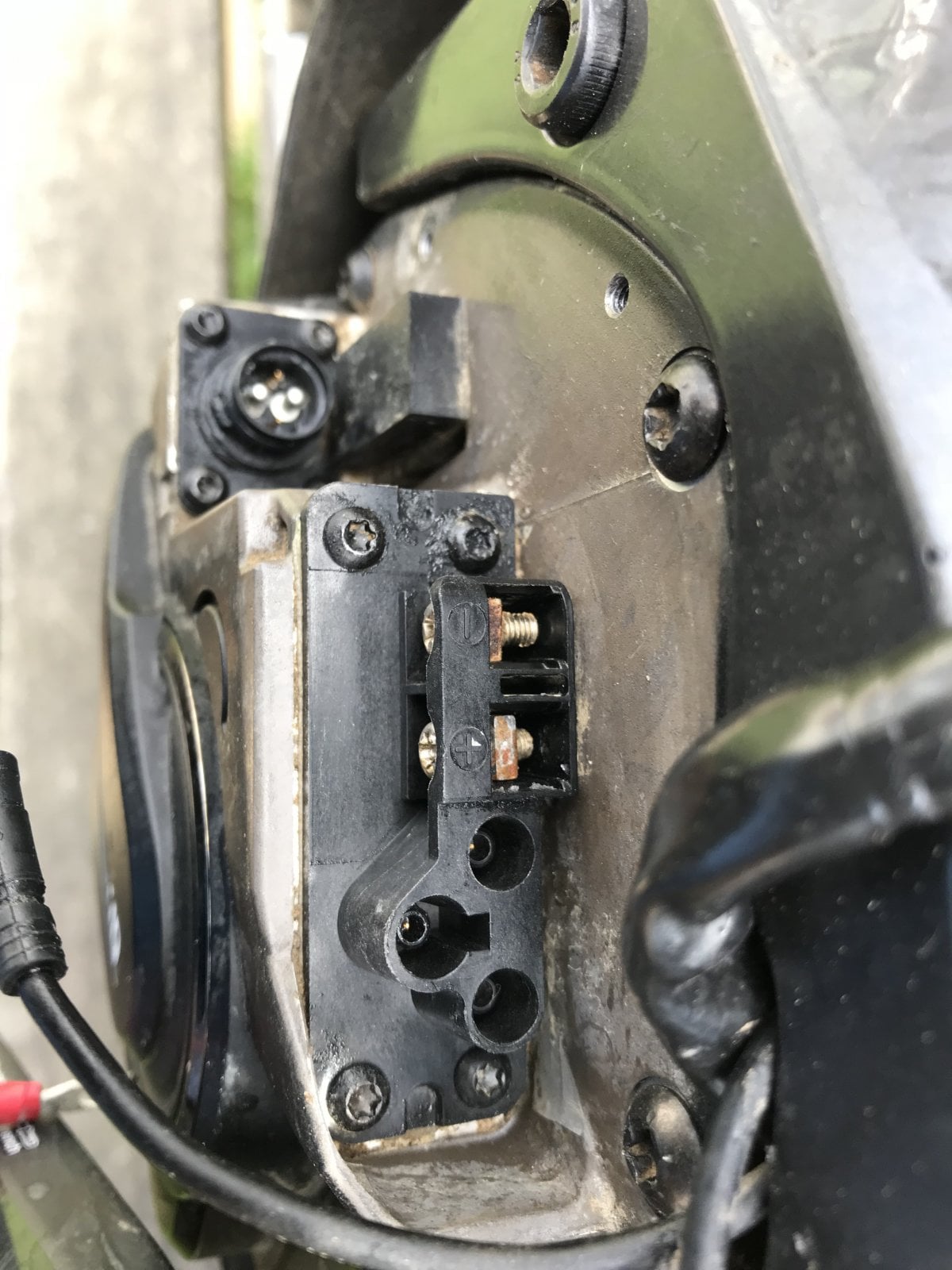

Hi guys
Does anyone have a fix for the very poor seal on the non driveside motor cover? Every ride in mud and the cover needs removing and cleaning as the electrical connections are full of mud and water
Thanks

lots of us have put silicone sealant round the top.

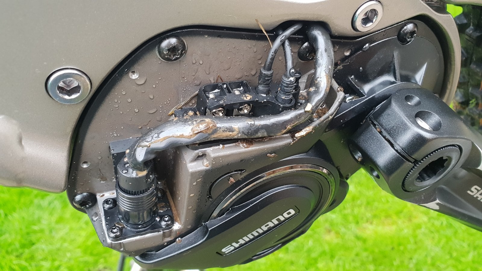

Tape works for me across the top ,stood a lot of it but muck still get in there from behind the motor and the underside of the cover I’ve now siliconed Sealed the 3 conectors on top of the motor after having a few problems with dirt and dust getting in ,. I think all the little round push in connectors on the system need to considered service items and pulled out cleaned and greased etc regularly . I recently had to clean the same conectors in the display , it’s amazing how much muck gets thrown up at them but I never thought to do much with them before

The speed sensor with the slot is the main problem , especially when it’s been replaced by the conector on the ‘device ‘
I think these little sensor connections take such tiny voltages that a little bit of muck brings up a fault code . The codes are never consistant , I used just clean them and it’s all good to go again but now I’ve siliconed around them as I popped them together .
The main conector at the front is no problem that seems to seal really well so I just grease that one
