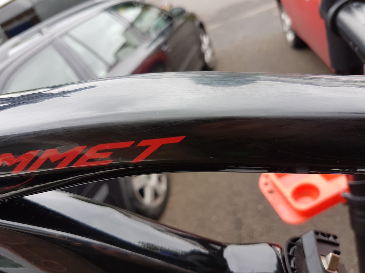

So I'm a couple of weeks into E-sommet VR ownership, and I'm enjoying how the bike rides.
I was pretty shocked to see how bad the paintwork is on the frame though - especially the crossbar.

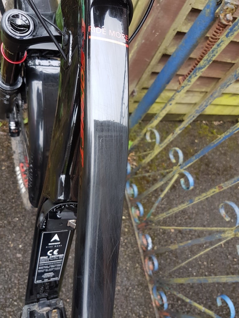

I'm not aggressive when it comes to cleaning. I use muc-off & a soft brush on the heavily soiled bits. But the frame paint doesn't appear to have any sort of lacquer layer, and after a second wash it looks like it's aged several years. It's crazed, hazy, and looks like someone has attacked it with sandpaper.
Is this a common thing? I'm going to speak to CRC about it.

Yep thats normal even using the softest brush or microfibre cloth, you can rub some crud off with your finger and leave micro scratches behind which clouds the black badly and makes it look a little crap. I invisiframed mine first week I had it and that acts like a tough clear coat that that paint job is missing. Failing that get a can of clear coat and laquer that bad boy up yourself

The car detailers I know would ask if you’d used the two bucket method or not.
You can polish that out actually but then I’d be protecting with something like Shack Wrap (doing my new Orange Surge next week - Shack Wrap – Protect Your Ride) or Invisiframe.

Just ordinary car polish like Autoglym SRP will restore and to an extent protect. You can then Shack Wrap/Invisiframe. Then you can wash your 4K bike with a muddy yard brush.
