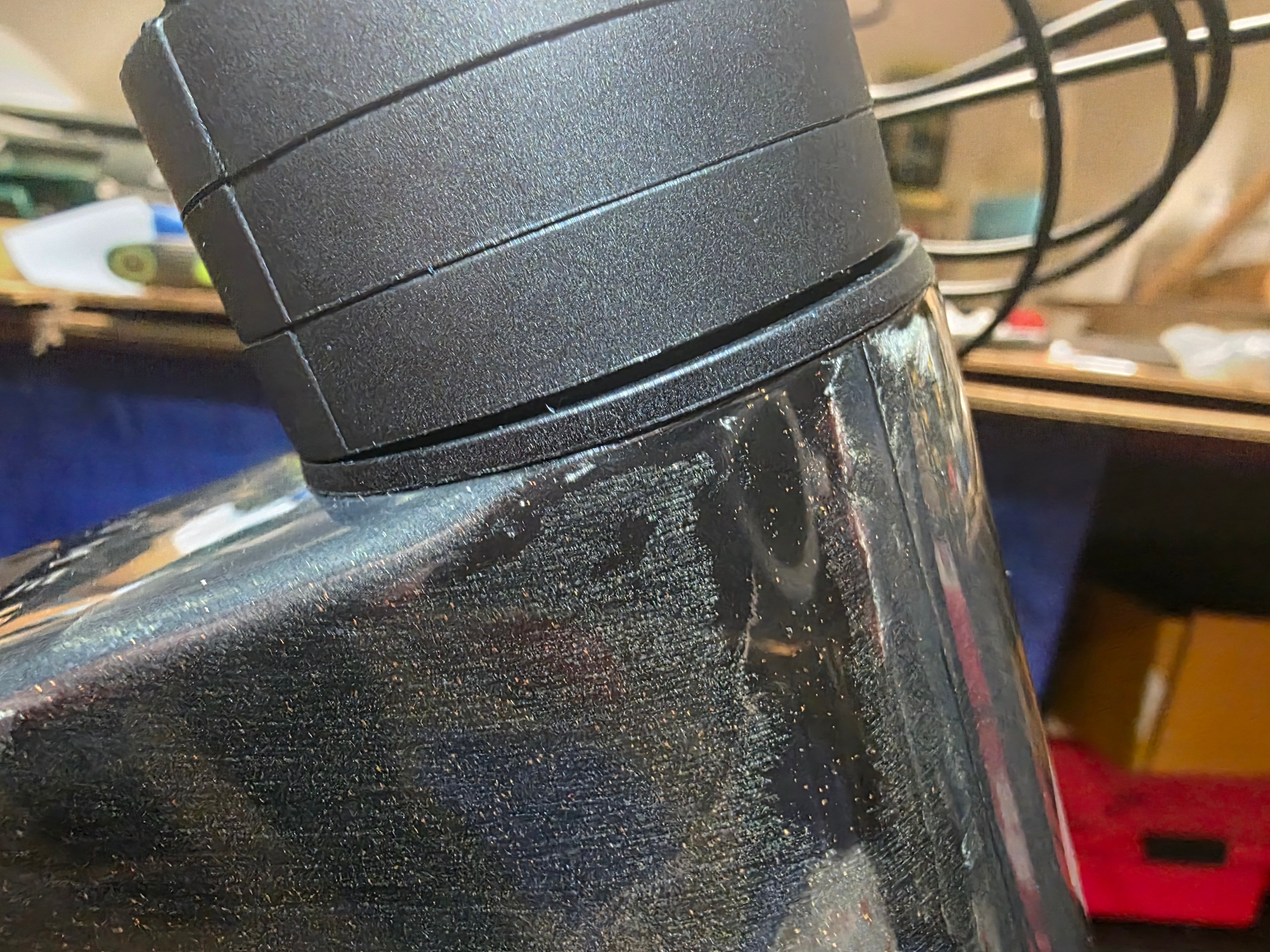

Gap at integrated headset between spacers and cups.
I needed to re-organize cable after replacing dropper. and once I have re-assembled headset there is about 1- 1.5 mm gap between lowest spacer and upper headset cup.
The integrated headset on the top consists of: cup, bearing, race, shim and then plastic race with carve out sections for cables. Here is the gap between plastic race and lowest spacer.
The issue is the plastic race with cable cutouts will not install low enough into bearing race/ shim and protrudes about 1 -1 5. mm above the bearing surface.
And when plastic spacer installed there is this gap.
Interestingly it seems to be primarily at 12 o'clock and at 6 o'clock there is almost no gap.
I had it apart 3x and always end up with gap. Anyone had similar experience?
Any advice what might be wrong; I am just not sure if the gap was there originally.. Thanks

So I actually took some pics of bike when brand new and I do see clearly the exact gap there as well. So that is pretty bad, as the gap for sure will introduce moisture and debris into headset and shorten life.. quite disappointing that Scott has not captured this. May try to flip the cup (change the fork to steeper position) and see if this goes away...
possibly remedy: attach (glue) small strip of fabric/tape/some kind of curtain to the outside of the lowest spacer to overlap the cup base to cover the gap...
Anyone dealt with this ??
