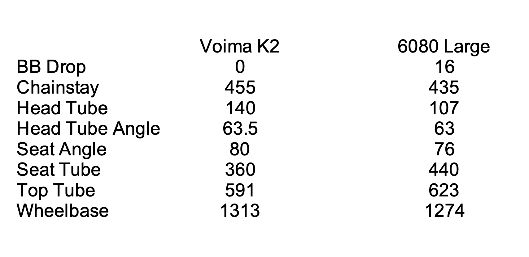

Started this thread as very little online about the Scor 6080......Just ordered a GX to fill in for the Voima that has cracked. (even though BMC in Switzerland were not helpful at all re buying a frame)
Should be here next week and I will Update once I get a few rides in. Two Questions I would like answered..........
I will put the CX race from the Voima into the SCOR and "save" the new motor until I know what is happening over in Finland......Can I get the local Bosch dealer to change the wheel circumference from 29" to 27.5" or would it be a whole new "remap" on the motor overwriting the Pole settings.?
What is the seat post Diameter as I have a reverb post I want to use and if it is 34.9 I need to order the spacer now! I have looked everywhere and cannot find the answer.

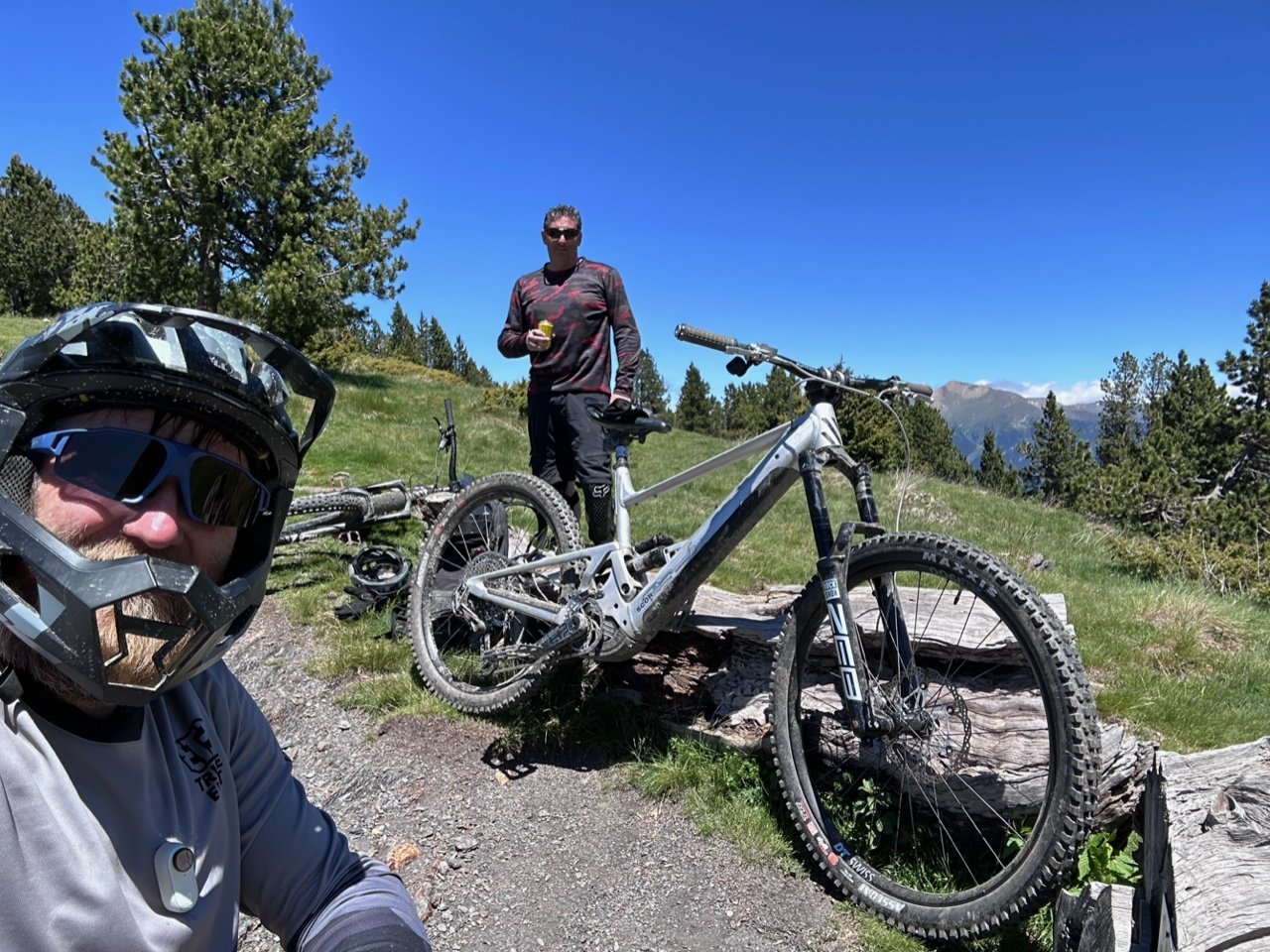

So on Friday the Scor Arrived, Worked late to "make it mine"
Day 1 was up the lifts in Vallnord as the Motor Sensor was set to Hub Magnet and the motor would not assist. First impression of the bike compared to the voima is like a Soviet era Fighter Plane....compared to a Modern one. Over built, the finish is sanded Alu with a clear coat.....(looks great I think). There were a few things badly done from Factory....for example the Battery mount bolts in the down tube were loose with no thread lock....
Going down was fine very plush, I took it it easy as the suspension was well out and did not feel right. Due the motor not working there was no climbing.
Day 2
Put some tokens in the fork. reduced the pressure.....and spent a bit of time setting up properly. Magnetic sensor glued to swingarm (no mount but a perfect space in the drop out for a big blob of epoxy)
The real test......bike climbs better than expected......no way as planted as the Pole, and with 165mm cranks had more strikes in a day than I had with the Voima in a year!!!! I thought the bike would want to wheelie on the steeps with the short rear stay but it is no where near as bad as when I had the Trek Rail I was pleasantly surprised at its ability.
Downhill I found the bike to play nice....very plush and sure footed.....not quite as playful as the Voima......just a big Bruiser that will far out perform my abilities.
All in all I am happy BUT would I prefer my Voima back.? You Bet ya the Voima is special....... and the way it climbs here in Andorra where it is steep and technical make the Voima win hands down in the climbing department.
Down hill in park not too much between them.
Today I will do some "Techincal downhill off Piste" and report back

I managed about two or three more large rides on the Scor and I am happy with the bike its managed all my climb nemesis tests where I would be the limiting factor.....going down hill in the park is fun as you would expect and it is very capable and confidence inspiring. The weight is getting Noticeable I had a Trek Rail 9.9 that I could lift above my head....then I had the Voima that I thought was heavy......and this is just a bruiser I can barely lift it onto the maintenance stand!!!!! on the super steep walk sections I am so glad it is a Bosch motor with its easy to use walk mode as pushing this up a hill even for a short distance would be killer. My Last two bikes were 29/29 so that is what I am used to. I definately feel closer to the rocks on the pedals.......lots of Pedal strikes on the climbing where the Voima would just cruise past without a care. Downhill the bike is awesome.....very stable composed and just mops up the bumps and rocks as you would expect at this level. Maybe a bit easier than the voima on hard switchbacks and slow techie downhill single track.
If I had never owned the Pole I would have been delighted.......but I will admit that I am hoping Pole Rise again send me some new swing arms. It really was the best bike for me and what I do.
I am finding it hard to put to words my feelings about the SCOR compared to the Voima.....Basically the Scor is a meathead Heavy weight thug and the voima is the same that has done MMA Training with shiny pants on.
Oh Forgot to mention......I have a 170mm Reverb post and yes I wish it would go in another inch/2.5cm in the photo its in as far as it will go!!!!
Hi All, Been a while since I was on the forum......I have fixed my Voima so will be selling the SCOR 6080 shortly as cannot justify 3 top end ebikes.
All the components have Zero Km the only part used is the frame for about 300km. I will return it to Factory Spec as it came from the shop. looking for €5000.......Can bring to the UK on my next visit home.
Loved the bike was great dowhill.....plush.....and a good climber......nice to have something different as well.
Here is the info

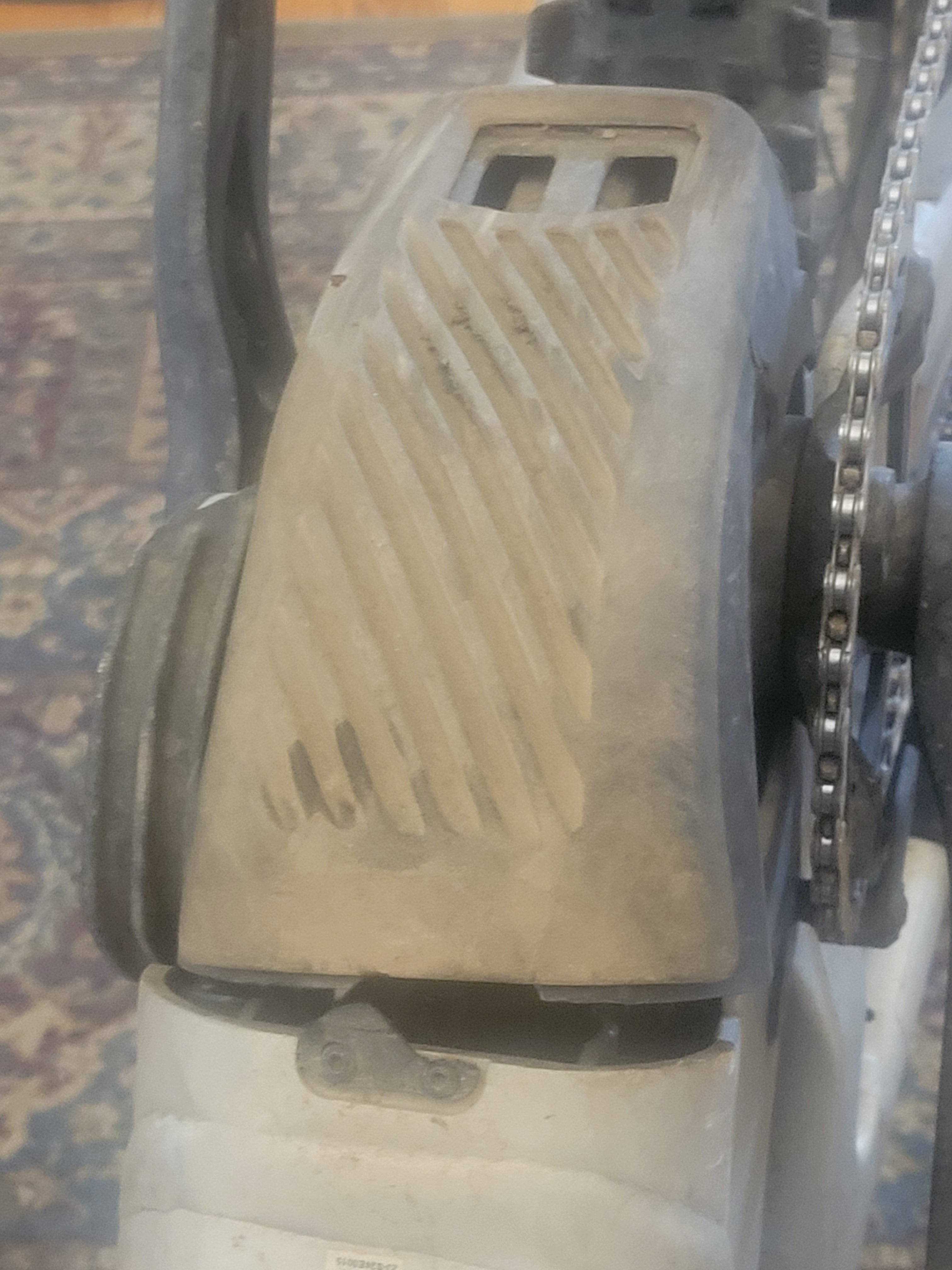

Seatpost is 31.6 according to website. Does anyone know how to get a new cover/protector for bottom of motor? Broke very easily from minimal contact.
This happened to me. I order a new one, but they've been backordered for months now.
I was able to glue it back together using Loctite Plastics bonding system. It's held up for at least 4 months now.
