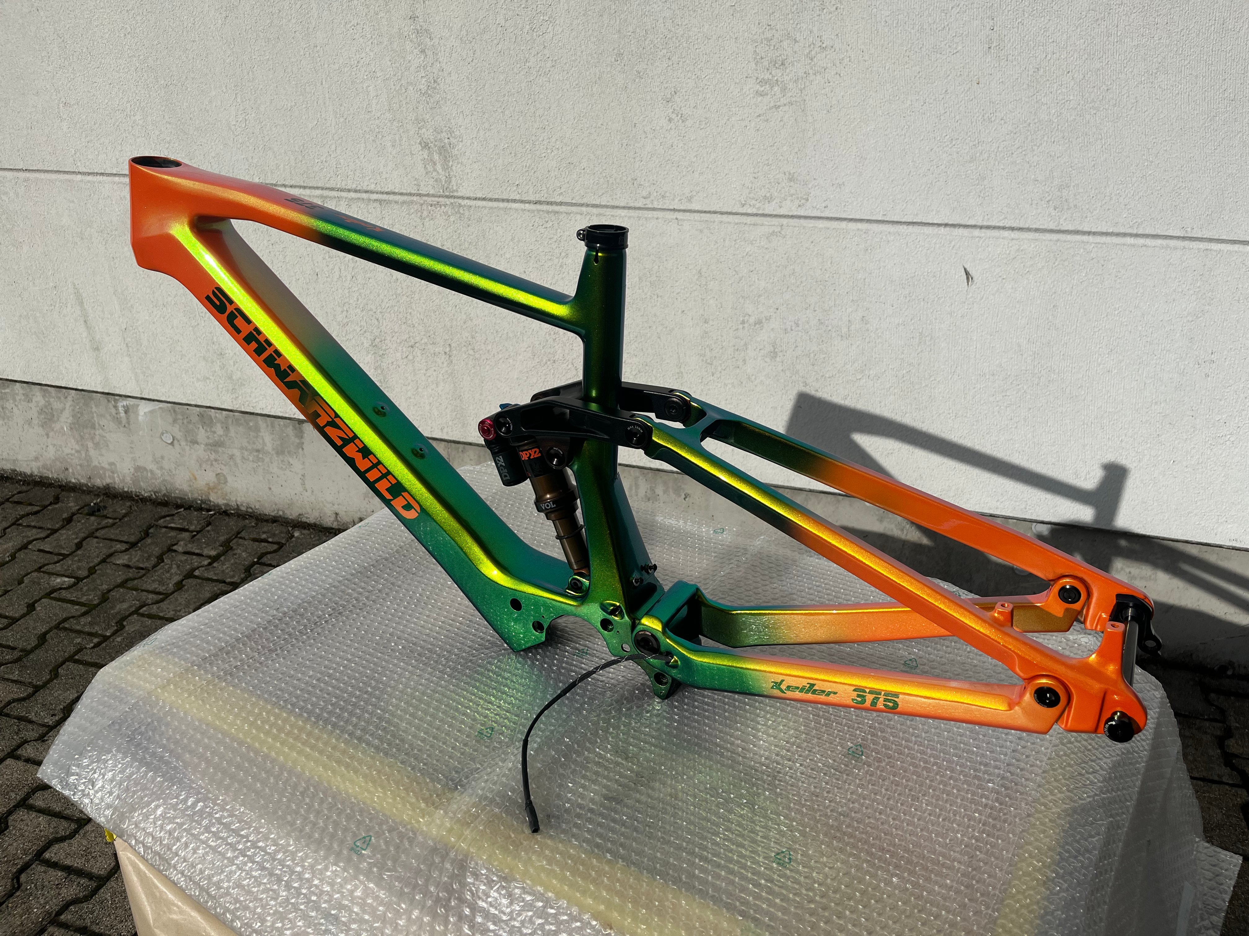

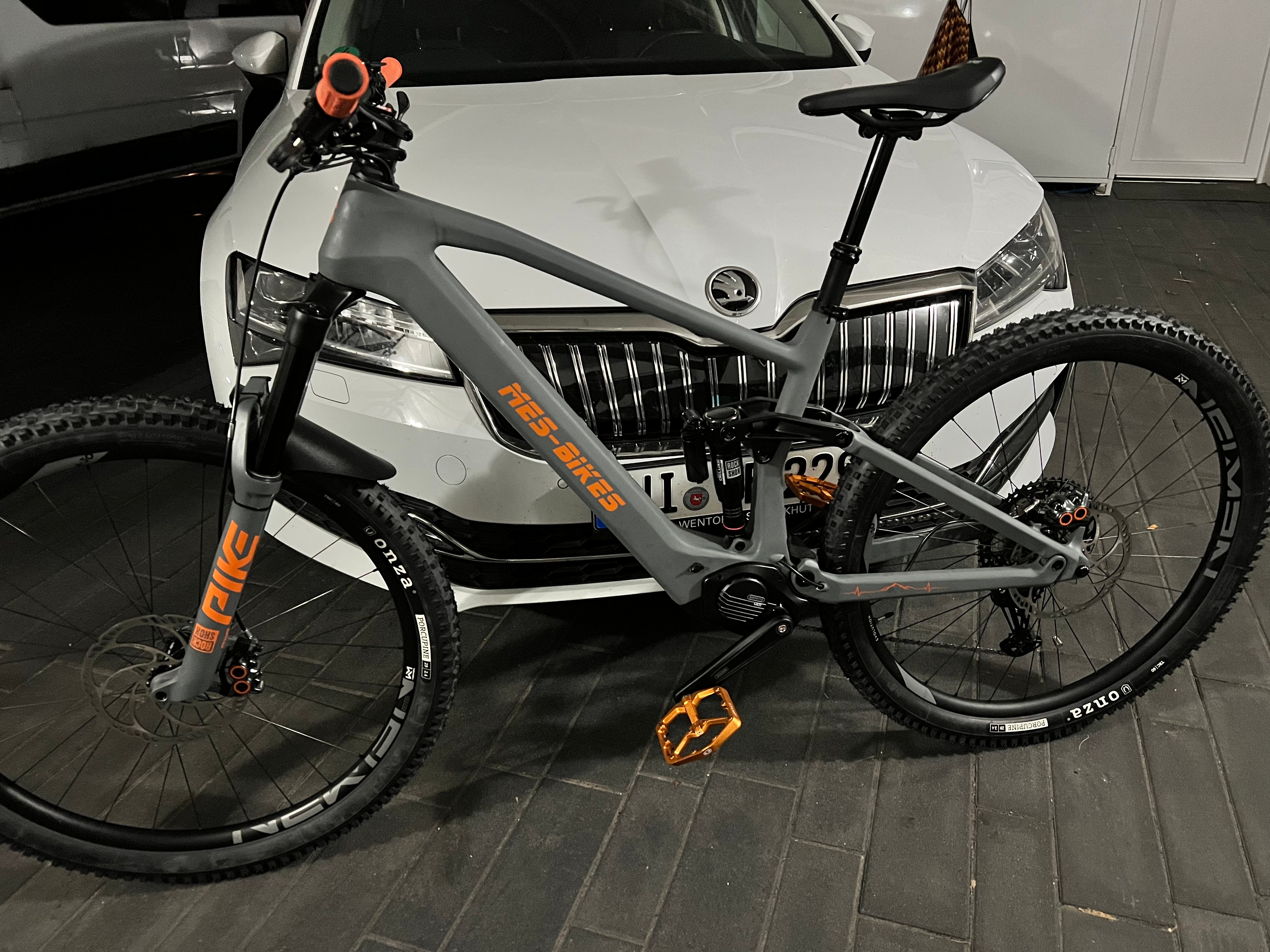

SCHWARZWILD Bafang M820 with LCE 930 frame
I am so dying to see this. I really would like to see a lighter fat bike build, without the M620. Still haven't given up hope on that one.
A lighter motor and smaller battery should easily shave off 5kg of the current fat bike builds.
now have the fat EMTB carbon frame fit for M510/M560 and battery 840wh, but no frame fit for small battery

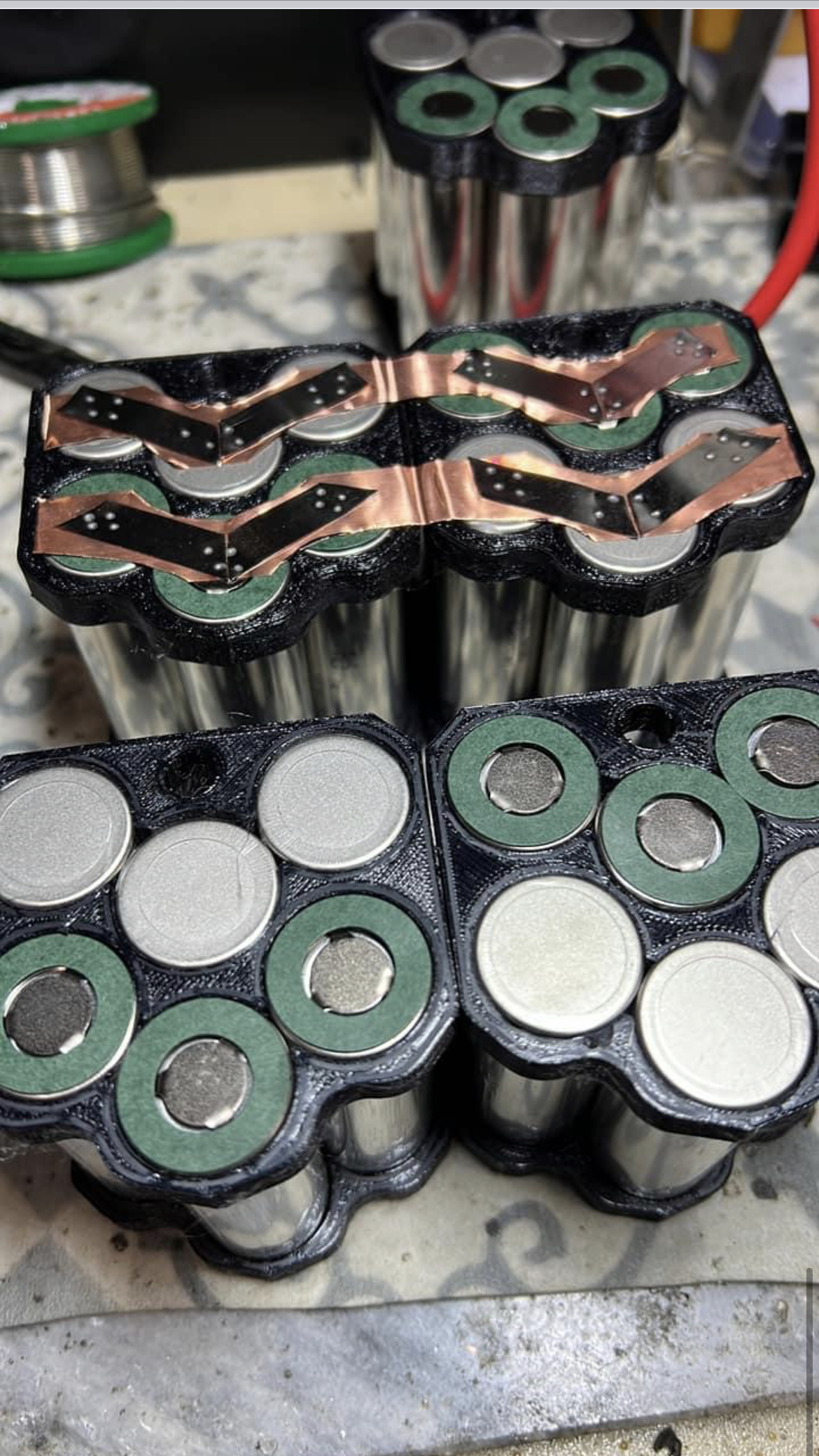

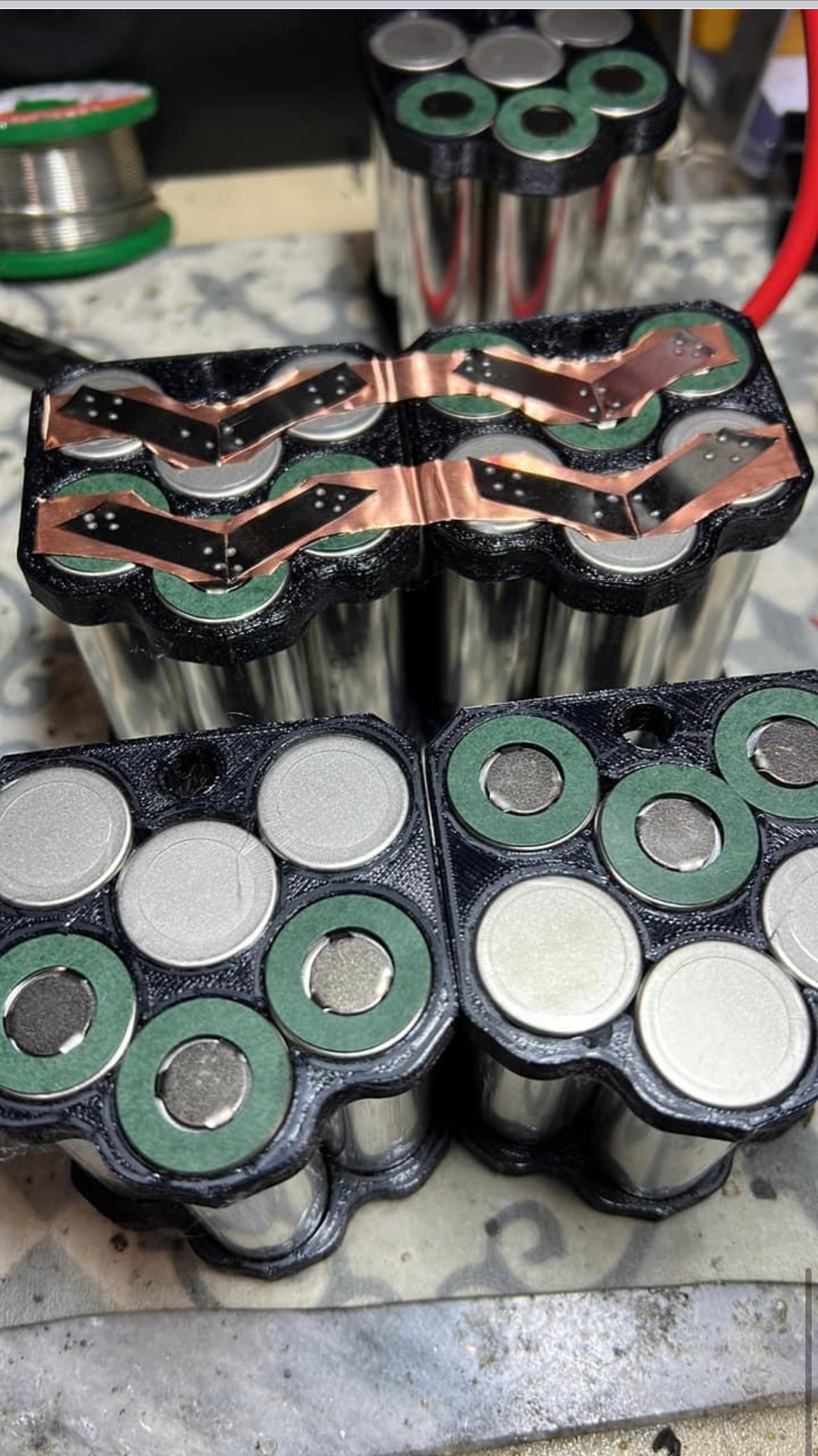

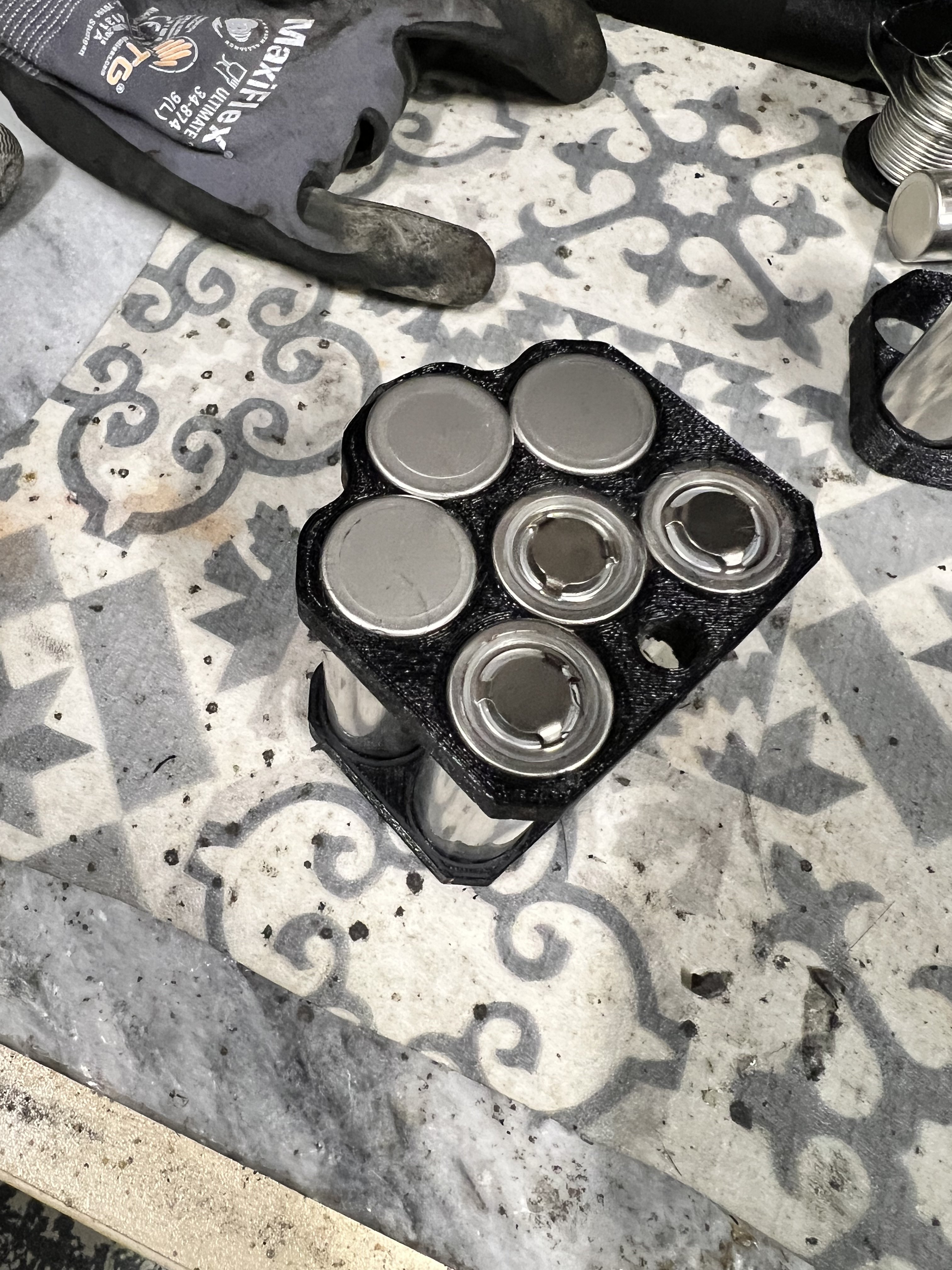

Hi Karo. Nice. I realized my lc930 with 600wh as well. I designed special 3d printed cell holder for that . Could be very tight with 3x13 ;) but can fit I guess . I have 3x10 21700
I reached 18,6kg. Are you satisfied with the m820 regarding „power reaction/ startup angle“ . My impression is that it is not as quick as my m510 fc2 . I tuned it with besstpro to minimum startup angle but still not fully satisfied 🥲
6A71D1D7-6F22-4220-9B27-826C6C85A235.jpeg 3253B17D-296E-4AD7-BF58-59FAD954BFAB.jpeg 87BACA82-0983-435D-BEA3-567560474B9C.jpeg

Nice battery design. I can't see any difference to the M 510 in terms of power reaktion. However, I also have the 43V version.

Very clean design for cells,
More photos please show it.
the bafang company said the same power output,
Awesome battery design @Mirkoser ! I have already downloaded your STL file that you shared on FB :)
I can't wait to build my LCE 930 when it arrives.
How did you attach the battery to the frame? I'm also curious about more photos :love:
Sorry haven’t made more photos of the finished battery. I used special high voltage heat shrink to protect the battery and it sits very tight in the frame without any movement. Additionally I locked it with plastic screws through the bottle holder threads

I am a bit confused, you used a 48v battery and 48v motor flashed w 43v firmware?? was there a issue w 48v motor and battery???
Amazing!!
The M 820 is currently only available in 36V and 43V versions. My motor is originally a 36V which my salesman flashed for me with the 43v software on request. I only use the 48V battery to get a little more power out of the motor.
Ahh, I see, I am told there is now a 48v firmware...

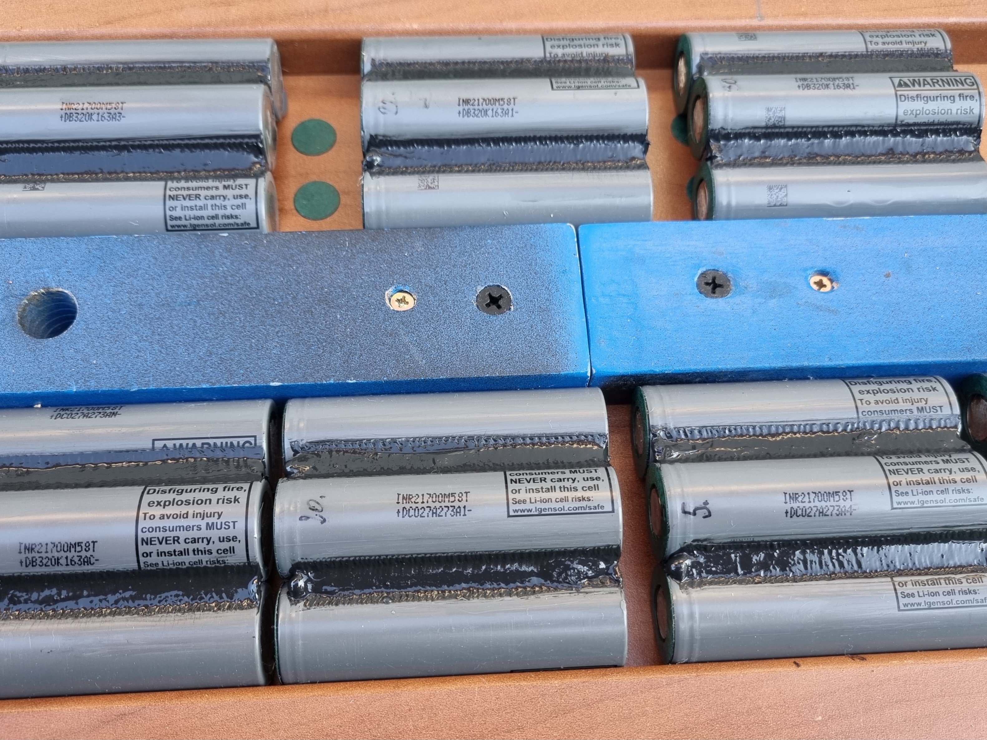

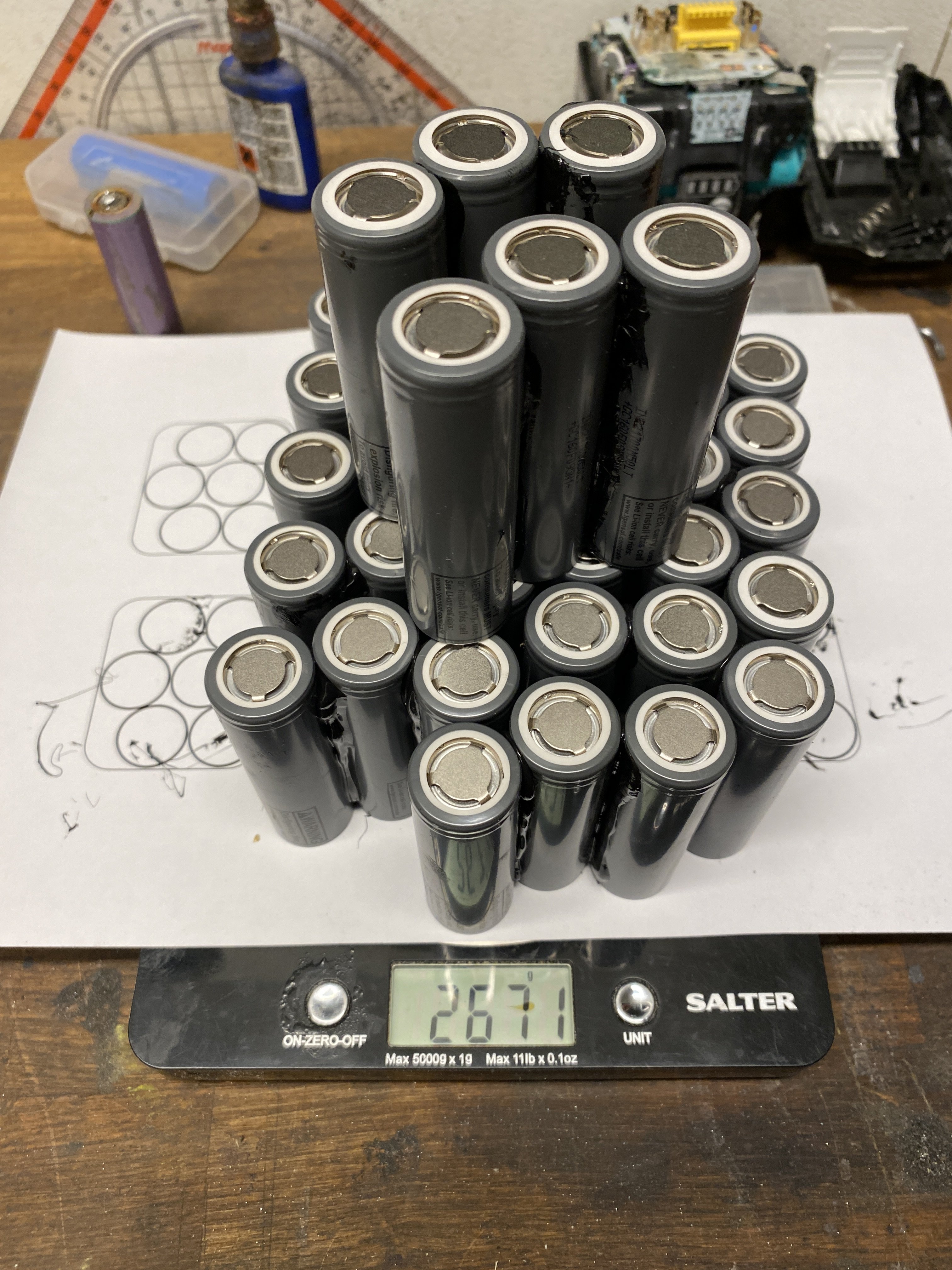

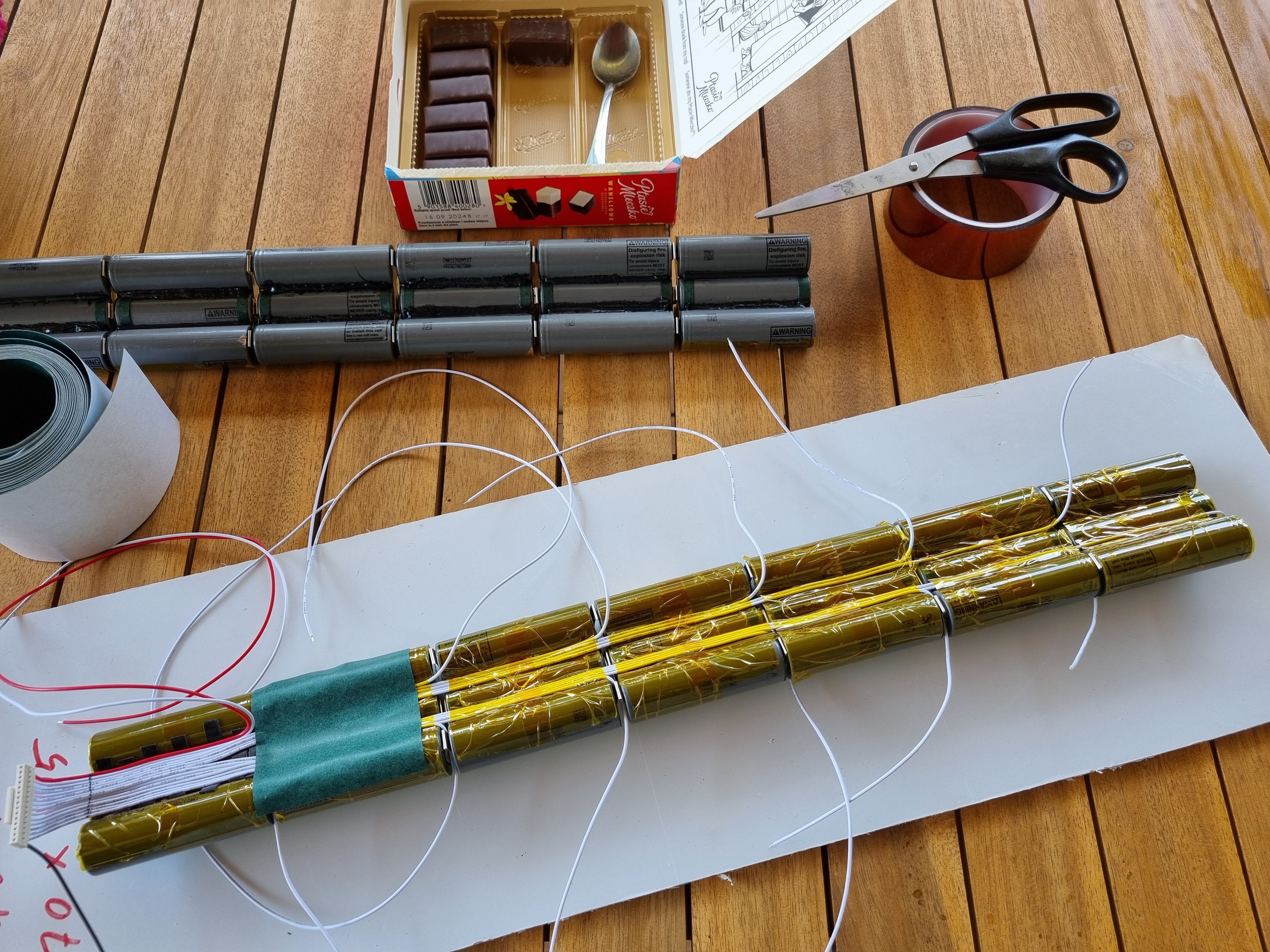

I just started building a 13S3P battery, but it will still take some time before it is ready. Cells only glued together weigh 2671 grams.View attachment 127065
Hi. How do you glue the cells? (what is the name of the drug?) is the glue flexible or hard? and how tightly does the glue stick to the cell? Greetings
I used Wurth polymer glue, it can take heat up to +90 degrees celsius. I just put glue in between and checked the angle with model i made on paper. It sticks very well, but can surely be cut if needed, it stays flexible. It needs to be flexible not to brake from vibrations.
I guess you can use any heat resistant glue that stays flexible.
Thanks for the info. In the meantime, I bought and used Loctite 5970, which has excellent adhesion and, according to the safety data sheet, is resistant to vibrations, and fortunately I am already finishing the construction of the package :)

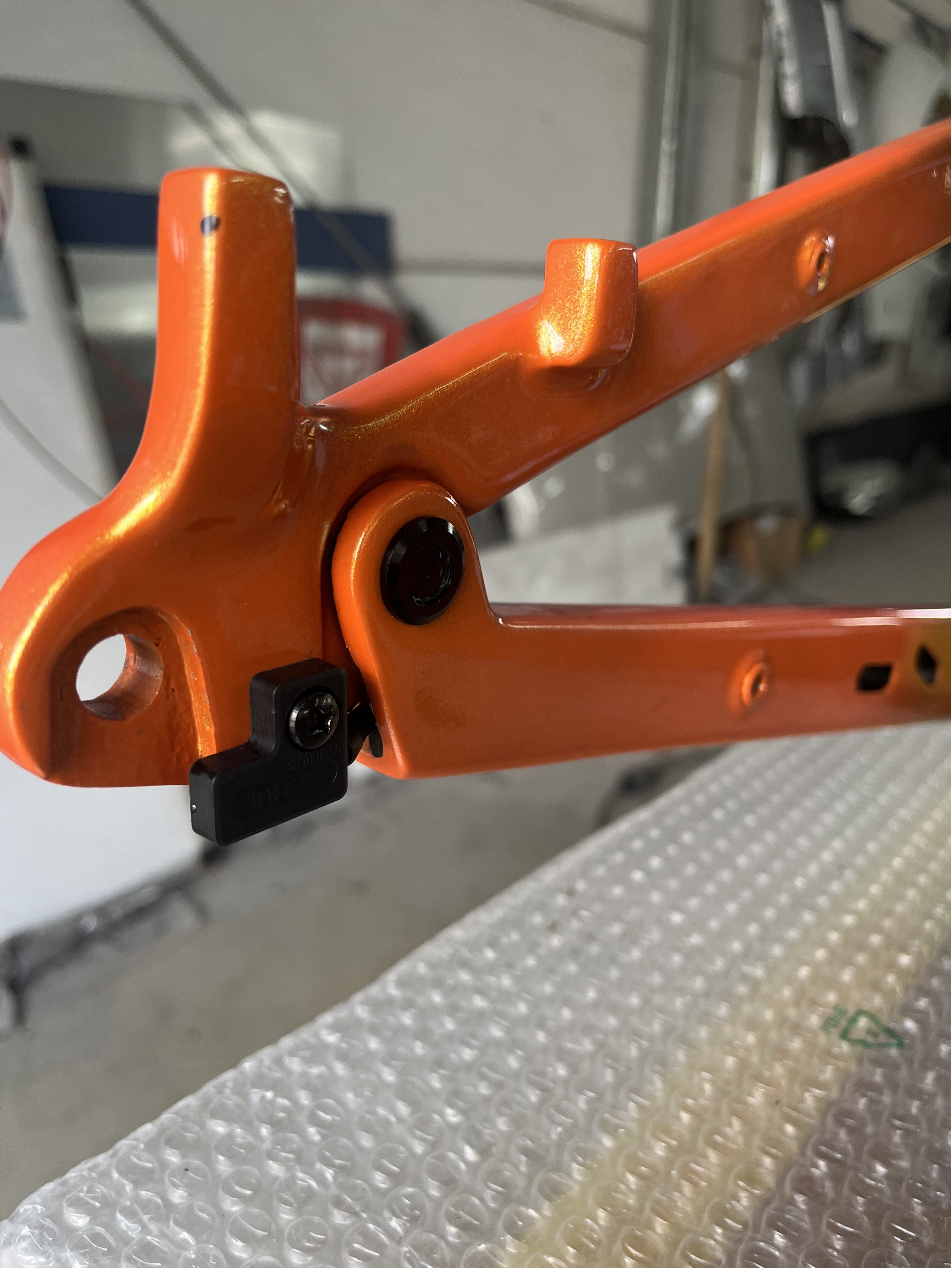

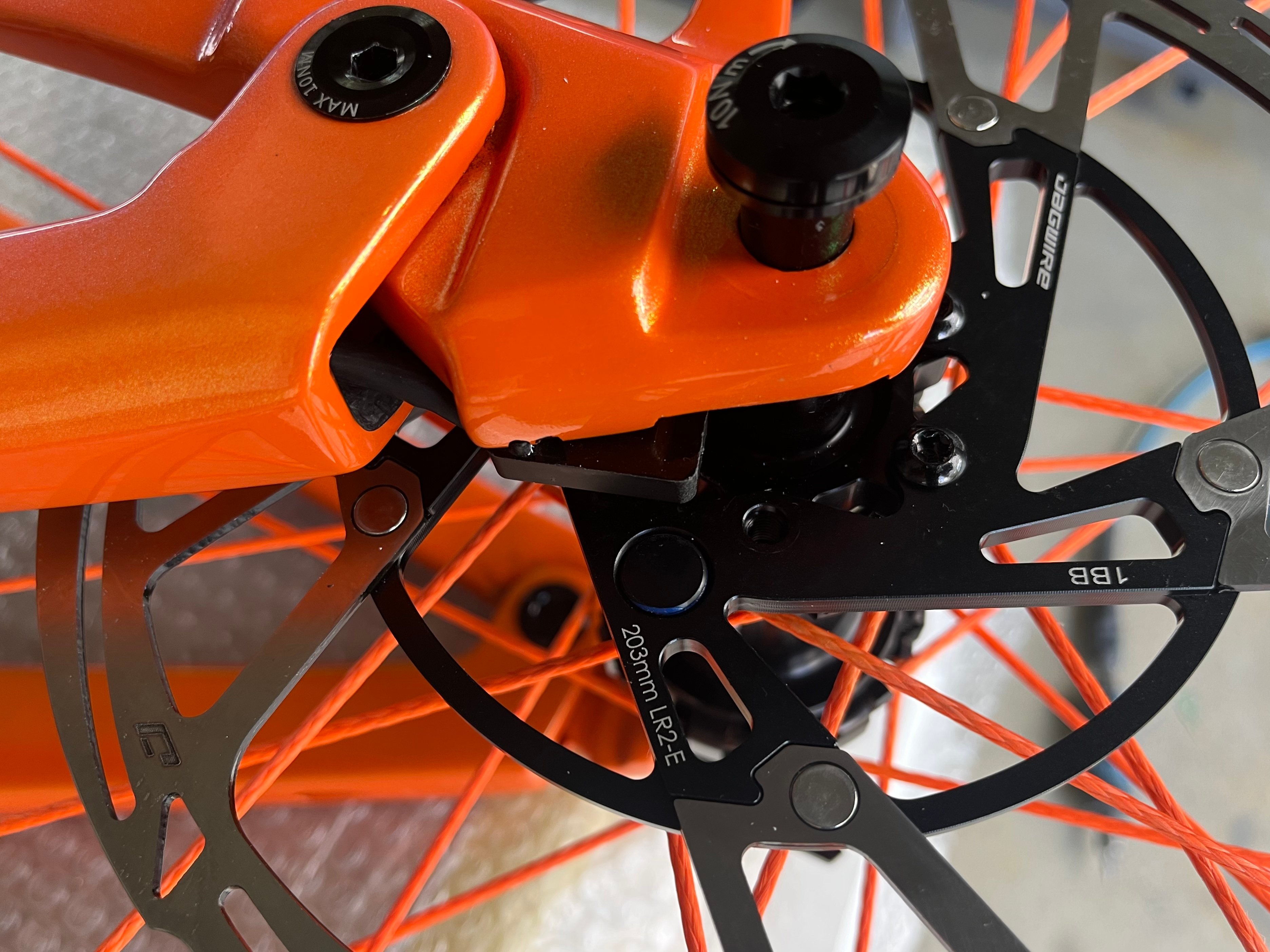

Hallöchen, baue zurzeit ein Light Carbon LCE 28 mit Bafang M620 zusammen! Den Umbau mit dem Speedsensor und Bremsscheibe würde ich auch gerne machen! Woher hast du den speedsensor ! habe schon stundenlang gesucht! Gibt es irgendwas Speziales, beim Umbau zu beachten? Vielen Dank für deine Unterstützung! Gruß Stefan

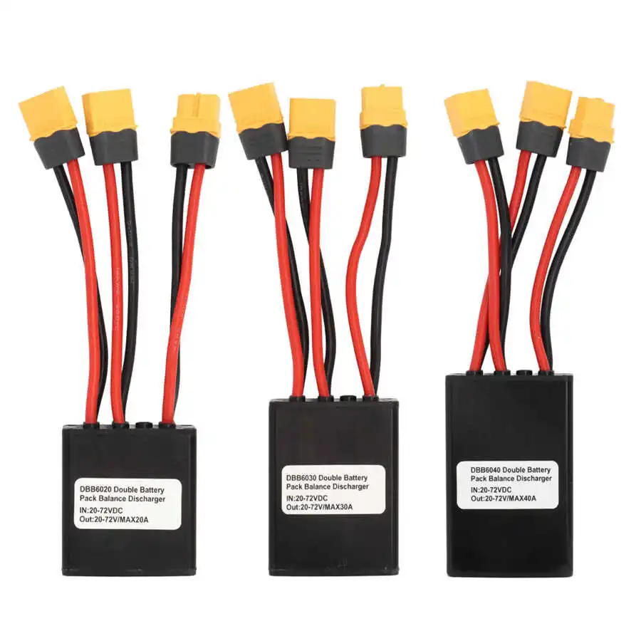

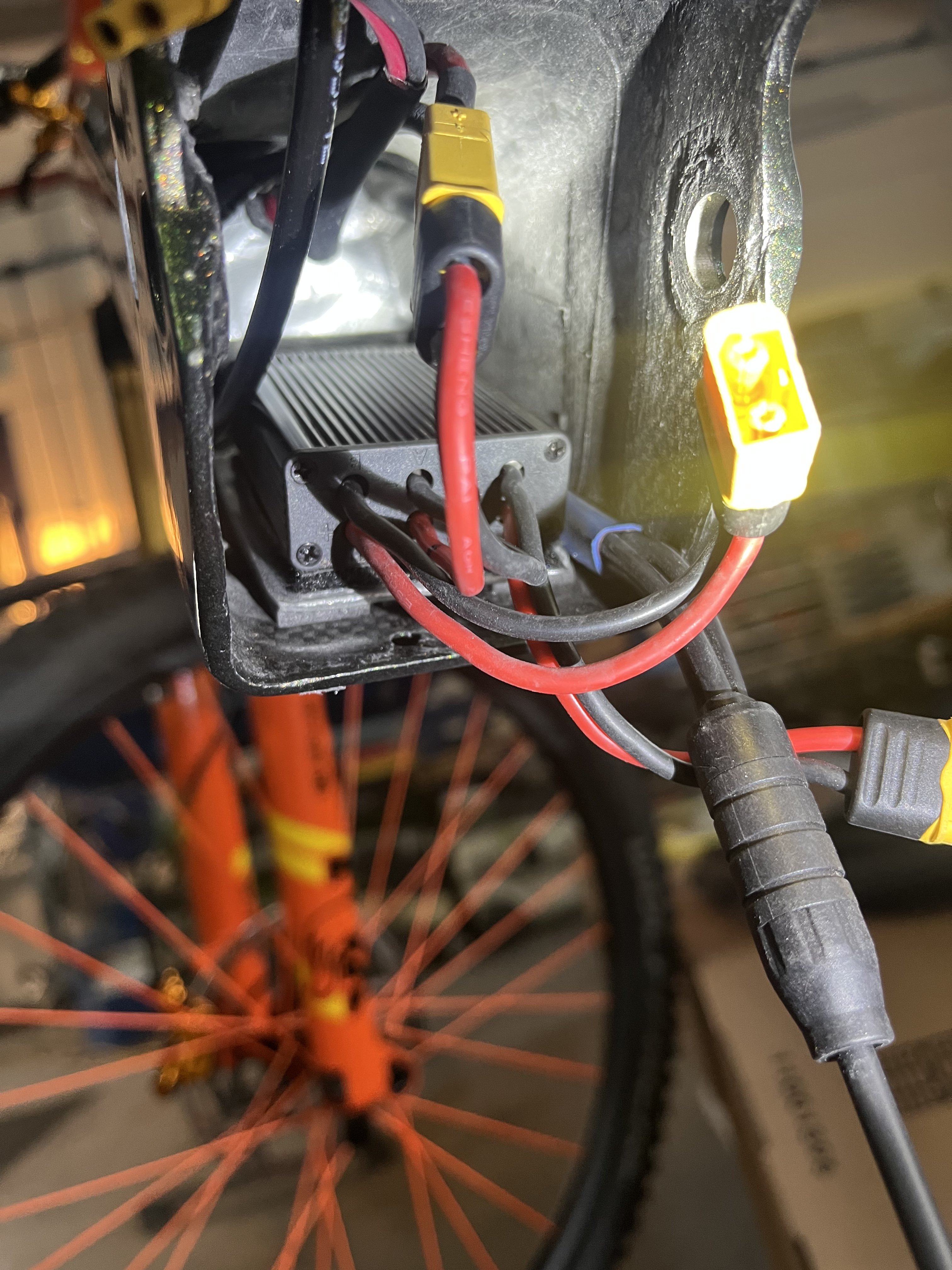

In order to fix the battery and attach the dual battery discharger, I made an aluminum bracket…
View attachment 124280View attachment 124281
I attached the connections for the range extender and the charger with a rubber stopper and pull them out of the frame when necessary, I couldn't think of anything better 🤷‍♂️
Hi. Please write how does the 2-battery splitter work? Send me which one you bought.
I want to convert my 13S3P + FW43W set (it drags on too long after stopping pedaling) to 11S3P + 11S1P (range extender) + FW36 (definitely the best engine software)... Regards
Hallo. Bitte schreiben Sie, wie der 2-Batterie-Splitter funktioniert? Schicken Sie mir, welches Sie gekauft haben.
Ich möchte mein 13S3P + FW43W Set (es zieht sich zu lange hin, nachdem es aufgehört hat zu treten) auf 11S3P + 11S1P (Range Extender) + FW36 (definitiv die beste Motorsoftware) umrüsten... Grüße
