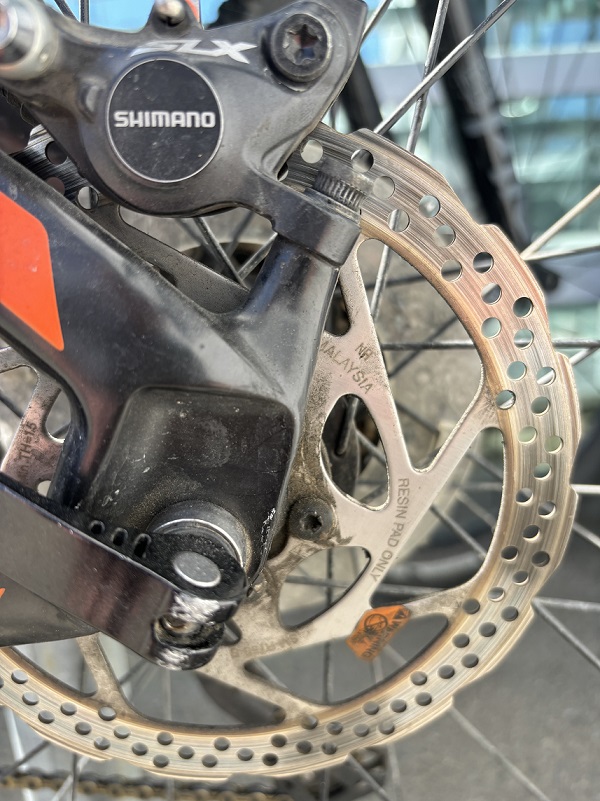

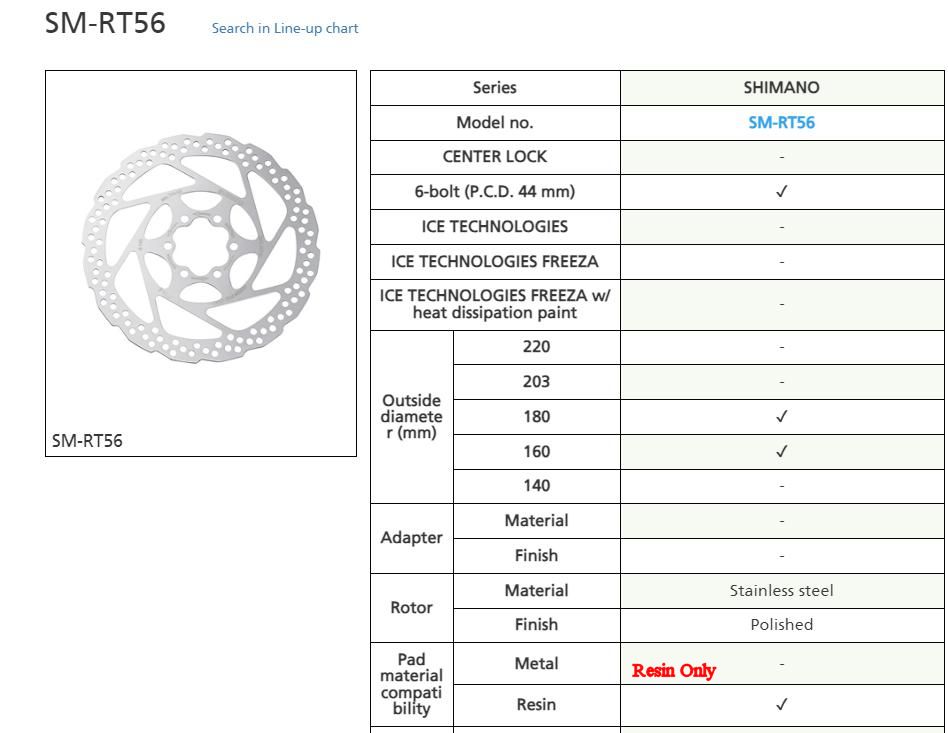

I think Shimano RT-56 are "Resin only". I don't think SRAM makes any. I'd expect there are oddball manufacturers on Amazon that sell them, who come and go.
RT56 are indeed resin only. I just went and snapped a pic of my rear disc on my XTC hardtail. The lower spec discs than this RT46? RT26 etc are all resin only.

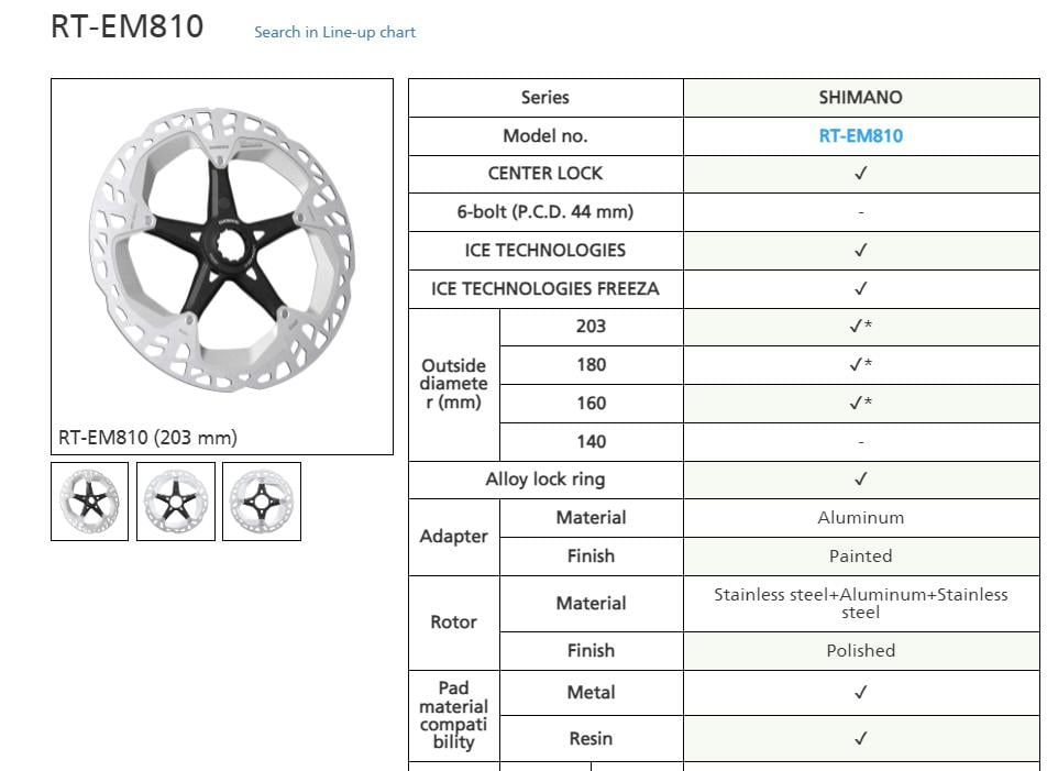

RT66, RT76, RT86 etc are all fine with metal and resin

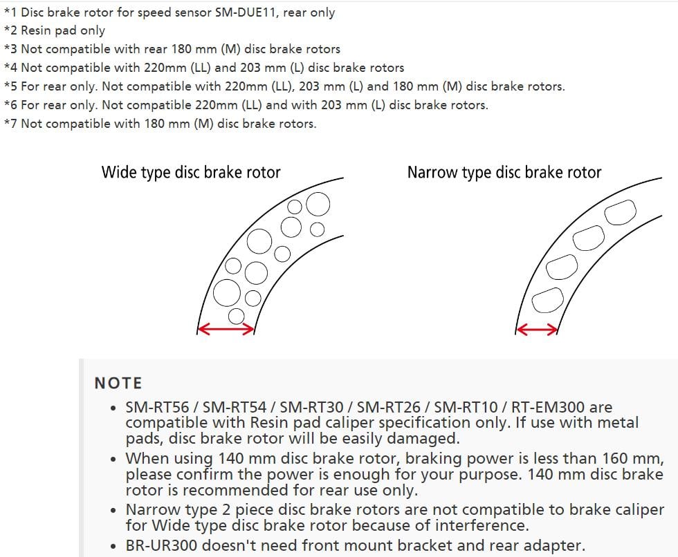

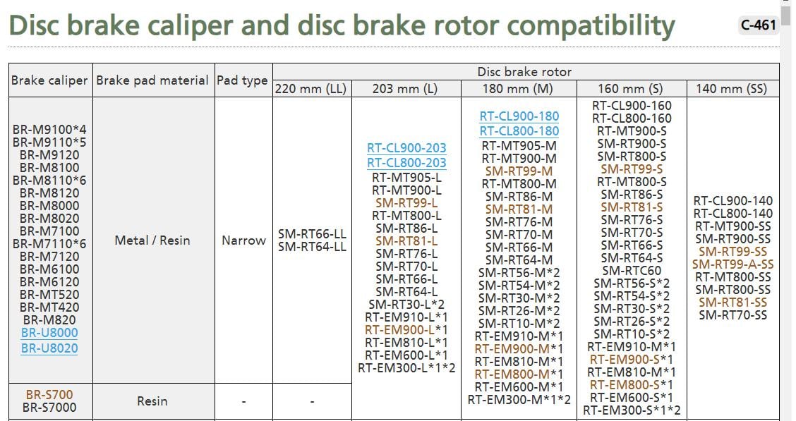

Brake pad compatibility on Shimano braking systems can be referenced using Shimano's compatibility charts.
You will note that some Shimano brake rotors will have an a "*2" suffix attached at the end of the rotor model number. This denotes that the rotor is compatible with resin brakes pads and not metallic.

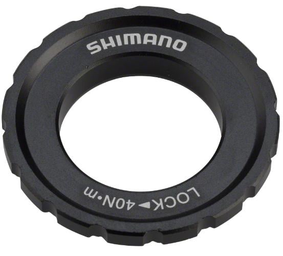

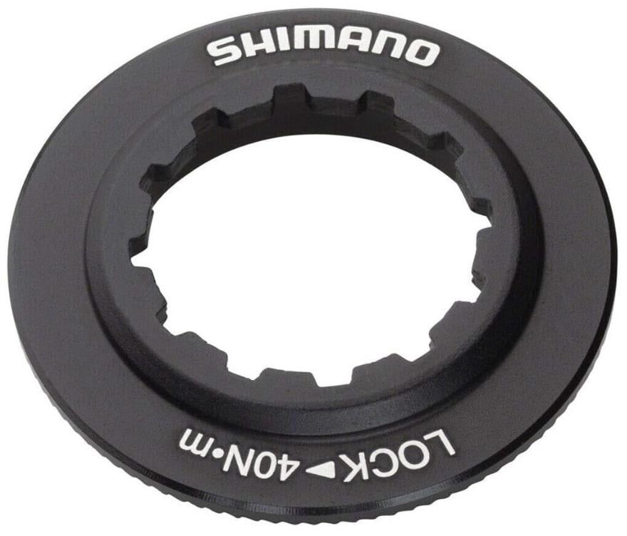

I found a really good deal on shimano cl icetech rotors but they have internal lockring and I need external. Can I just bit them and use the external ones I have now or are the rotors also different?
Sander23,
Yes, you can use your external lock ring in place of an internally splined lock ring. Shimano uses two types of rotor lock ring, "External" and "Internal Splined." Which lock ring a person uses is dictated by the axle, hub end caps, and restrictions in amount of space at the hub. If your hub uses an external lock ring, then yes, you can use it on any Shimano center lock hub that you buy.
External Lock Ring
Internally splined Lock Ring

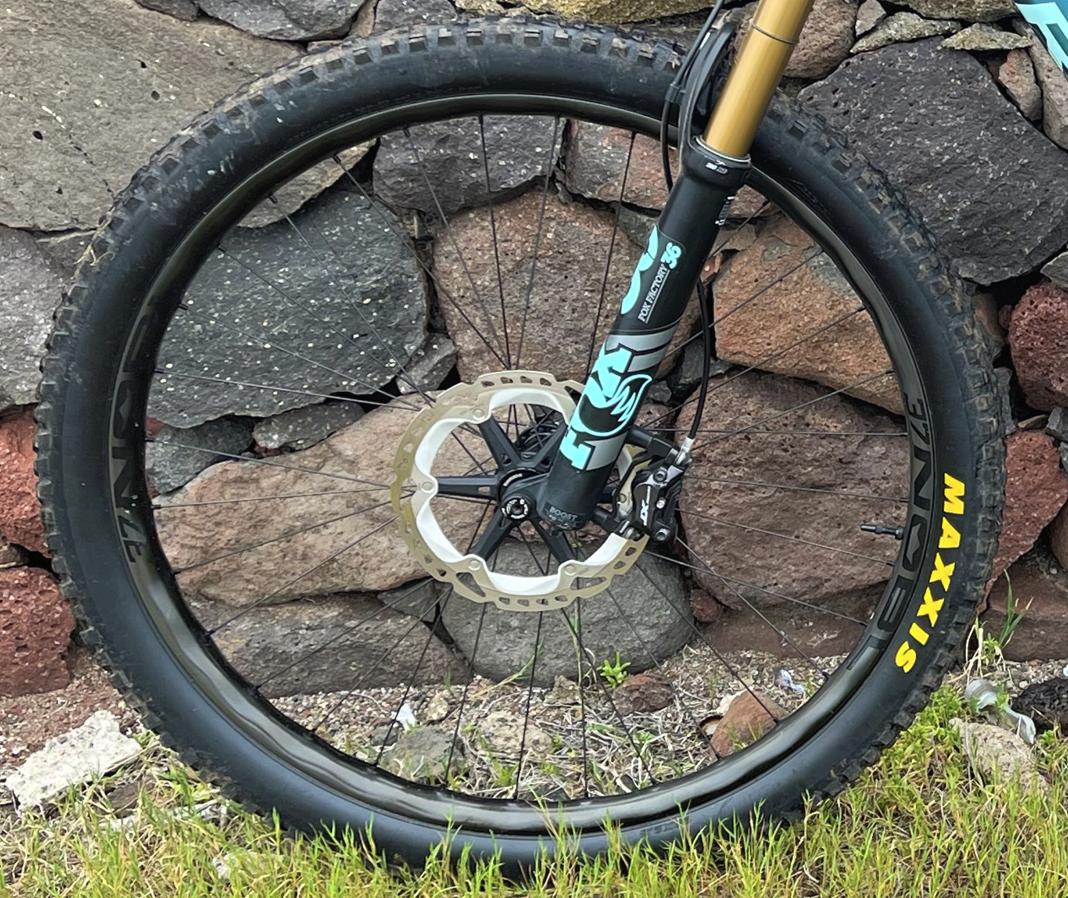

Shimano Ice Tech Rotor on my Rise M20 with Noble TR37 wheels.
Thanks for this post. However, which of these rotors are specified on MTB's, or more relevantly since this an eMTB site, on eMTB's?
