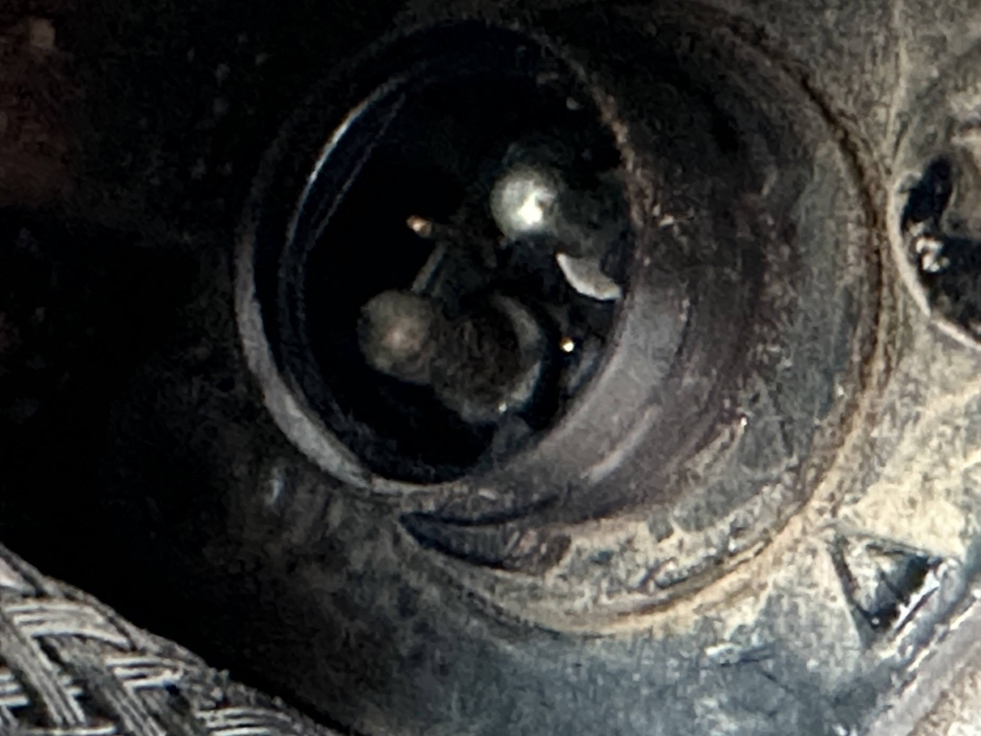

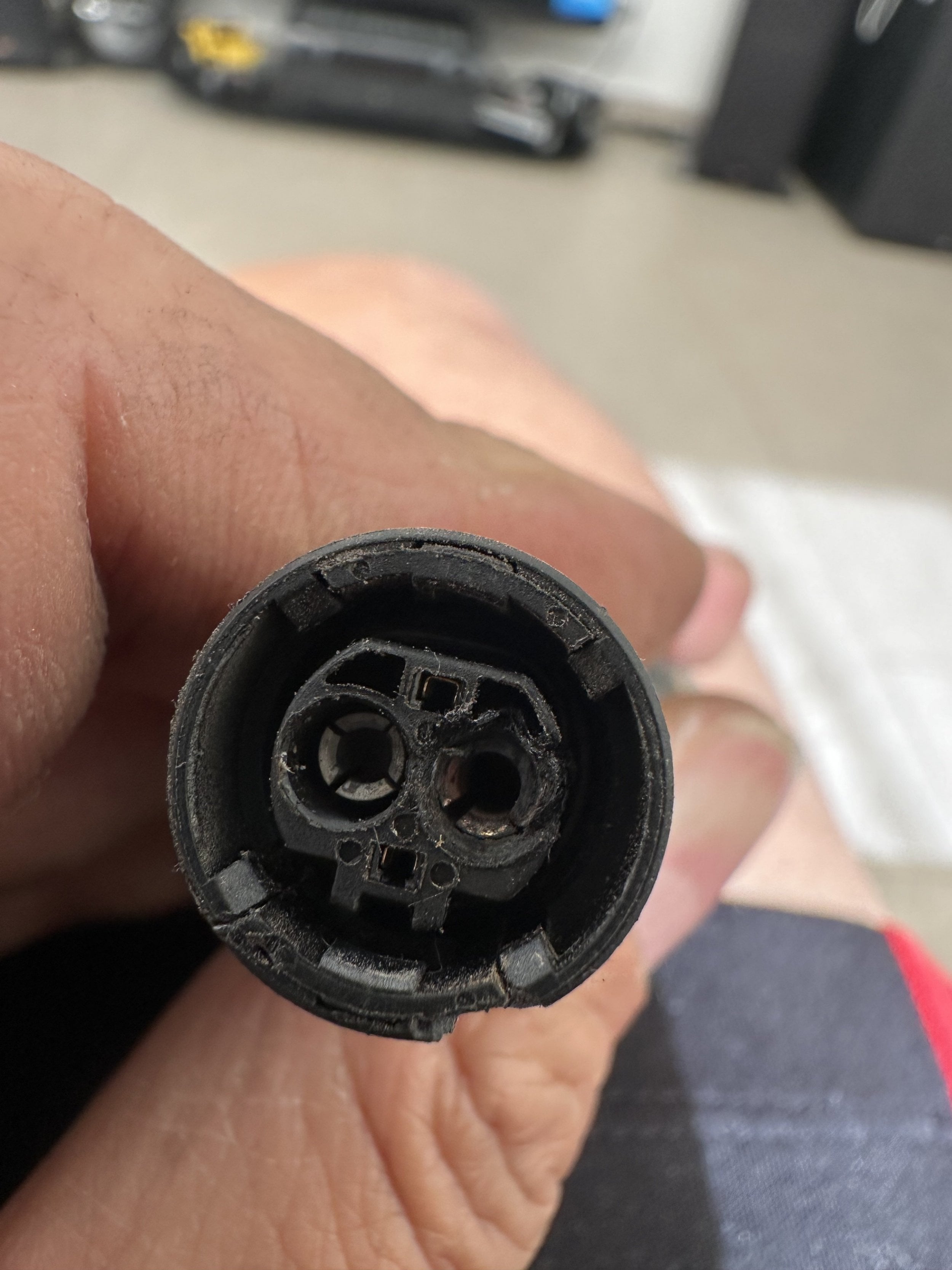

Exactly same problem and this is what I found
