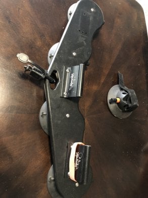

I am waiting on a quick release for my fork, but I am going to try seasuckers roof mount. It says 45 pound limit per bike and I have the two bike rack = 90lbs limit total. So in theory it will work . I have moved a 20mm to the center to balance the weight for solo bike transportation. image.jpg
