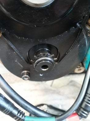

With the Dyname drive being so quiet, I didn't think to inspect the primary drive (I've not found or received info from RM about inspecting or servicing the primary drive).
After another member discovered his was badly worn, I checked mine to see and discovered the chain was worn and the motor drive pinion has bent teeth.
I replaced the #25 chain and it's 2 o-rings, but the bent teeth clip the new chain so it's noisy - still works fine. I asked the dealer about purchasing a new pinion, but apparently the motor has to replaced... This is being performed under warranty next week. The bike has travelled 8000 km and the motor runs perfectly so although I'm receiving a new unit, I am a bit concerned about not being able to replace a crucial part going forward beyond the warranty period. I'll be asking that question when I drop it in for sure.
The pinion was not designed to be replaced ?
That's how they're playing it, but while it's under warranty I ain't gonna remove the motor end cover to see inside lol. I will enquire when I drop it off Monday, but I don't think the shop really knows. I would expect the part is replaceable, but it's odd to me (and a little wasteful), to be replacing a sweet motor instead of the worn part.

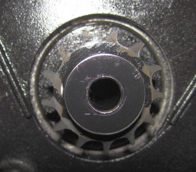

Bought this week a #25 chain and checked the length. Checked my 5430km chain against the new one. 0,3 mm longer across 23 chain links.
In other words ~ 0,2 %. Unfortunately the motor cog looks quite worn, but still no noise or any other shortcomings.
I wonder how a new cog looks like...

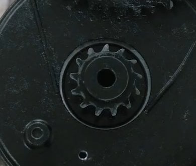

Interesting: the transfer chain replacement video
That motor used for this tutorial looked brandnew. Still the motor cog looks like this:

Hahaha, indeed. Could be that's how it is supposed to be. Doesn't seem correct though when one considers every other roller chain/sprocket set up. Maybe it's some new Canadian secret black magic technical innovation spooky engineering. I'll open up my new one and check when I get a chance.
Right. Even if the cog is very endurant, it will be worn some day. It must be serviceable without changing the motor or any other action that cannot be done in a reasonable equipped workshop. With all my consideration for the very nice performance, this is very bad. Would not have bought this bike if I knew this.
I can only hope to be wrong.
So the good news is the cog looks that way from new. This confirms my suspicions about Canadian black magic :LOL:

I'm sure it must be a serviceable part. With all that torque though, it needs to be secured in a way that it will never work loose - just look at the damage the transfer cog can do to the transfer shaft spline if left to rattle around like happened to that other poor bugger on here. I feel a bit silly tbh now knowing that the pinion drive wasn't actually damaged, but in my defence, I did supply photos and originally enquired about purchasing the part. I wonder now how often to replace that chain going forwards.

It is a trick of the camera. I was a bit scared when this posting was issued and looked from different perspectives. The "bent teeth" changed position when I was moving my perspective. That weird tooth profile is causing this effect. Looks like a Shimano 11t that was mounted the wrong way...
