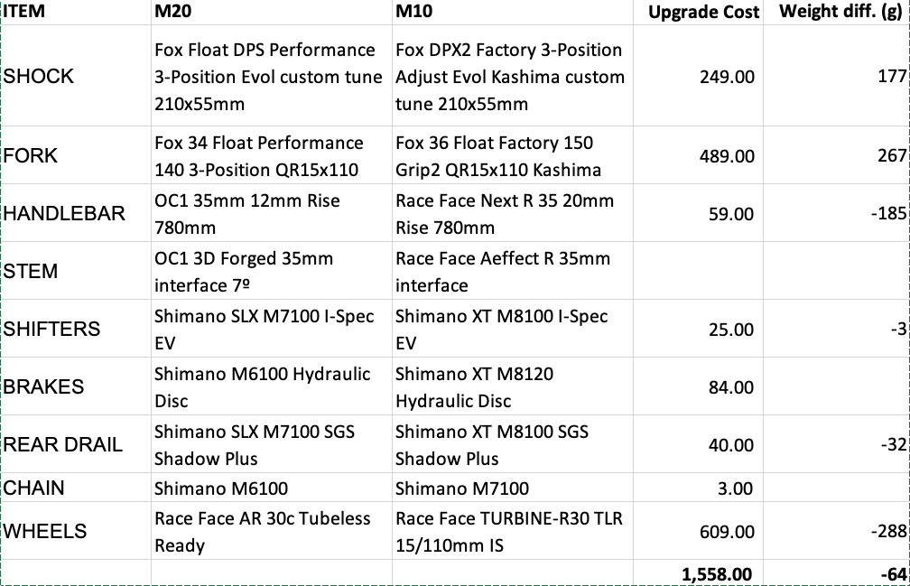

I went through the M10 vs. M20 exercise too and ended up on the M10 since it's a bargain with the upgraded parts sold at market value and the bike is already very expensive. Orbea isn't marking up the parts and the list is substantial between the two compared to other manufacturers who change a fork and ask for another $1500. That said, if you *don't* have the means for an M10, the M20 will be amazing in it's own right.
To evaluate the parts differences, I went full-on geek and made a spreadsheet with either Orbea's stated cost to upgrade the part, or market cost to upgrade from M20 to M10. I came up with almost exactly the same $ in market upgrade as price differential between the two, and to see if there was any weight penalty for the more robust suspension parts (there wasn't overall). The M10, despite the heavier suspension pieces, gets lighter rims and bars making the weight differential estimated -64g on the M10 (so negligible).
