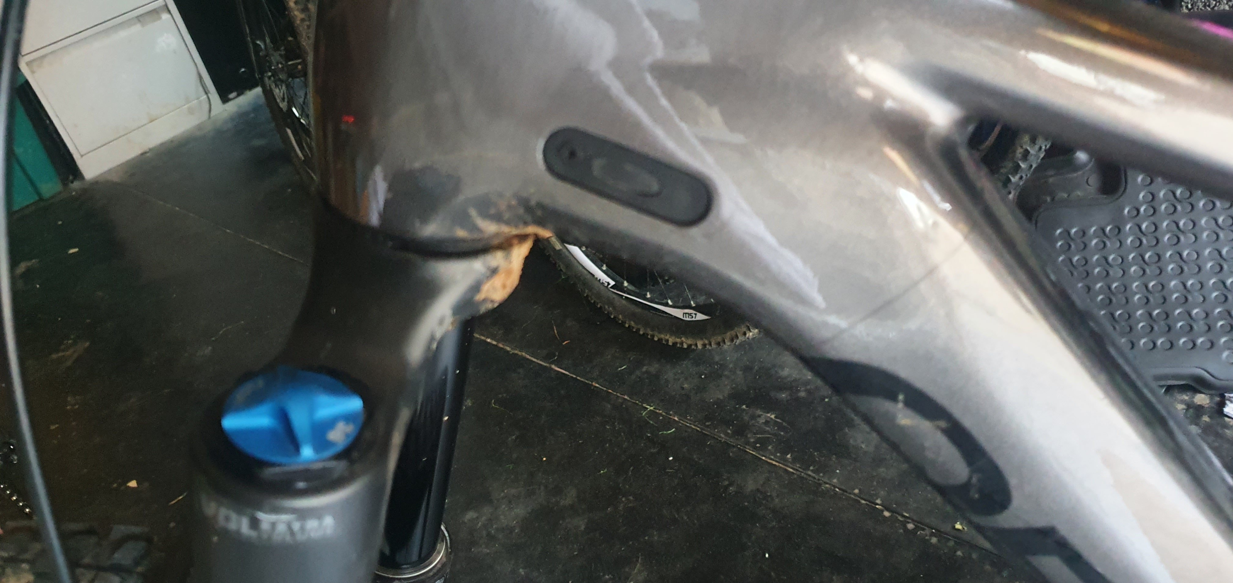

My UK Rise came from the factory with rear brake hose, dropper cable and display wire all routed through port on the RH side of the head tube. UK bikes have the rear brake lever on the left. I removed the gear cable from the LH side port and blanked the hole off when I fitted AXS derailleur.
