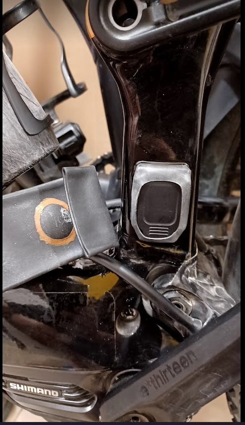

But this post is also to bring my first tip in case it is useful to this community. I have observed that latest spring rains and dry dust is coming around the seal for charging port through the charging plastic door, making it difficult to keep that sensitive area clean.
And I have found a cheap way of improving that with a slice cut out of an old tire tube, and put around the charging door as outer seal.
Attaching a picture to illustrate the concept.
Have a nice ride!!!!

I have rode couple of times with it and it is preventing a lot of dust to come into there.
If it doesn't stay in place, cut a slightly narrower ring. No glue needed :)

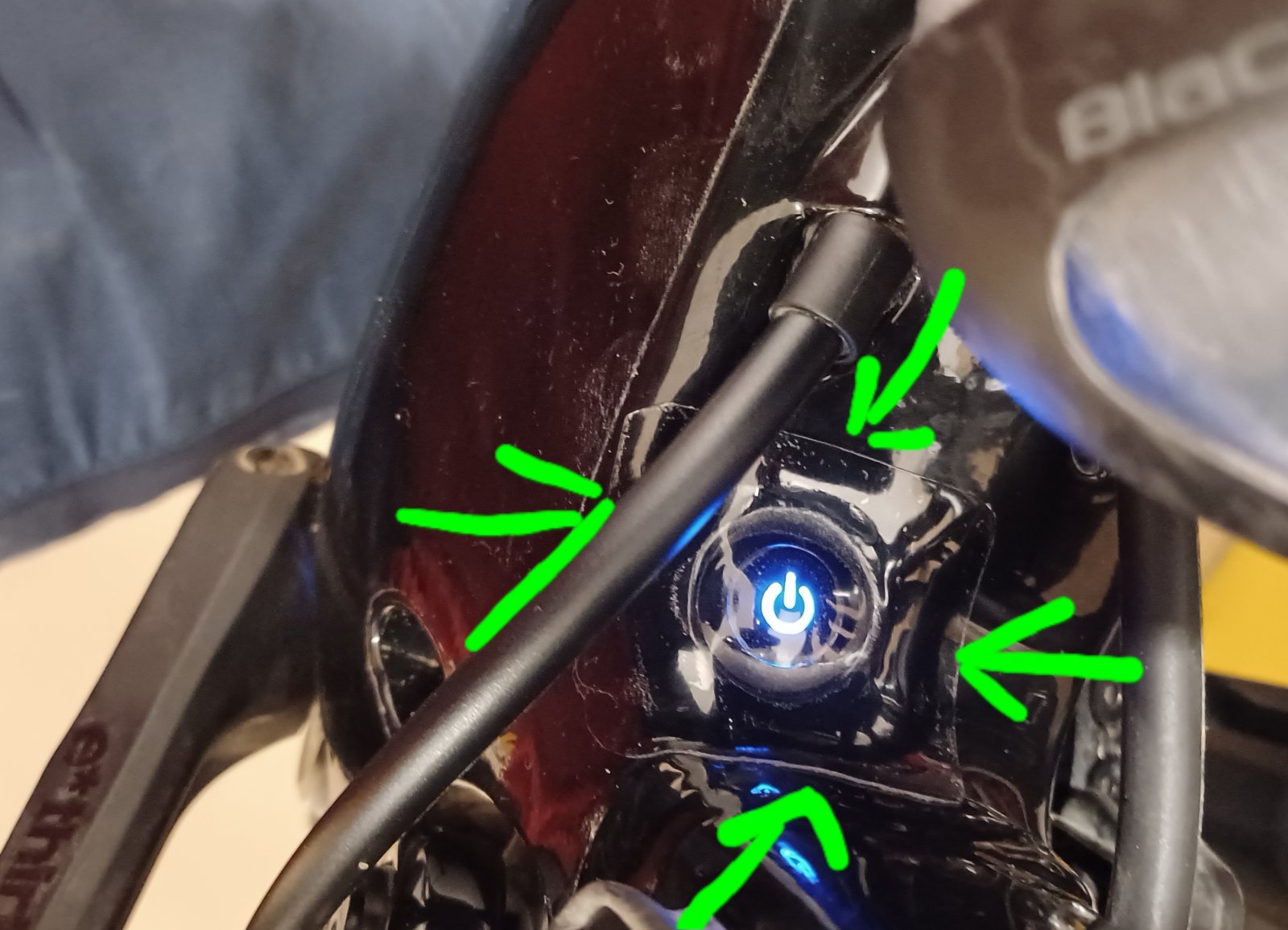

And now another simple tip: this time to protect the power button from dust and water.
Just used some spare piece of bike frame protection transparent film (bike shield in my case), and sticked it over the power button area.
Cheap, fast, effective and available to everyone!

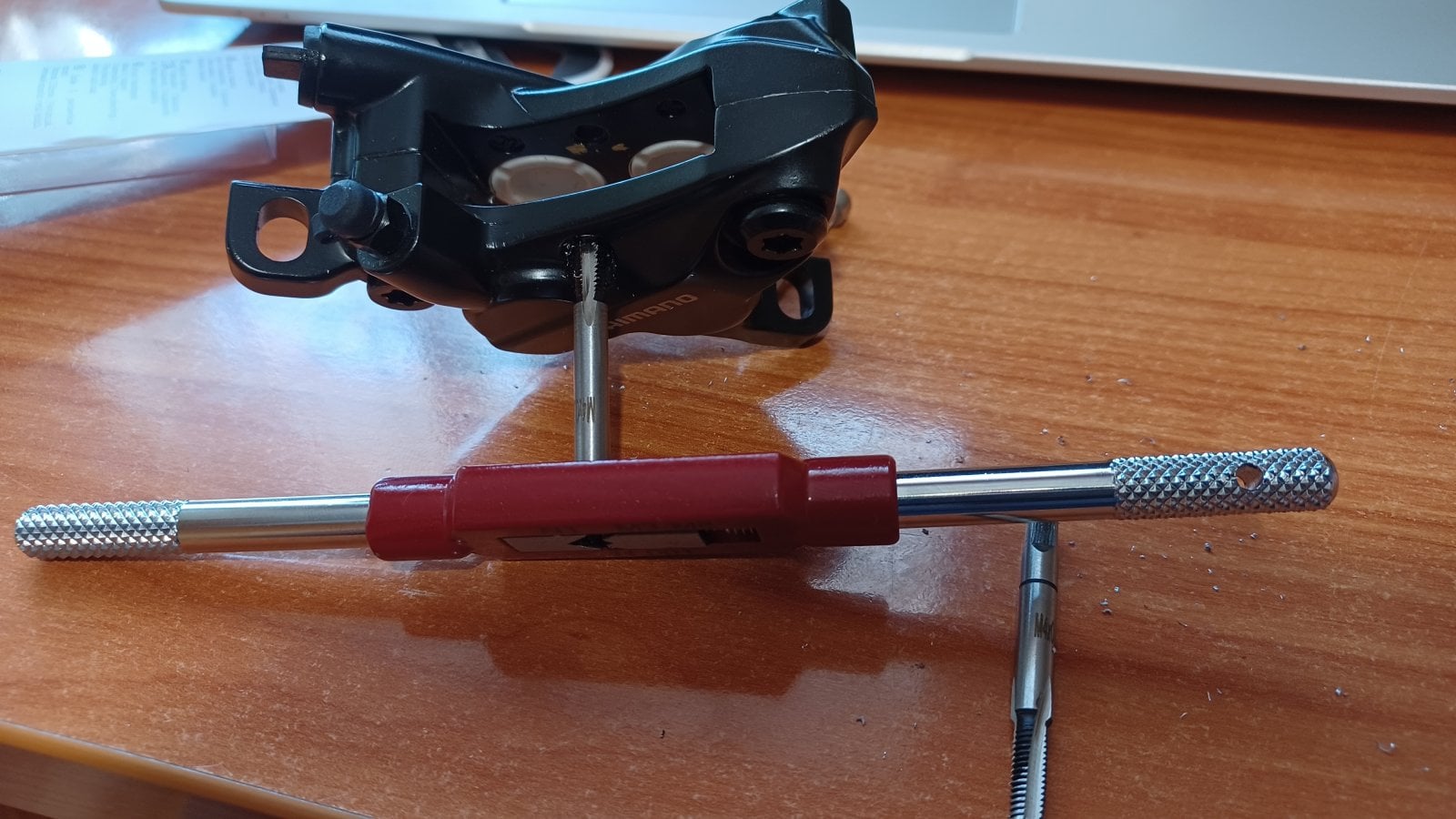

New tip: Yesterday I got my BR-MT520 delivered (more than 50 euro :eek:, maket is crazy) and followed the suggestion from @Funks. With M4x0.7 tap you can make a thread for the Shimano pad axle.

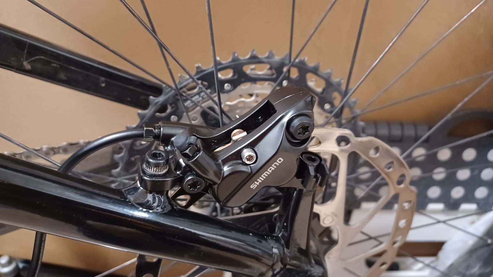

And here the new 4 piston caliper instaled with Shimano pad axle and snap retainer used in SLX and XT calipers.
I like the solid black of BR-MT520 caliper in line with frame colour. BR-M6100 is a bit more black-grey while BR-M7120 is a bit black-blue ;)

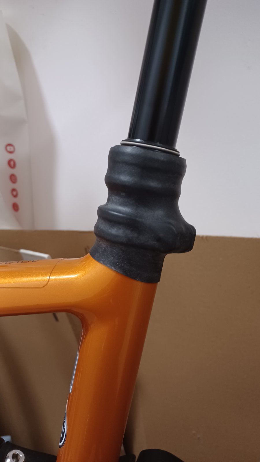

Yet another simple idea, hoping you find it useful.
Use a portion of an old tire tube and after taking your saddle off the bike, pull it down through seat post to prevent dust and dirt coming from rear wheel to enter inside the frame. Picture attached:
