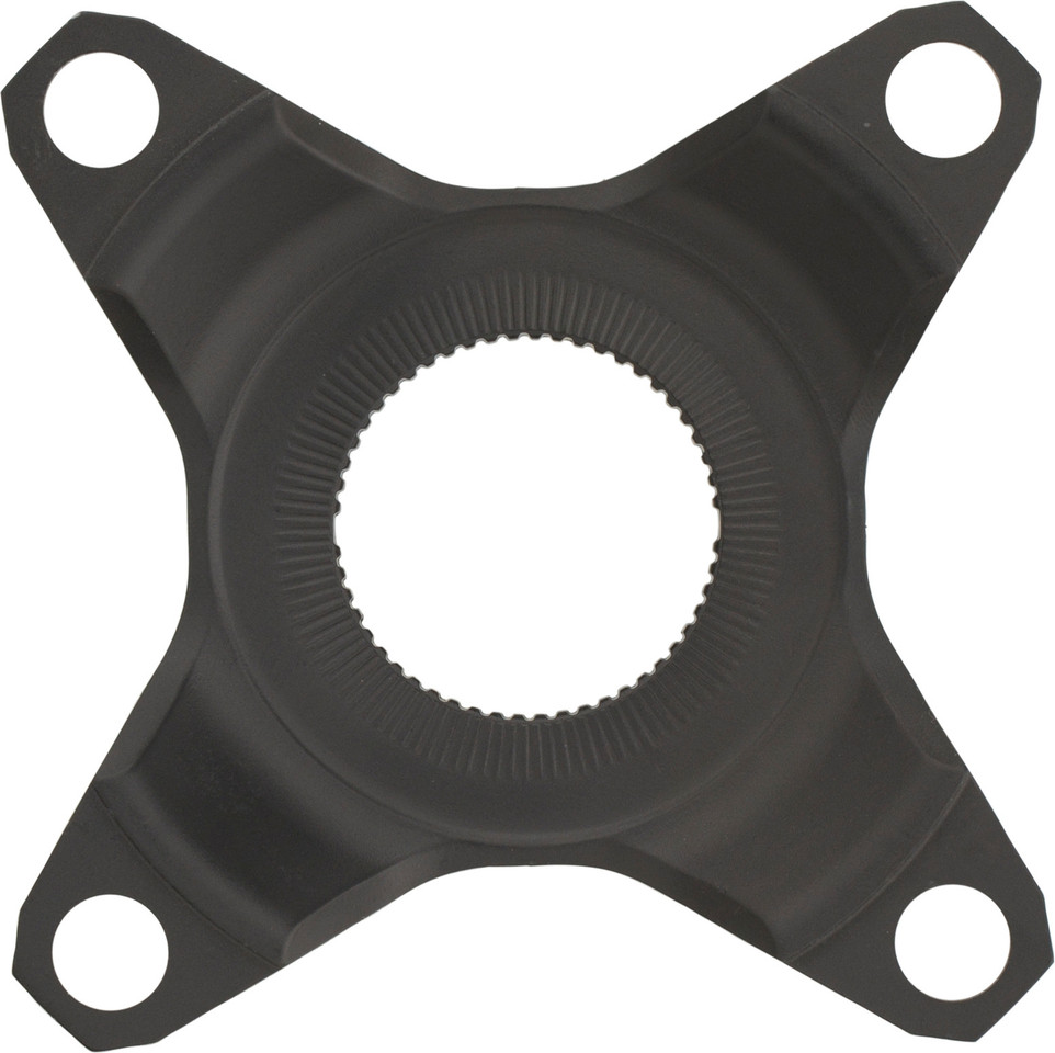

I do, but I am using the original one because I have fitted a 32t chainring. My reason to install this spider was to be able to replace chanrings easily just with 4 bolts, not for changing size :D
My opinion is that a 34t should fit, but cannot guarantee this.
Hi, How did you manage to fit the chain guide with the Shimano spider? When I do this the spider hits the chain guide and gets stuck?
Thanks

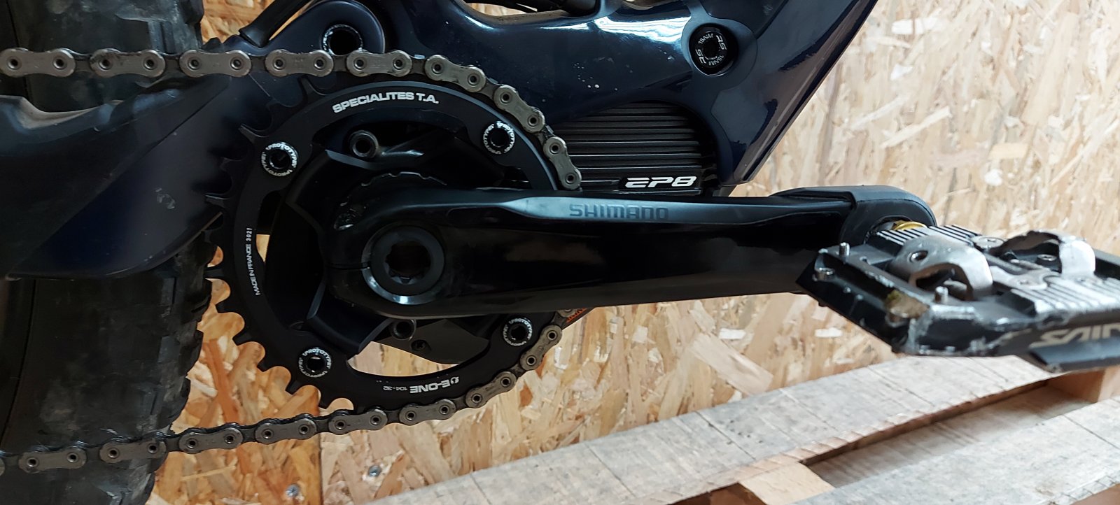

E*thirteen 32t is out of stock. Only avaliable on june. Solution to keep the customer bike running: Shimano CRE80-B spider and TA Specialites E-One chainring 32t. CD-EM800 chainguide on its way because customer want it.
