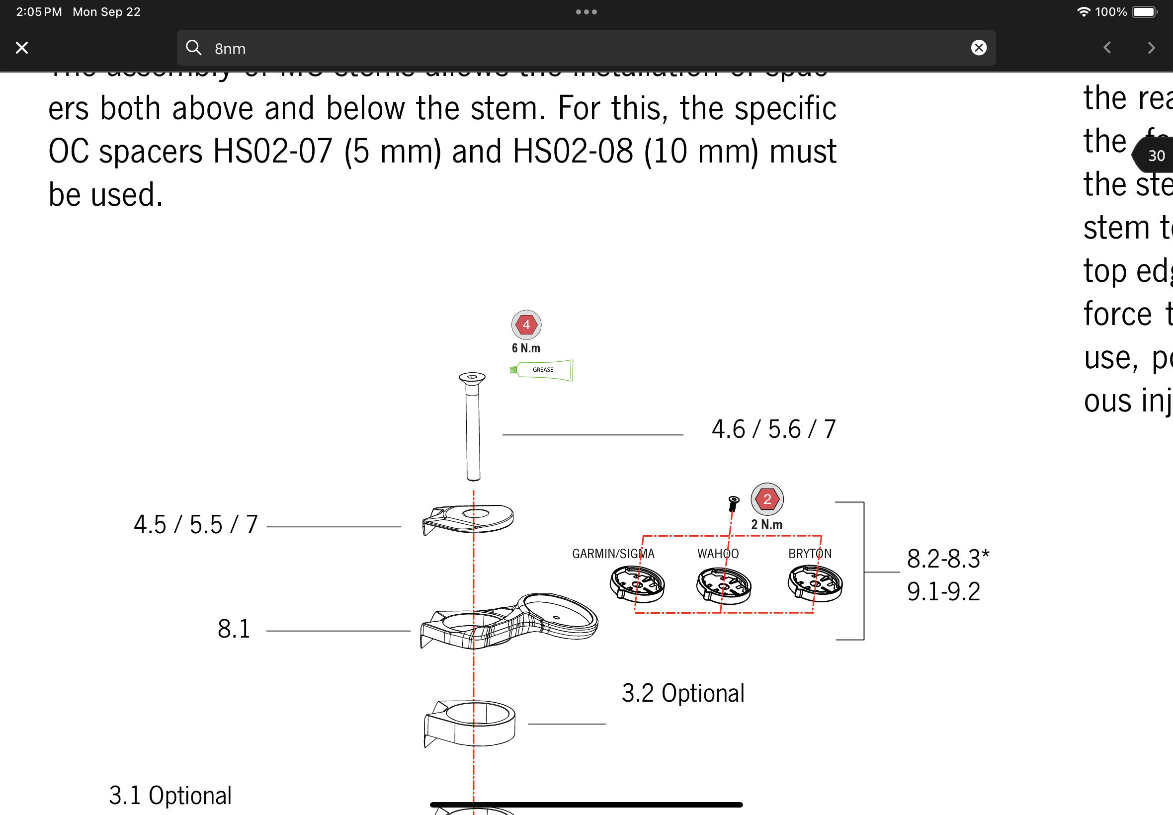

Thanks for this - I think it's solved my creaking noise! I took my bike to mechanics at two different shops to check the headset because of a creaking noise, and both said it was good. The Orbea Blue Paper for 2023 M models says 8Nm, so I tightened to that (it was only about 3-4Nm before) and after a quick test ride it seems good!
Also, replace the star nut regularly , its a 3 piece item that may appear to be working perfectly, but , the 2 claws can work loose and the shaft bit can also become loose and or flex but still function ,[ i recently bought the tool and some starnuts[few $] and replaced one[for no reason] and the steering felt much more solid, so ????
Rise 25 - 8nm (not 10 as up thread) but that seems to have solved it. There was a lot of turning and creaking beyond what I’d considered “headset tight” before it reached the torque setting.

I have a 2023 Rise H10. If im understanding correctly, I should preload the headset by tightening the top cap bolt to 8NM, then tighten the stem bolts to 6NM. It sure seems tight, when turning the bars side to side. I don’t have internal routing. I found a torque setting in the manual that says 6NM. Im so confused!
6nm is way to tight for the top cap!
Just tighten the top cap until there is no play, or tighten it until there is some resistance when you turn the bars and back it of so the resistance goes away.
The 8Nm spec for the top cap is for the M model bikes (carbon frame, and different headset). However, now that I've had more time with this, experimented, and replaced my lower bearing, I agree with the comment from @Silent_Jay that even 6Nm is too much (and I have an M bike where the spec is 8Nm).
