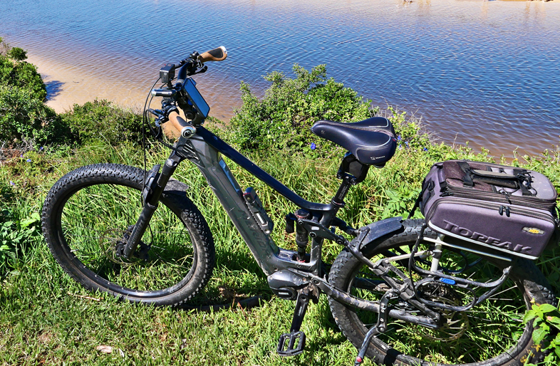

As a 70 yr old dude my eOne Sixty is set up for long tours, not track work. I had the 2018 model, now have the 2020, and a 2021 order has landed and I should have it soon.
The two main mods I've asked for is a Di2 system and swapping a 27.5 for the front 29'er. I want to reduce the overall footprint of the bike when its being carried by car so less is sticking out at the side. Yeah, 3/4" aint much but it helps and I'd rather a more compact frame overall for the kind of riding I do and blog about.
Two Qs here: are there any disadvantages in reversing the mullet, given that the bike frame has been designed around a 29" front?
Second, has anyone put a Di2 electronic shift on a Shimano ebike? Theres a lot involved, but with arthritic finger joints I think I'll use my gears more and power less.
For the same travel and tire width, a 29” fork and wheel is almost a 40mm difference compared to a 27.5” setup (~20mm fork and ~20mm wheel/tire radius). I’ve seen a 27.5” wheel on a 29” fork. That alone will drop the front end about 20mm with an obvious change to headtube angle and stack height. To keep the front end height close to stock, you’d need to increase the stock fork travel by 20mm, or 10mm with the addition of a 10mm spacer-type lower crown race for the headset. That would retain most of the stock numbers but the trail measurement would still change due to the smaller wheel size.

Thanks for the detailed info; I guess its a suck it and see situation. For my kind of riding 20mm may not make much of a difference. If it does, I'll talk to my suspension expert about the addition of a 10mm spacer.

Looks like you’ve got a fairly tall fit as is, so the smaller front end will increase your need for a higher rise bar & stem combo. As for the frame numbers, the 20mm will likely decrease the HTA & STA by 1° as well as lower the BB height 8mm or more.

Wow; you know your stuff Chris! Thanks.

For those interested in the two queries I raised, I now have my 2021 eOne Sixty EP8 and can answer them myself.
First, the Di2 is available only as an 11 speed and fitting it to an eOne Sixty would require a rebuild. Not worth it; Shimano will releae a 12 speed over the next year or so, and it will be a simple upgrade for my ebike.
Second, the decision to get the eOne Sixty minus a mullet has paid off. The bike steering is sharper and the overall feel of the bike is more organic/responsive without the 29er; downhill crashers may feel different but for my riding its been a good move.

For what its worth, I had the mullet in the 2020 eOne Sixty and always felt it had an over-sized front end with heavy steering. Now that I have a 27.5 the bike feels more in scale and the steering organically precise. I like it and will not go back to a mullet...but then again I'm not a down-hiller which is what its probably been designed for.
