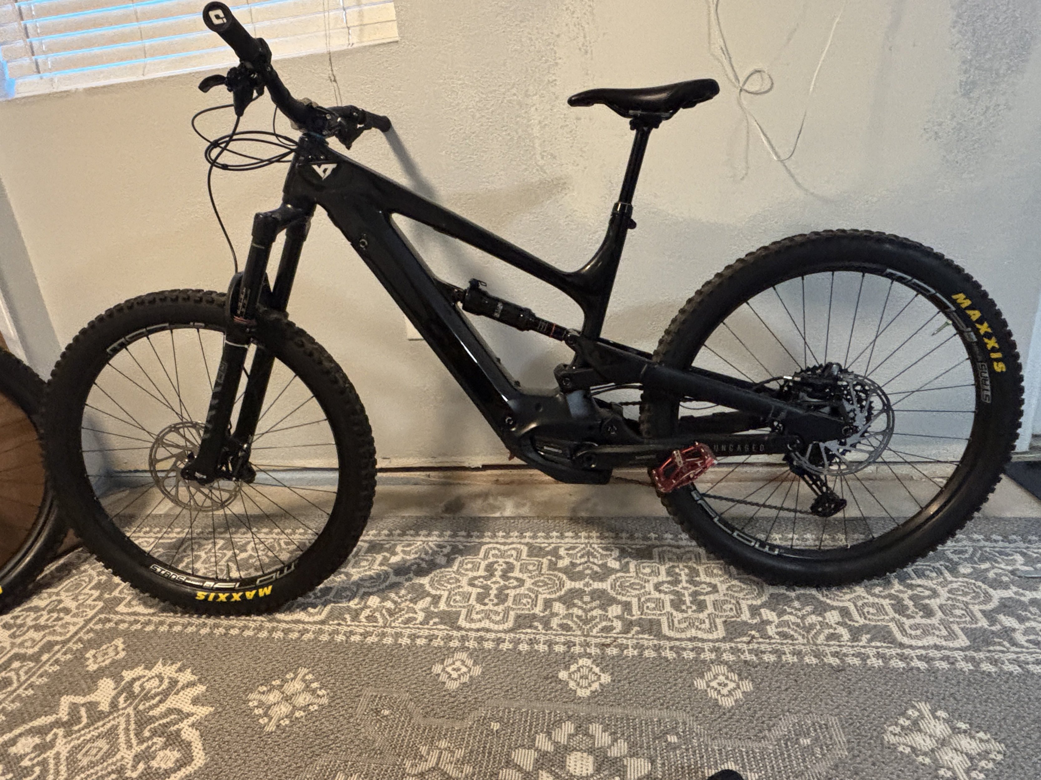

If you are wanting a lower extender like the Wolf Creek 10mm (cannot find them anywhere), Niner bikes makes a 15mm one for $20. The 15mm allowed me to get rid of that crap Acros Block Headset. It also let me play around with converting my 2022 Full 29 Decoy (Size Large) into either a Mullet or a complete 27.5 bike with the factory 150mm fork. I have measured the 2 most impt geo specs I believe when making these kind of changes (HA and BB Height). Yes, starting with a Mullet config is better, but when a 29er is what you got, its what you got.
Factory Specs (Full 29er)
HA 65.8 / 66.3 (Low/High)
BB Height 338/345 (Low/High)
Mods to my bike
15mm Headset Extension (Niner Headset - ZS Lower Cup)
Rear shock changed from 230x60 to 230x65
Bike is set in High Position
Mullet setup Geo
HA = 64.2
BB Height = 342
Full 27.5 Setup Geo. If you put on a 160mm fork, it would slacken HA about 1/2 degree and raise BB into 340s.
HA = 65.4
BB Height = 336
View attachment 152955 Full 27.5.jpg View attachment Clearance Fork to Frame.jpg
Mods to my bike
Mullet setup Geo
HA = 64.2
BB Height = 342
HA = 65.4
BB Height = 336
View attachment 152955 View attachment 152956 View attachment 152957
