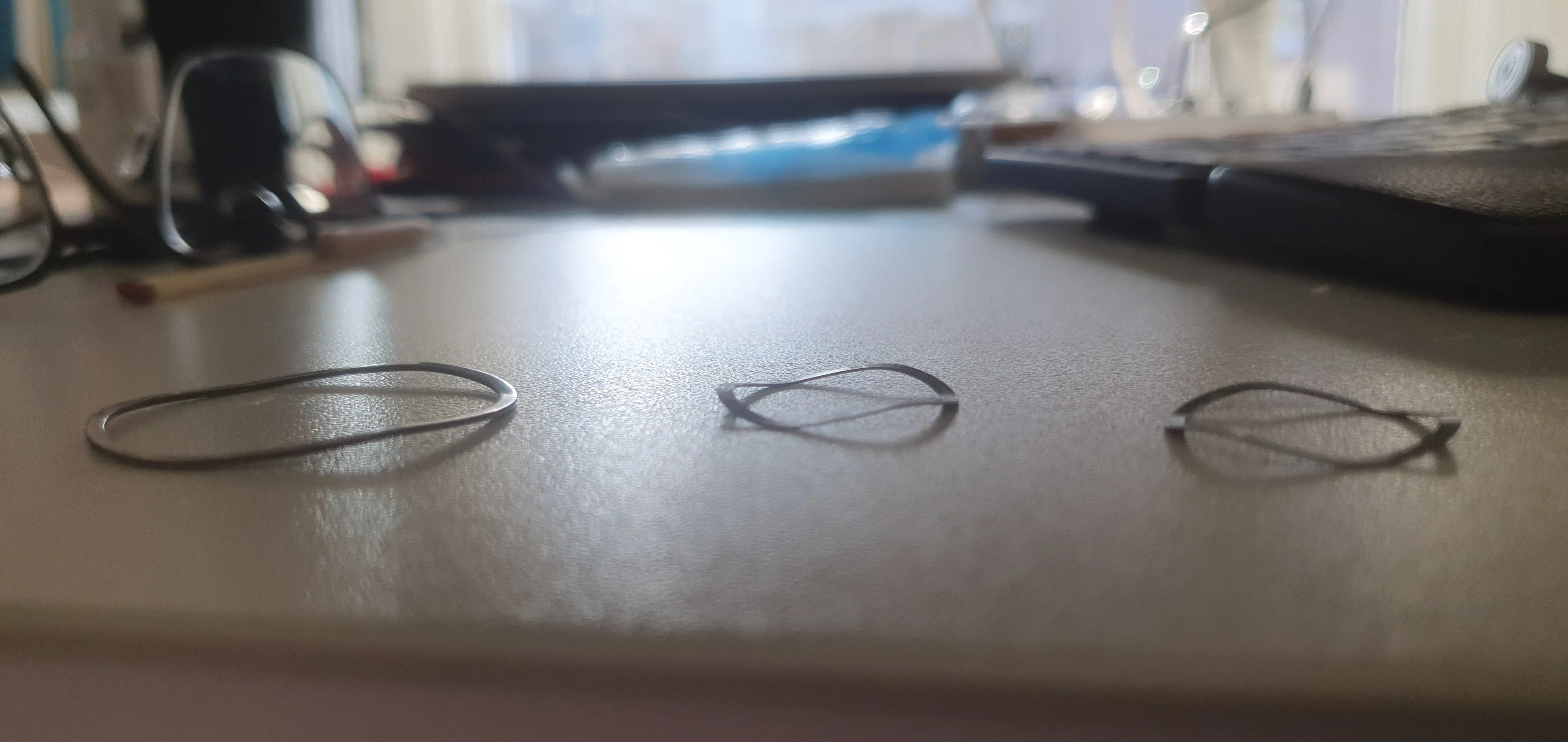

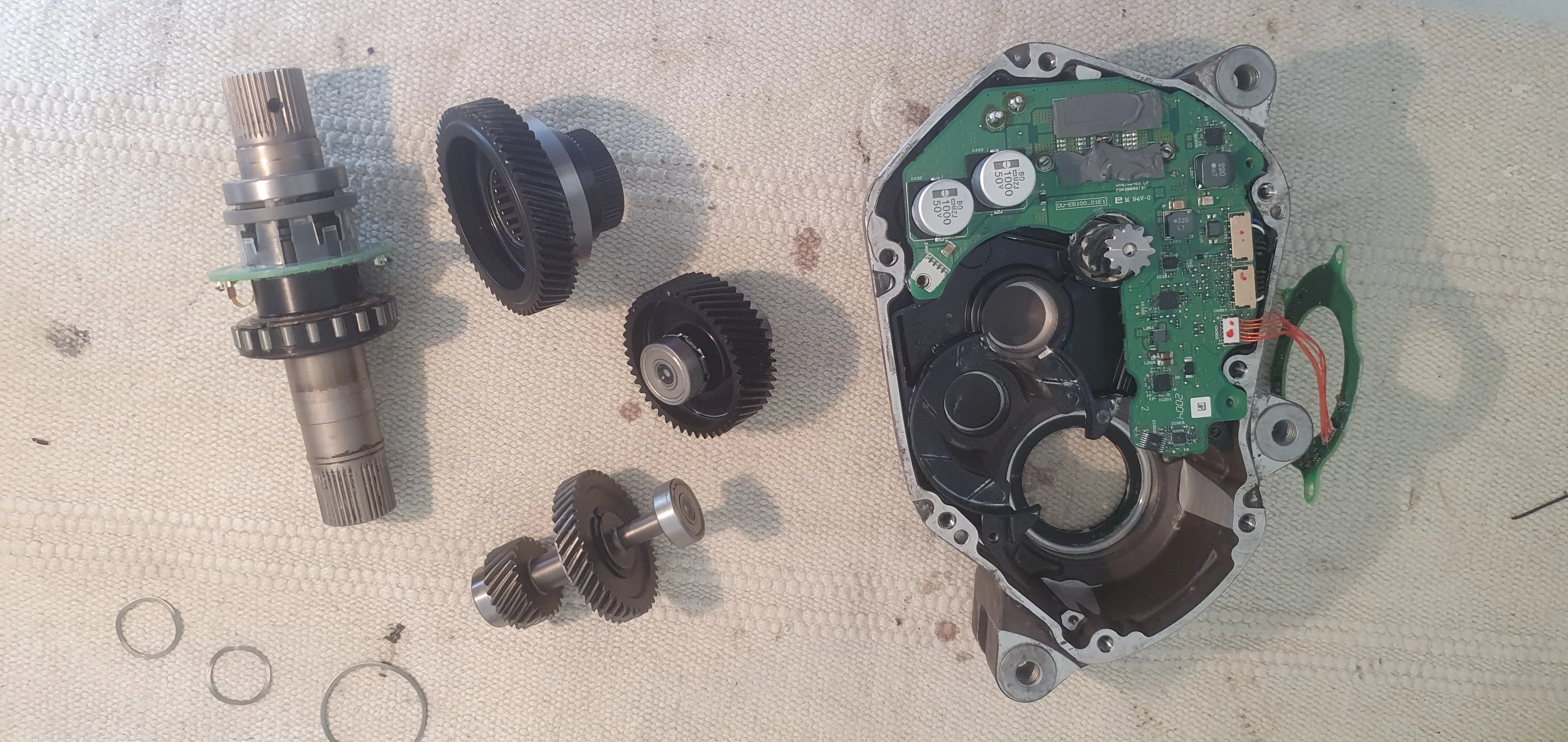

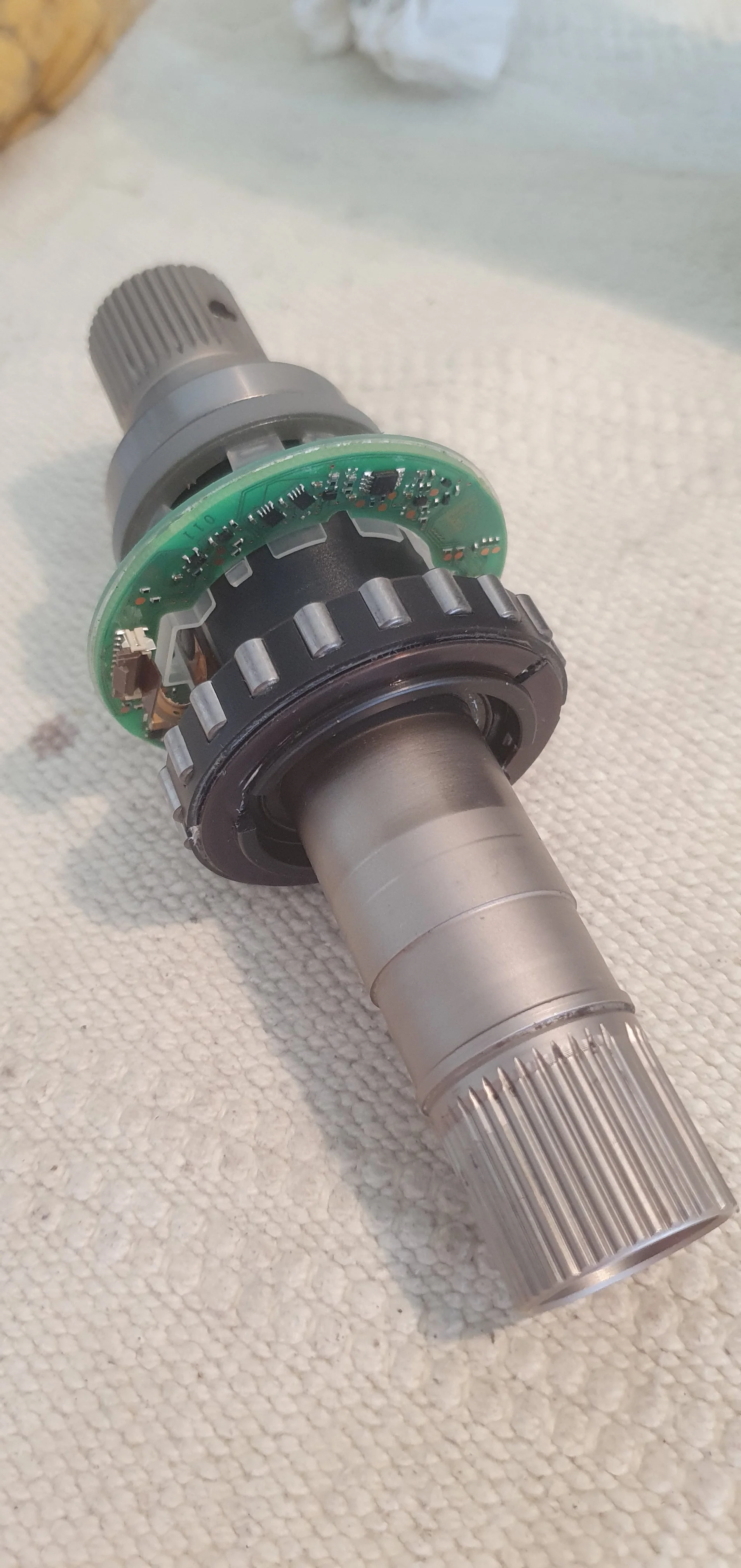

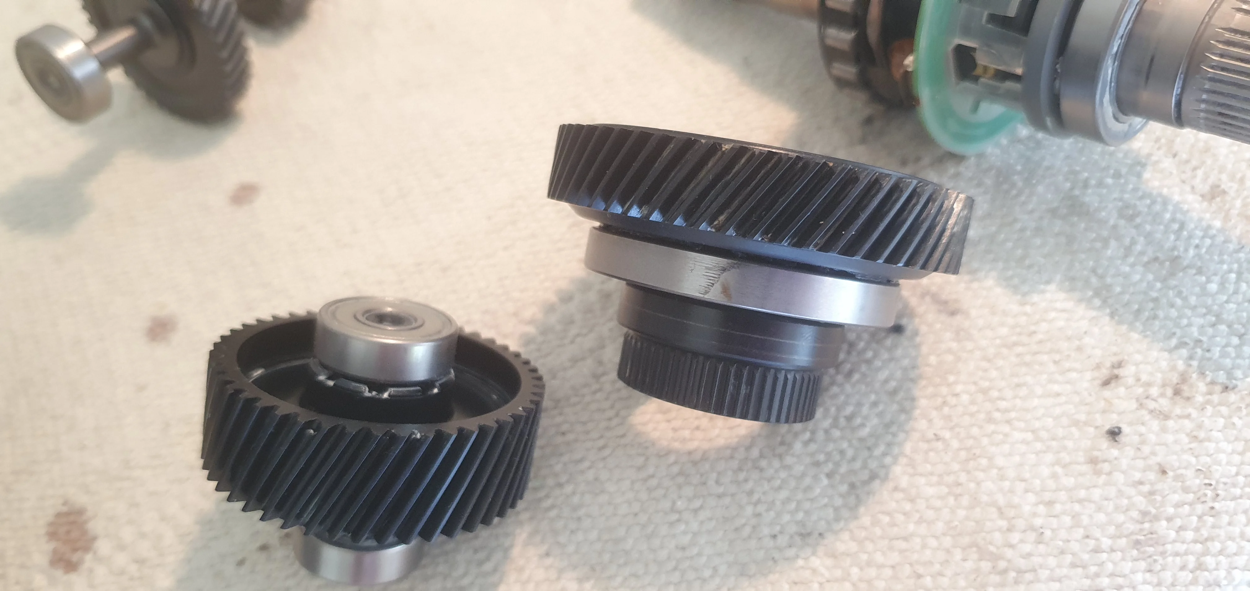

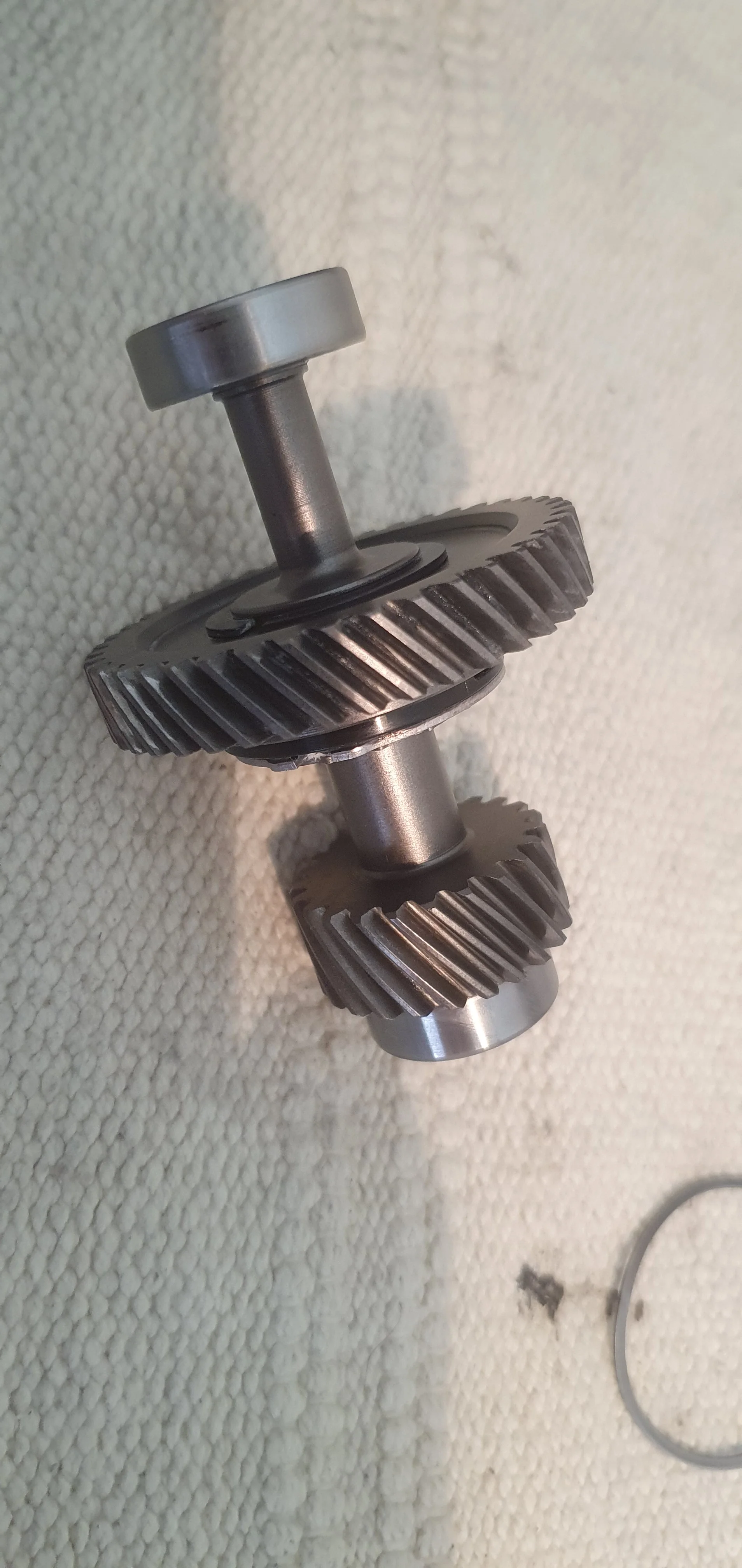

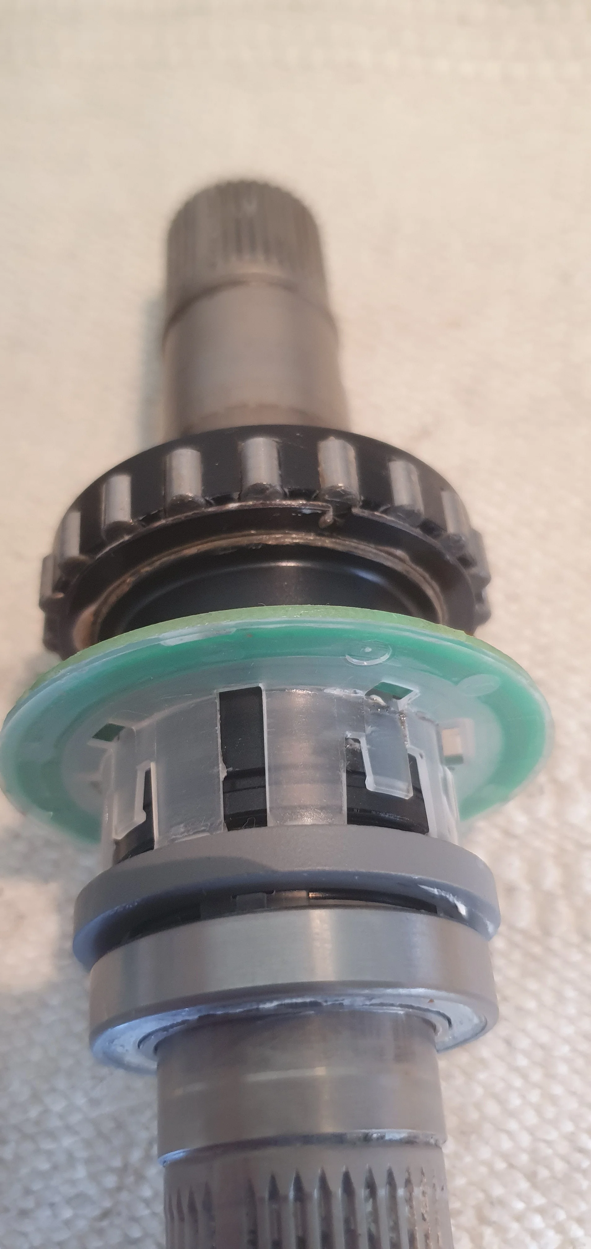

It is my first time messing up with an electric motor but I tried reparing first. After disassembling it I can't see any problem with bearings or the nylon metal gears. I thought these below are distorted shims, but apprently they supposed to be like that. Or perhaps clutch assembly with the roller bearing but I don't know if it is worn out.
I've posted more pictures below. What should I do? If I just replace all the parts metal and nylon, bearings, clutch assembly the price would be more than 250 eur and I'd prefer to get a new motor. I can get just a new clutch assembly for 100 eur, but as I say I don't know if it is the source of the problem. Should I perhaps disassembly that roller bearings and clean them? Can anyone tell how this is done..?
Many thanks for your opinions...
If the main crankshaft bearings feel fine then it may not be the motor. Those two would be the two to change and put it back together.
If after that it’s still noisy time to check chain, cassette and chainring.
Thanks Benny, I need to change chain and both chainring/sprocket anyway, the back wheel with gears is realtively new (changed a year ago). I'm thinking about greasing the motor putting it back with new chain, etc. and doing more testing. If it still feels like it's motor then getting a new one...
