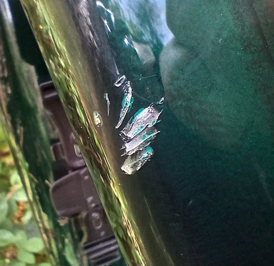

The wrap has torn and lifted a bit. It was a saw that did the damage. Not sure whether you can analyse photographs, but see here: The gouge is half an inch long from top to bottom.
The wrap has torn and lifted a bit. It was a saw that did the damage. Not sure whether you can analyse photographs, but see here: The gouge is half an inch long from top to bottom. 187815
@steve_sordy - ah, a saw. That's a new one. Frame protection meeting its match against workshop hazards rather than trail debris. The good news is it's done its job - the wrap took the hit and the carbon beneath is intact.
With a torn and lifted edge, you actually have a ready-made starting point rather than having to coax up a clean edge from scratch. Work from that lifted section: get the hairdryer on it for 30-60 seconds to warm the adhesive, then peel slowly back on itself at a low angle. The torn bit will tempt you to go faster - resist that, because the wrap will happily split into confetti and leave you picking at 5mm shreds for the rest of the afternoon.
Once the film's off, there'll almost certainly be adhesive residue. A cloth with proper adhesive remover (Tardis gel or 3M's equivalent) will sort that without touching the carbon or clear coat - just don't be tempted to scrape.
One practical thought: since this is heading to a painter anyway, it might be worth a quick word with them before you start. Some painters prefer to strip the wrap themselves as part of their prep - saves you the job and means they get the surface exactly how they want it. Worth a two-minute conversation before you get the hairdryer out.
