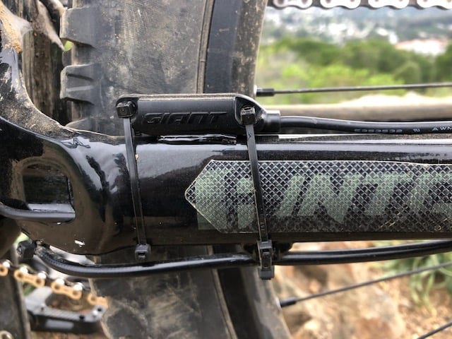

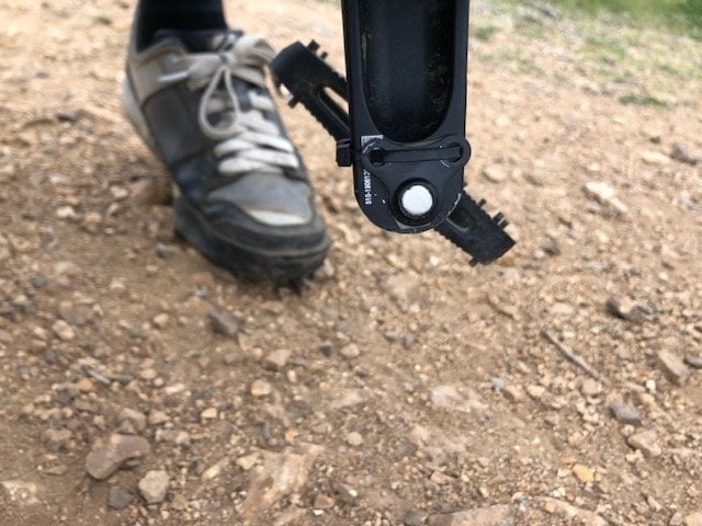

This is for the 2020 Giant Trance with the speed sensor magnet bolted on the rear rotor. I moved the sensor and placed it on the left chainstay. Orientation is important for the sensor to pick up the signal (see picture). Mounted the magnet to the tip of my left crank (again, see photos). So far it's working well without errors.
Edit: {5/3/2021 Still working great only thing is I get the red light about 1-2 times per 2 hour ride. It keeps working at a 3 level mode so I can wait till a downhill to simply turn it off quickly back on. Generally it is good then. The other day on a gnarly technical ride it happened 2 times in a row in about 4 minutes. After that it was good the rest of the ride about another hour in the 2 hour ride. Only mistake I have made was when it happened a few days ago, getting off the bike and pushing the magnet very close to the sensor. So of course it started it's lurching thing. Moved it back to OEM spec distance and it was fine again. Again, if you are really technical and like dropping motors, put a volspeed in (don't do it if you don't have a display because it needs some babying and has to be turned on every time you turn on the bike. I have one on my Bosch motor and it has been rock solid (but I also did not have to drop the motor to install it) Volspeed is the best I have found for unlimited top end. Only thing I have found is it occasional forgets the setting and I just got into the practice of re-initialing it every hour or so. IOW, just as easy to deal with the red error light 1 to 2 times max per ride.}

Only thing I would advice, it may take awhile to get the magnet perfect and it may throw error and stall like a horse trying to head back to the barn on a trail ride at dinner time. IOW, maintain maybe just a little closer than the spec it has for the spoke. (I used the oem magnet with a couple of mods and mounted the sensor under the chainstay and had measured the exact distance the 2 were apart when the magnet was on the spoke. I got it pretty much within a mm or so of that exact space. Too close and it will stall, to far away and it will error. YRMV )
