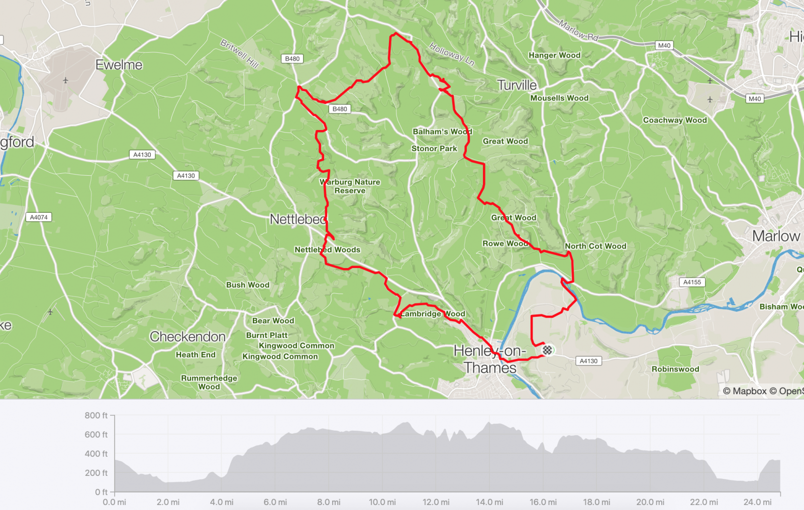

What the best settings for the app, I'm only managing 24 miles and the last bit up Remenham hill is a killer when its dead , see the ride below maybe im asking a bit to much
Nick
What the total elevation gain?
What mode and settings?
mostly in eco setting are factory as my app won't work !!! it does today i had to do an update , so i can change the settings now any tips
It's not terrible. I did 19.3 miles with 1939ft elevation gain in Tour (Bosch) on 80% of my battery today.
