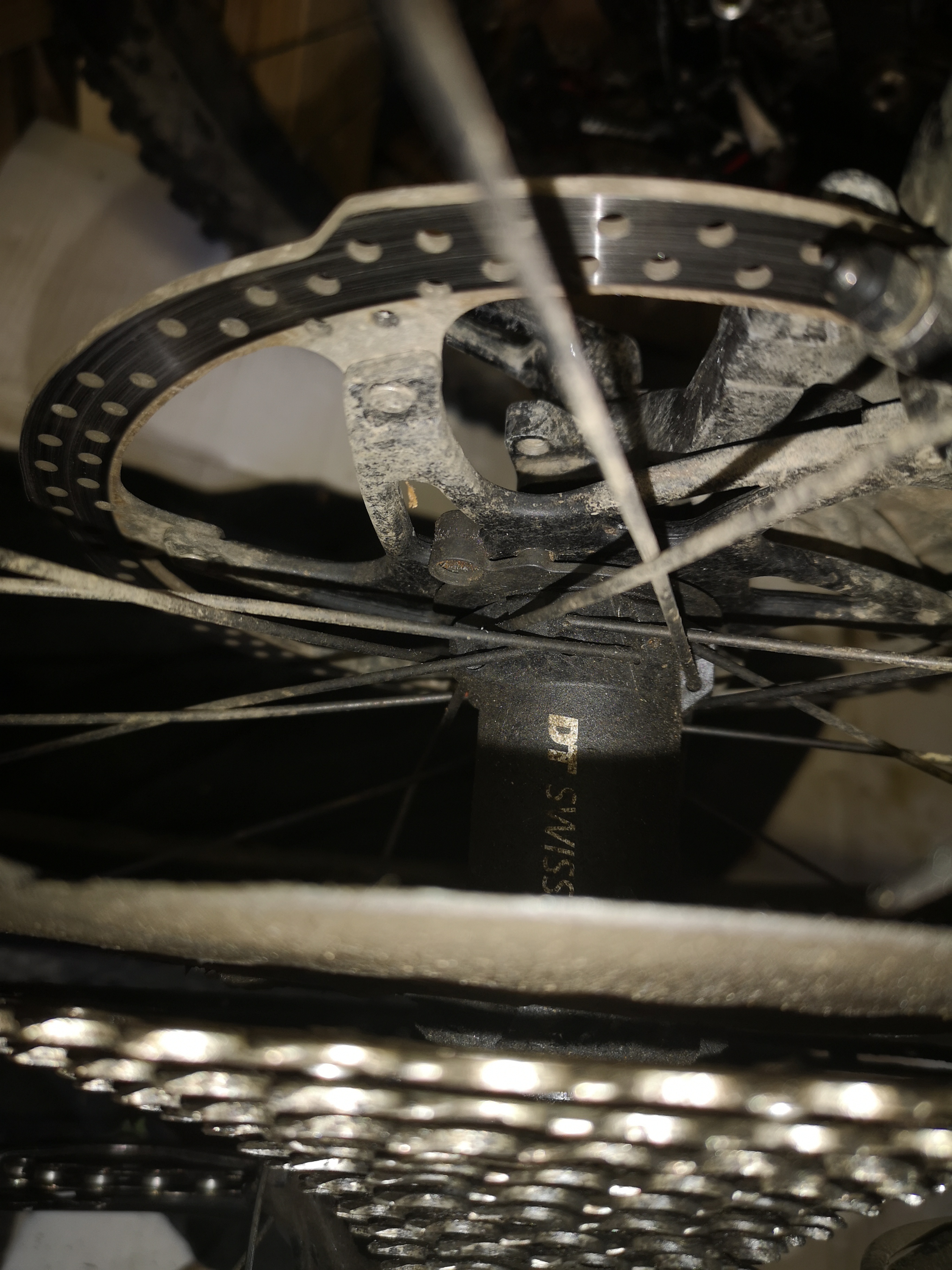

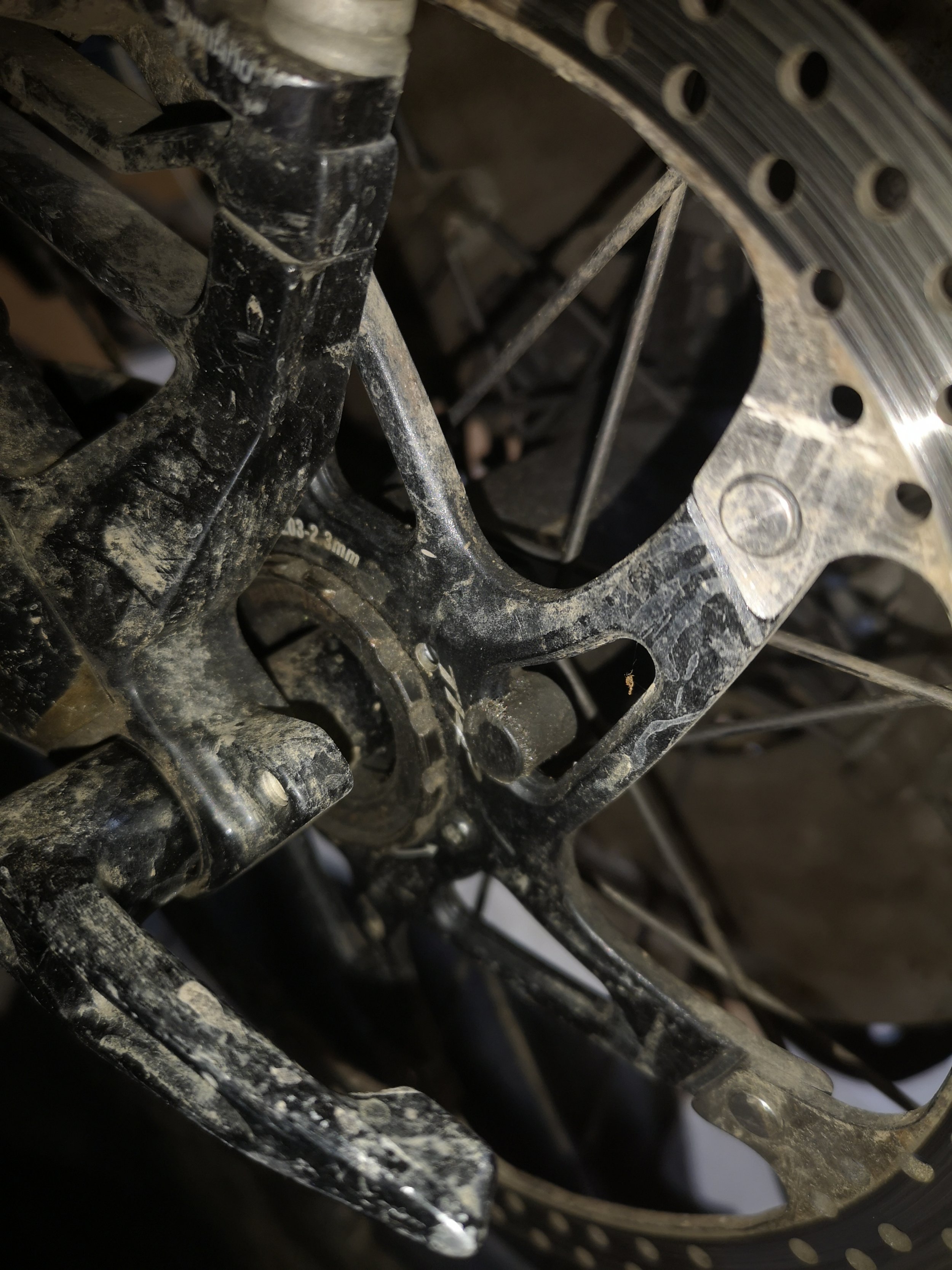

I refitted the shimano magnet to some TRP disc's when I replaced my rear wheel with a dtswis one.
Just used a round file and drilled a couple of holes for the mounting plate.
