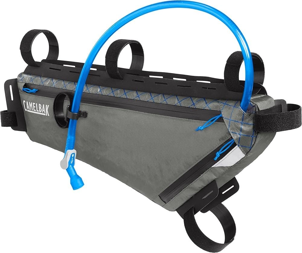

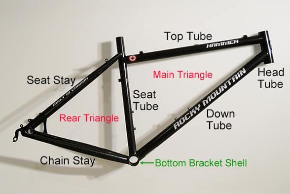

Interesting because I was thinking of the Camelback Frame Pack. It would likely only fit under the Down Tube so it would not be as secure as under the Top Tube inside of the Main Triangle. But it would have an inner tube and bike parts so not likely as heavy as being full of water, which is what it was designed for.

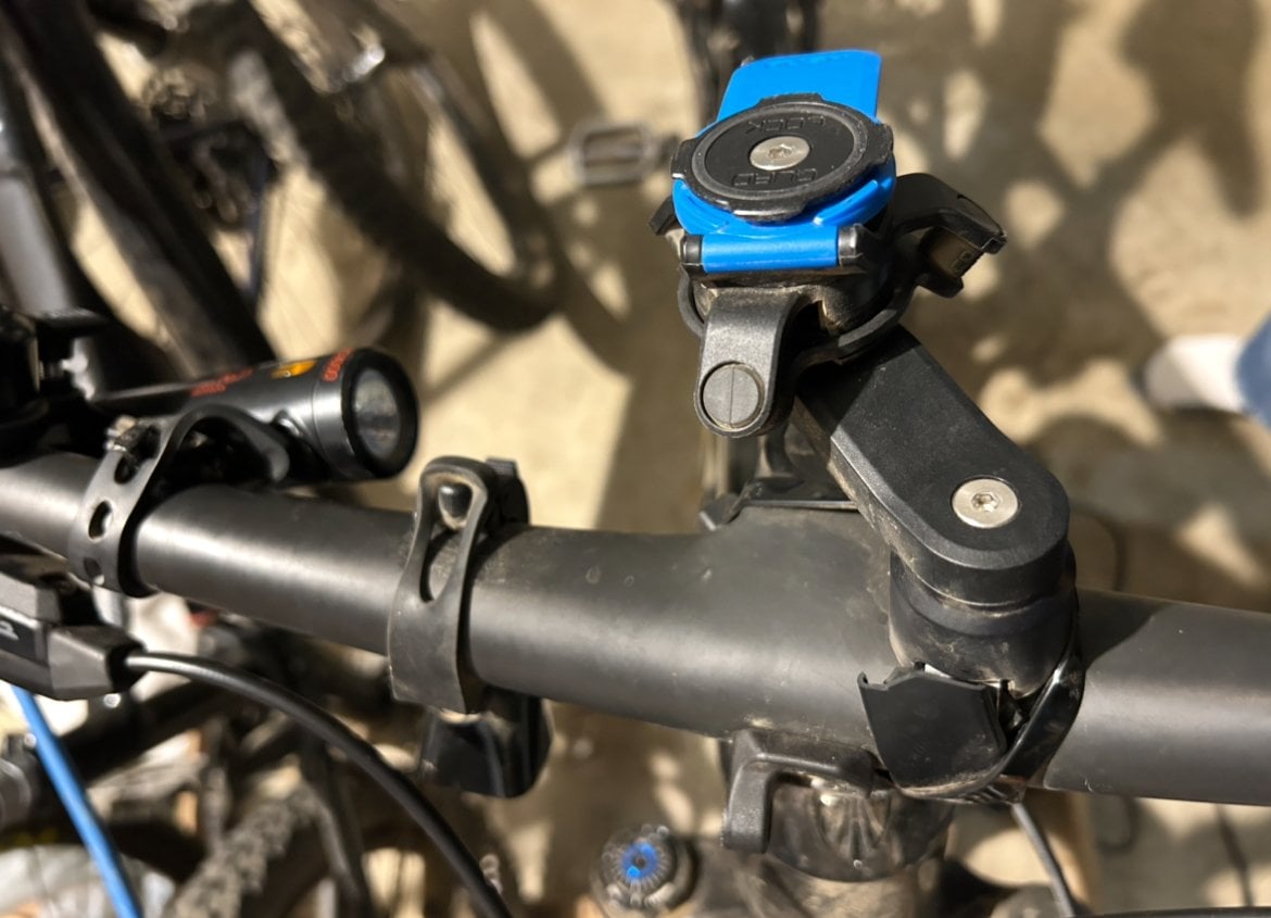

By the way, my IPhone is set up on a Quadlock using a motorcycle mount secured on the Rail’s oval bars using their Roll Cage Hose Clamp and a thick ziptie. In the pic are also a Timber Bell and a light turned parallel to the bars. I run four such lights. I turn them sideways when not in use.

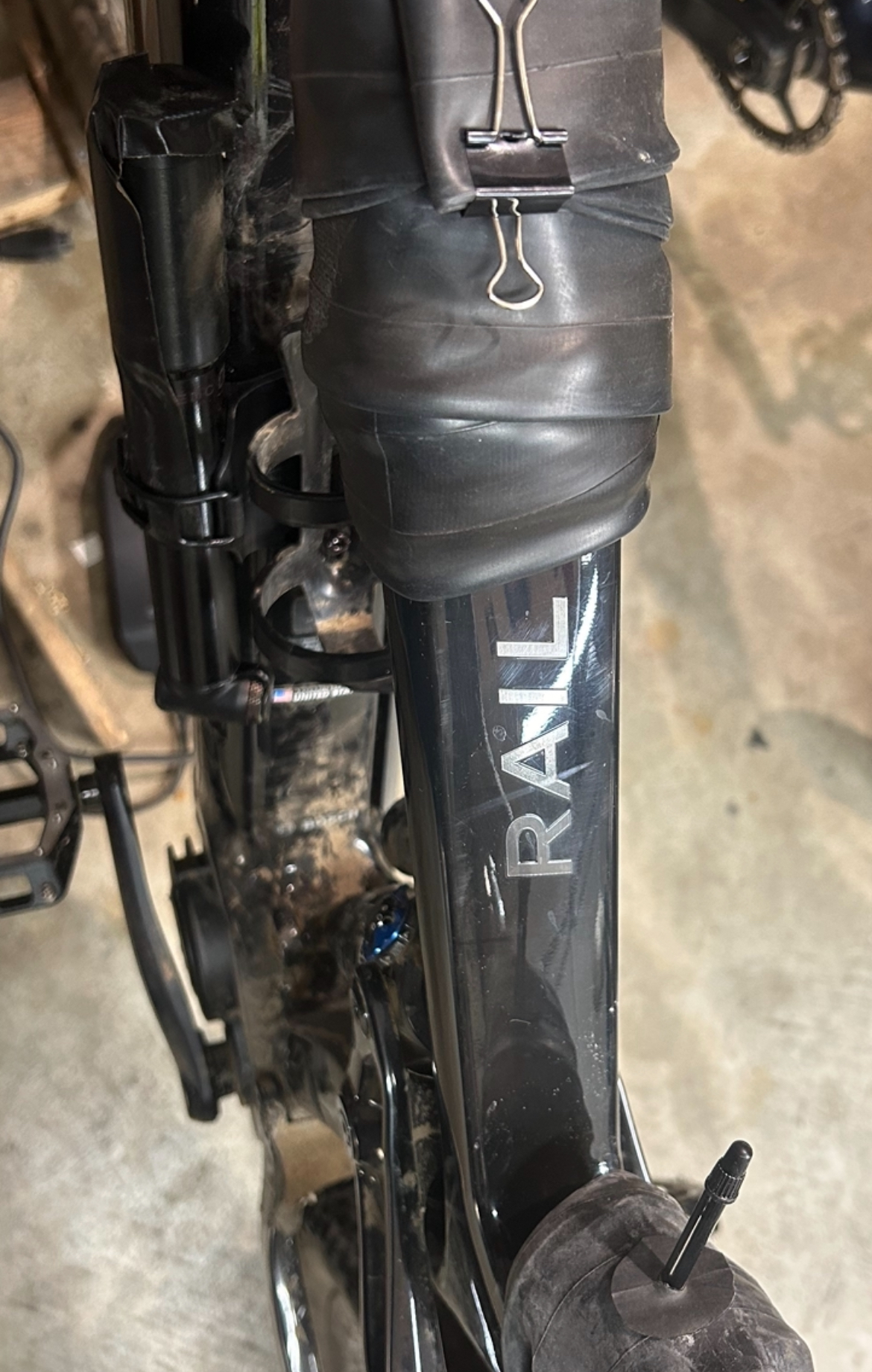

I do not like carrying things on me. I ride dirtbikes so couldn’t care less if the bike is heavy. But having it be self-contained and ready to go is cool.

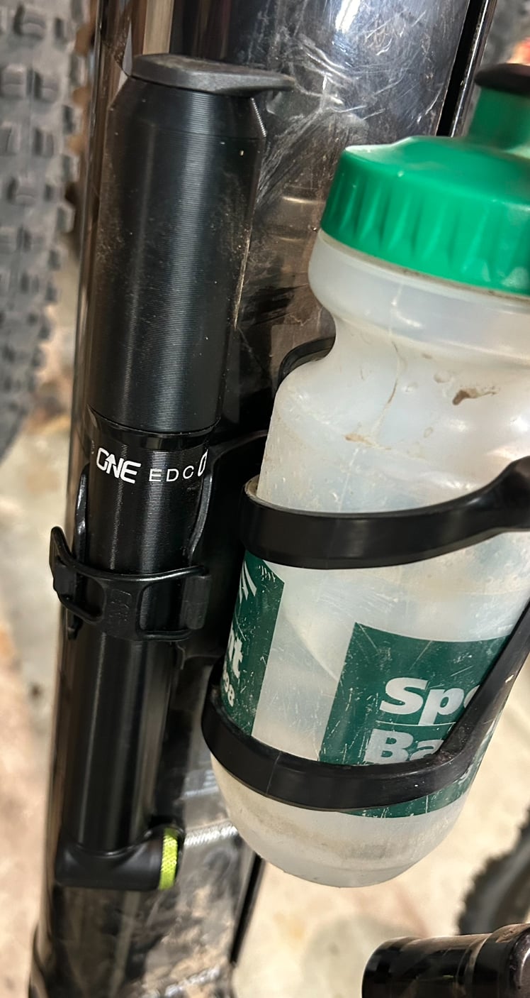

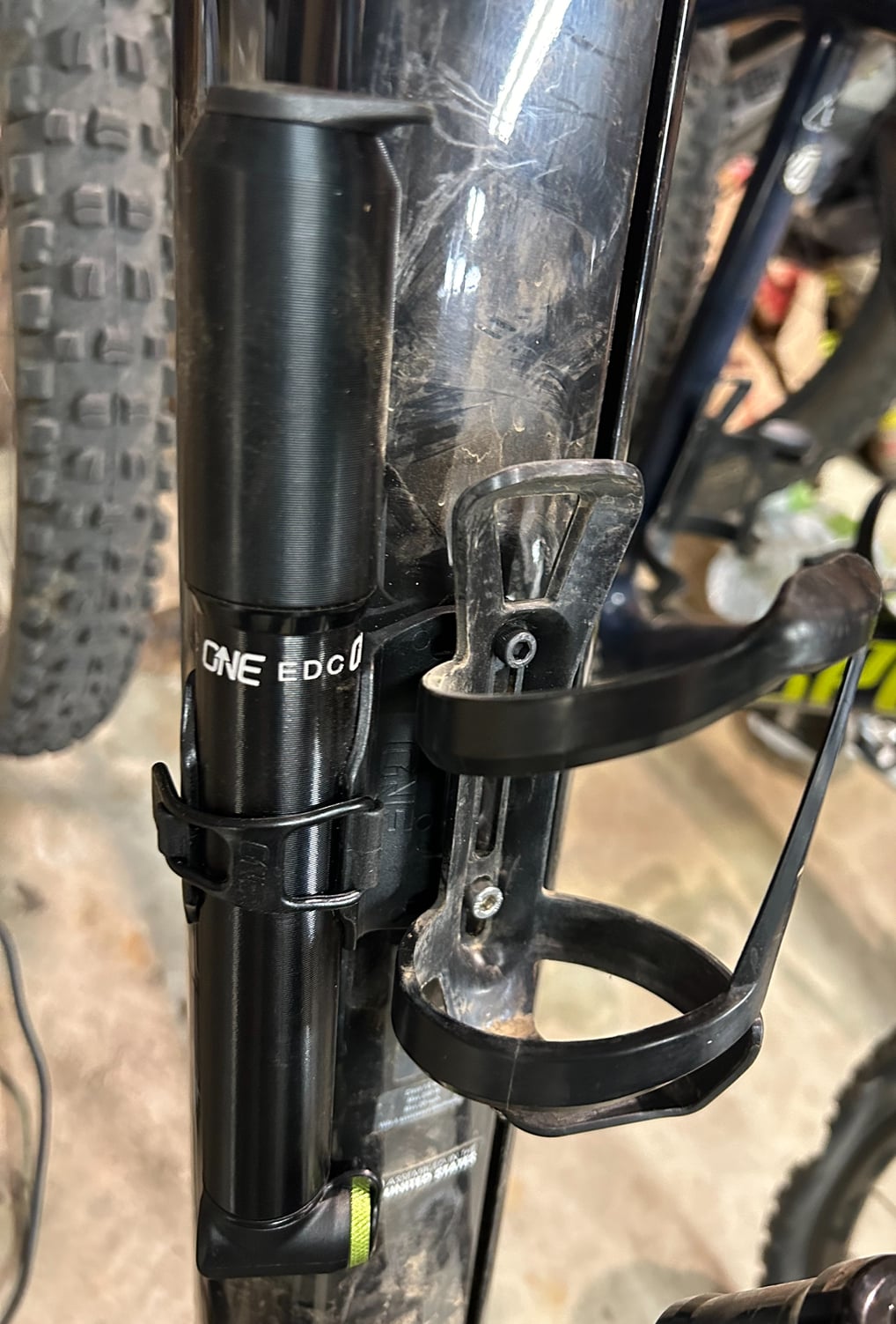

As recommended above, I bought the ONE’s EDC:
100cc air pump
V2 tool kit
Pliers and tire plugs
They all fit inside the bike pump which in turn fits on the bottle cage mounting area of the Trek Rail. I had to get bolts that where about 3mm longer. I also later taped the air pump handle to the airpump body so it would not separate while riding.

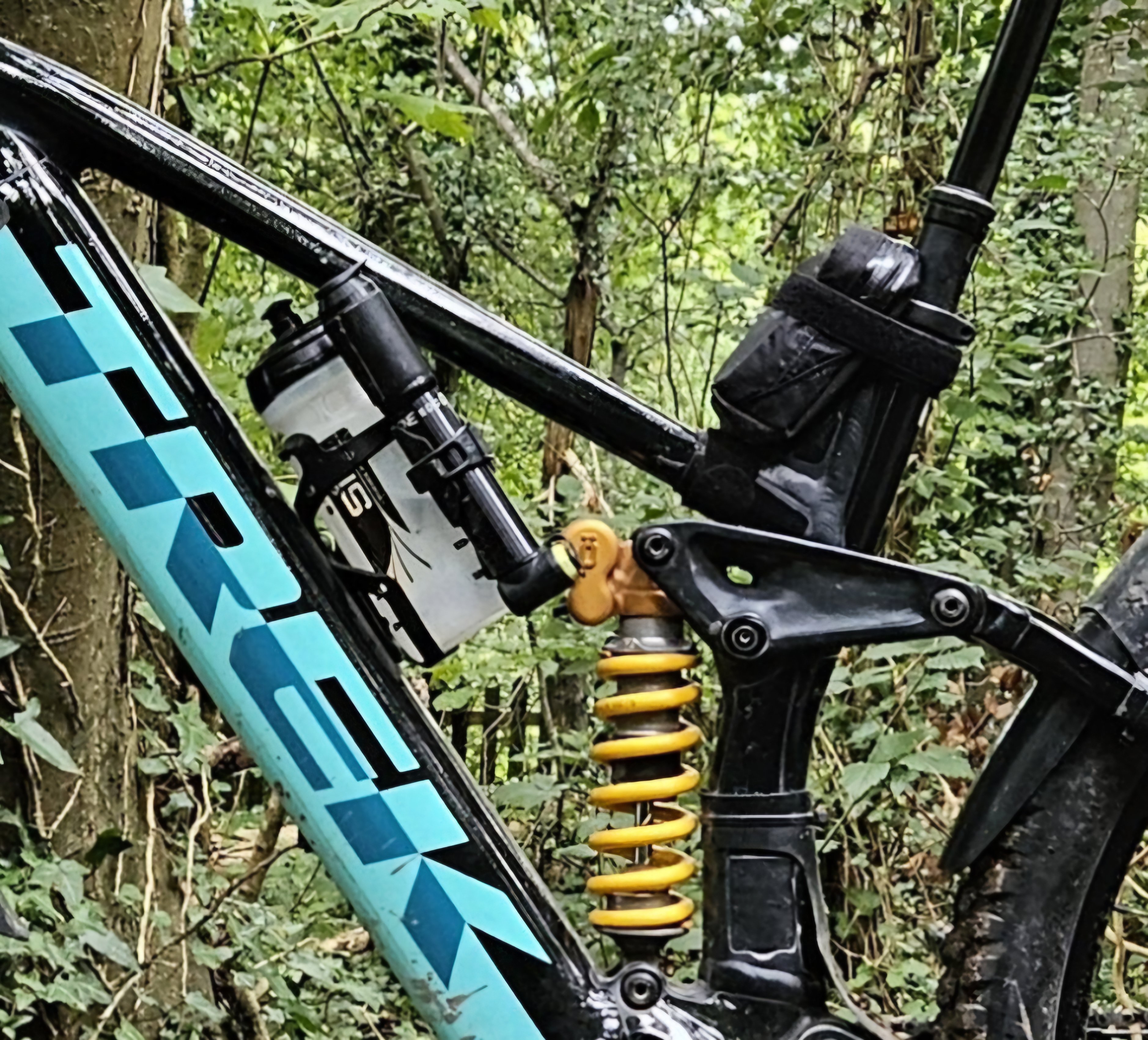

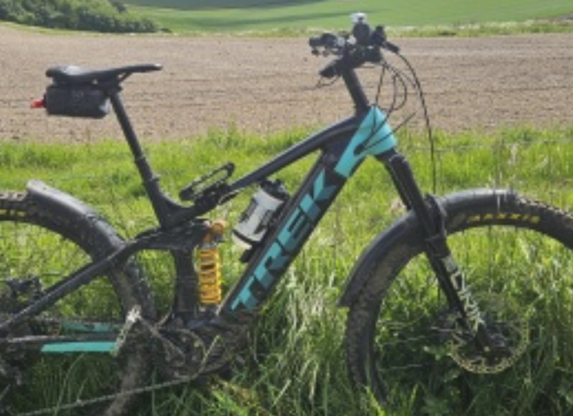

Done the same with the smaller (70cc) EDC pump on my 2022 Trek Rail. Have other stuff in a very small bag held with Velcro on top of the cross bar next to the seat tube - IIRC it's a Bontrager Elite Seat Pack/Small.
Hi irie, if I had to guess you have an aftermarket bottle cage or you drilled and riveted on the ONE air pump?
I noticed your avatar shows you used to carry a saddle bag but now its on top of your top tube and in front of you seatpost. Can you tell its lower center of gravity, and what other advantages did you notice?
And how are the mud guards working out?
1. Bottle cage is Specialized Zee II with holes drilled out to move cage higher in frame to prevent the Ohlins shock fouling on it.
2. Pump is attached with two small bolts to the top side of the drilled bottle cage to keep it away from my legs.
3. Yes, I do notice bag weight being carried to lower down - makes the bike feel more 'lively'.

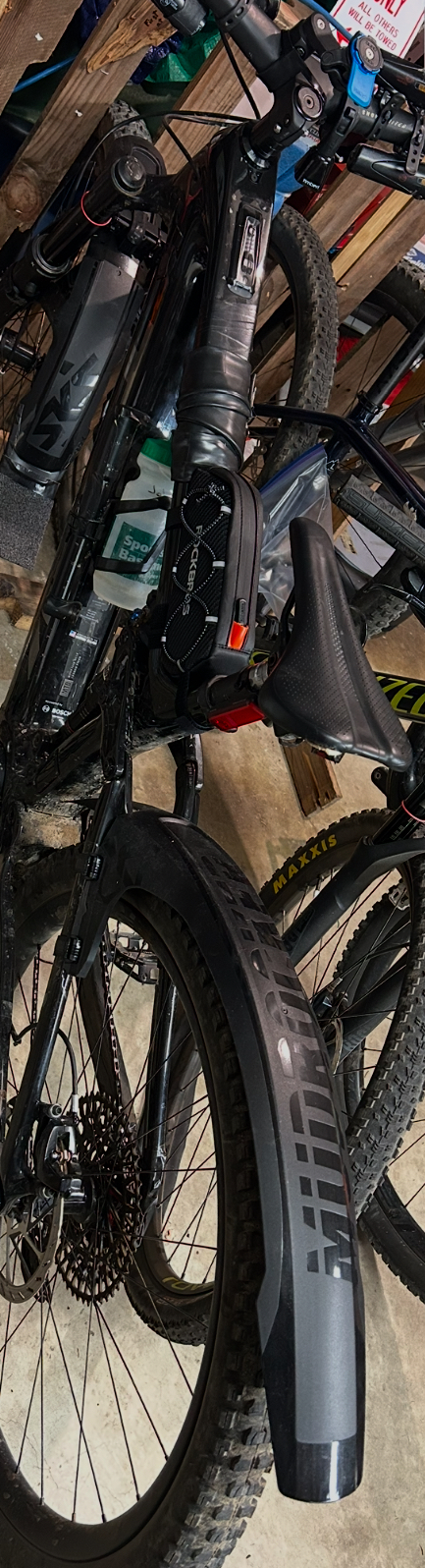

4. That's my 'good weather' mudguard. Because it's now bad weather with plenty of mud have fitted "Large Mudhugger" rear mudguard - very ugly but practical. Changed Spring and Autumn.
Hi irie,
because mud season is upon us in the northern hemisphere, would you mind posting pics of your wet setup as well? Did you have to do any adaptations to the rear large Mudhugger, and what do you use in front?
I noticed the Rail frame’s battery compartment cover has big open seams, presumably to let air in to cool the battery. And plenty of mud splashes into there. Which could block it in big enough quantities. So big dirtbike-type fenders do not scare me so long as they fit the Rail right and do not flop around too much.

One more thing, I have not bought a cool bag like you so the first inner tube I rolled then put into the same area belted by the cuttings of another inner tube and the second inner tube I wrapped around the top tube and used a paper binder clip to keep from unwinding.

Front mudguard is RRP large held on with zip ties. Rear large Mudhugger also held on with zip ties with layered tape to prevent paint damage. Both go on directly without any modification.
