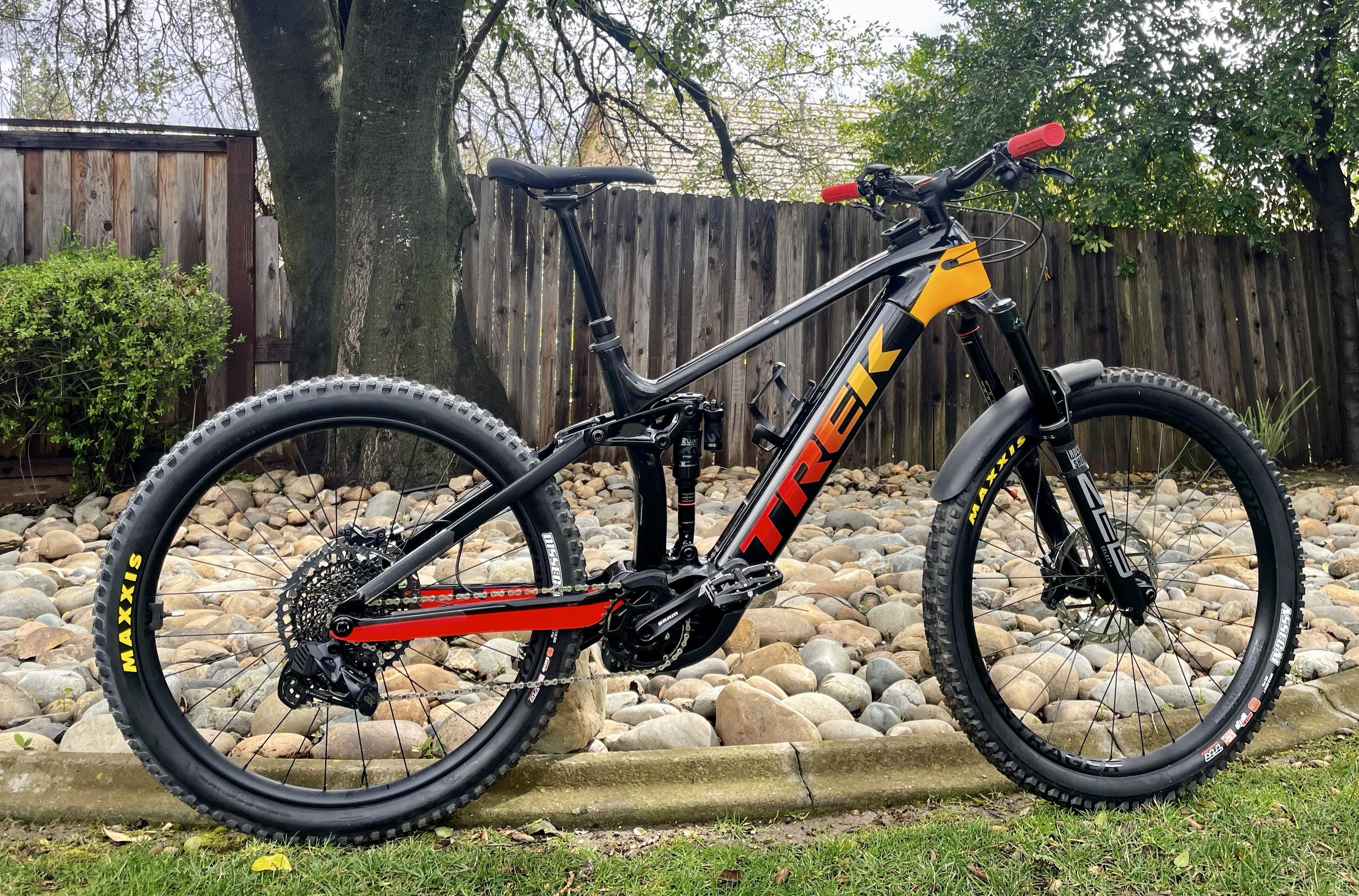

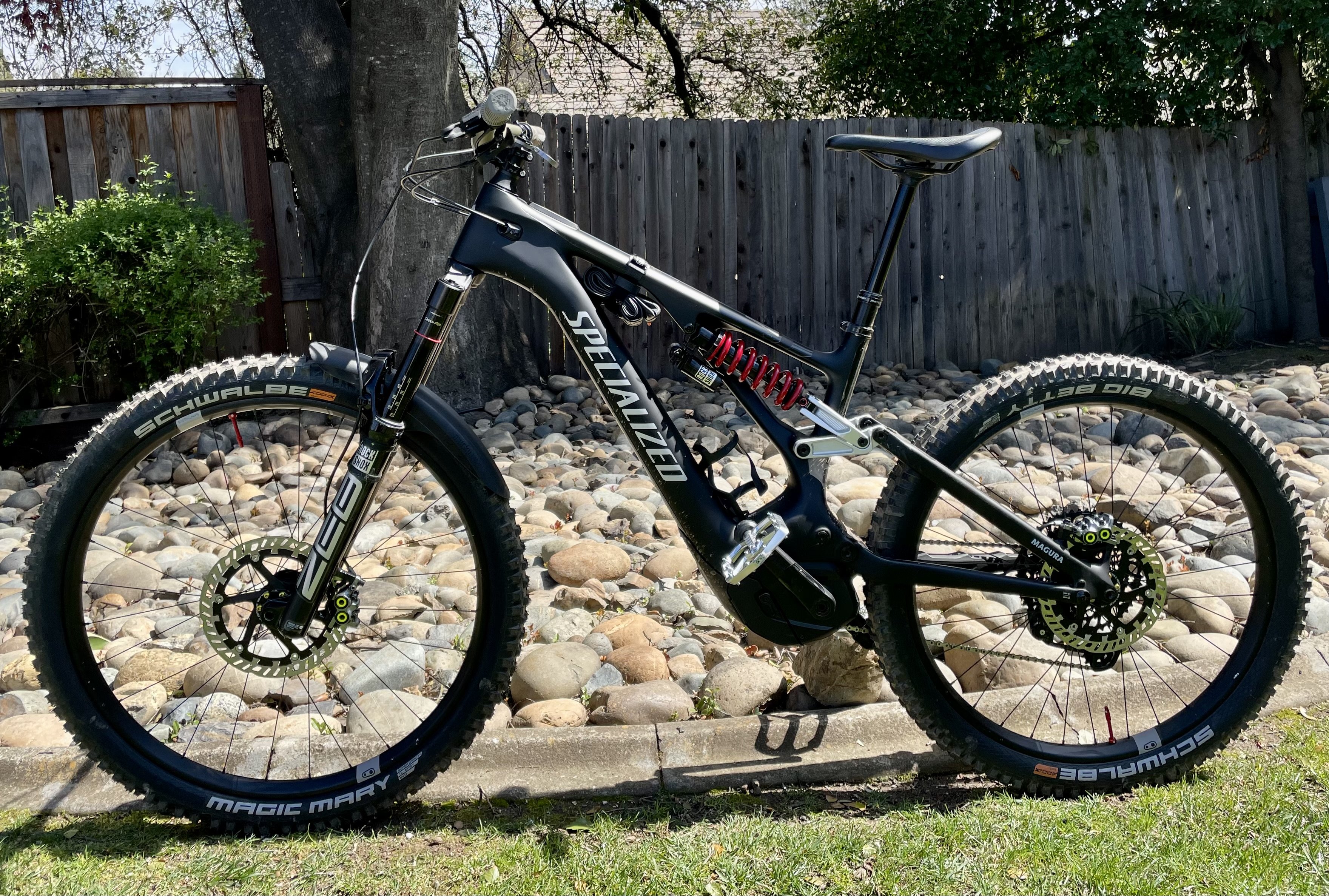

I have both in the stable and both are very different, IMO comparing the two is like comparing a Cybertruck to the Rivian
The girl that gets my attention all depending on my riding plans with the crew.
S-Levo, tech, tight single track, steeps, jumps, Levo is a 170/165 travel
T-Rail, flow, drops and feature's, oh yeah pedal day (cant beat a 29 on pedal days) Rail is a 170/150, flip chip in Low
interesting comparison, for me Levo is more capable bike, and Rail feels like a trail bike with more travel.
