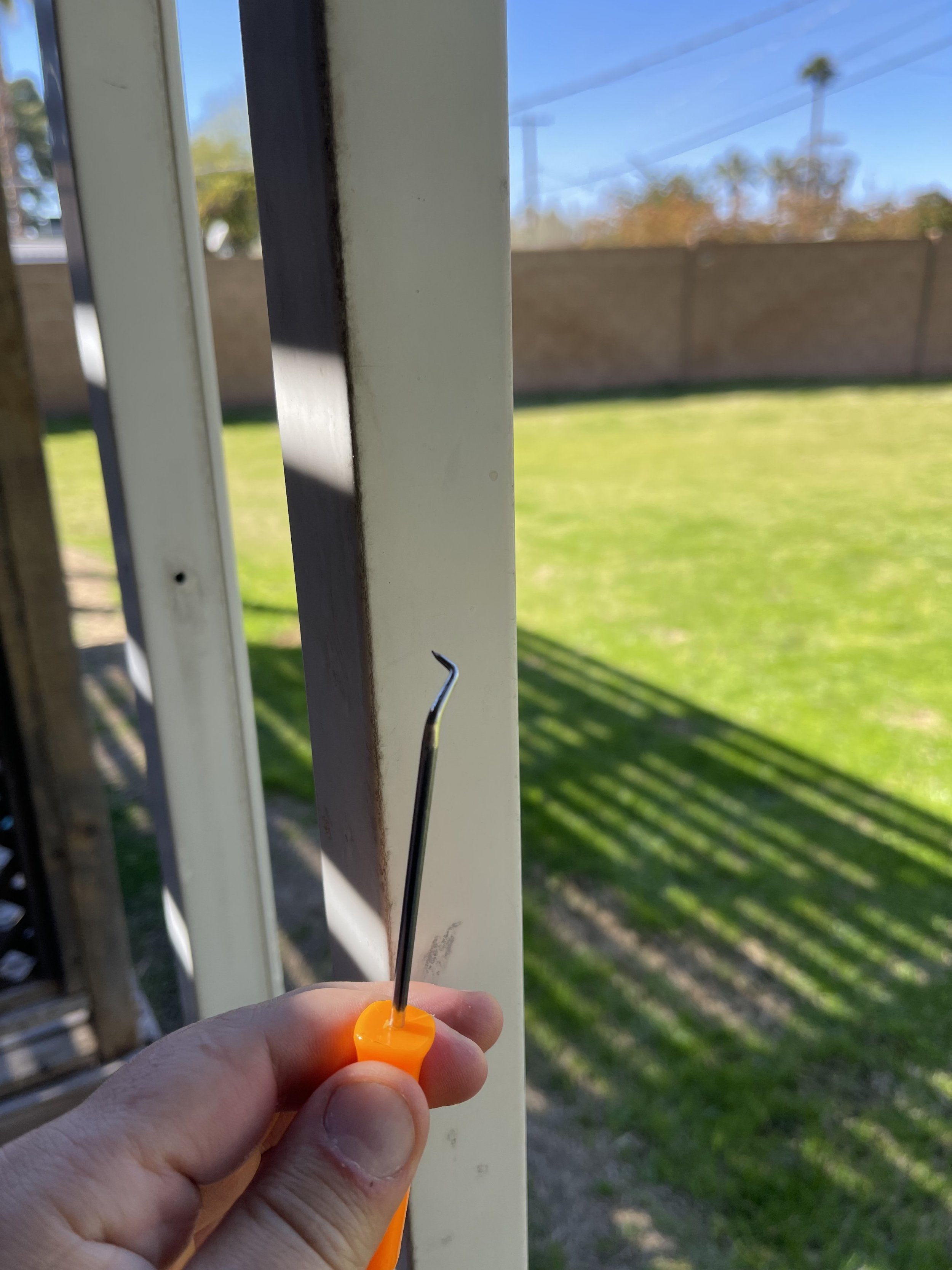

Just like squeegee says, but I used one of the little curvy picks from harbor freight, wedge it in between that gap and rock it back-and-forth evenly on each side until it starts to work it’s way loose
