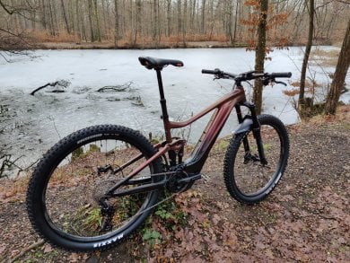

Hello everybody,
last Thursday I picked up my new "Giant Trance XE+3".
Meanwhile, I've driven 200km and I'm really excited.
Unfortunately, however, I have a problem:
Meanwhile, I have recharged the battery 3 times from about 20-30%.
Each time the charging takes forever. When I look at the charge level after 12-14 hours, the battery is 84% to 91% full and no longer charges.
If I then disconnect the charger from the power, wait a minute and connect it again, the rest is charged.
Battery has always had room temperature of about 16-20°C (stored after the last trip for over a day in the warm before I started charging). (The trips themselves have been in frost around -2 to +2°C).
First I thought of a contact problem from the charger -> bike -> battery. Have cleaned all contacts and also measured with a multimeter -> no defective connection found. I also took the battery out of the bike and charged it directly -> same problem.
What seems strange to me is that when I disconnect the charger after +12 hours of charging from the battery / bike it continues to flash green, as if it would continue to charge and not notice that no battery is connected. It doesn't jump back to red, which is what I would expect. Is this normal?
Otherwise, at the moment, I would probably most likely assume a faulty charger. In the less favorable case, the battery has a "quirk".
Thanks for your feedback!
