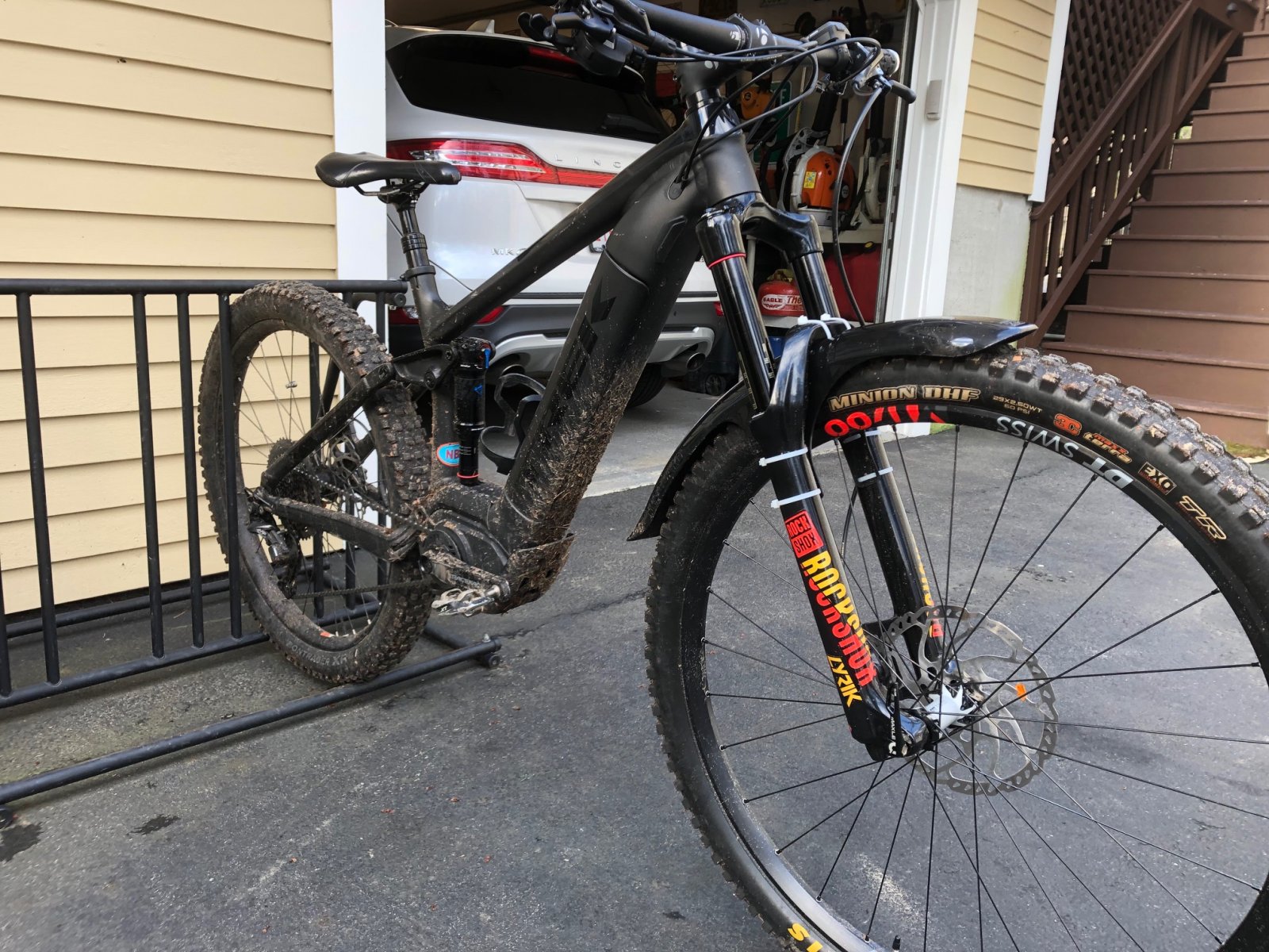

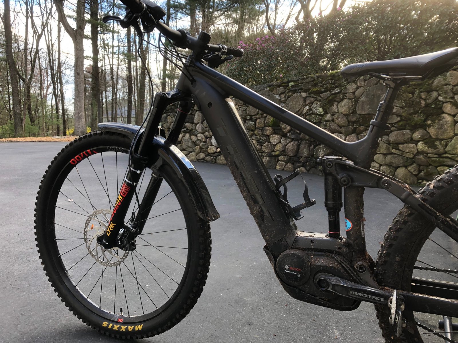

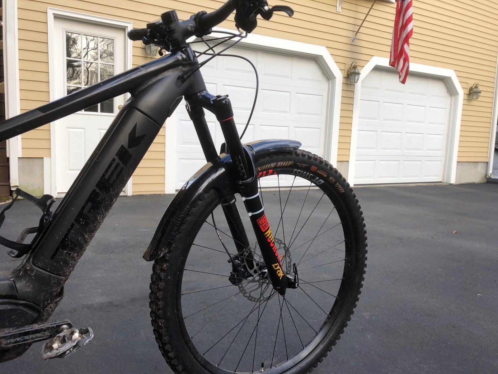

Here's my 29/27.5 Powerfly. I'm running a 160mm Lyrik /2.5" DHF out front with the stock 150mm out back. This setup is so much better than stock its like riding a trail bike vs a full blown enduro rig. I've done several races so far and this setup holds its own against the best mullet bikes out there. Never going back to stock...

Thank you, @liv2ryd

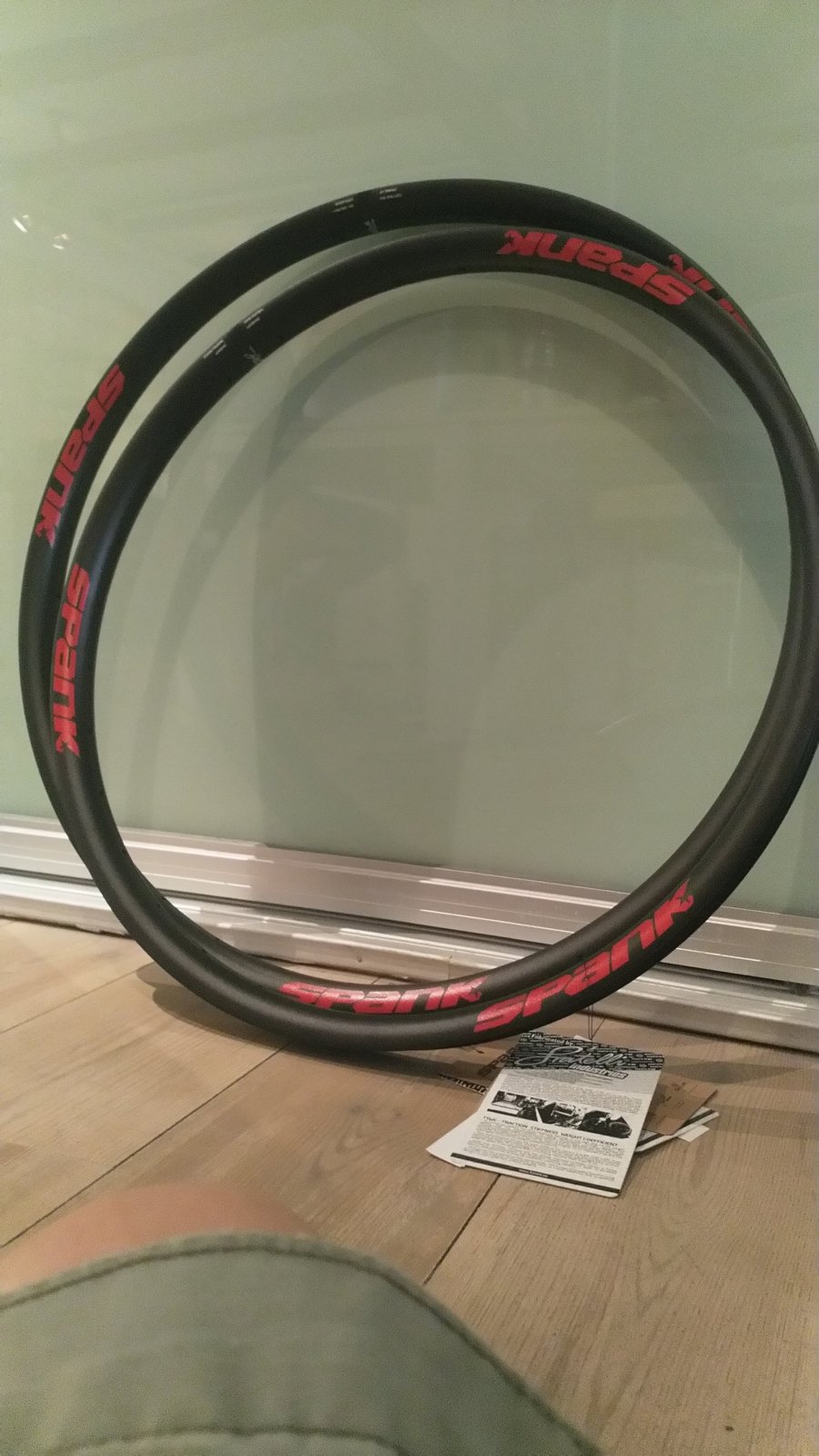

I have already pulled the trigger and am now waiting for the parts for a new mullet wheelset build to arrive. Rims have arrived and the rear hub should be here in a couple of weeks.

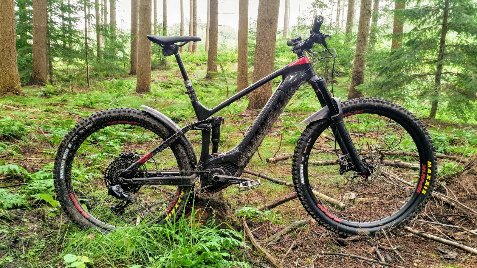

Wheels have been built. I took the bike out for 43km test ride and I am super happy with the result.This mullet-ish setup is, along with the completely silent Onyx rear hub, by far the best upgrade I have done to this bike.
My first impressions are, that the bike is more nimble with better control, predictability and cornering abilities.
Of course most of this may come down to just being this Maxxis tire setup being a better choice for my riding style than the stock Bontrager XR4 tires :)

What's the wheel diameter of the 29er front with that tyre?
33red
447
137
Quebec, Canada
Completely non-scientific from floor to top of the center nob it is ~755mm.
I will double check this to night after work.
Nice picture. I am on 27.5 + i will check if my fork is OK i could just buy a 29 rim for front and probably put a Rekon 2.6. How wide are your rims?
My PowerFly LT 9.7 came with a 29ner Yari fork.
Rims are Spank 395+ with an inner width of 35mm.
