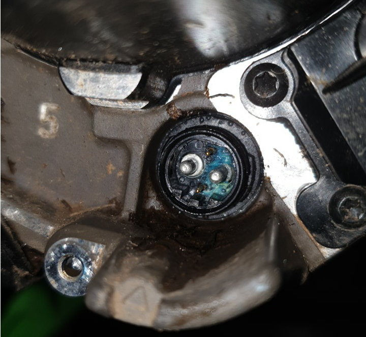

I've had some relevant issues with my 2021 vitus esommet vr, my engine cover was full of muck which resulted in my engine being flooded with boggy water that corroded the power connections.
lol @ the wee green/yellow wire
Worth checking if there's blockages or muck way in your engine.
Also if you spotted it above, there was a bolt in my engine cover among the muck, which turned out to be from the top battery mount (lol).
I'd noticed prior to finding this bolt that the top mount was swivelling up to 45' in the downtube, now I've cleaned up the connectors with contact cleaner & fixed the top mount its not thrown another e010/e020 error.
I do however after a ride find that the battery has self-ejected when I take the cover off, not requiring the hex key for removal, so maybe I need to further tweak the top mount..

Bit of an update - this e010 error code now happens every other ride cause my engine floods so much.
I set the top battery mount to the lowest possible point, so the error wasn't caused by the battery, but rather the engine for sure.
When I take the large power cable off it makes a loud wet suction noise, lol.
Careful unscrewing the screws attached to metal plates, they're really cheap and one chewed entirely 💀
Going to use the front mudguard on the rear (suggested in another thread) to avoid the drivetrain and engine getting covered in muck, will use water avoiding spray & maybe dialectric grease or something to make the engine cables more water proof.
I might follow your lead with the front mud flap. Might try to seal up the outside of the engine with black tack putty so it doesn't immediately rush into the engine components.
I was thinking of a mod - the last 2 times I've ran into the error my bike was at a 45'+ incline, so the water wouldn't be able to reach the bottom engine drainage holes, maybe a few small holes in the rear of the removable bottom cover would fix this? 🤔
