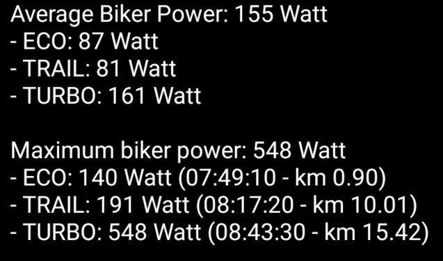

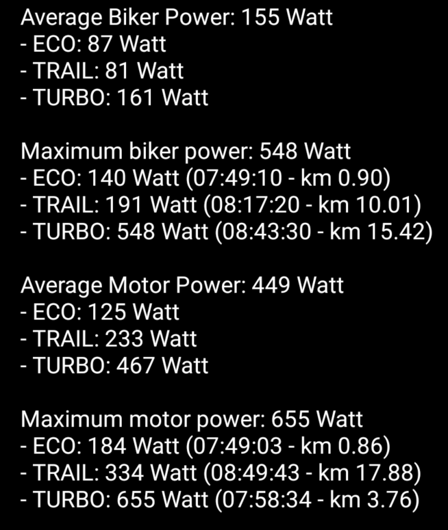

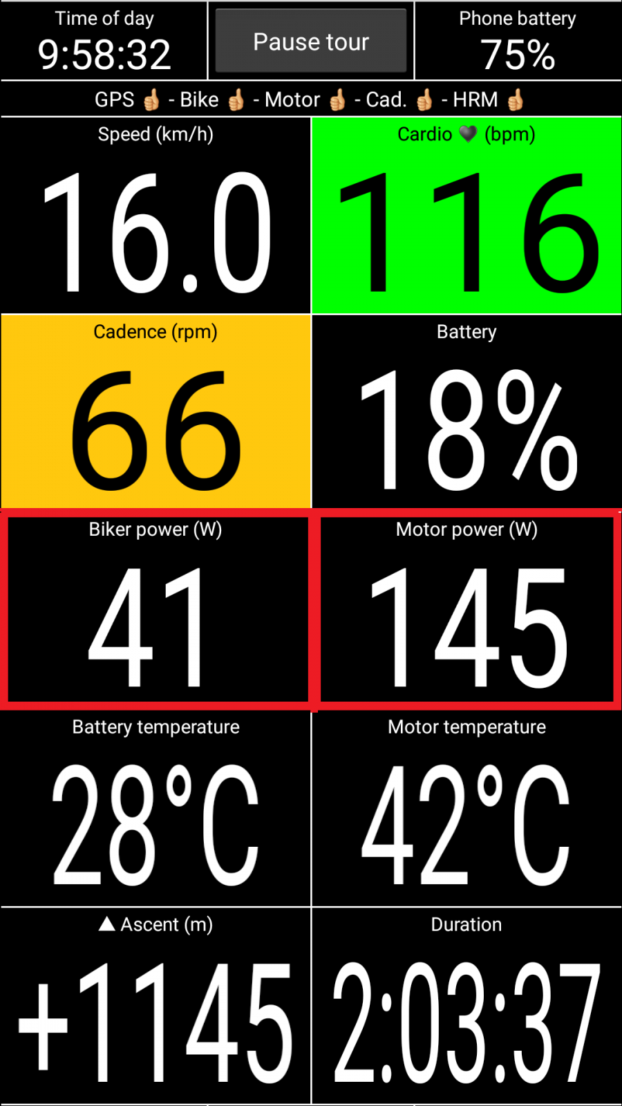

The first screen shot is the live capture and the second screen shot is displyed during and after the ride.

Hi G, not quite sure what you mean dude, To back what up? The accuracy of the power meter?
If yes, then..... no, apart from the below which like I said looks 'fairly' accurate.

IF Blevo only shows average and max power of the rider during a ride (like in screenshot), the usefulness of that info is questionable, but IF the rider power info would be available as real time data, using same ANT+ power meter profile as any other separate power meter, then THAT would totally replace a separate power meter. I don't understand why manufacturers don't do that.
The numbers in this screenshot are somewhat interesting, as rider input in ECO and TRAIL is lower than in TURBO... isn't it "normally" the opposite - you push all out of your legs until they explode, then switch to TURBO/BOOST and try to recover. I would expect that TURBO shows lower RIDER Watts than ECO. At least in my riding style it certainly would?!?

IF Blevo only shows average and max power of the rider during a ride (like in screenshot), the usefulness of that info is questionable, but IF the rider power info would be available as real time data, using same ANT+ power meter profile as any other separate power meter, then THAT would totally replace a separate power meter. I don't understand why manufacturer's don't do that.
My guess is because the data isn't actually accurate. There;s no way Brose'd put something as accurate as a proper stand alone power meter in a mass produced motor system where 99%+ of the users won't even understand how to use power to train by
I thought the same until I realised if eco is only used on the flat and downhill soft pedalling is all that's ever required to ride at normal mtb speeds. (an average power of 90w really is nothing for any reasonably fit cyclist) Whereas if Boost/turbo is only ever used up the steepest hills more effort will be required. Going with this theory it looks like trail is probably being used mainly for shallow inclines or slightly fastee speeds on the flat.

I still can't get my head round post #3 "Average motor power 449W".
If the motor is supposed to be restricted to an average of 250W, does that imply the motor of "Kiwi in Wales" has been de-restricted? I'm not being critical, just trying to understand all this stuff. :)
Yep it doesn't seem right does it :) And even a de-restricted motor wouldn't affect the power output of the motor - it only means that the motor can keep applying the same power above the normal cut-off speed limit.
So the motors are supposed to have up to "250W continuous power rating" - but no-one seems to be able to find a definition for what that exactly means! Over what sort of time do they have to average 250W - 1 hour? 2 hours? Over the duration of the battery? (Which should be 2 hours with a 500W battery).
The only explanation for post #3 above is that the duration of the measurement was shorter than that required to average 250W. So maybe if the rider had kept going in turbo it would have gradually decreased the power it was supplying at some point.
