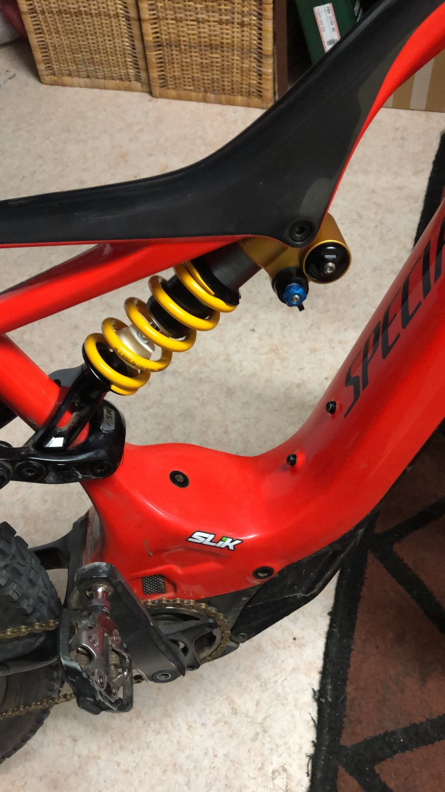

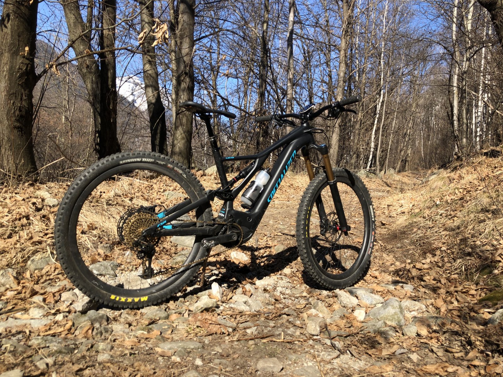

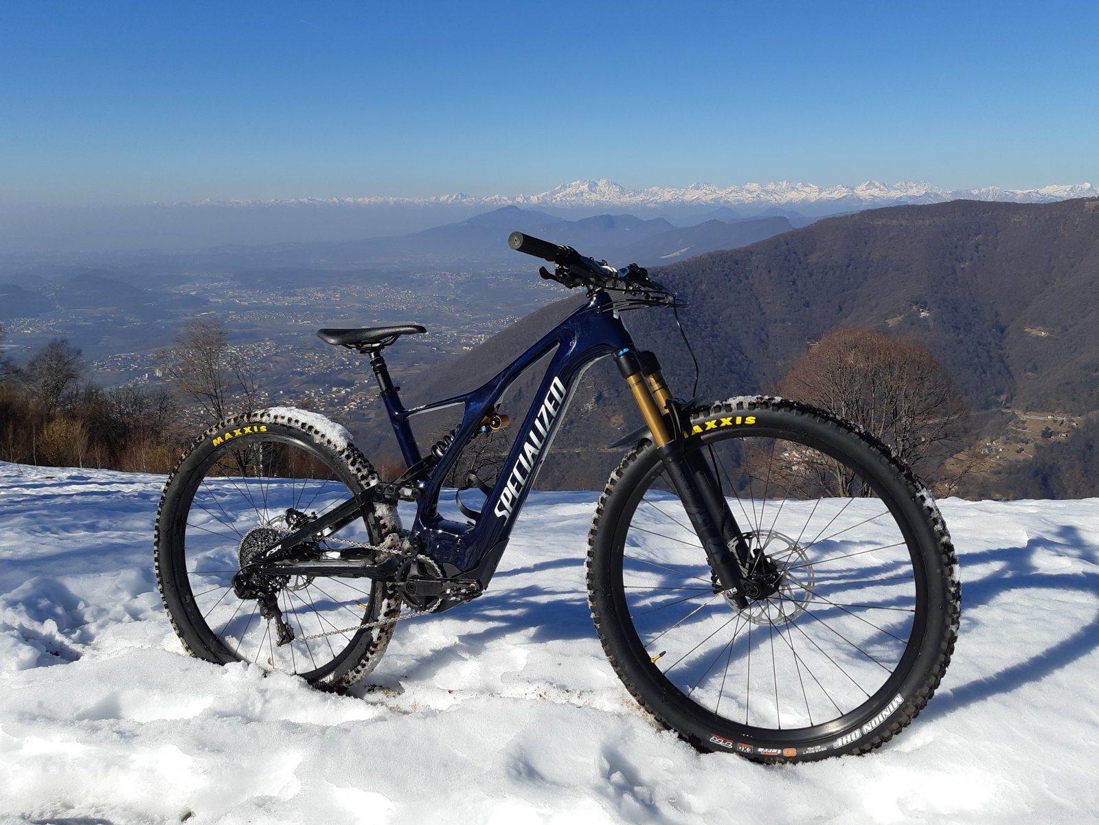

Have made a shock update to Ohlins TTX22 and i love it!
front a 29"LB wheel 2.5WT shorty, rear 27.5"LB wheel 2.6 Minion; Fox36 grip2 160mm
Sram Eagle XX1 12speed, Wolfthoot 30" steel, Miranda 160mm

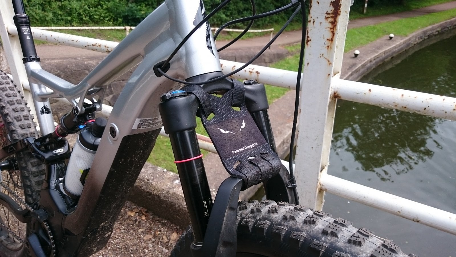

How do you find the charger upgrade - thinking of doing same to my Revelations.
The upgrade goes very well, the fork works better, that's for sure! With the rct3 charger cartridge the revelation turns into a pike which is one of the best forks on the market. So the upgrade is advisable. I really like the total or almost blockage of the fork in the firm position when I pedal uphill and the low speed adjustment is a plus that serves to make the fork more effective on rock gardens. I suggest you upgrade the revelation.

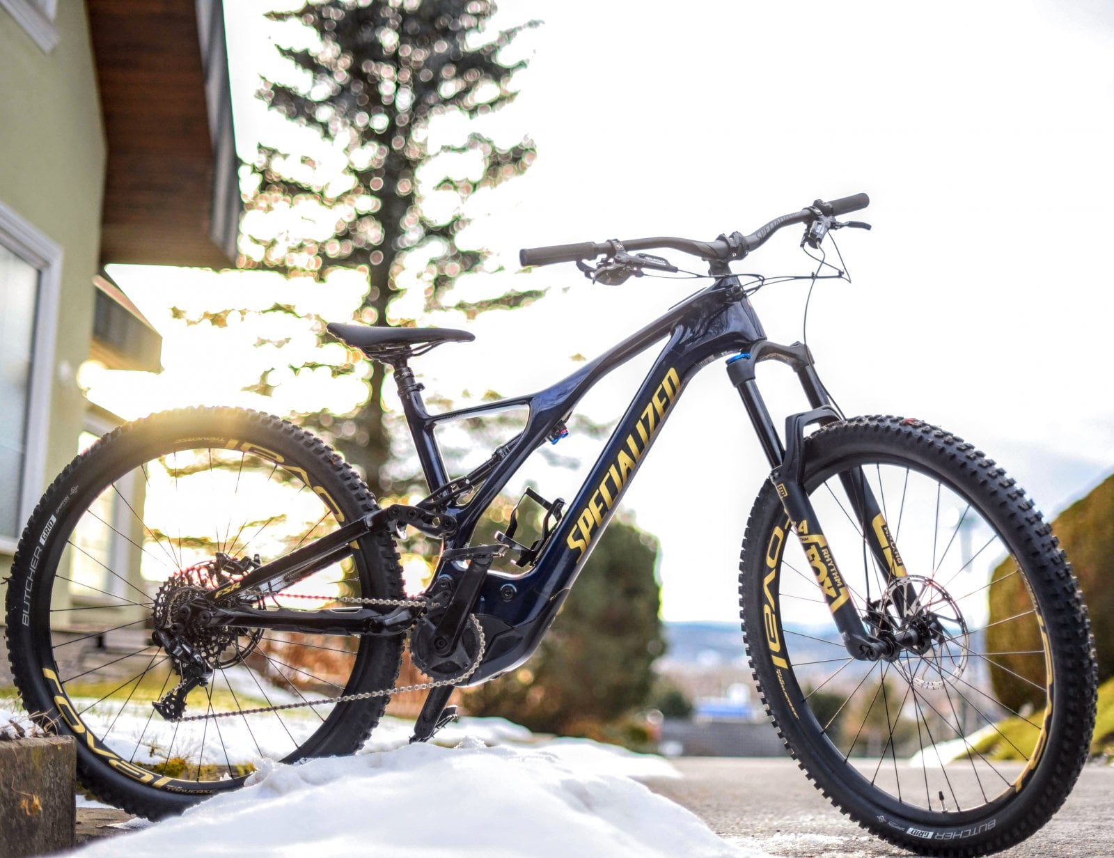

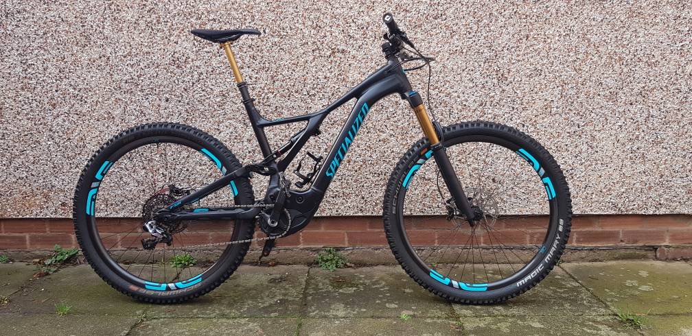

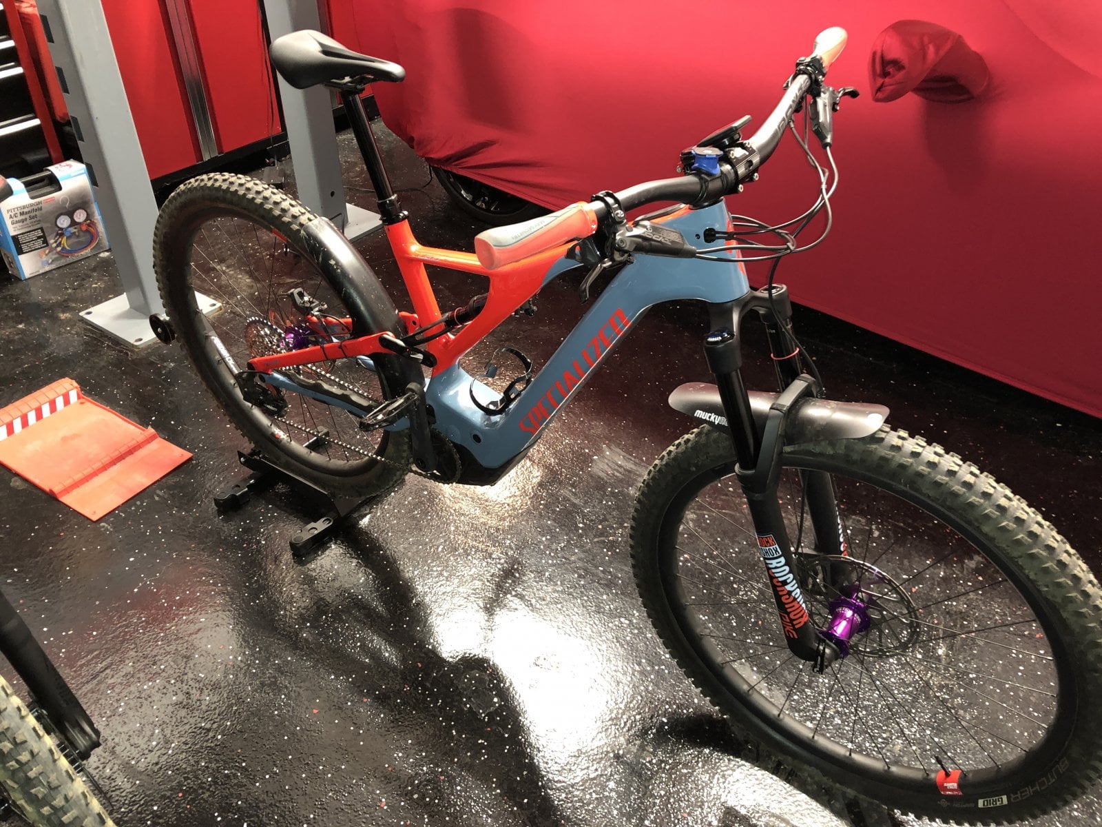

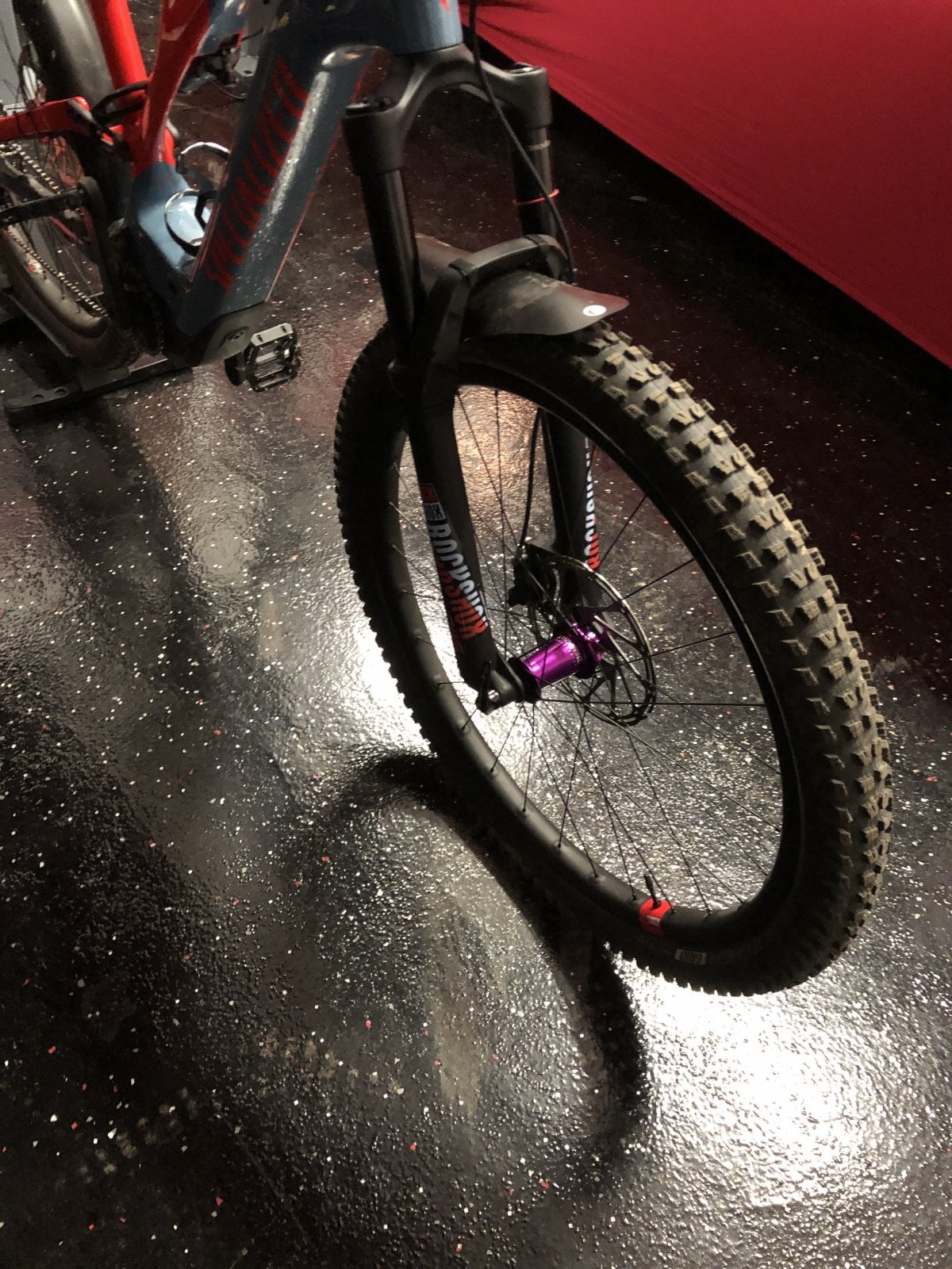

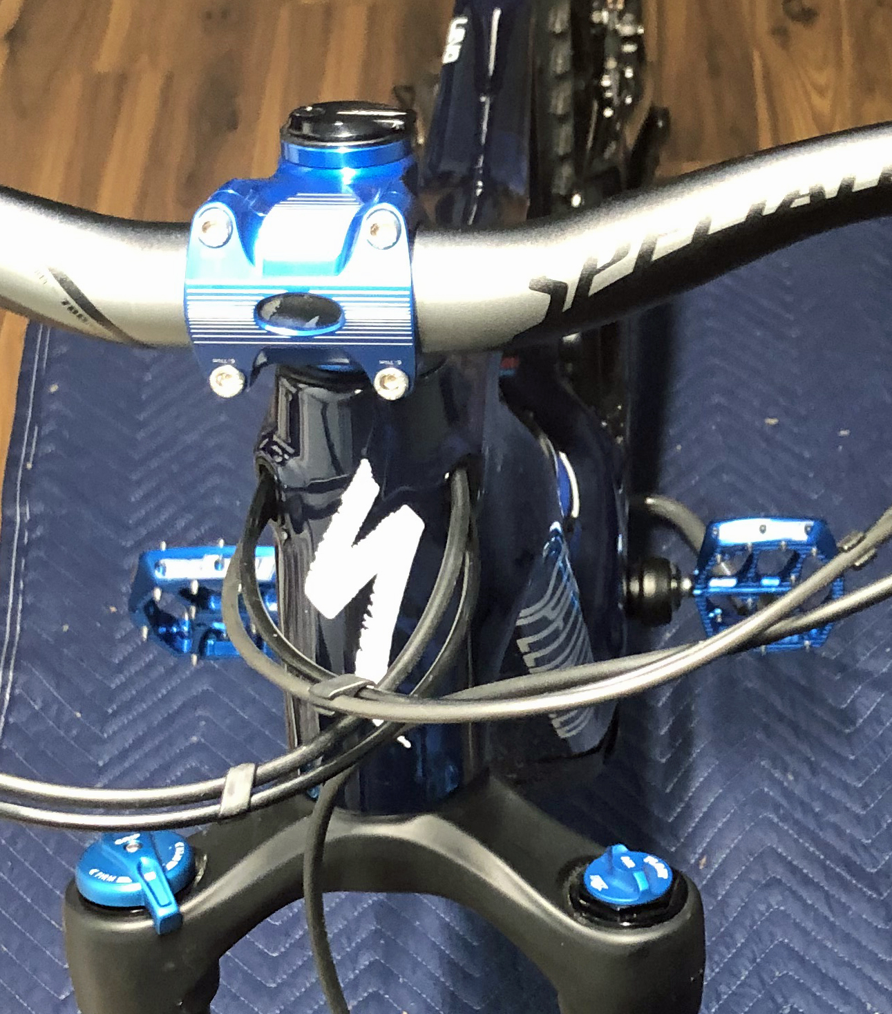

my "modded" (just optically) at this point.
My first thought was to replace the fork with a Fox Factory 36 + the seat post with some Kashima coating, SRAM XX1 cassette/shifter and some Hope brakes with matching color. But to be honest, the bike isn't that bad as it is and these would be expensive upgrades. So firstly I've experimented with an optical-only modification.
I personally like the mixture of blue and gold. What do you guys think?
(*image updated)

That looks great! Good to hear your thoughts on the suspension too. I cant wait to get mine dialled in.

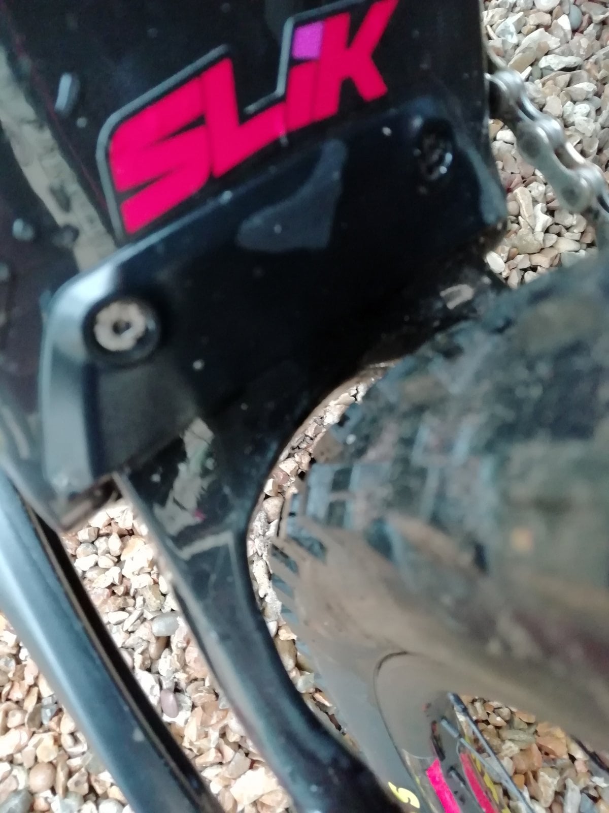

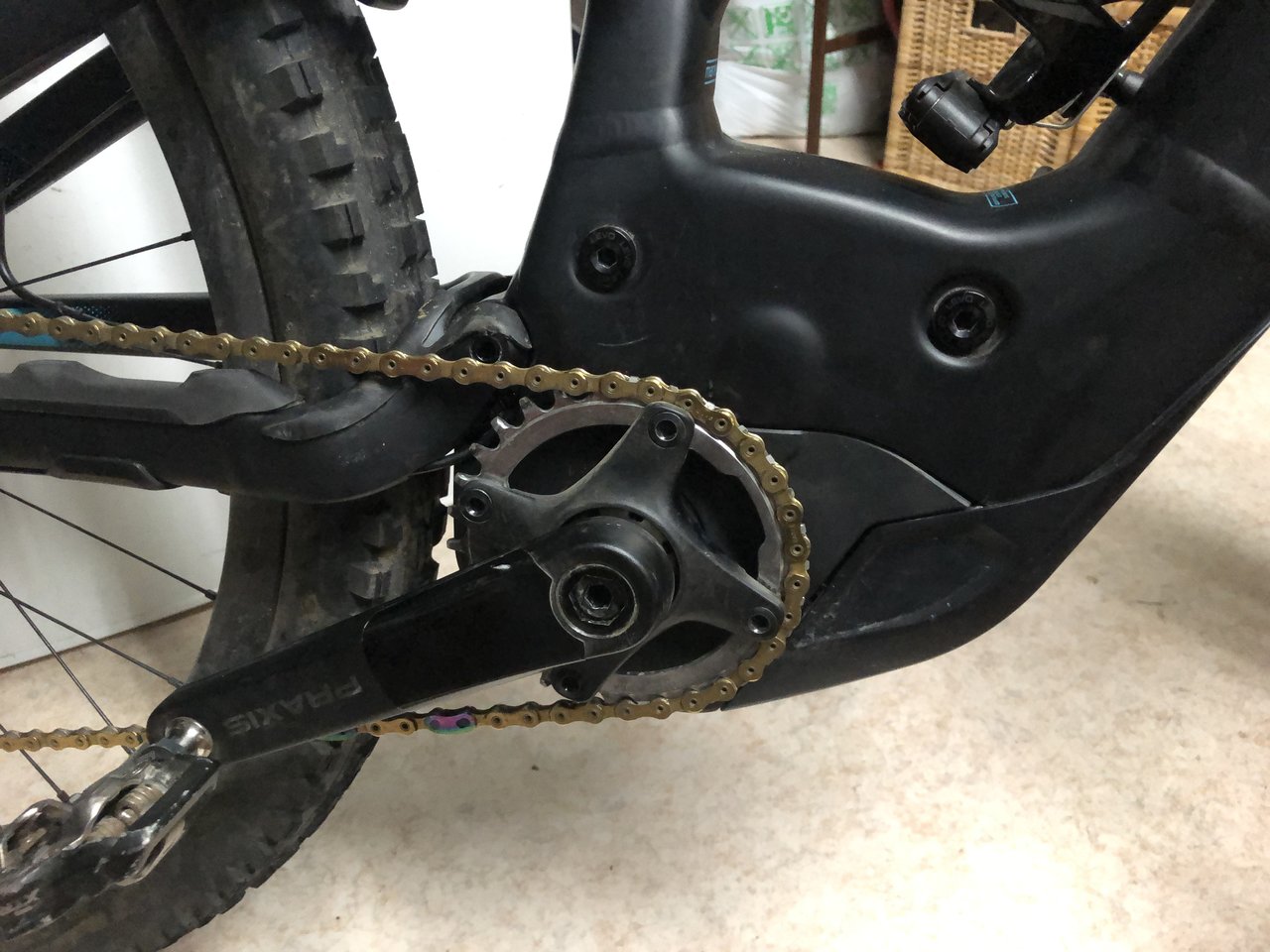

Could you do me a huge favour and take a pic showing how much space you have between tire and up against motor(front lower triangle)?
I have the exact same bike as yours in L and I can only run a 2.2 tire at the back, even a 2.3 ground Control is rubbing up against the motor :rolleyes:
I have contacted my local @Specialized Rider Care more than a week ago but apparently they could not care less replying a customer - Not a word from them and so much for the apparently good Specialized support everyone are praising but not in Scandinavia (n)
My theory is that there exist more than one rear triangle size as some have plenty of space and others not so much.
Karsten

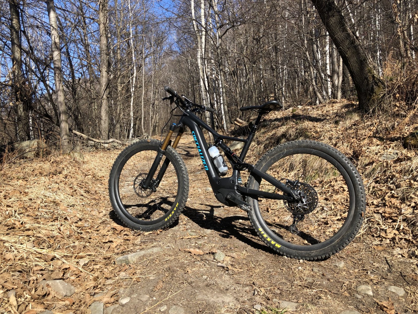

Pic attached - loads of room.

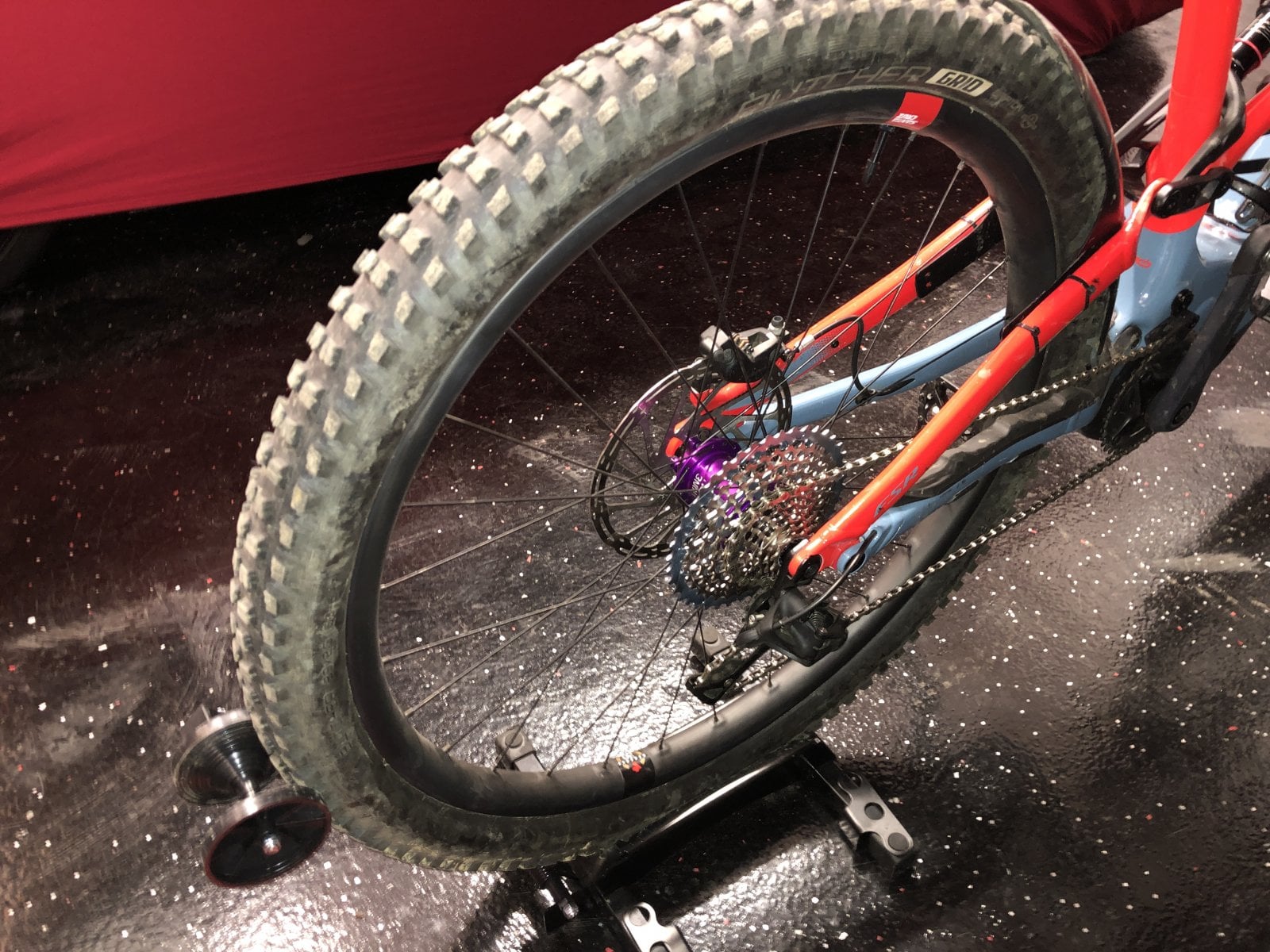

(*image updated)
Looks great! Subtle and clean but really pops.

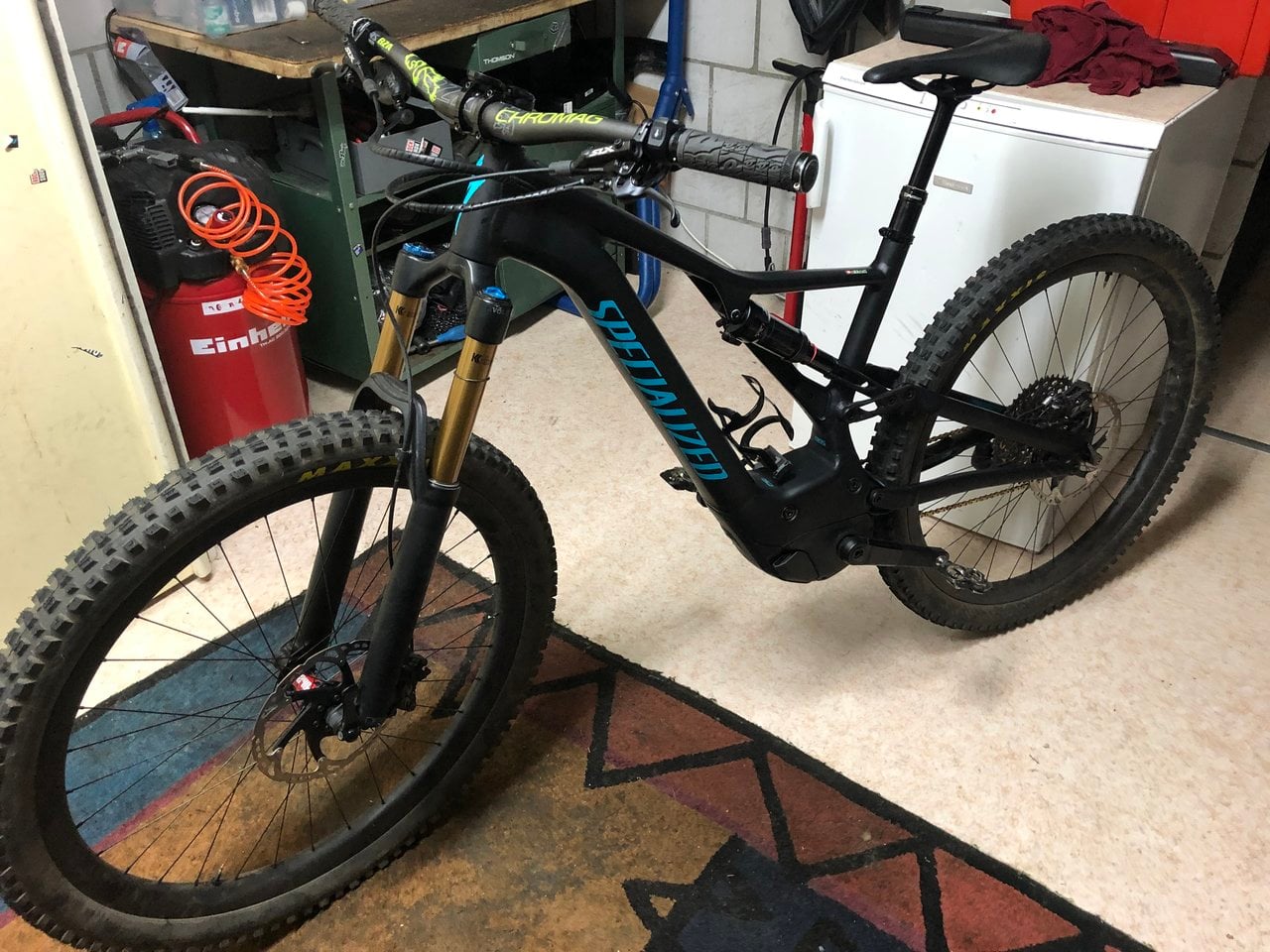

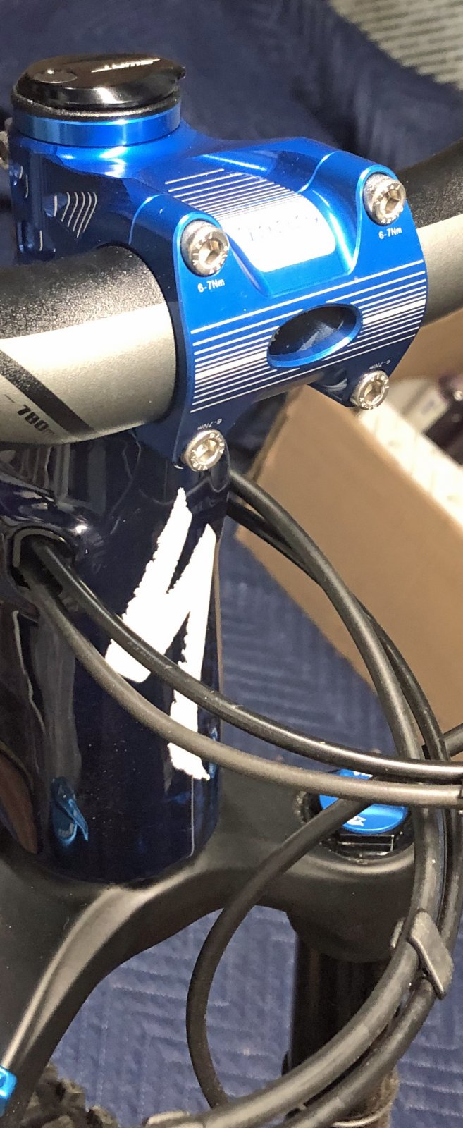

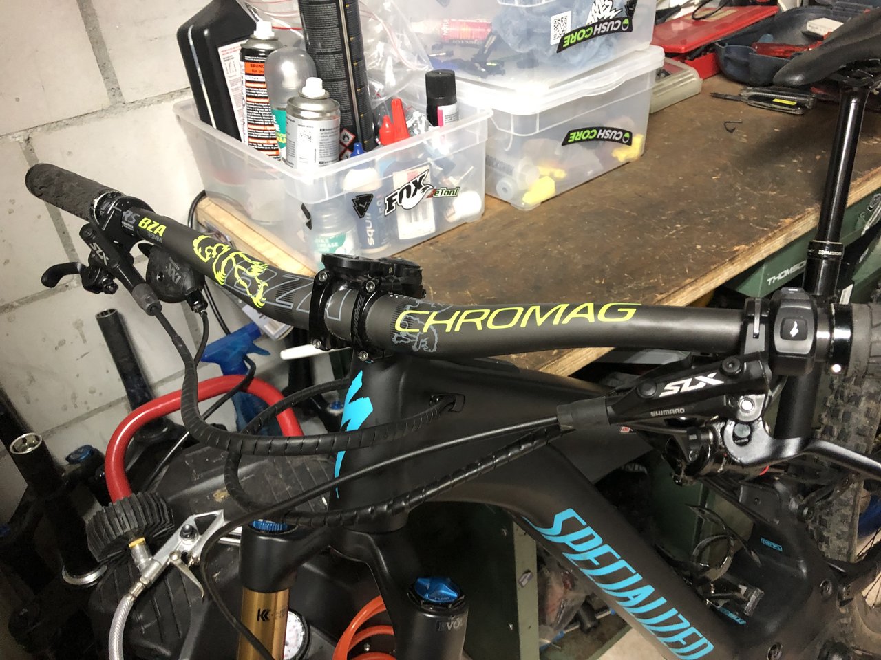

some updates, brake, chainring, Cromag Carbon Bar, RF Turbine Stem,
shimano Zee
shimano SLX Lever
Wolftooth 30" steel
whats the thinking behind reducing the size of the front ring?
