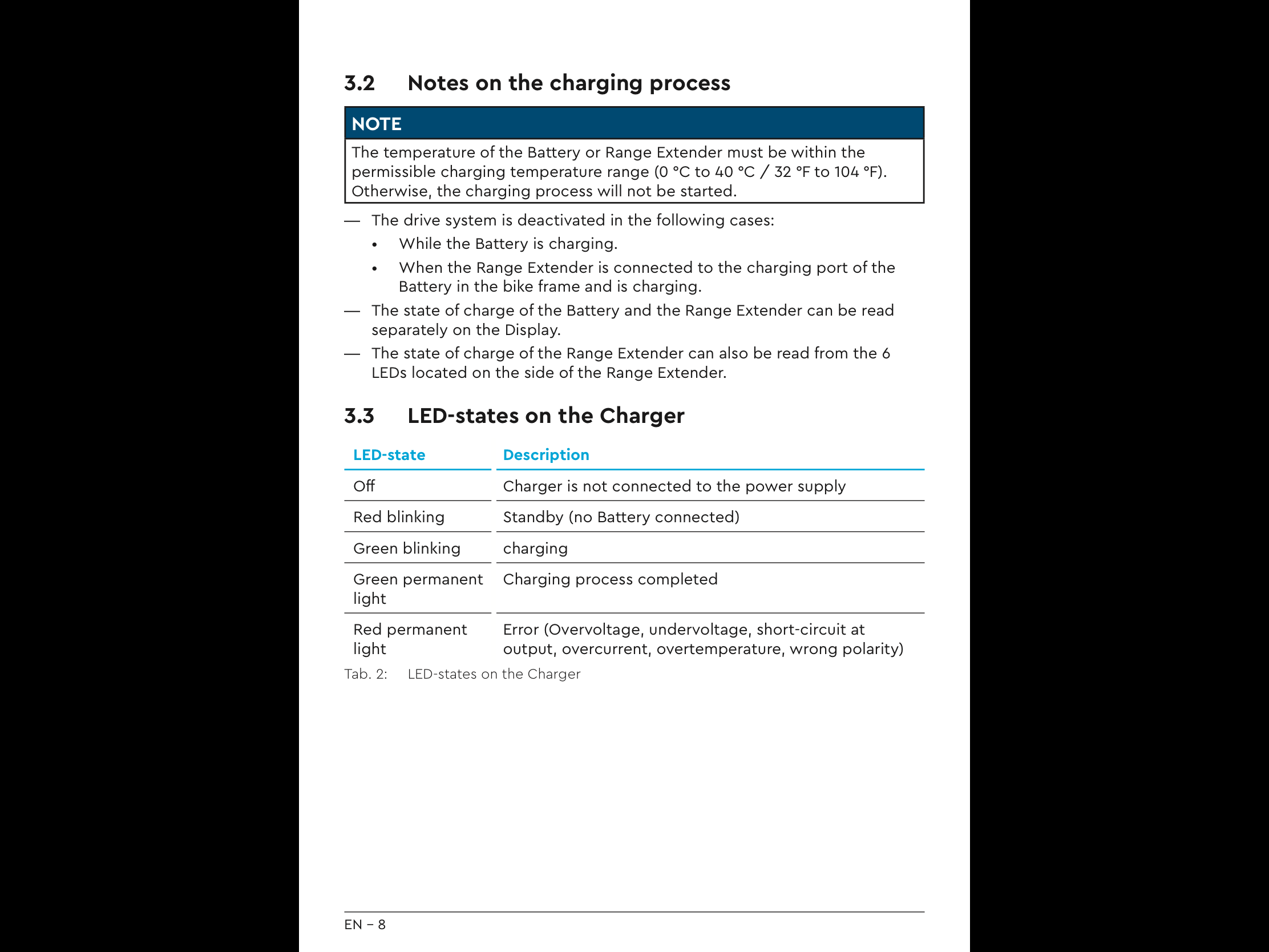

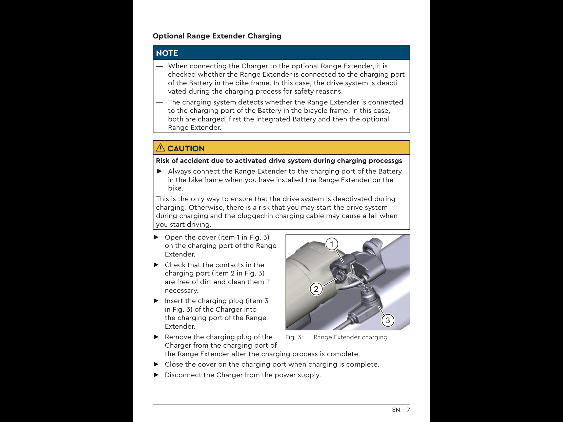

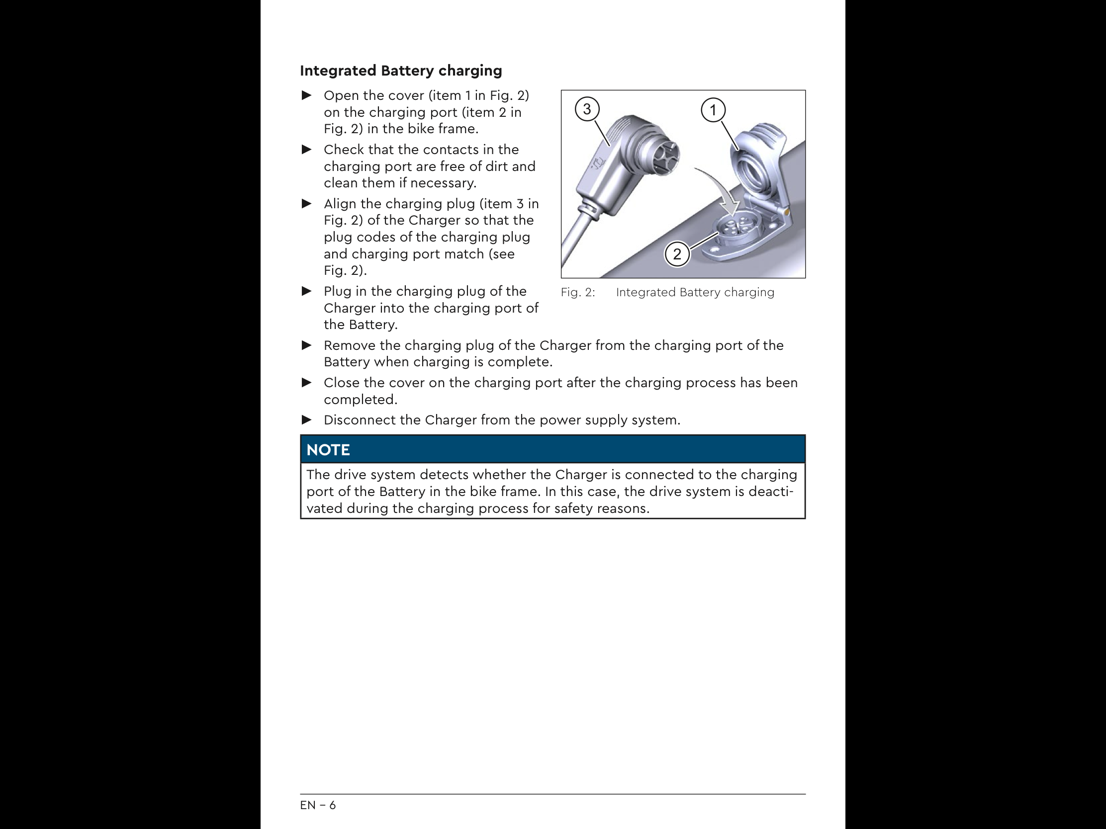

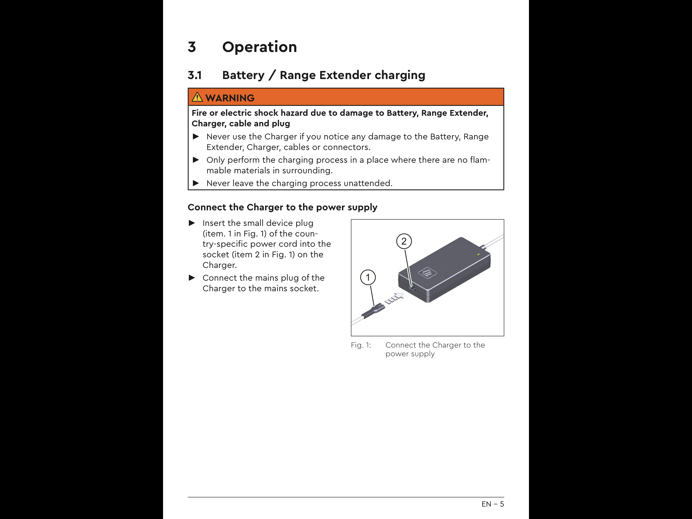

The manual for the TQ50 charger clearly states to first plug the charger into the wall outlet and then plug the charger into the battery port. I have no reason to do this differently.
