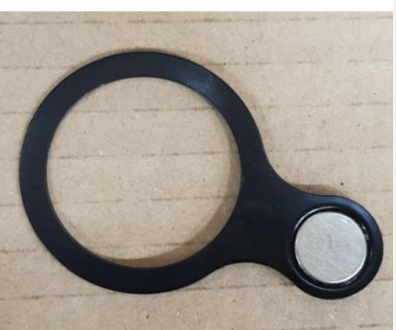

Check to make sure your speed sensor magnet is not loose and easily spun with your fingers, if you are using a center lock rotor. Make sure the center lock nut is secure. I had a similar issue and did not catch it until the center lock nut came loose enough for me to notice there was a problem with my rear brakes. Since tightening the nut down to torque specs, never had a motor shut off problem since.
Thank you for the hint. Will check once I get the bike back from the shop (if still having the issue).
