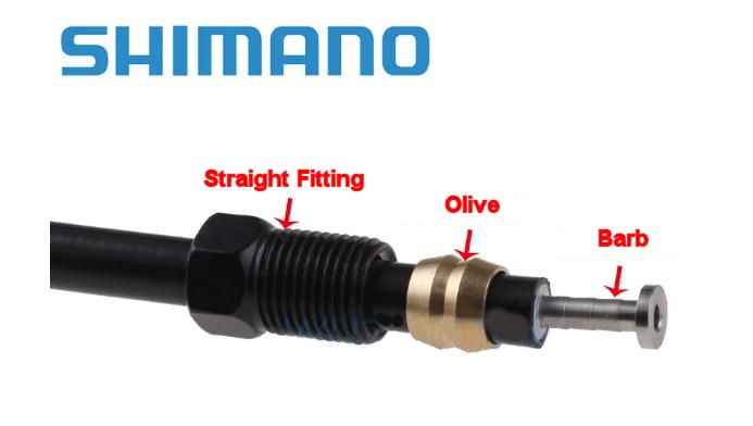

All modern Shimano brake levers, Deore, SLX, XT, XTR, use a straight fitting hose connection at the lever.

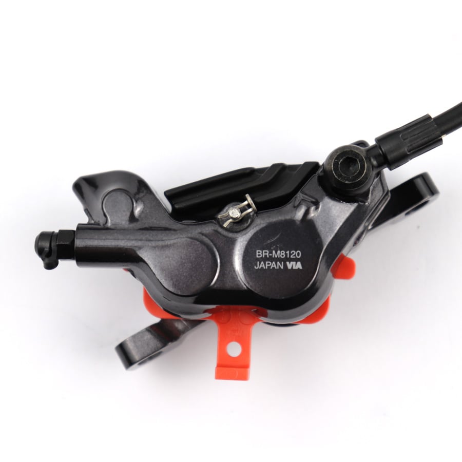

Some Shimano brake calipers use a straight fitting connection, others use a banjo fitting connection. Pictured here is a Banjo style brake hose fitting.
Shimano currently uses two types of brake hose on its braking systems. They are the SM-BH59 and SM-BH90 brake hoses. As a general rule, lower level brake components will use a Shimano SM-BH59-SS brake hose. Higher level braking components will use either a SM-BH90-
SS or a SM-BH90-SBM brake hose.
The “SS” abbreviation refers to the brake hose's connection fittings, i.e. straight fitting at the brake lever and straight fitting at the caliper. An "SBM" brake hose abbreviation refers to a straight fitting at the brake lever and a banjo fitting at the caliper.

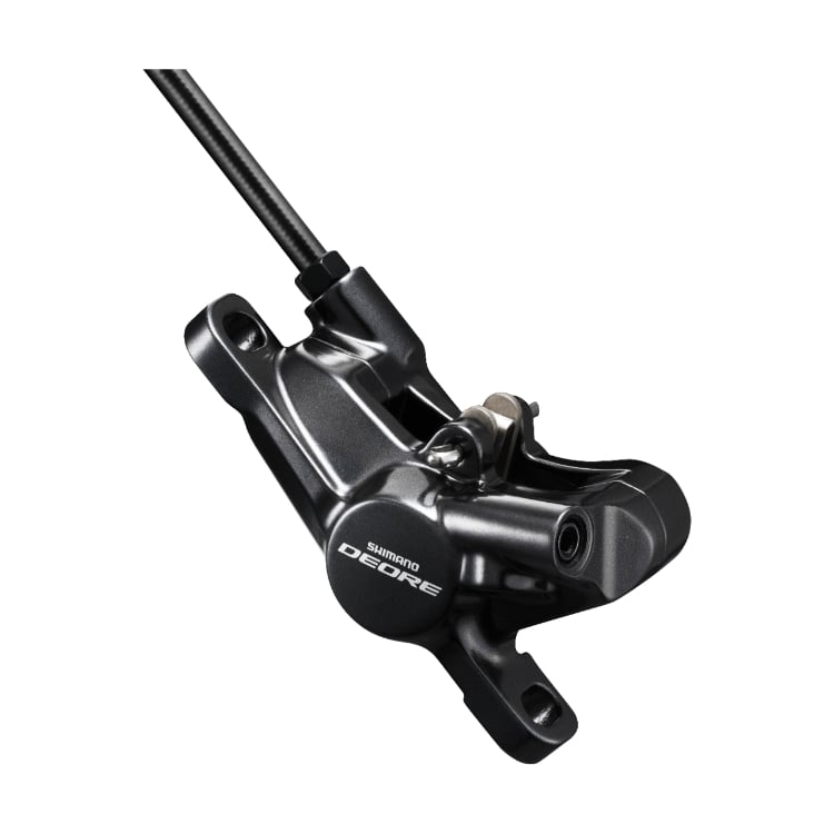

Lower level two piston brake calipers use a straight fitting brake hose connection. Higher level SLX, XT, XTR two piston calipers use a banjo style brake hose connection.

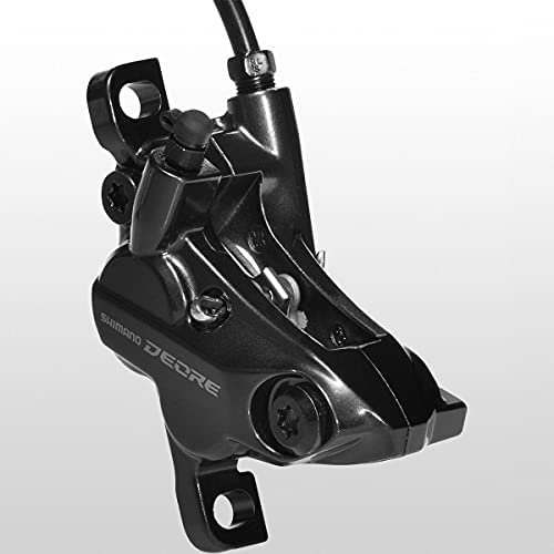

Deore four piston calipers such as the M6120 and the MT520 use a straight fitting brake hose connection. Shimano "20" series brake calipers, i.e. M7120 SLX, 8120 XT, 9120 XTR, use a "Banjo" fitting brake hose connection.
Deore M6000, two piston brake caliper with straight fitting
Deore M6120, four piston brake caliper with straight fitting

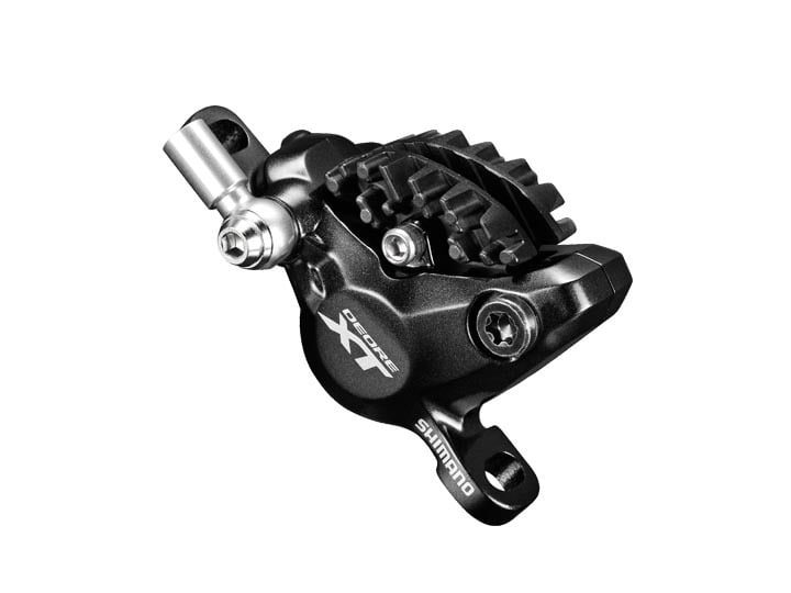

XT M8000, two piston brake caliper with banjo connection fitting
XT M8120, four piston brake caliper with banjo fitting

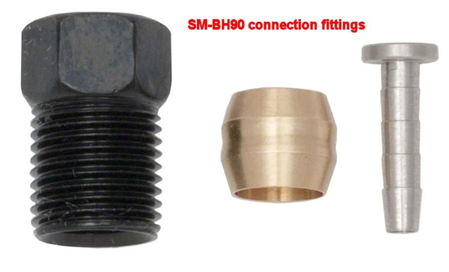

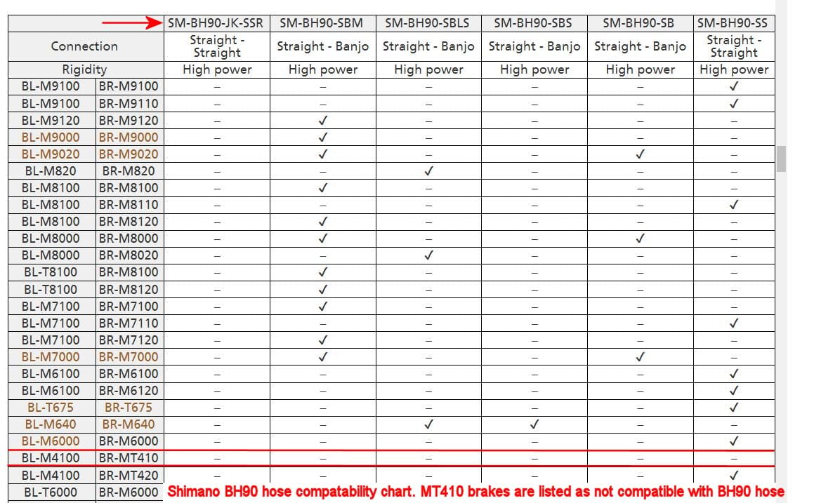

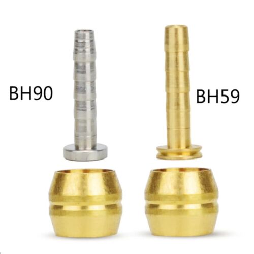

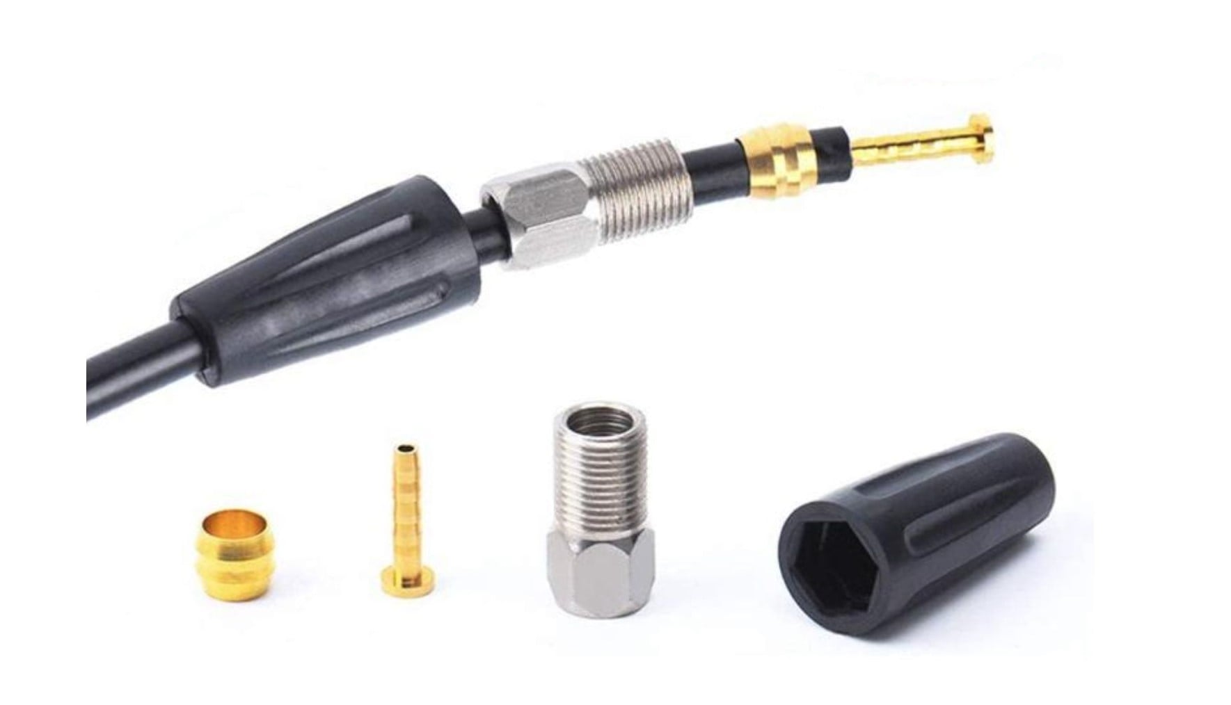

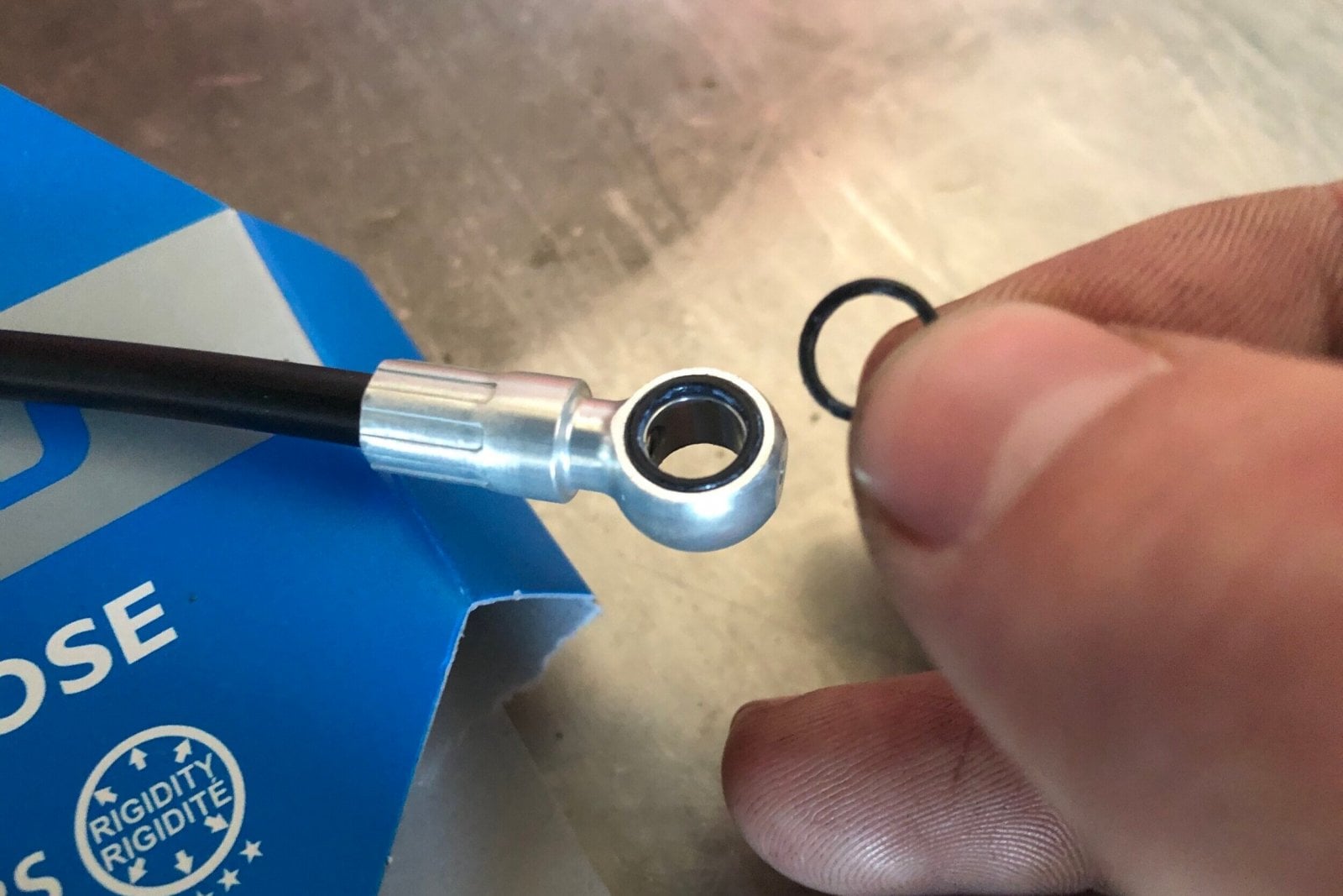

Orbea Rise models come from the factory with Shimano BH90 brake hose installed on the bike. The Rise Hydro H30 comes with Shimano MT410 brakes. Shimano's compatibility chart states MT410 brake components use the BH59 brake hose. All other Hydro models use BH90 brake hose.

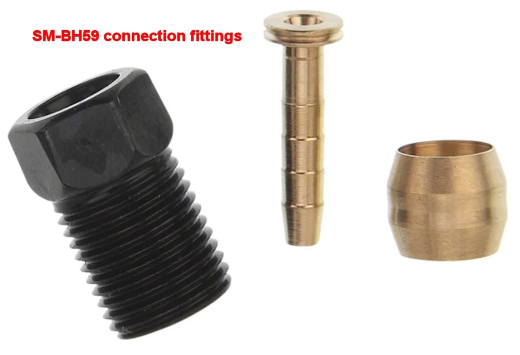

Shimano BH59 and BH90 brake hose differs in internal diameter size. The BH59 hose has an internal diameter of 2.3mm, whereas the BH90 hose has an internal diameter size of 2.1mm. The outside diameter of both hoses is the same at 5mm. I believe the reduced internal diameter of the BH90 brake hose increases hydraulic pressure at the caliper.
Hose barb fittings for the BH59 and BH90 are NOT compatible. If you have BH59 brake hose, you must use a BH59 hose barb. If you have a BH90 brake hose, you must BH90 hose barb. This is due to the differing internal diameter size of the two hoses. The external diameter of both hoses is the same at 5mm, so the olive can be used on either hose.

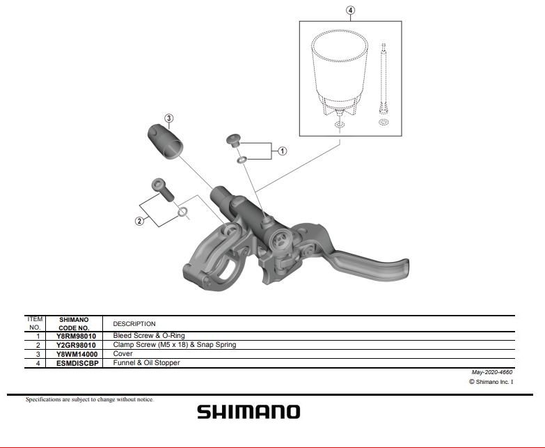

3. Shimano Brake Levers:

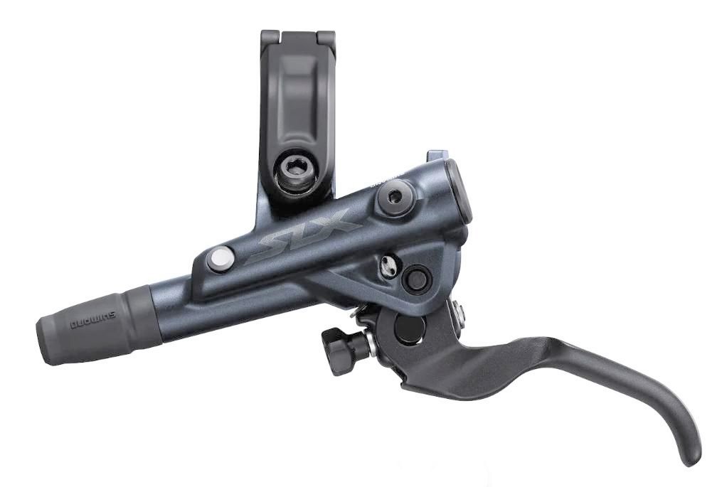

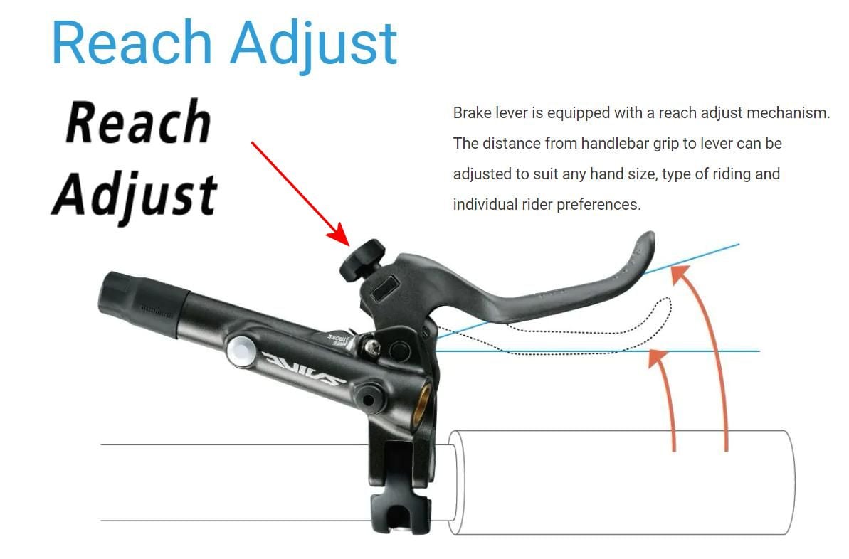

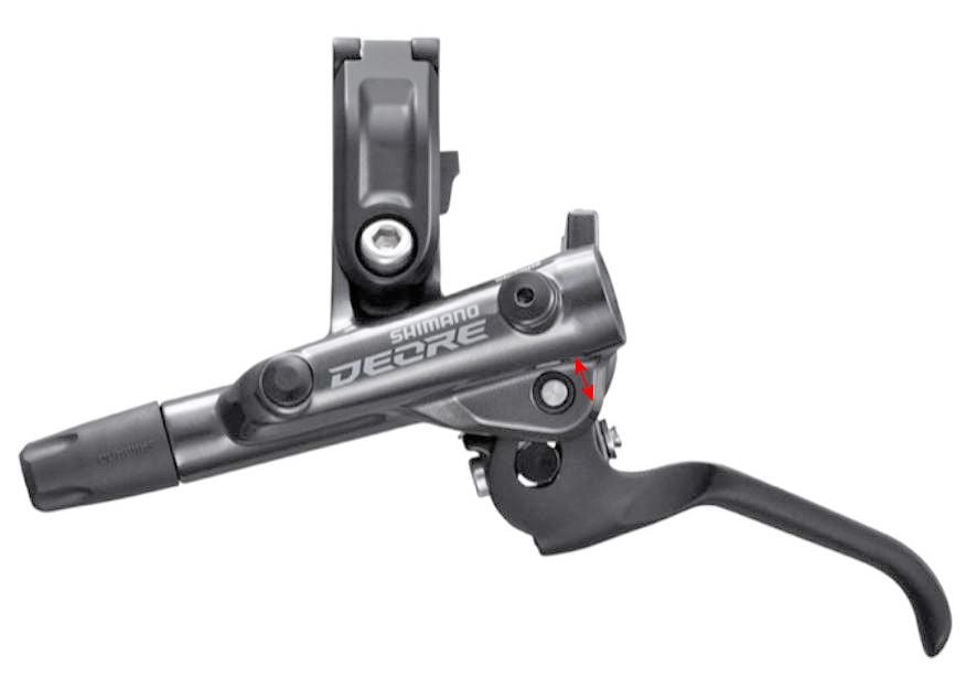

Depending upon the level of your Rise brake lever, i.e. Deore, XT, etc., it may or may not come with several rider customization features.
The first feature is "Lever Reach." SLX and above brake levers have a castellated screw on the brake lever that allows the rider to make a tool free adjustment in regards to how far the brake lever extends away from the handlebar. Deore and lower brake levers have a hex screw which requires the use of a tool to make the reach adjustment.

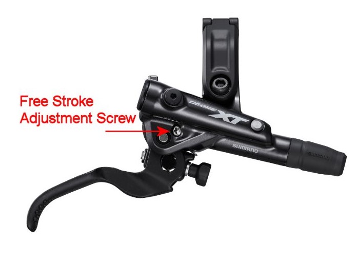

A second useful feature is "Free Stroke" adjustment. Brake levers XT and above have a "Free Stroke" adjustment screw. The "Free Stroke" adjustment screw allows you to adjust how far you have to squeeze the brake lever before the caliper pistons advance the brake pads far enough to engage the brake rotor, i.e. Bite Point. The terrain we ride varies all around the world. Some riders may prefer a softer, feathery engagement, whereas other riders may prefer a quicker and more firm engagement.

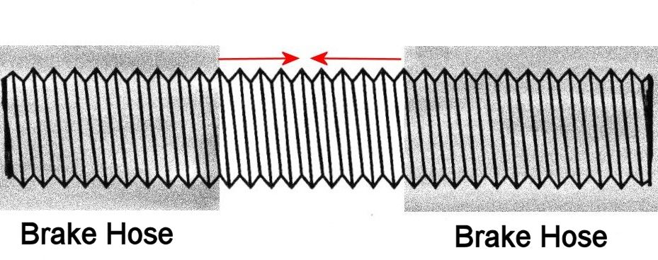

To fish the new brake hose, you must firmly attach it to the old brake hose. Buy a 1.5 inch/38mm long, fine thread machine screw which has a diameter slightly larger than the inside diameter of the BH90 brake hose. Thread one end of the machine screw about halfway into the old hose. Cut the head off of the screw. Thread the new brake hose onto the other end of the screw. Thread both hoses together so that they firmly meet with no gap between them. Spray the new hose with a silicone lubricant and the old hose where it exits the top of the motor mount shell. Start from the rear due to the banjo fitting. Begin pulling on the old hose, starting at the rubber hose guide which can be lifted up. The screw may pull out while pulling. If it does, then drop the motor and install the hose.

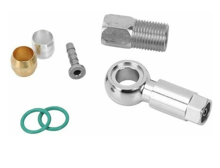

There are aftermarket companies on Amazon and eBay that sell Banjo fitting adapters which will convert your BH90 straight fitting brake hose into a banjo style brake hose. I am hesitant to recommend this procedure because experimenting with you brake system with unknown parts can be dangerous. The banjo fitting adapter works by installing the banjo fitting onto the caliper. Next, thread the Rise's straight fitting brake hose into the banjo adapter.

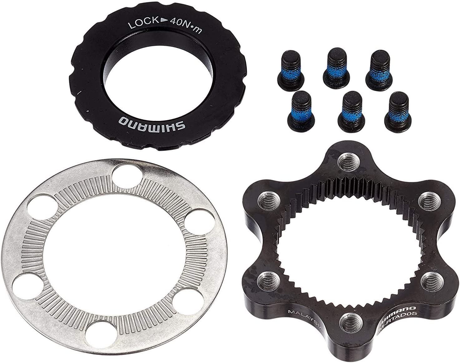

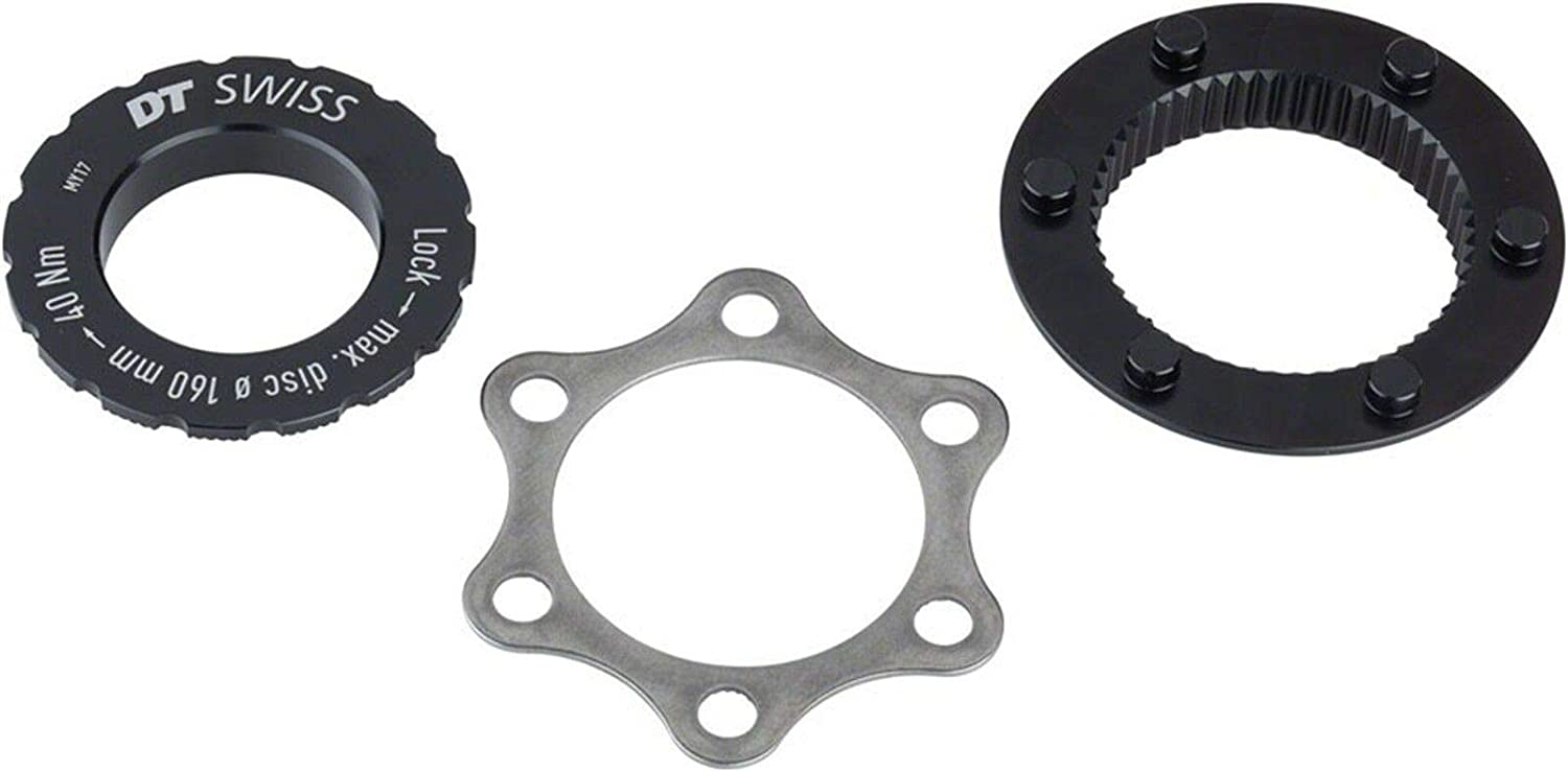

The rear rotor on your Rise must have a magnetic pickup in order for your bike to work. Shimano 203mm Centerlock brake rotors with magnet pickup are difficult to source as the supply is limited. There are manufacturers besides Shimano who manufacture centerlock rotors with a built in magnet pickup, including Jagwire and Magura.
When I first got my Rise M20, I installed SRAM G2 brakes with 200mm centerlock brake rotors. SRAM does not make a centerlock brake rotor with magnetic pickup. I tried various centerlock rotor magnet adapters sold by Bosch, Trek and others. These were not successful and my bike fault coded. I next superglued a Neodymium rare earth magnet to the brake rotor. This worked really well for a few weeks. Then my Rise began to fault code on rides and shut off. After some hair pulling and research, I learned that rare earth magnets will lose their magnetism when subjected to high heat, i.e. glued to a brake rotor. The magnetism will return after the magnet has cooled. However, if the magnet is subjected to enough heat cycles, the loss of magnetism will become permanent.
I eventually stopped trying to re-invent the wheel and purchased a set of Shimano XT brakes. No more fault codes or romantic walks in the park....Can I get a hallelujah please!
Note: I recently saw a new style of magnetic adapter for centerlock rotors. The magnet adapter clamps around the circumference of the centerlock locking ring. This adapter would allow you to use any manufacturers centerlock rotor. I don't recall where I saw the adapter, possibly on a Hydro or Wild? If you know of this magnetic adapter, please take a picture and add it to the thread so others can view and consider it as a viable option.

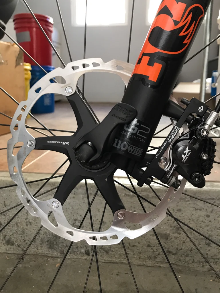

Six bolt rotors are much easier to upgrade.
You can use any type of manufacturer's six bolt brake rotor, the supplies are plentiful. The bolt pattern is universal across the industry. The correct six bolt magnetic adapter can be purchased on Orbea's website.
Here is a picture of my Rise with RT-EM800 203mm rotor. The Orbea Rise blue paper states a 220mm brake rotor cannot be used on the rear of the Rise due to clearance issues.

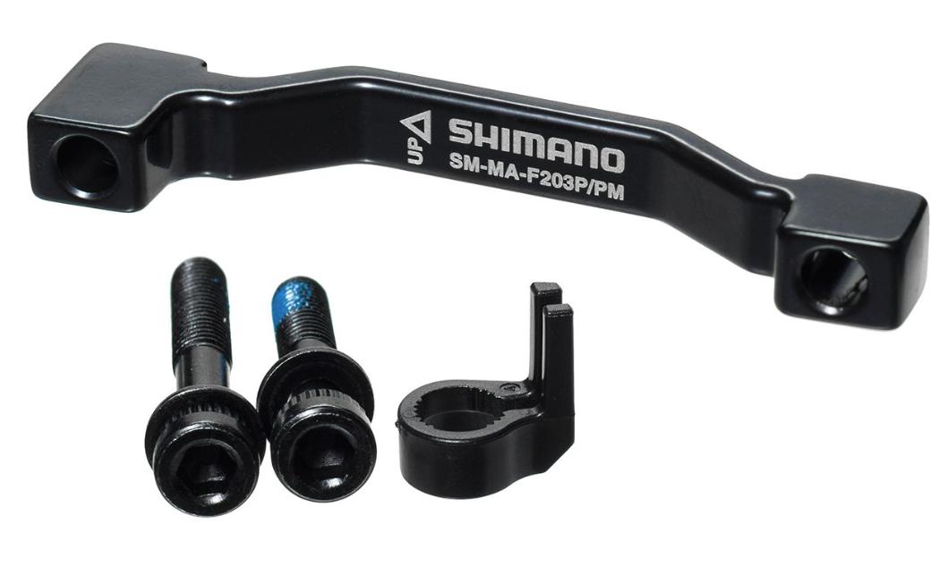

If you plan to increase the size of the brake rotor on your Rise, you will need to purchase a brake caliper adapter. Brake caliper adapters work like a spacer block to increase the height of the brake caliper in order to compensate for the increased diameter of the brake rotor.
Example of a brake caliper adapter

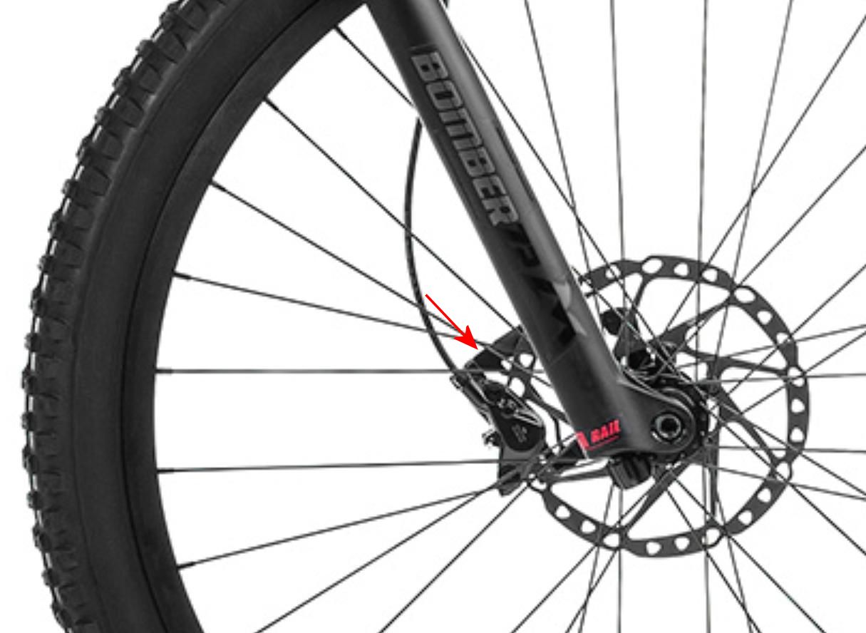

"Post Mount" is a term used to describe the two threaded lugs which the brake caliper bolts to on the frame and fork. The height of the post mount is determined by the size of the brake rotor which the bicycle manufacturer sets the bike up to use. Orbea has set up the Rise frame to use a 180mm rear brake rotor, thus the frame's rear brake lugs are 180mm post mount.
If a 203mm brake rotor is used on the rear of a Rise, then the 180mm post mount height has to be increased by 23mm to compensate for the larger diameter brake rotor. Use Shimano caliper adapter "SM-MA-F203P/PM" if you wish to install a 203mm brake rotor on the rear of your Rise.
The Fox 34 has a 160mm post mount and thus will accept a 160mm rotor and brake caliper bolted directly to the fork. If a larger 180mm or 203mm brake rotor is used, then a caliper adapter is required to compensate for the increased rotor size.
The Fox 36 has a 180mm post mount and thus will accept a 180mm rotor and brake caliper bolted directly to the fork. If a larger 203mm or 220mm brake rotor is used, then a caliper adapter is required to compensate for the increased rotor size.
The Marzocchi Bomber Z2 found on the Rise Hydro H-30 uses a 160mm post mount and will accept a 160mm rotor and brake caliper bolted directly to the fork. If a larger 180mm or 203mm brake rotor is used on the Marzocchi Bomber Z2, then a caliper adapter is required to compensate for the increased rotor size.

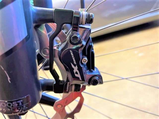

Picture of my Rise rear brake with 180mm post mounts. I have increased the rotor size from 180mm to a 203mm brake rotor. I have used a SM-MA-F203P/PM brake caliper adapter to compensate for the 23mm in increased rotor size.
Here is a picture of my Fox 36 fork with 180mm post mounts. A 180mm brake rotor and caliper would bolt directly to the fork and no caliper adapter would be needed. However, I have increased the front rotor size to 203mm. I am using a SM-MA-F203P/PM brake caliper adapter to compensate for the increased rotor size. The same "Post Mount" caliper adapter used on the rear of the bike can also be used on the front fork's 180mm post mounts.

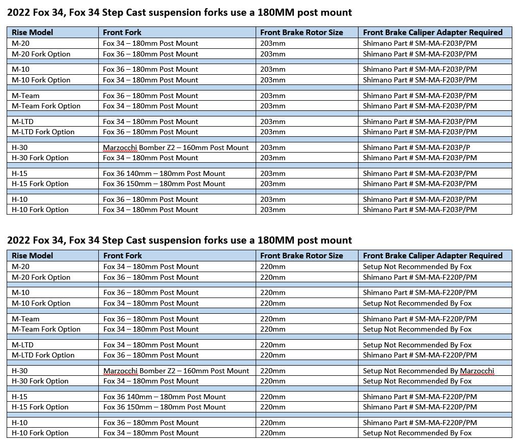

Shimano does not recommend using a 220mm brake rotor on a 160mm post mount, i.e. Fox 34 fork and therefore does not manufacture a 60mm caliper adapter.
If you wish to install a 203mm brake rotor on your 160mm post mount front fork, then Shimano recommends you use the flat and more rigid SM-MA-F203P/P caliper adapter as seen pictured below.

Note: In the below charts, I have included fork upgrades and downgrades offered by the Orbea factory for each model Rise.

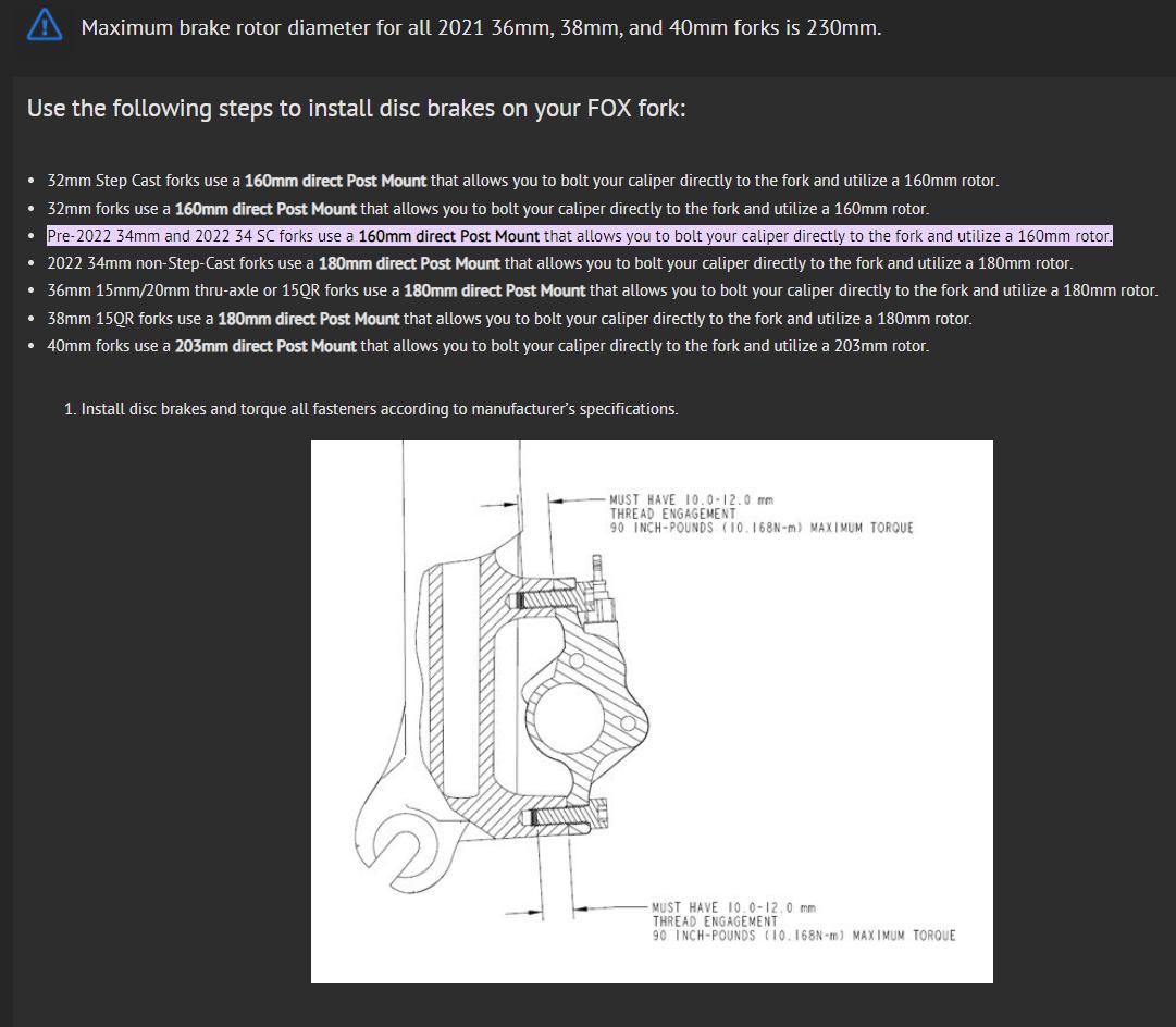

Thanks for another great write up. I do have an observation though. Everything i see says the Fox 34 fork has a 160mm post mount but my M20 with a Fox 34 came with a 180mm rotor up front with no adapters of any kind for the brake caliper. I installed a SM-MA-F203P/PM on my fork which spaced it out perfectly for the 203 rotor. Is the SM-MA-F203P/P spaced any different from the SM-MA-F203P/PM? Or is it just considered more rigid? I have noticed under hard cornering i do get a bit of brake rub up front. So if its more rigid, i may consider swapping it.
Malicefox,

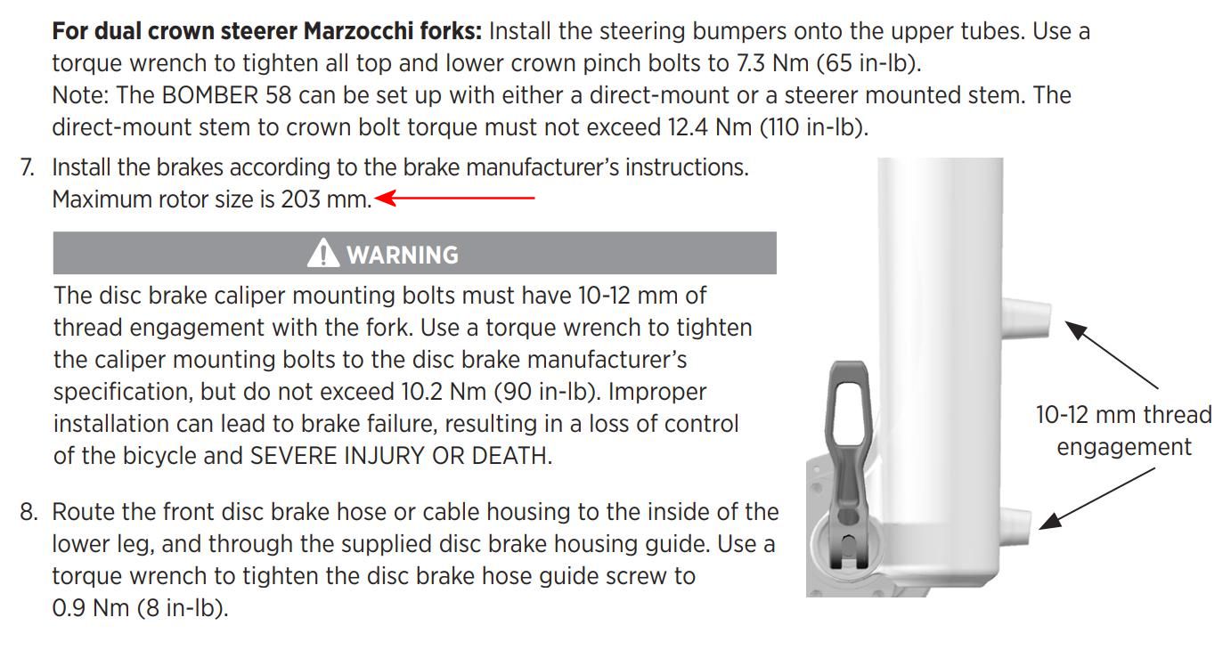

Thank you for pointing this out. You are 100% correct. I went back and checked with Fox who also owns Marzocchi. All pre-2022 Fox 34, Fox 34 Step Cast and Marzocchi Bomber Z2 suspension forks have 160mm post mounts. However in 2022, Fox changed the post mounts on the Fox 34 and Fox 34 Step Cast to 180mm post mount. I've made subsequent changes to the caliper adapter charts to reflect this fact. I and the other forum users appreciate the heads up.
Here is some additional information from Fox's website. As a side note, Fox does not recommend anything larger than a 203mm rotor on Fox 34 and Marzocchi Bomber Z2 forks with 160mm post mounts.
Marzoochi Bomber Z2 Owner's Manual

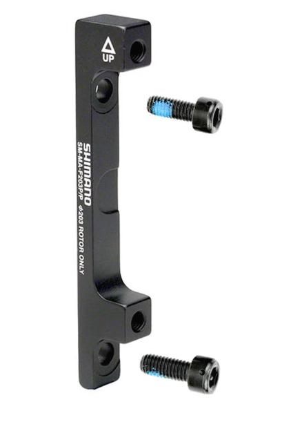

The SM-MA-F203P/P caliper adapter has a different mounting and structural design than the SM-MA-F203P/PM caliper adapter. According to Shimano because it is flat and not curved, it's slightly more rigid structurally. I've never used a flat caliper adapter on a 180mm post mount. I'd recommend sticking with the standard post mount, curved style. I've attached pictures of a "Post to Post" SM-MA-F203P/P flat adapter and a "Post Mount" SM-MA-F203P/PM curved adapter. Note the differences in mounting design. You will typically see flat Post to Post caliper adapters on road and gravel bikes.

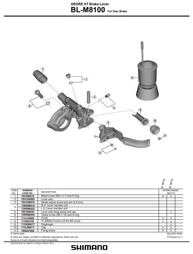

The free stroke adjust on the XT levers don't actually work. The only thing better on the SLX and the XT levers compared to the DEORE (BL-M6100) is the fact that you can replace the lever blades with Flo Motorsports PRO 120 Lever blades.
Shimano doesn't sell replacement lever blades for the BL-M6100 (I guess they expect you to throw it away even though removing the blade is the same procedure as the other SLX and the XT levers - lever blades are the first thing to bend on a crash), and the Flo MotorSports PRO 120 Lever blades only fit on the SLX (BL-M7100) and the XT (BL-M8100) levers.

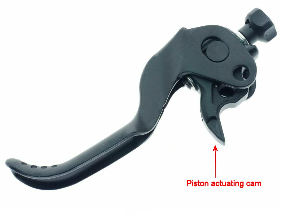

I would not say outright that Shimano's free stroke adjustment "Does not actually work." Let's just say it "Struggles" a lot with being pretty much useless as compared to other brake manufacturer's and their free stroke customization. I've always liked the free stroke barrel adjuster on the SRAM Guide and Code brakes which allows me to make a quick and tool free adjust while on the trail.
You are correct, Shimano does not offer a replacement brake lever blade for the Deore BL-M6100 brake lever. I'm guessing the reason for this is economics. A brand new Deore BL-M6100 brake lever assembly can be purchased for about $30.00. If a lever blade were offered, by the time you paid the purchase price, shipping and tax, the price would be about the same. A SLX lever can be purchased for about $16.00 online.
I've never swapped brake lever blades between a Deore lever and SLX, XT, etc. I wonder if the SLX would fit on a Deore BL-M6100 brake lever assembly? Anybody try it before? For those interested, here are the parts sheets for the Deore BL-M6100, SLX BL-M7100 and Deore XT BL-M8100 brake levers:
Deore BL-M6100 Brake Lever
SLX BL-M7100 Brake Lever
I tried installing Flo Motorsports Pro120 MTB lever blades on the BL-M6100 and couldn't get it fitted. No problems fitting it on a BL-M7100 and a BL-M8100 lever though. I'm assuming the lever blade attachment is slightly different albeit you remove a BL-M6100 lever blade exactly the same way (grub screw, and push the pin out) as you would an BL-M7100 or the BL-M8100.
I've added a Deore XT brake lever to my post above. When you look closely at the Deore, SLX and XT, you can see that the axle pin on the Deore lever is located in a different position than on the SLX and XT brake lever body. I'm guessing this alters the piston actuating cam design/size on the Deore blade and make the XT/SLX blades incompatible. Is this what you found when you tried to swap blades?
XT brake lever blade

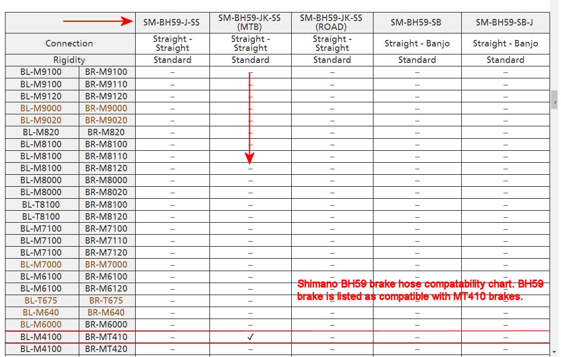

Do you know if it is possible to use SRAM 6 bolt centreline 220mm and 200mm rotors with the MT4100 brakes? Maybe with post mount adapters of some kind?
I have just purchased a Rise H30 and I have 2 sets of wheels with a SRAM 220mm front and 200 rear and a Fox 36 setup that I’d like to keep using from my outgoing bike.
Any help appreciated. Many thanks.
Hjwemtb,
Yes, it is possible to mix one manufacturer's brake rotor with another manufacturer's brake caliper. Rider's do this all the time for various reasons. I have not combined a Shimano MT410 caliper with SRAM rotor. I hesitate to provide assurances it will work because I've never done it. Theoretically it should work provided the set up is done correctly.
If you do combine a MT410 brake caliper with SRAM rotor here are some considerations you should know about.

Brake Pad Overhang is an issue that can occur when an incorrect sized caliper adapter is used and spaces the caliper on too far, or not enough. Mounting a correct sized caliper adapter incorrectly, i.e. 180 degrees backwards will also lead to brake pad overhang.
Use the correct adapter and make sure it's orientated correctly.
1. The Rise H30 comes with either a Marzocchi Z2 or Fox 34 front fork.
Year 2021, Marzocchi Z2 and Fox 34 forks which have a 160mm post mounts are limited to a maximum front rotor size of 203mm. Year 2022, Fox 34 with 180mm post mount is limited to a maximum rotor size of 220mm. Year 2022, Marzocchi Z2 with 160mm post mount is limited to maximum front rotor size of 203mm.
If you increase rotor size, you must use the correct corresponding caliper adapter which will space the caliper out to match the larger diameter rotor. You must use the correct sized adapter or you will ruin your brake pads. As an example, if you plan to use a 200mm SRAM rotor on a Marzocchi Z2 with 160mm post mounts, you will need to use a 40mm caliper adapter (200mm rotor - 160mm post mount = 40mm). The correct SRAM 40mm adapter is SRAM Part # 00.5318.007.003.
Note: As a rule of thumb, you can safely use up to a 43mm caliper adapter. Anything past 43mm creates a safety issue due to leverage exerted on an unsafe/oversized adapter during braking. Long term flex on the bolts and post mounts would result in metal fatigue which could potentially shear the bolts or post mounts off and lead to really really bad shit. Therefore if your fork has 160PM then the maximum rotor size is 203mm. If your fork has 180PM, then the maximum rotor size is 220mm.
2. The H30 comes stock with Raceface AR-30 wheels with have Deore or equivalent center lock hubs. You can purchase an adapter that will allow you to use a six bolt rotor on a center lock hub.
3. When mixing disk brake components, there is the chance of encountering a compatibility issue or instance of "Brake Pad Overhang."
I once used SRAM calipers on a Shimano Ice Tech rotor. The two were compatible and worked, however the enlarged holes on the rotor's braking surface rapidly wore my SRAM brake pads down.
Not all manufacturer calipers play well with other manufacturer brake rotors. I once tried using a two piece Hope rotor with my SRAM G2 caliper. No matter how much I adjusted the caliper, the rotor's two piece mounting rivets rubbed the caliper.
Another area to take into consideration is rotor thickness. Some manufacturers use a much thicker brake rotor than Shimano. Shimano brake rotors are 1.80mm thick, whereas SRAM brake rotors are 1.85mm thick. The added thickness may require depressing the pistons farther into the caliper. To do this, you may need to bleed off brake fluid at the lever or caliper.
Shimano uses 160mm, 180mm, 203mm and 220mm diameter brake rotors. SRAM, on the other hand uses 160mm, 180mm, 200mm and 220mm rotors. The difference in rotor size on Shimano's 203mm rotor means It's easy to inadvertently use the wrong brake caliper adapter. As an example, say you want to use a 200mm SRAM rotor on a Marzocchi Z2 with 160mm post mount (PM). You will need to use a SRAM 40mm brake caliper adapter. You can use a 43mm Shimano brake caliper adapter, however this leads to a situation called "Brake Pad Overhang."
Here is a great article that may help you.
I hope this helps you out.
Be safe, Rod

If you visit Shimano's technical webpage section, you will find compatibility charts listed for various components including brake hose. According to Shimano's brake hose compatibility chart, the MT410 brake system is NOT compatible with BH90 brake hose. The MT410 brake system is listed as compatible with BH59 brake hose.
Shimano's BH59 brake hose compatibility chart lists the SM-BH59-JK-SS (Straight fitting on each end) as being compatible with the MT410 brake system.
Shimano's BH90 brake hose compatibility chart does not show any compatibility with the MT410 brake system.
In my Shimano brake tech series, I identified that both the BH90 and BH59 brake hose have the same outer diameter. This would theoretically allow the use of BH59 and BH90 brake hose on the MT410 brake system. I have not personally worked on a H30 Rise and cannot verify which type of brake hose Orbea has installed on the H30. Shimano components are hard to source these days and manufacturers often make component changes in order to keep bike production moving.
I'm going to assume that you are inquiring about BH59 brake hose on your Rise H30 because you are thinking of upgrading to a four piston caliper such as the Deore M6120? The Deore M6120 caliper uses the same brake hose straight fittings as what comes stock on the H30. However, the Deore M6120 caliper uses BH90 brake hose.
There are two ways you can identify which brake hose you have installed on your Rise H30. Check the length of the front brake hose and see if you can find a BH59 or BH90 printing on the hose. The other way is to remove the brake hose at the brake lever and check to see which hose barb insert has been used.
The BH59 hose has an internal diameter of 2.3mm, whereas the BH90 hose has an internal diameter size of 2.1mm. Because of this, each type of hose uses a different type of hose insert. If you see a gold/brass colored insert, your Rise has BH59 brake hose. If you see a silver colored insert, your Rise has BH90 brake hose.
Note: if you remove the brake hose at the lever to see which insert you have, you will need to perform a small bleed after reconnecting the brake hose to the lever. The process is quick and easy, but does require a few simple tools, bleed cup and Shimano brake fluid.
Here's a good video explaining how to do a small bleed at the brake lever using a Shimano bleed cup.
The logical question to ask "How would switching brake hose types, i.e. use BH59 brake hose on a Deore M6120 brake caliper which is supposed to use BH90 hose, affect braking?" The short answer is, I don't know, I've never done it before.
I am not an engineer, but I do know that when I put my finger over the end of a garden hose, I can increase the pressure of the water via the finger restriction. I also know that a restriction lowers the volume of water being delivered out of the hose. It stands to reason that the larger internal diameter of the BH59 brake hose will deliver more fluid volume to the caliper, however line pressure will be less.
My thought is the larger piston size on the two piston caliper requires more volume whereas the smaller pistons on the four piston caliper require more line pressure. Interestingly, Shimano brake hose compatibility charts show the use of both BH59 and BH90 on two piston calipers, i.e. the MT410 two piston caliper uses BH59, whereas the M6100, M7100, M8100, M9100 two piston calipers use BH90. This leads me to wonder if there is a slight possibility Orbea may have used BH90 hose on the H30?
How would the use of BH59 hose affect a four piston caliper's braking? I don't know, I've never done it. I'm guessing it would work okay. You would likely lose some braking performance due to the loss of line pressure from using BH59 hose, i.e. you may have to pump the brake lever a tad bit more and or, possibly squeeze the brake lever a little bit harder.
If anybody has used BH59 brake hose on a four piston caliper system, I and others would be interested in knowing what the results were.

I replaced the stock Deore single piston brakes on my Rise H30 with "Shigura" setup. I ordered the Magura MT5 package from Bike24 in Europe (about $130 for calipers, lines, levers and even discs). I read up and found I needed to pull the Magura cable in through the back (banjo doesnt come off, so I snipped the olive from the lever end and went to work). I thankfully had a local mechanic who said to buy the Shimano tool to drop the motor and it was good I did as there was no way to do this without some push/pull assist underneath in the motor compartment. I also bought the park tool, really just a cable with a threaded end that worked great. I did find that the cable was prone to binding as I pulled it up the down tube, it must have been hitting another cable and or the battery. So I was pushing as much as pulling. You have to buy shimano barbs and Magura olives to make this work right.
At first I tried the Deore levers but they were pretty meh (very linear). So I picked up some XT servo levers and popped those on. Overall these brakes are almost as nice as my TRP EVO DH brakes on my (analog) enduro, I have been messing around with different sintered pads to try to improve the front brake performance. BTW, dropping the motor is a really easy job, I need to learn how to pull the battery the next time so that I can bring the Rise on a plane to my other house 900 miles away and just have a spare battery there.

In order to be successful, you need to do a little prep beforehand. The trick is to use the machine screw method which I detailed in the initial posting on this thread.
Visit your local hardware store. Take a small piece of Shimano BH90 brake hose with you. Buy a fine thread machine screw of approximately 1.5 inch/38mm in length which will thread into the brake hose. You want the threaded fit to be firm and not easily threaded.
There is a lot of friction where the brake hose travels along the motor and out of the top of the bottom bracket shell. You'll want to divide the hose pulling process into two phases. The rear chain stay is phase one. The frame is phase two.
Start at the rear caliper by cutting the brake hose. Thread one end of the machine screw halfway into the "Old" hose on your Rise. Cut the head off of the machine screw. Thread the new replacement brake hose onto the other end of the screw. Make sure both hoses are threaded tightly together so that there is no gap or lip that can hang up somewhere on the frame. You want the connection where the two hoses meet to be smooth with no protuberances (Fancy word).

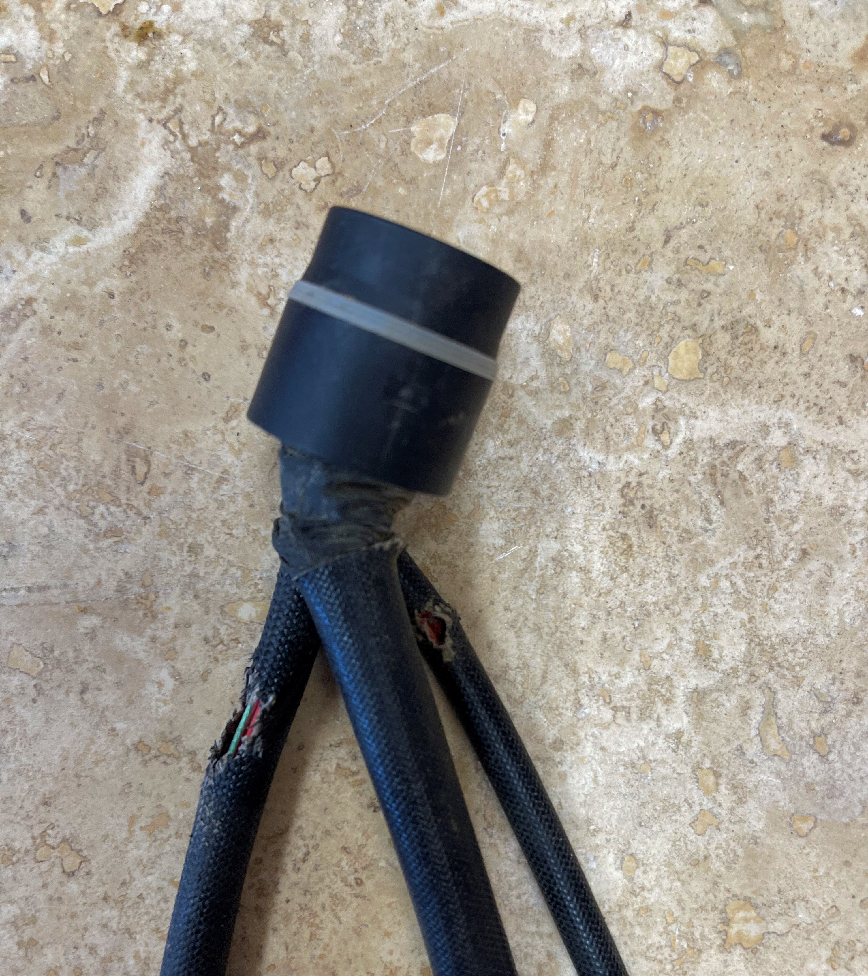

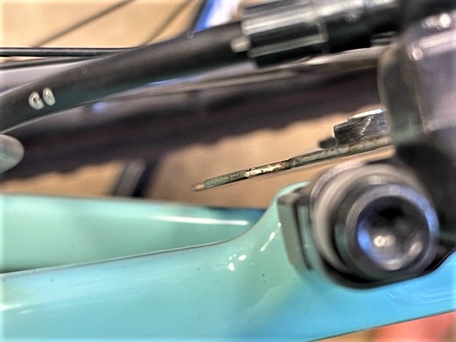

Occasionally during your ownership of the Rise, you do want to drop the motor and check your wiring harness for chaffing. The Carbon Rise does not have any separate routing channels in the frame for cables, hoses and wiring harness They are all squeezed together through the same tight area. Because of this, things tend to rub and chafe. This is especially so where the down tube meets the motor.
In the picture below, my Rise wiring harness has about 2,300 miles on it. Note the rub through of the protective sheathing which was caused by contact with the brake hose and cables. I used a cloth based electrical friction tape to repair the harness sheathing. Also note that several of the wires that comprise the harness are very thin and can be easily broken. If they break your bike will throw a fault code and stop working. It pays to occasionally drop the motor and give things a check.

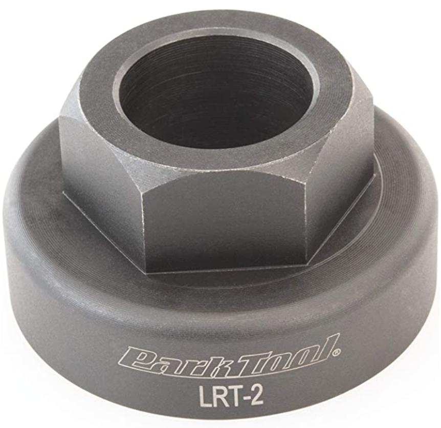

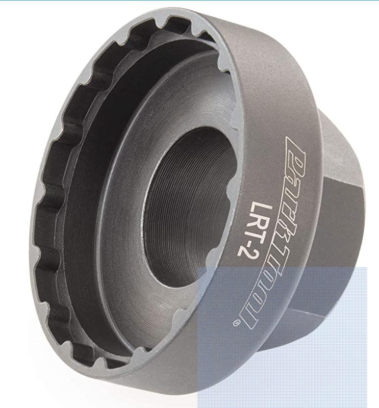

One last suggestion. If you don't have one already, consider buying Park Tool's LRT-2 lock ring tool. It's used to remove the chain ring lock ring nut on the EP8 motor. If the brake hoses should separate during the process, you won't be dead in the water with no bike while waiting to source the tool. Should the hoses separate, you'll be able to drop the motor and route the hoses.
Note: Five of the six bolts motor mounting bolts can be easily removed. The sixth bolt is partially obstructed by the chainring and cannot be easily removed without forcing the bolt past the chainring. This tends to scratch the bolt's black coating. It's easier just to remove the crank arm, chainring and the chain guide. You'll then have easy access to the bolt. You need the lock ring tool to remove the chain ring. It's not a difficult process to drop the motor. It takes me about five minutes. I've posted instructions on how to drop the motor in various threads on the Orbea Forum.
