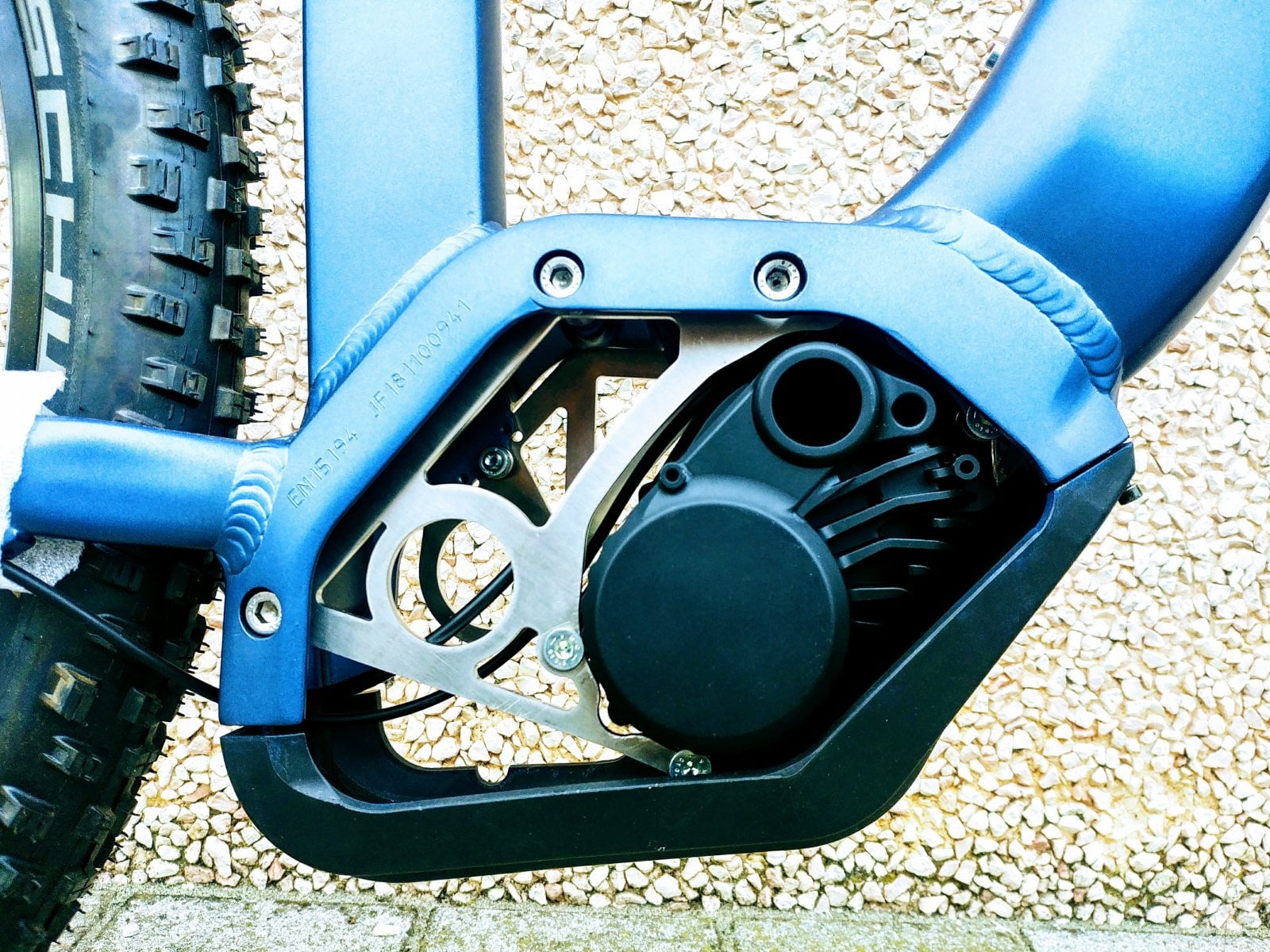

The main reason that prompted me to join the forum ( aside that it is a beatiful forum :) ) was that some ebikers with Shimano motors ( and others with Bosch motors) on their bikes asked for the Lightest as replacement after that the warranty is expired. Then I saw this thread.
We can actually retrofit Shimano and Bosch frames with the Lightest motor thanks to a motor mount which is compatible with Shimano fixing points and which integrates the bottom bracket. See below pictures.
Motor mount adapter
Lightest motor on Bosch frame
Lightest motor on Shimano frame, without cover on the left, and with cover
We haven't yet optimized the design for manufacturing, so I joined to understand if we can support you in that type of installation. In particular, my goal is to understand how many people have this problem ( not finding a standard motor for their warranty-expired bicycles) and what's their target price . That will help us in deciding what's the most cost effective production technology for the motor mount, and thus its price. For the price of the motor itself, you can check on lightest.bike directly.

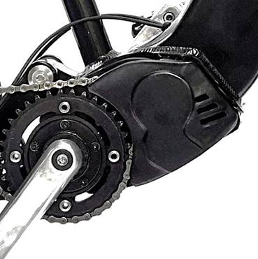

In the last picture it shows the chain not engaging the chain-ring at the top. Is that not leading to rider torque distribution over less chainring teeth and thereby more wear?

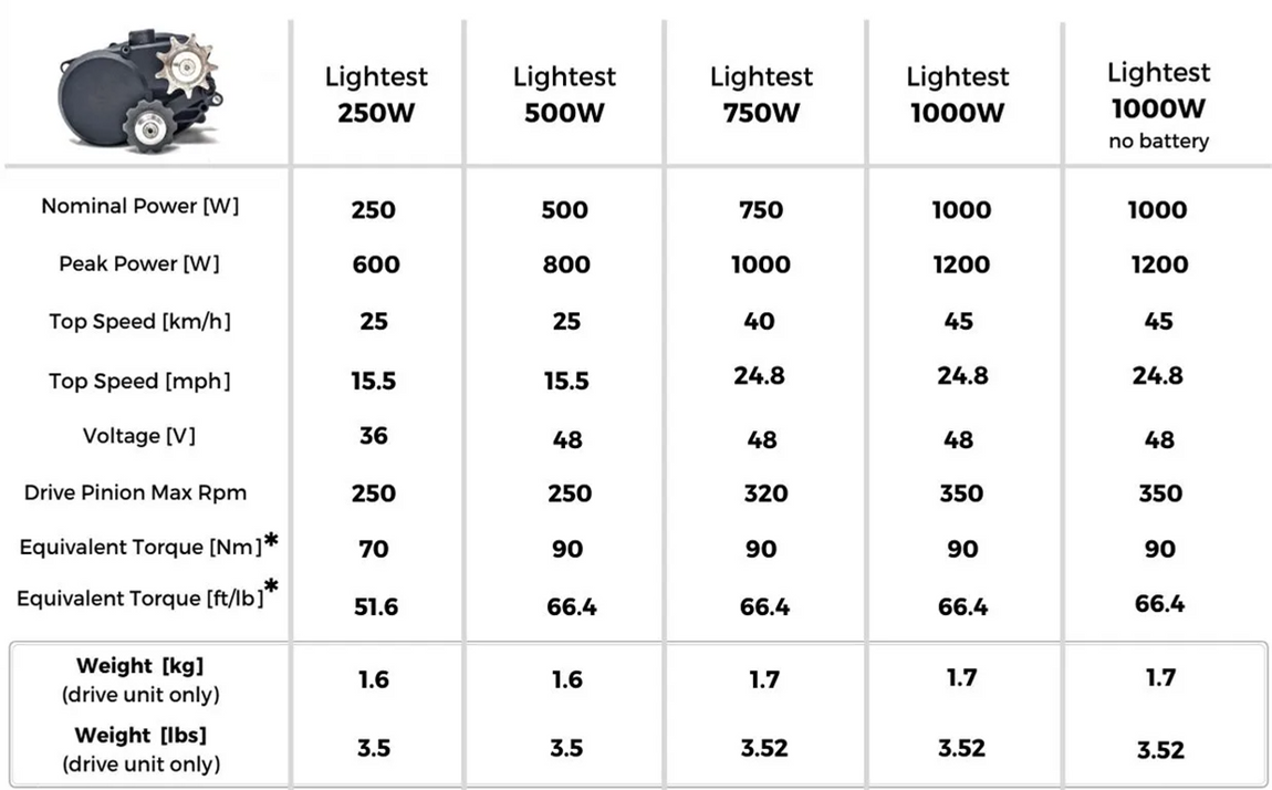

The motor can work with any battery, 36V for the 250W, and 48V for the 500W version and above, up to the 1000W version.
See specs here:
The important thing is that the battery can supply enough current to reach the max motor power of the version you choose.
Thanks for your feedback. We designed the motor to be very serviceable: you can basically change any part of the motor without taking it down from the bike frame. The part count of the motor is very low. For the specs, see the previous post, it can reach 90Nm.
About the chain: the system is similar to Rocky Mountain. The 90% of the torque is transmitted by the first 8 teeth of the chainring, so we didn't see any difference from standard chain wrapping.
