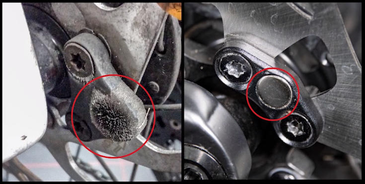

Great thread. One learning we've come across when using sintered pads (specifically useful to eBikes) is that when metal dust comes off the pads under braking it is naturally attracted to anything magnetic. For most brake pads/rotors this is a small amount - however under heavy braking with some pads the metal dust can build up on the speed sensor magnet (fixed to the rear rotor with two bolts).
Worth checking. In a few circumstances we've seen the speed sensor magnet bolts become magnetized - metal dust then sticks to these and the net effect is that the speed sensor signal to the motor is tripled and the motor believes you are going 3 times faster than you really are & slows you down to match 1/3 of the legal speed limit. Hence a regular service tip would be to check your speed sensor magnet - make sure it is clean and no metallic dust is stuck to it. If the bolts do become magnetized, simply remove them and drop them on a hard surface a few times to demagnetize them.
So this would also upset the walk function?
