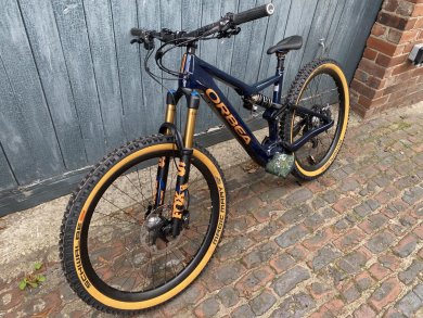

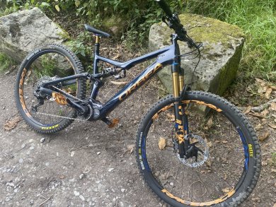

I’ve 2.6 on the front, I thought max actually was 2.4 on the back, I’m actually changing to 2.4 / 2.4 mainly as I’m trying skinwall tyres nexts just for the look of them more than anything!
The blue papers for rise says max 2.5. For winter have 2.6MM up front & 2.4 BB for rear currently have 2.4 bontrager XR4i upfront & 2.6NN in 27.5 flavour although just swapped shock back to 140mm travel (TTX coil) but not ridden it yet
2.6 DHF 2.4 DHR no inserts on the lighter wheelsets trail stuff (although I do wonder about the rocks I’m hitting!) and 2.4 x2 MM/inserts on the skinwall heavier days for the rougher XC stuff etc, I’ll or having a range extender anyway so given up on weight for these days out
