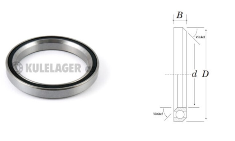

The complete spec for the lower bearing (Orbea Rise M20 2021) is 40x52x7 mm - 45x45 deg
I was not able to source a stainless steel version in Norway, got mine from kulelager24.no after 3 days.
I believe the bearing is semi-integrated?
Below is a picture showing the geometry

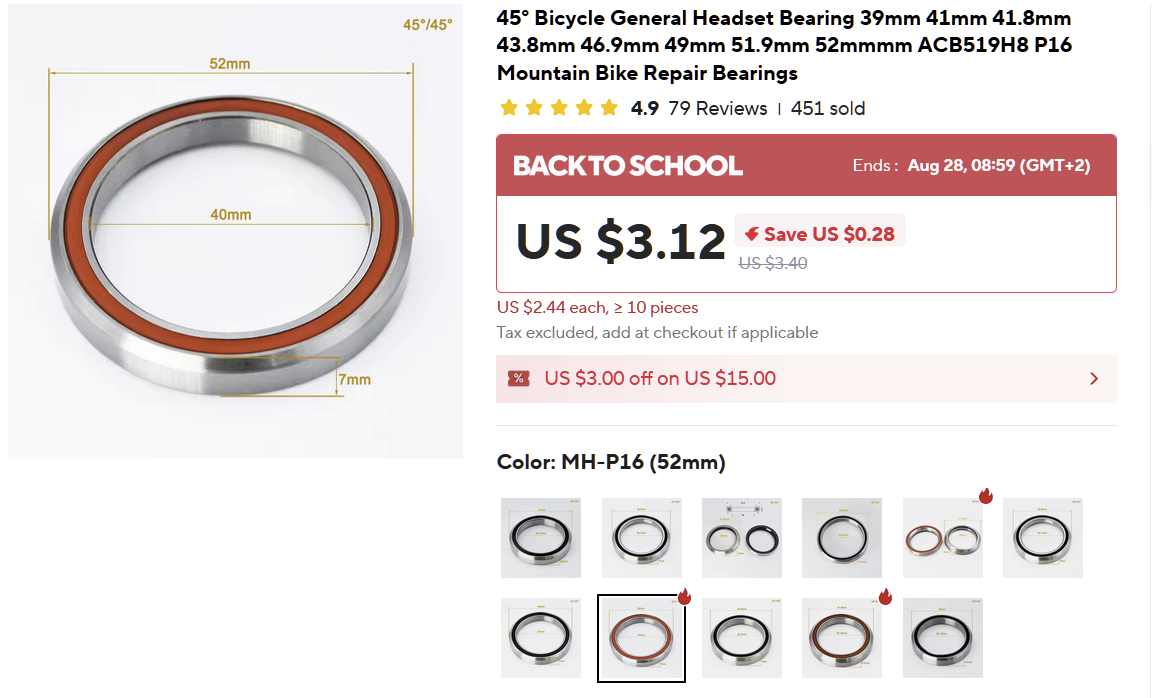

AliExpress sells the bearings (MH-P16) for as low as US $ 3.12 (+VAT and shipping if applicable).
They are obviously not stainless, but with the low price I can buy a set of 6 (free shipping) for the same cost as the one I bought in Norway (also not stainless), and replace as required!
