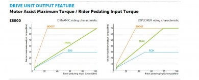

Ahhh yes... That's where I struggle to fully comprehend :) . It's funny though, I've seen several graphs depicting rider torque vs motor torque that are linear up to the max torque setting. The linear slope up to the max is just steeper for higher assist "percentages". Maybe that's why I'm struggling so mightily trying to make heads or tails of how the various factors influence the motor assist level.
graphical representations you mean?
in use an Emtb with gearing, cadence and effort changing constantly that's simply not how the motors behave
Here's the type of graph that I've run across several times.
Yes. Like I said. Graphical representations. Simplified marketing information to get the idea of how each mode behaves across to the punter.
