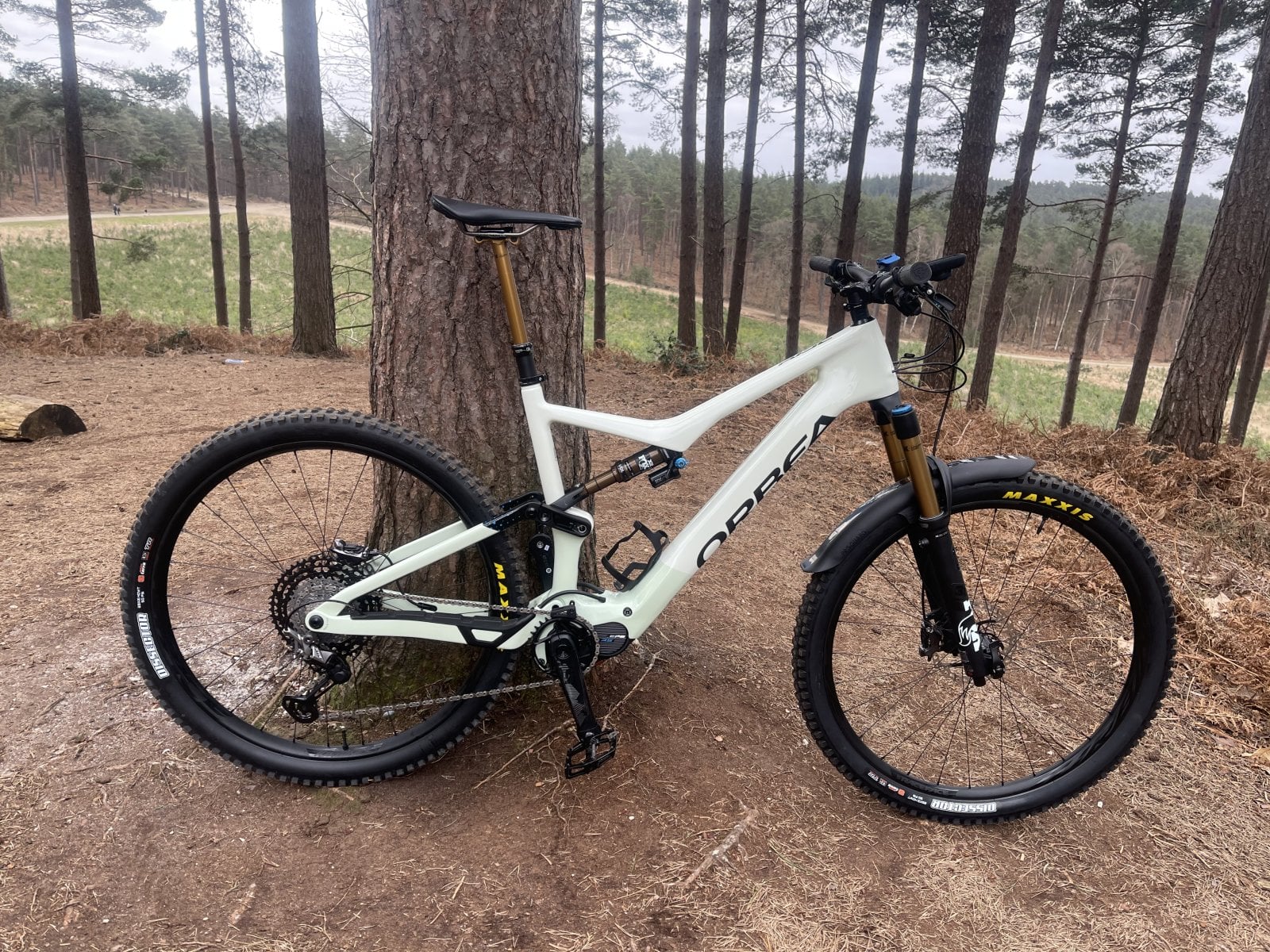

My View attachment 57052View attachment 57053only slight gripe this is the first bike I have owned / ridden with a shimano xtr transmission , my Levo has the basic gx transmission and to be fair the gx shifts faultlessly every single time and seams to shift cleaner then the xtr was on my rise
I am assuming the bike shop probably hasn’t got it dialled in quite correct surely
the xtr should be much better than a sram gx ??
Double check the pulley wheel gap.
Will do thank you
Is there a like a pulley guide distance tool like sram have for the shimano mech ?

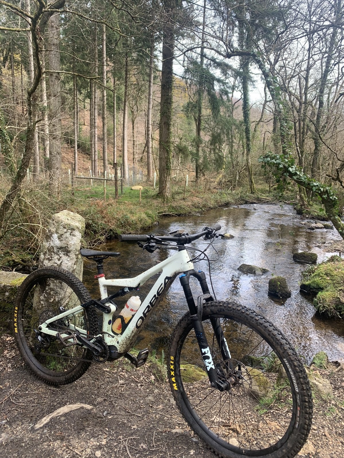

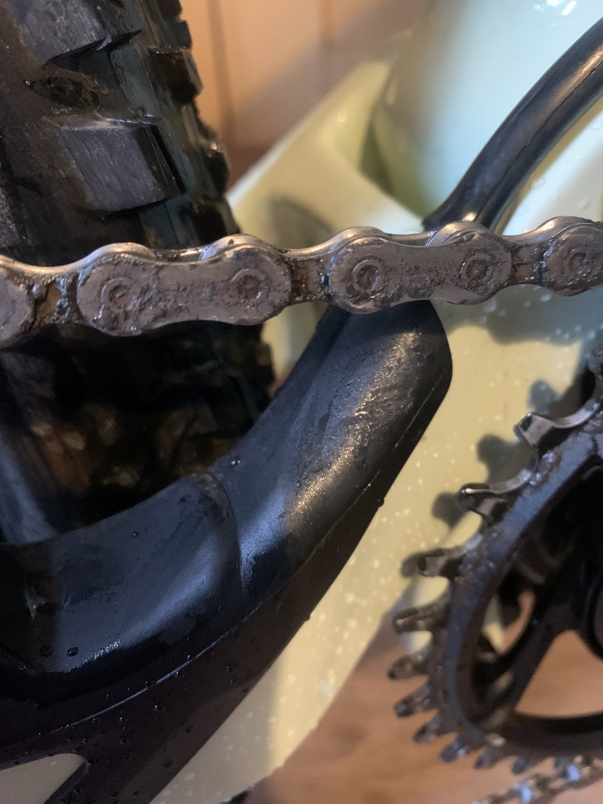

First big ride today, 44miles from sea level up onto Dartmoor and a few DH tracks in the woods. Mostly on eco upto the moor and then trail/boost for some of the steep climbs. 5 hrs in total and got back with 15% battery. A few things I’ve noticed and may need to sort out, the Dps shock is blowing through its travel a bit too easy, might switch back to my spare Monarch Plus rc3, the rear tyre has to go, the chain is wearing out the frame protector right by the chainring, might need something more there .
View attachment 57095View attachment 57096
The bike should have shipped with the larger volume spacer. Put that in and reset sag.
My M10 came with the spacer - It comes in a small Orbea branded box along with the manuals, tubeless valves, charger etc ask your LBS to give it to you if they kept it.
@DanMcDan - a larger chainring might be your solution to the wear on the protector. It will move the chain up a little and also mean you are in the smaller cassette sprockets less, increasing the height further.
They make 34t and 36t at £50 each, or a standard Shimano steel one would fit too, and last a lot longer but costs double and weighs more...
Funn do direct mount chainrings for Steps system too
Its on my to do list for mine, but not a cheap swap when you need to buy a specific tool, new chainring and possibly a new chain too!
