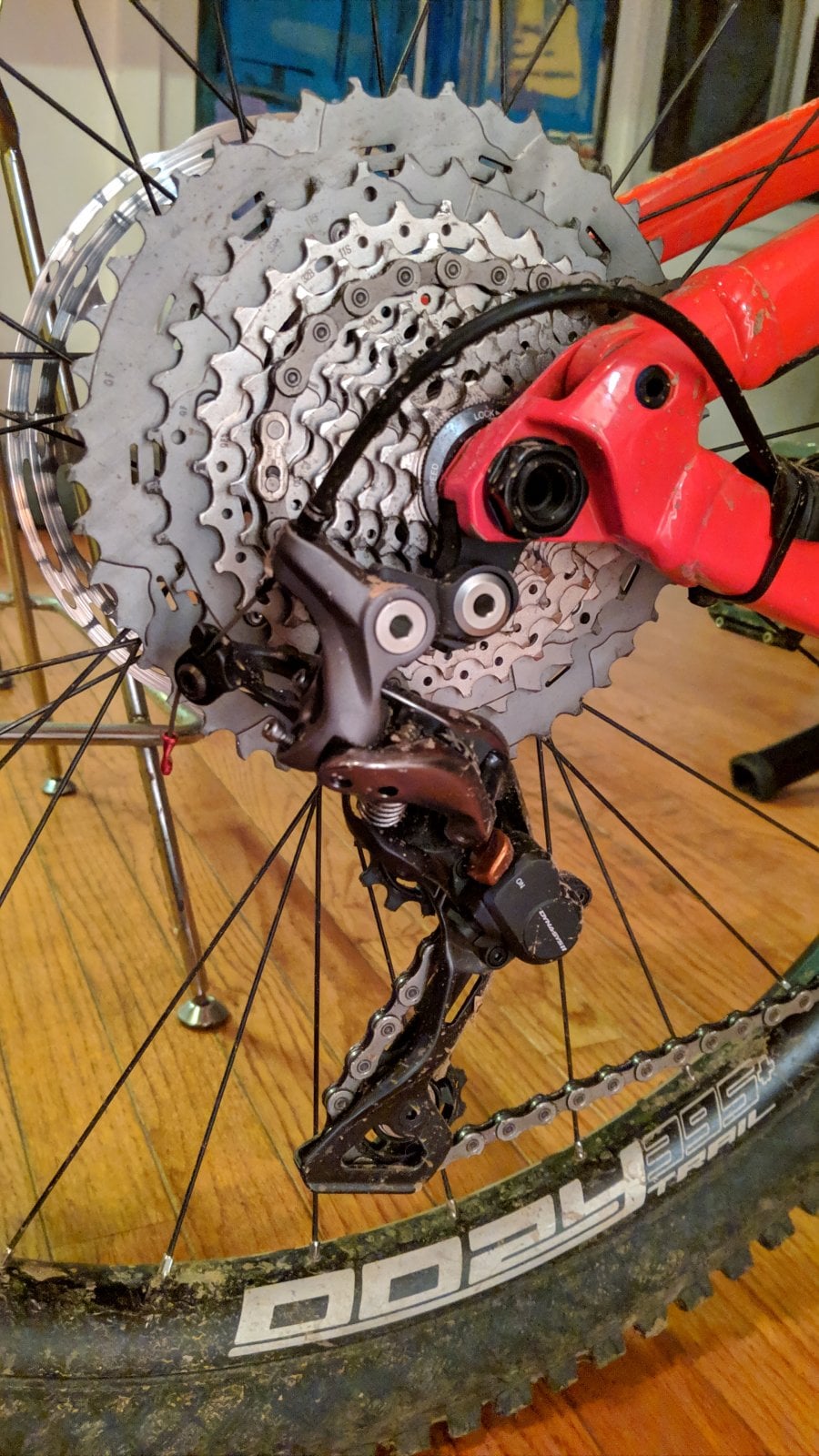

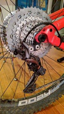

I've got a XTR M9000 shifter, XTR M9000 derailleur, XT M8000 11-46t cassette and a XT HG701chain on their way from CRC since they will stop shipping across the pond come January first.

First ride with the Shimano drivetrain, very pleased with the performance. Replaced the hanger for good measure, the original one was slightly bent as suspected. Upshifting under power comes with a satisfying click. Downshifting is equaly as good as there is a nice lever feel for single shifting, although multiple downshifts are available with one sweep.
I'm not sure I like the closer ratios, but time will tell. Some shifts felt like nothing changed, but other times, it was nice to fine tune the cadence.
