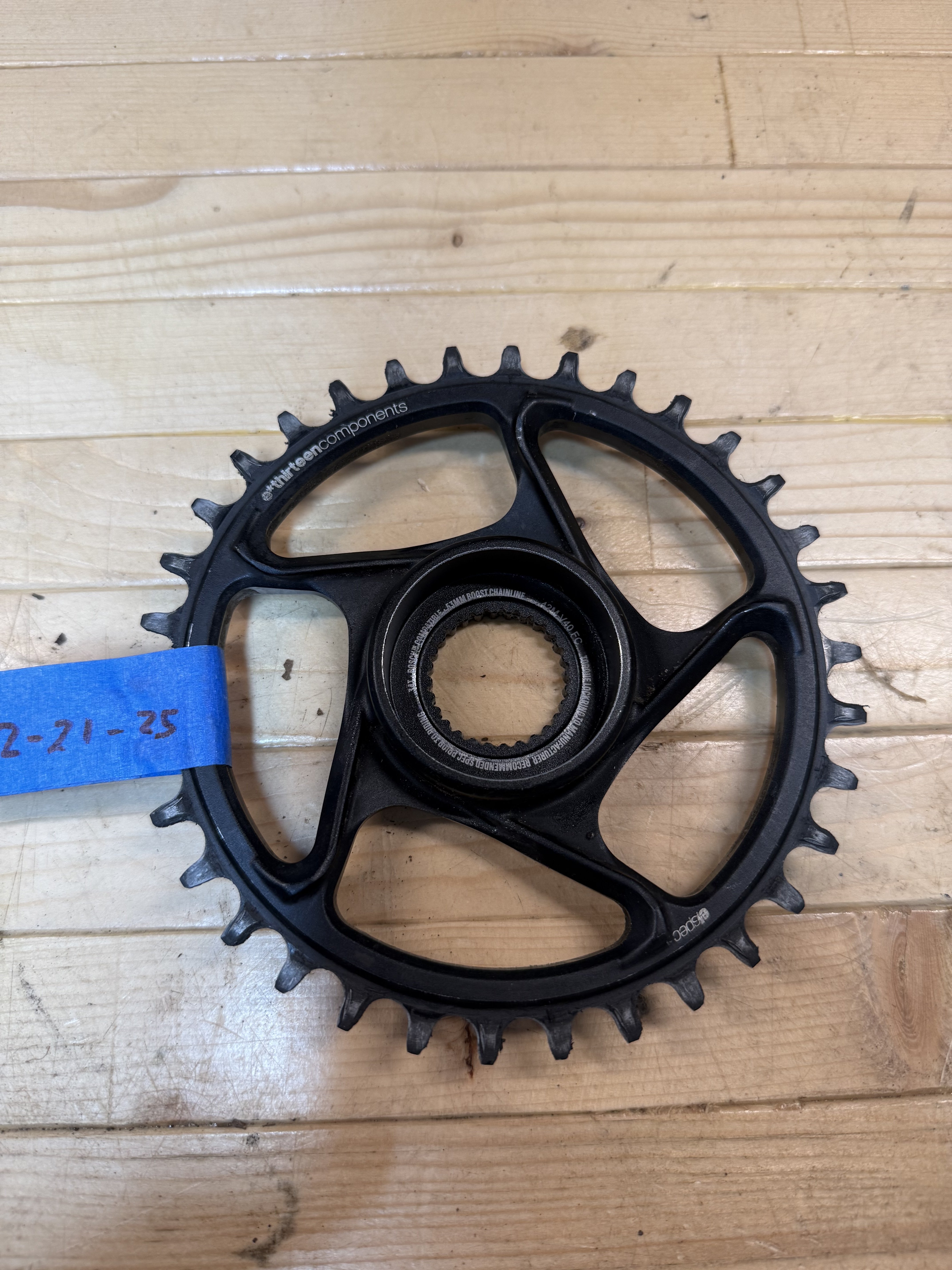

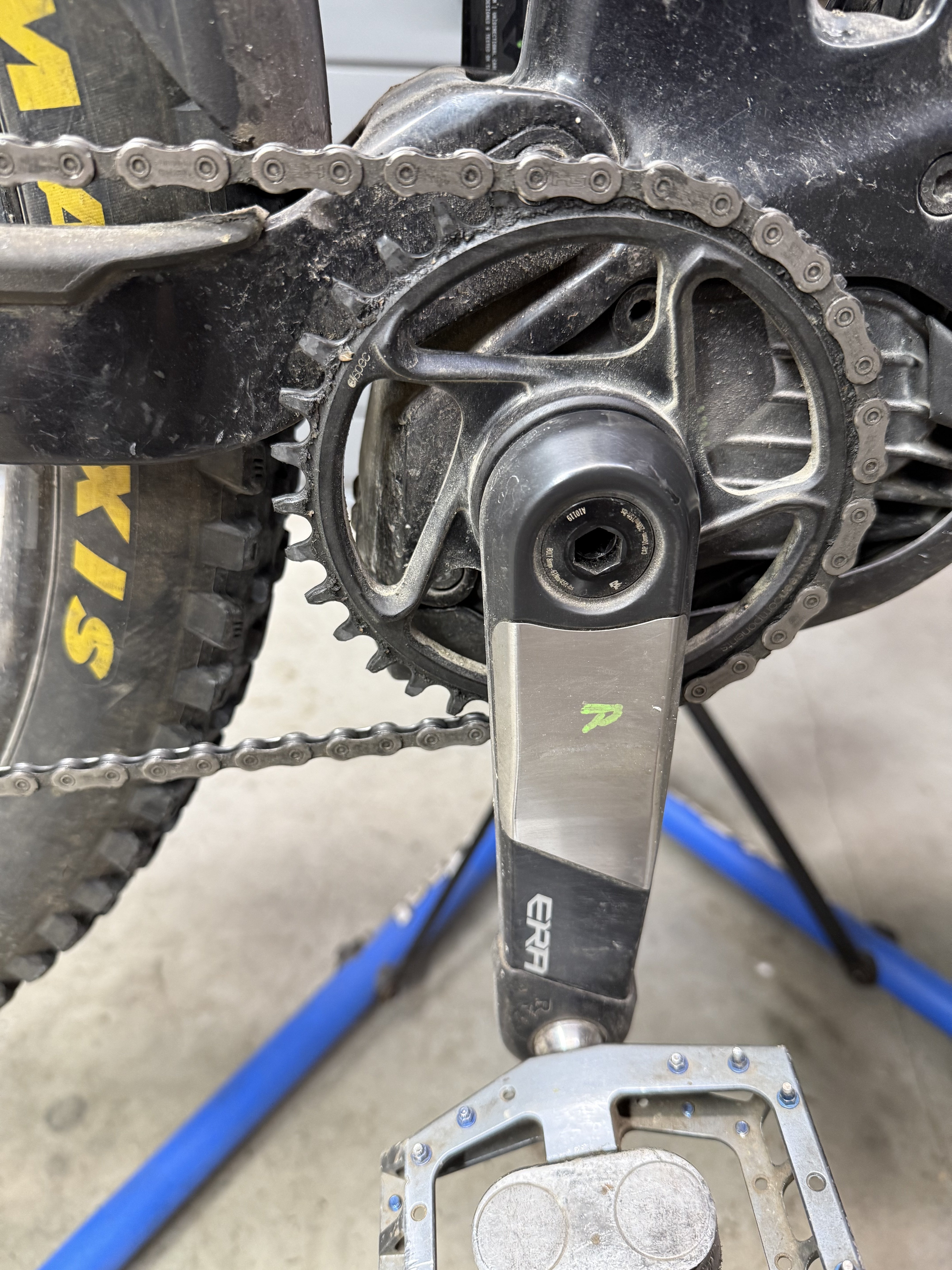

I’ve developed the “crackin” noise as I apply torque when starting a ride. Recently installed a new e13 chainring to replace the old e13 chainring. Originally there was a brass O ring and two plastic O rings installed on/behind the OEM chaining. Because of the shape of the new e13 chainring …I removed the brass O ring. Only then was the correct chain alignment achieved with the Shimano XT cassette. I also use the Shimano 8100 chain with the the SRAM AXS derailer. That setup was quiet, smooth and fast …until I installed another e13 chainring and started hearing the cracking noise.
I suspect a break-in period is needed …I hope.
I also removed the plastic chain guide. There was a few issues with this. Rubbed the chain, difficult to reinstall, breaks easily and prevented the cuff of my pants from passing around when sucked into the chain and chainring. (Never again will that happen to me). Chain guide is gone. IMG_0210.jpeg
Old chainring. Only chain suck was starting but no cracking noise.
Chainring loose?
It does seem like that but the new castle nut specs increases the torque up to 35nm with a new castle nut. But it’s something to watch.
