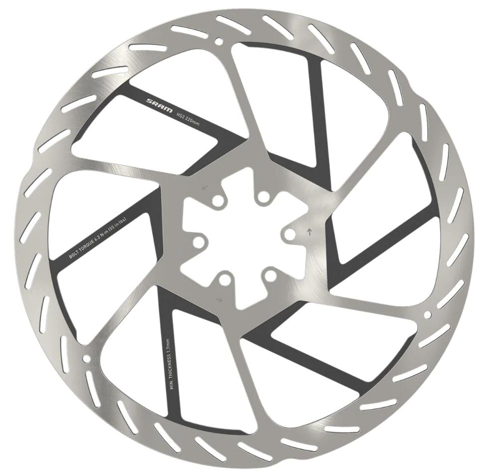

2) I see on your Levo that you are running SRAM Centerline brake rotors. I would suggest swapping out your Centerline rotors with the new SRAM H2 rotor. I installed SRAM H2 rotors on my Levo and absolutely love them. I weigh 192 pounds and run a 220mm on the front and a 200mm on the rear.
SRAM Centerline rotors have a starting thickness of 1.8mm and are recommended for replacement at 1.5mm. That's not a lot of room for wear. SRAM recently introduced the H2 brake rotor which are better suited for eBikes. The H2 rotor has a starting thickness of 2mm. A 2mm brake rotor will promote a more firm brake lever and resist heating/brake fade better. It's important to note that a Code R brake lever only has a set amount of brake fluid it can advance per lever squeeze. The thicker the rotor, the less squeeze required for the brake pads to make contact with the rotor.

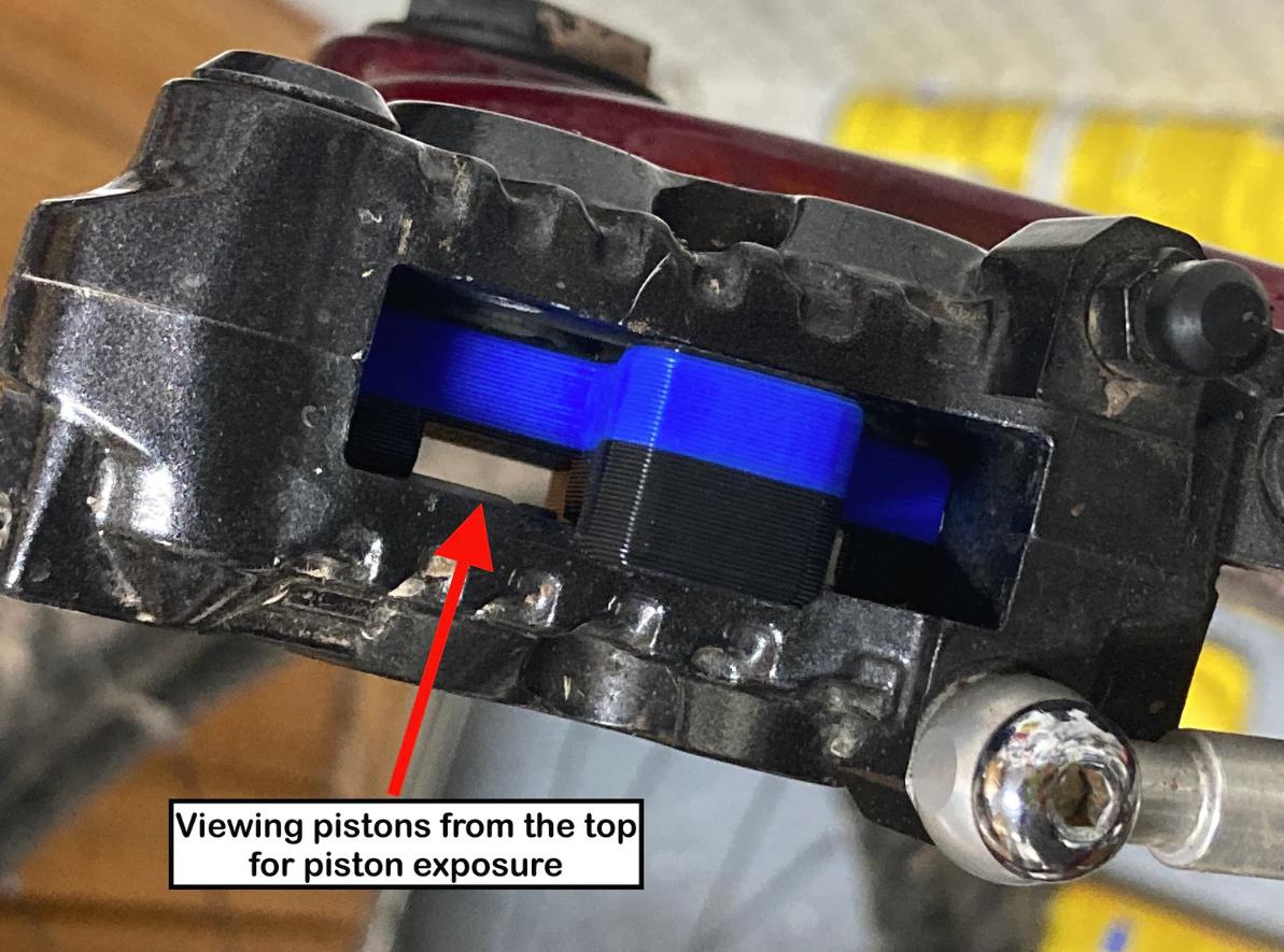

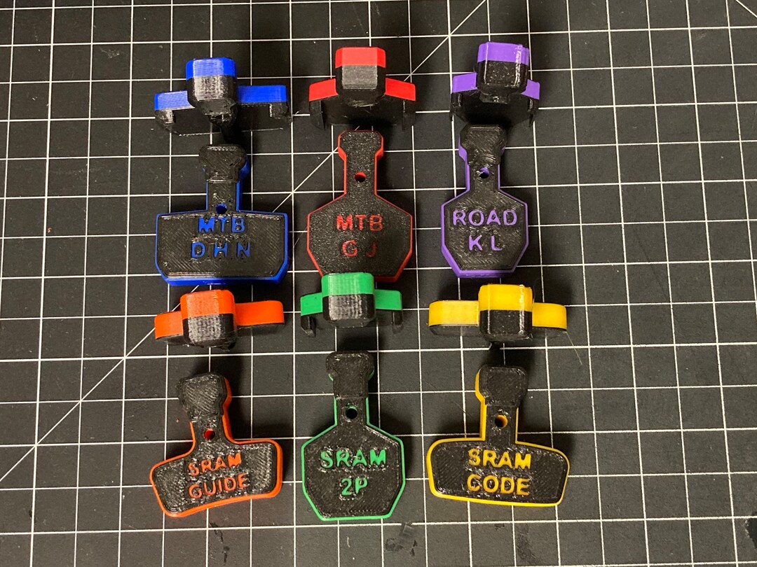

1. A sticking caliper piston can cause excessive lever throw.
Remove the caliper from it's mount and remove the new brake pads. Use isopropyl alcohol and Q-tips to clean all around the pistons. Remove all the grime you can see. Be extra cautious not to over extend the pistons out of their bores. This is bad JU JU, and you'll have to re-bleed the whole brake system if a piston pops out. When your done cleaning the pistons, take a clean Q-Tip and dip it in some DOT 5.1 brake fluid. Work the Q-Tip around each piston. The goal is to lubricate the piston seal area. Next, begin cycling the brake lever. Keep an eye on all four pistons as you do this. You want to barely squeeze the brake lever. Do this until all the pistons move freely and they can be pushed fully back into their bores. When you begin the process, you'll usually find one of two pistons that will be stuck. Lastly, use alcohol to remove all traces of brake fluid from around the caliper piston area. The caliper needs to be extremely clean. You don't want the fluid to contaminate the brake pads or attract dirt.
Note: There are people online who sale 3D printed piston exposure spacer blocks for both SRAM or Shimano. The block allows you to cycle a single piston out for cleaning. While doing so, the exposure block prevents the other three pistons from popping out of their bores. it's a really useful tool and inexpensive.
