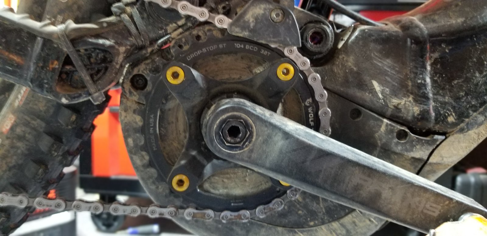

I wanted to run a HG+ chain, to test it againts the Giant choice for OEM-chain, a KMC.
The tranx is my first experience with the shimano 12 speed, I wanted to know if the chain matters.
I managed to fit a proper Shimano 12 speed Chainring (long, stupid-boring, story).
Here we have a Wolf-Tooth drop-stop ST 104BCD 32T. The significant part of the part number is the (ST) signifying HG+ chain compatabilty.
With the CR specified for the HG+ chain, it seems you may run any 12 speed chain you wish. I have been swapping chains back and forth each ride between the shimano and the KMC with no trouble at all.
The shimano chain shifts maybe a little quieter? but its not enough to matter.
The shimano chain takes less time in transition, but it's like milliseconds quicker.
The KMC seems better in mud. Better here means it doesn't rattle like a jar of marbles as often- while jammed with mud, leaves, and twigs. Neither setup is as good in the mud as a 10 speed, so this small nod towards the KMC chain is mute IMHO.
Either way, it dont matter much.
What doesn't work well is an HG+ chain, on a normal CR.
