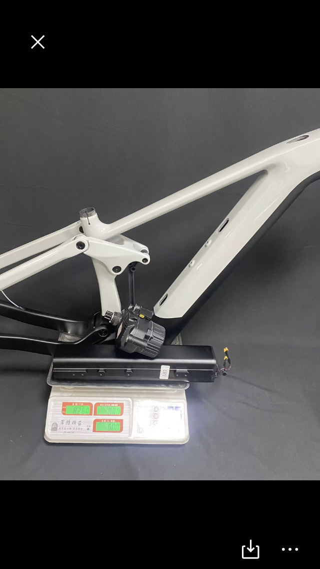

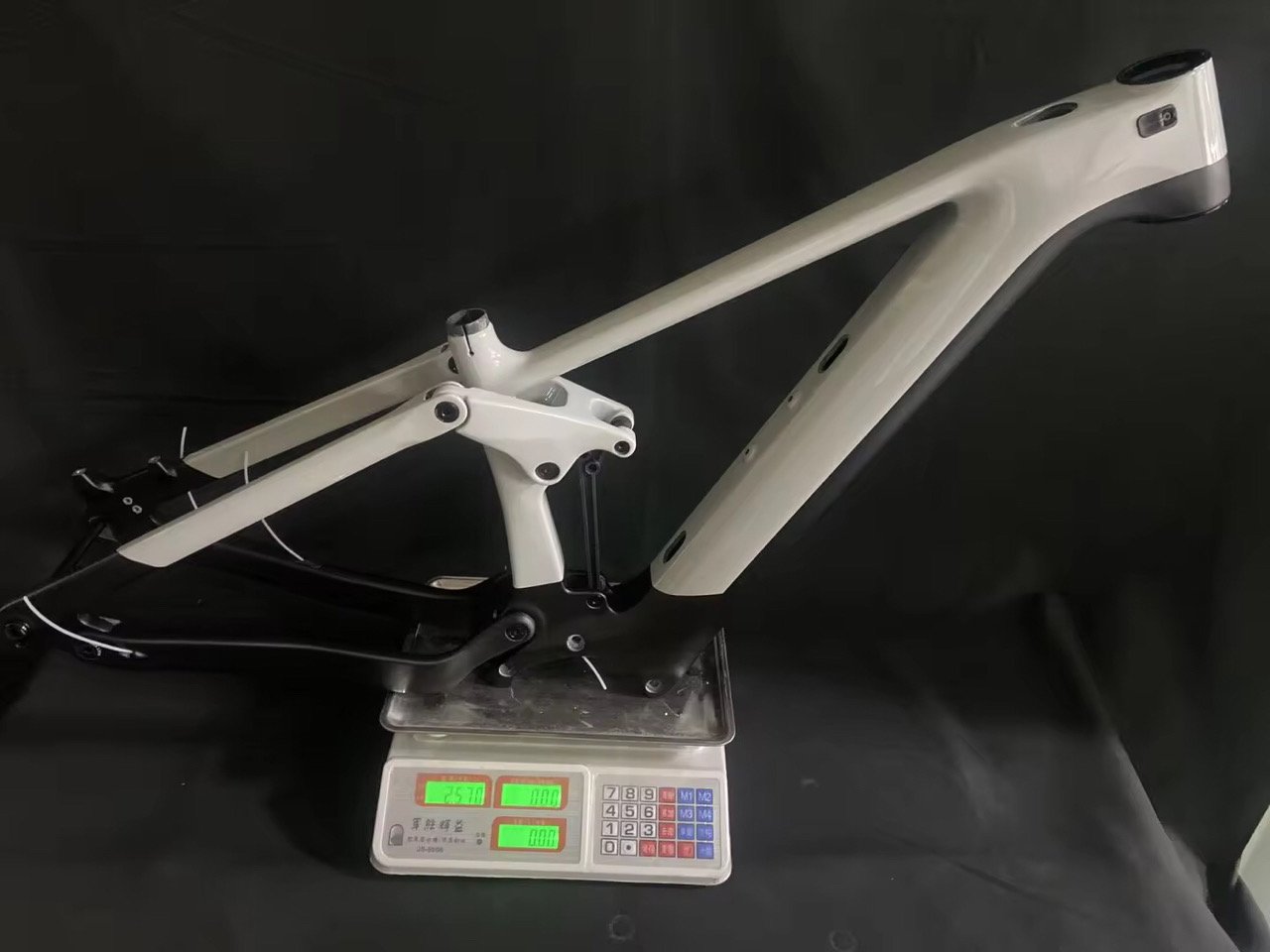

Hi, I am Berglex, a passionate mountainbiker from Switzerland. I'm currently riding a Turbo levo from 2024. I'm actually quite happy with it, but I also like making things. Since the current and very bland trend among many brand manufacturers is simply to put more and more power into the bikes at the expense of overall weight, I decided to build an E-MTB myself. I was also inspired by Rob's videos on DIY Chinese ebike. So I ordered the new CEF55 frame from SZZS Bikes, which arrived today. They also supply a new battery with 835 wh, as well as the tried and tested M820 from Bafang. I'm curious to see if I can manage to get a bike under 20 kg.

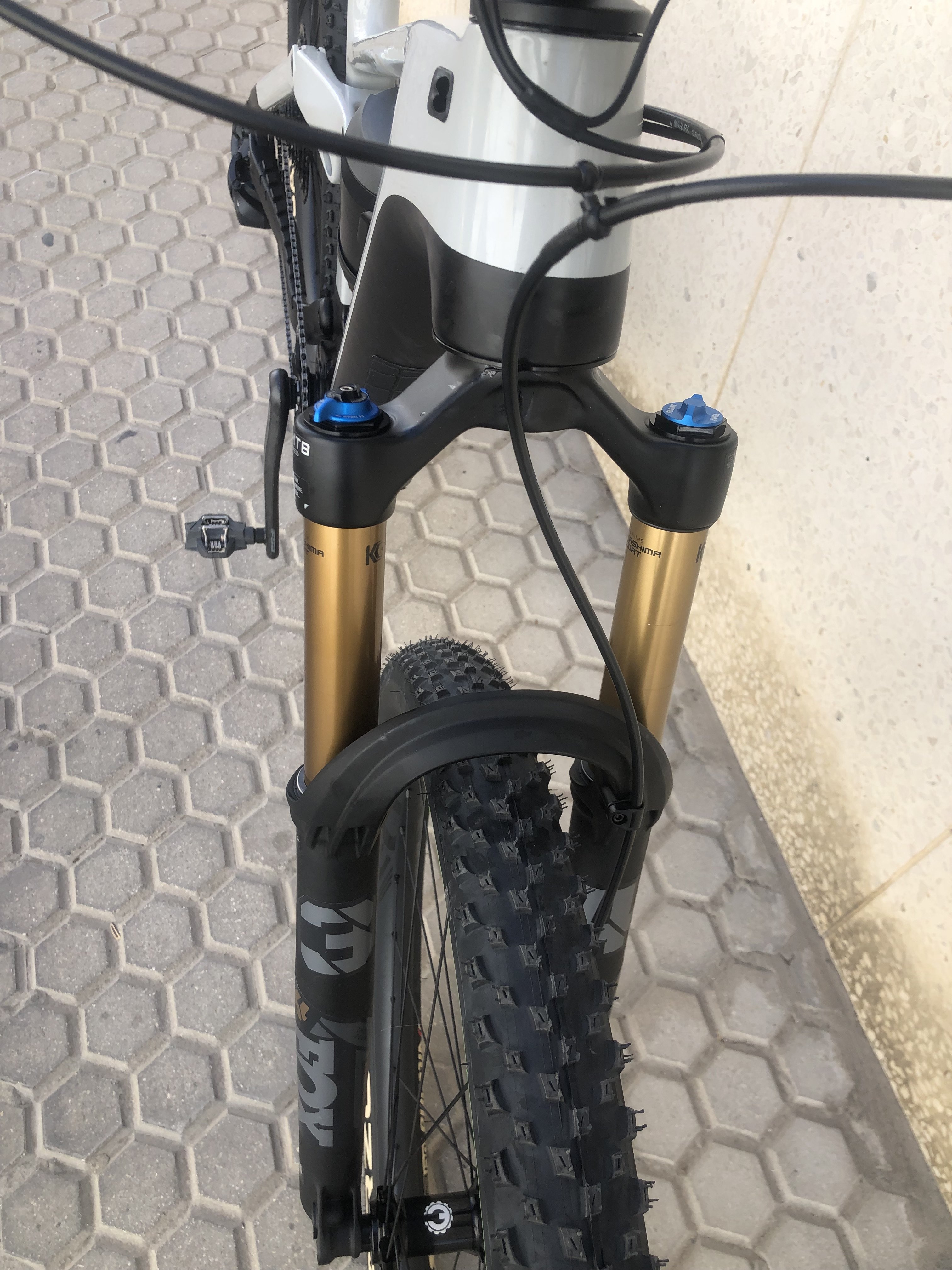

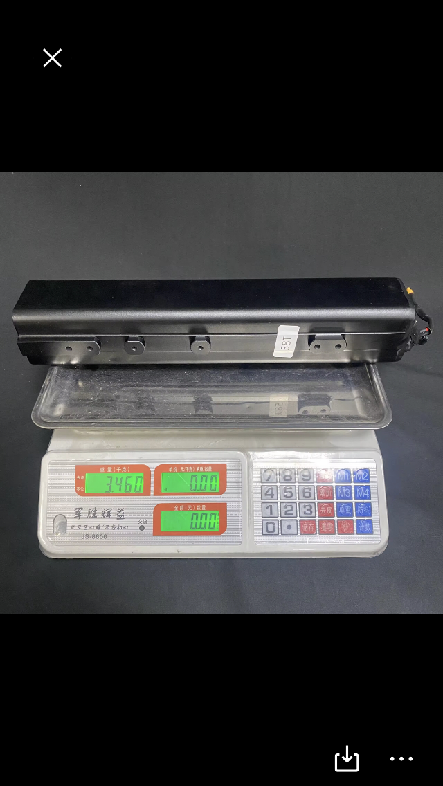

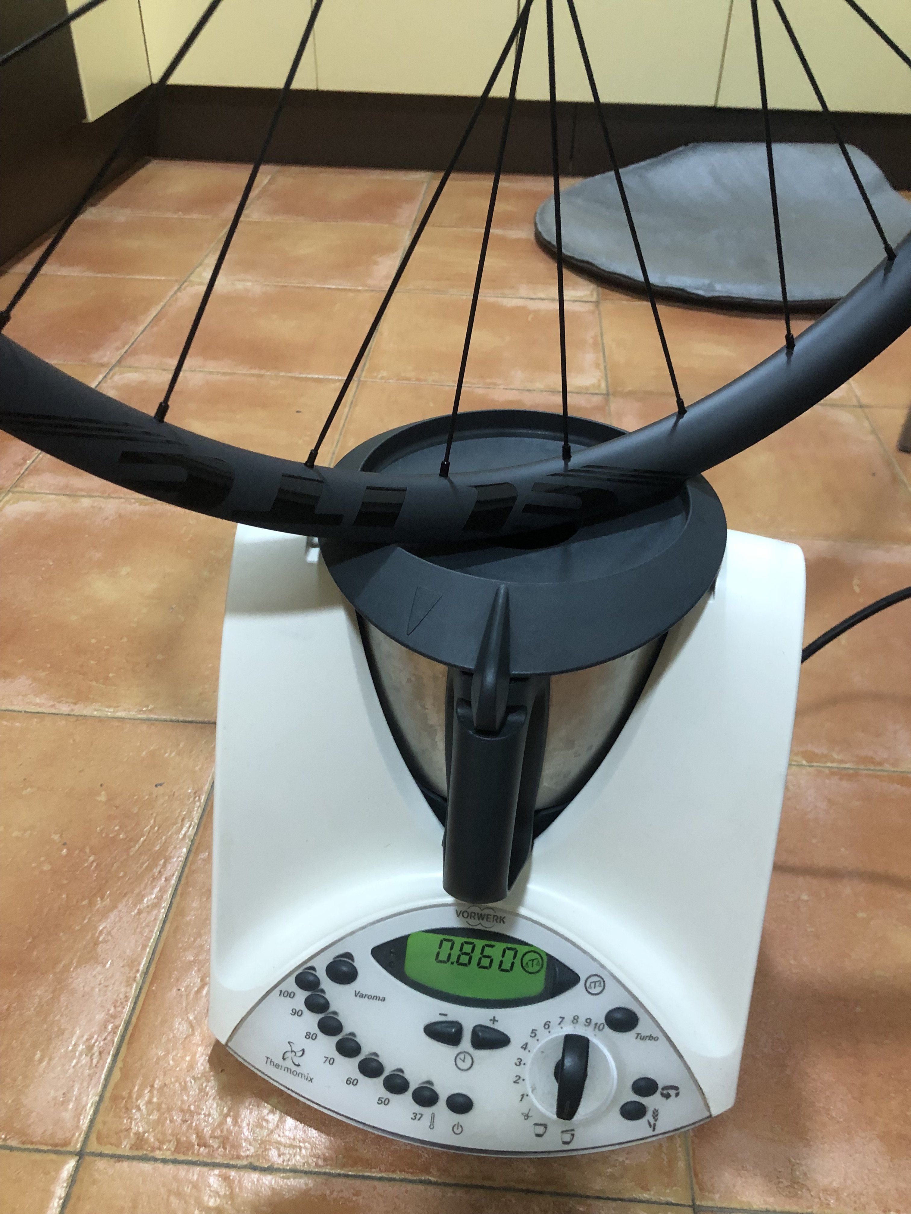

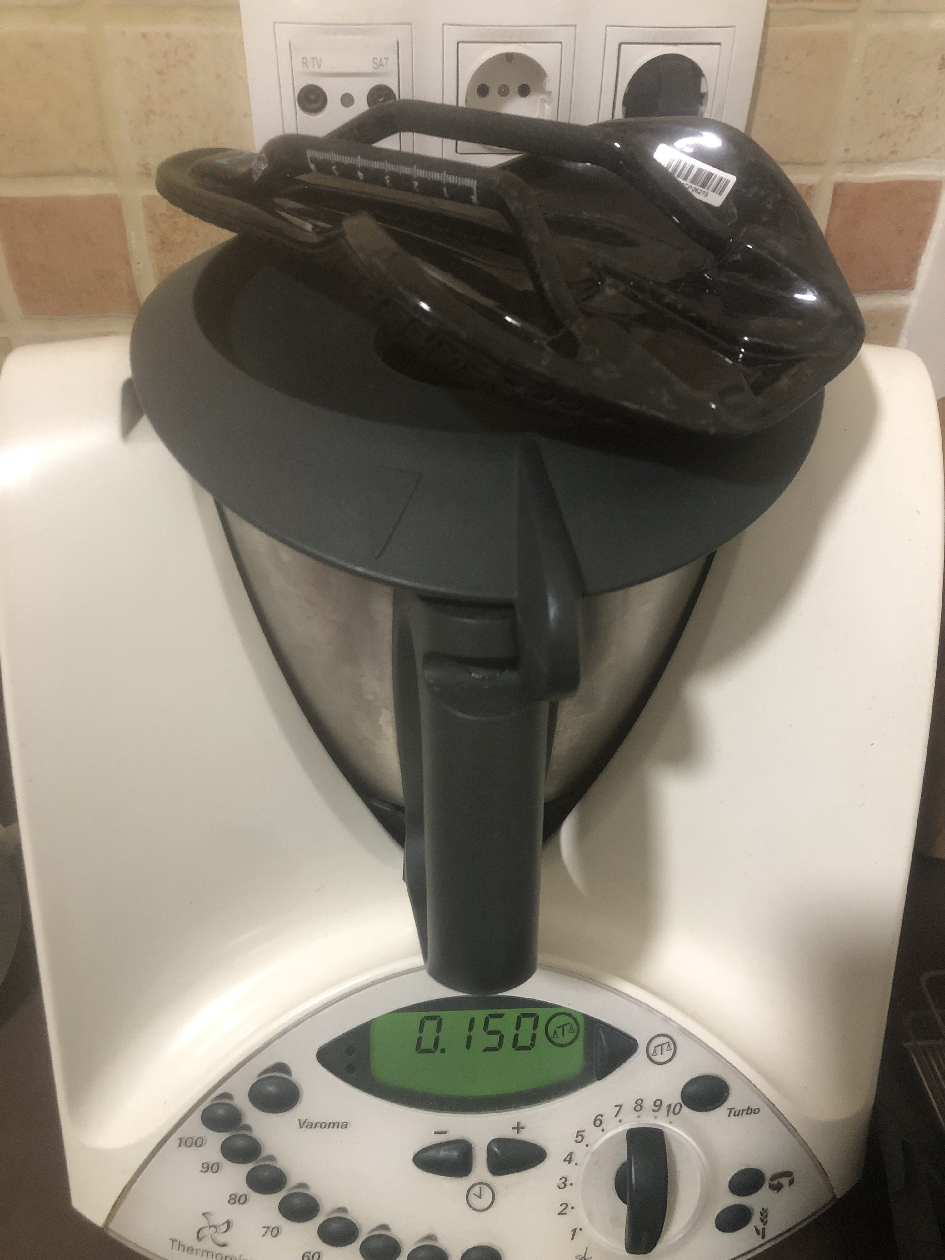

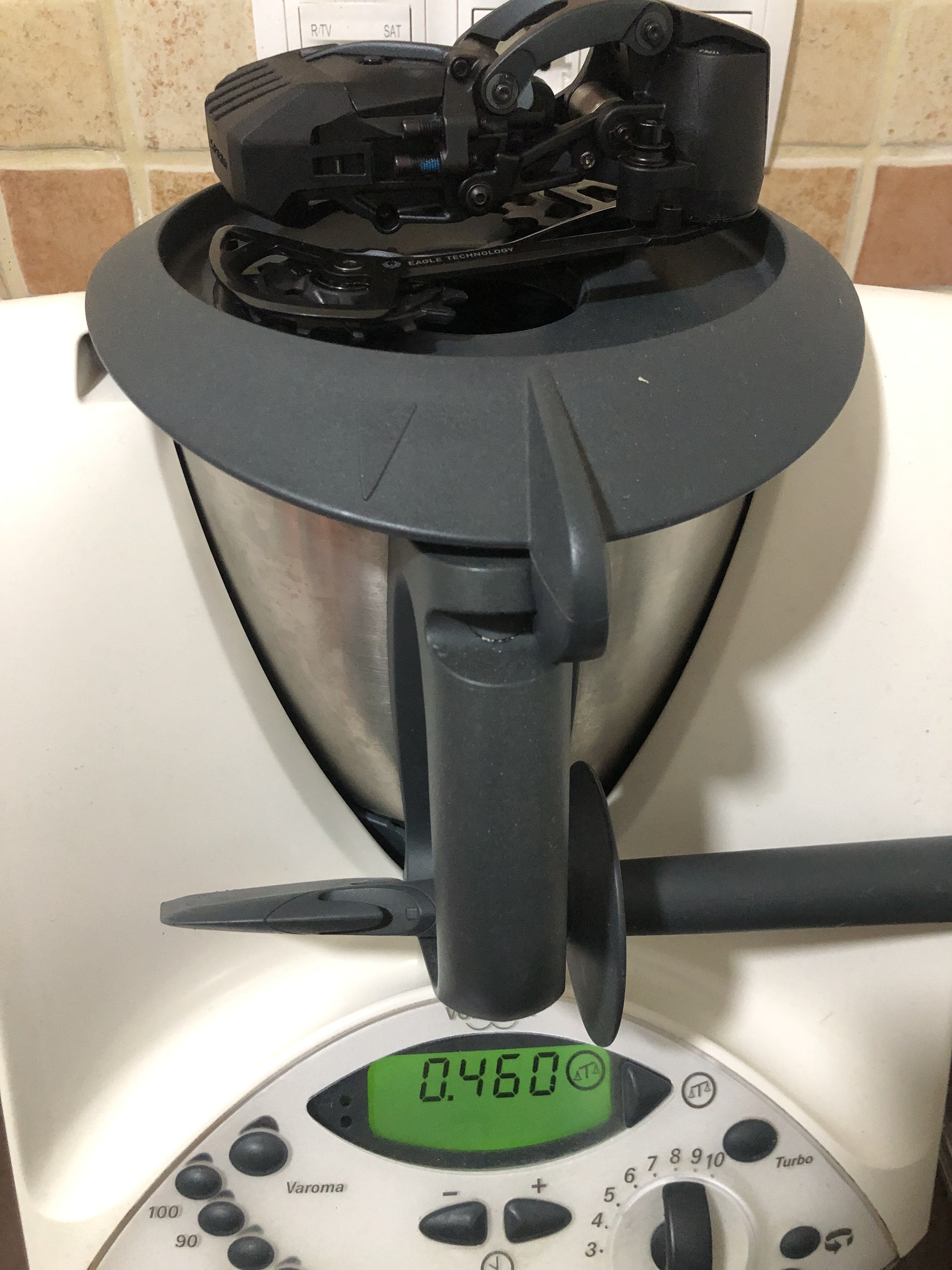

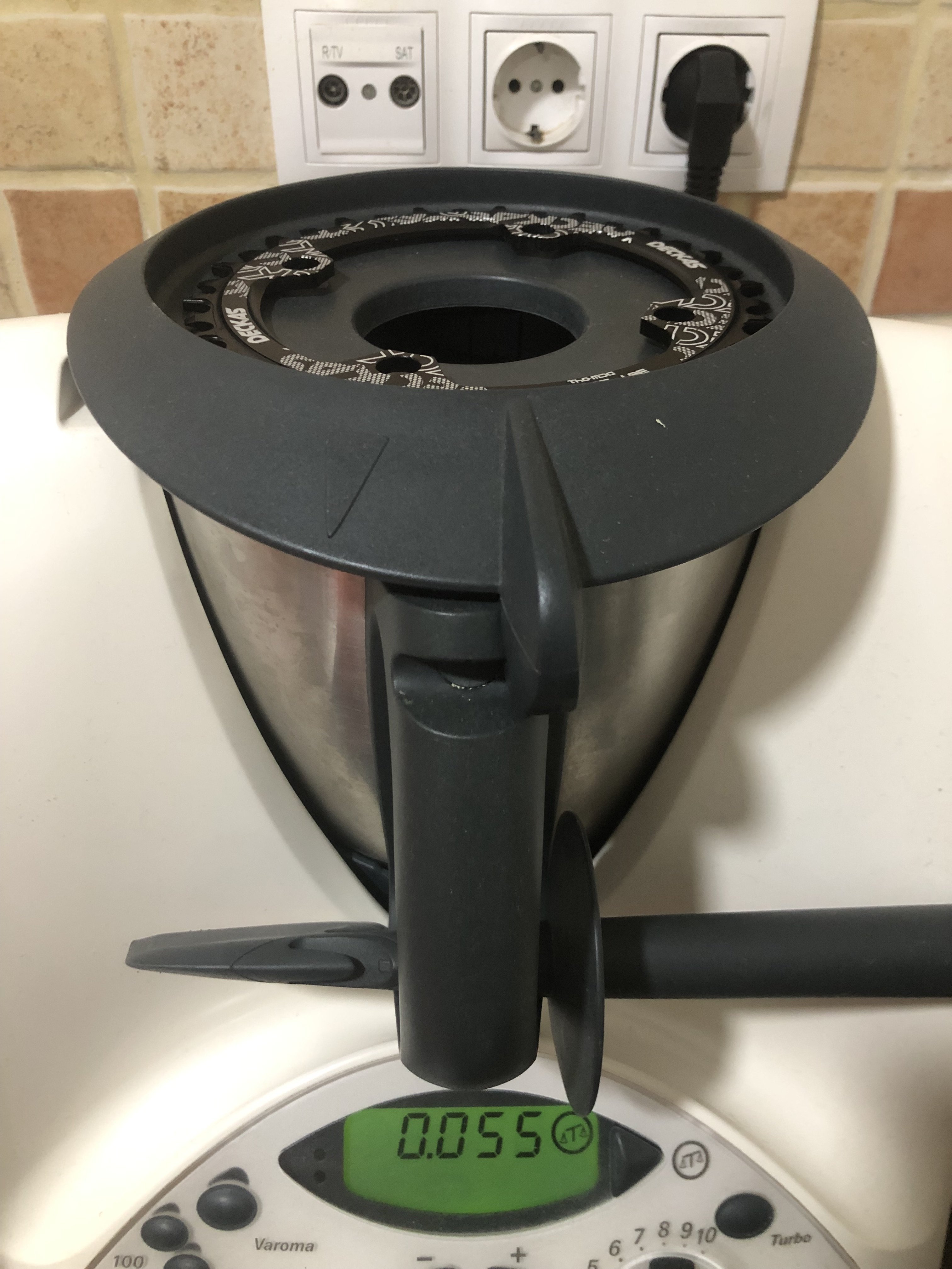

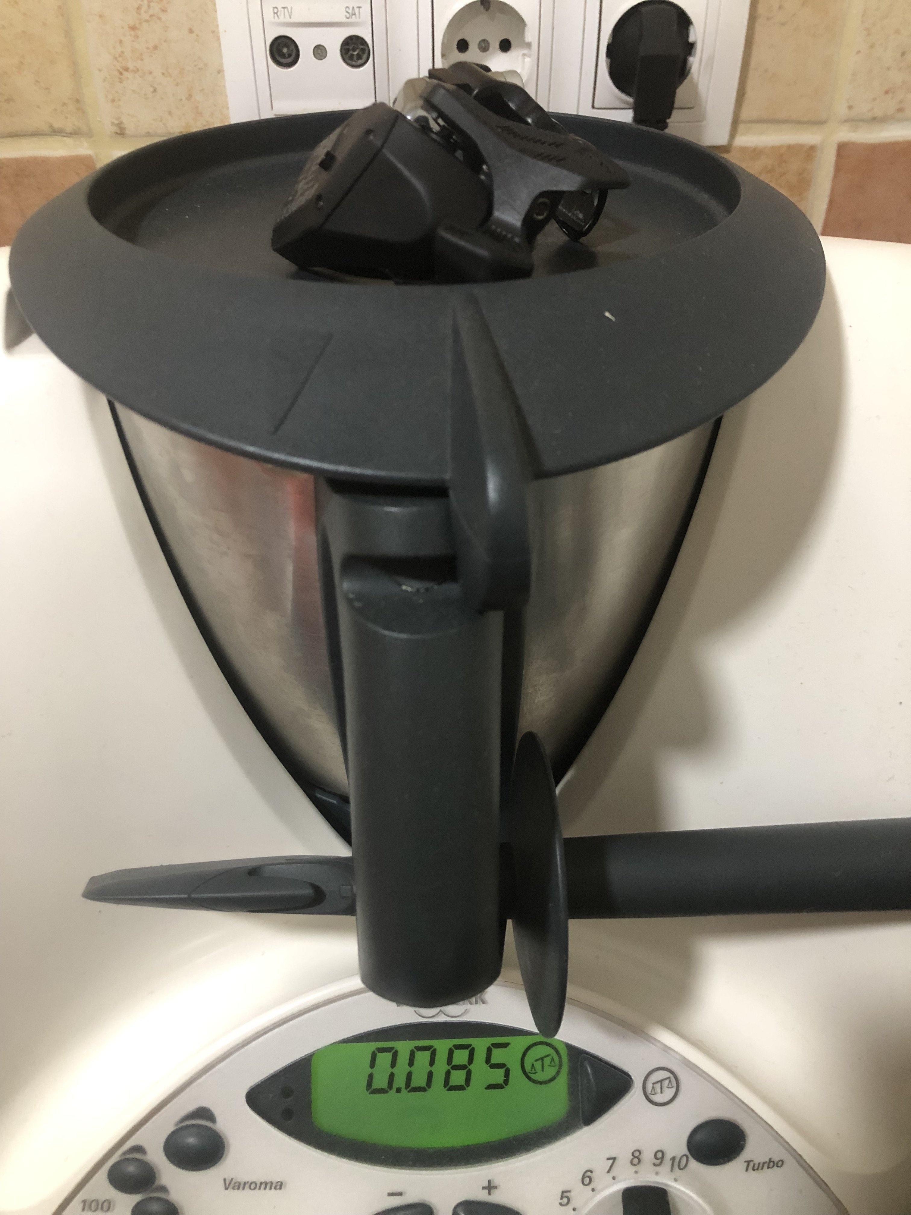

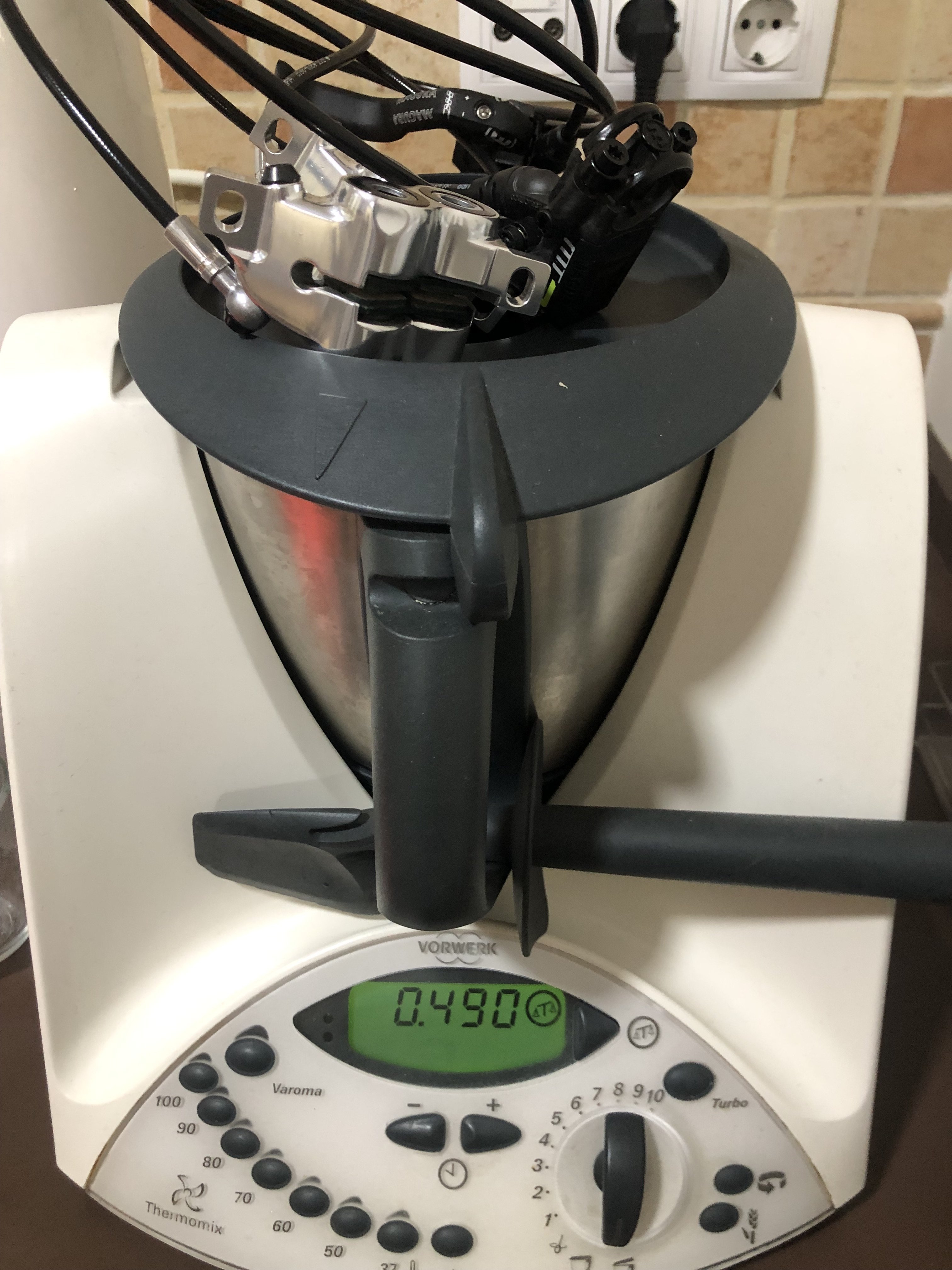

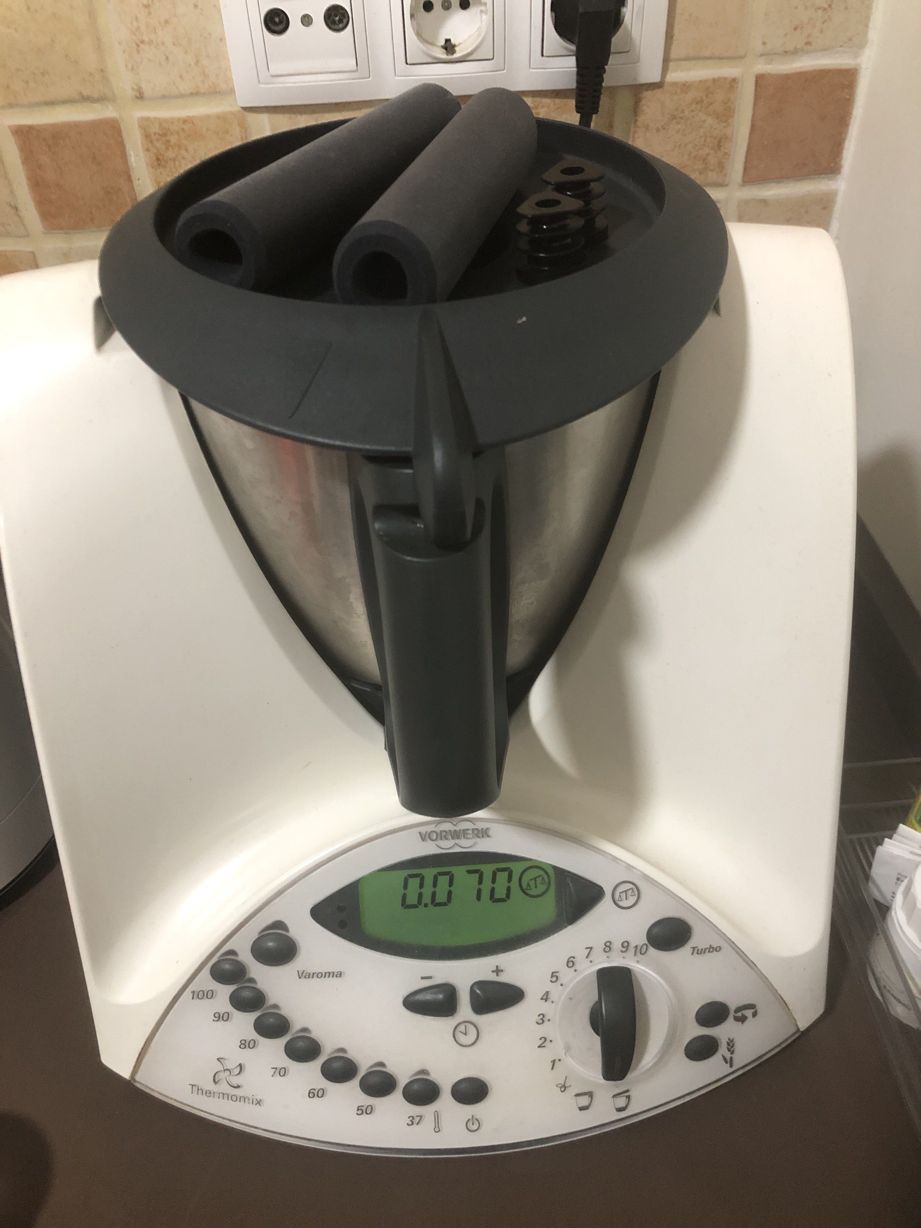

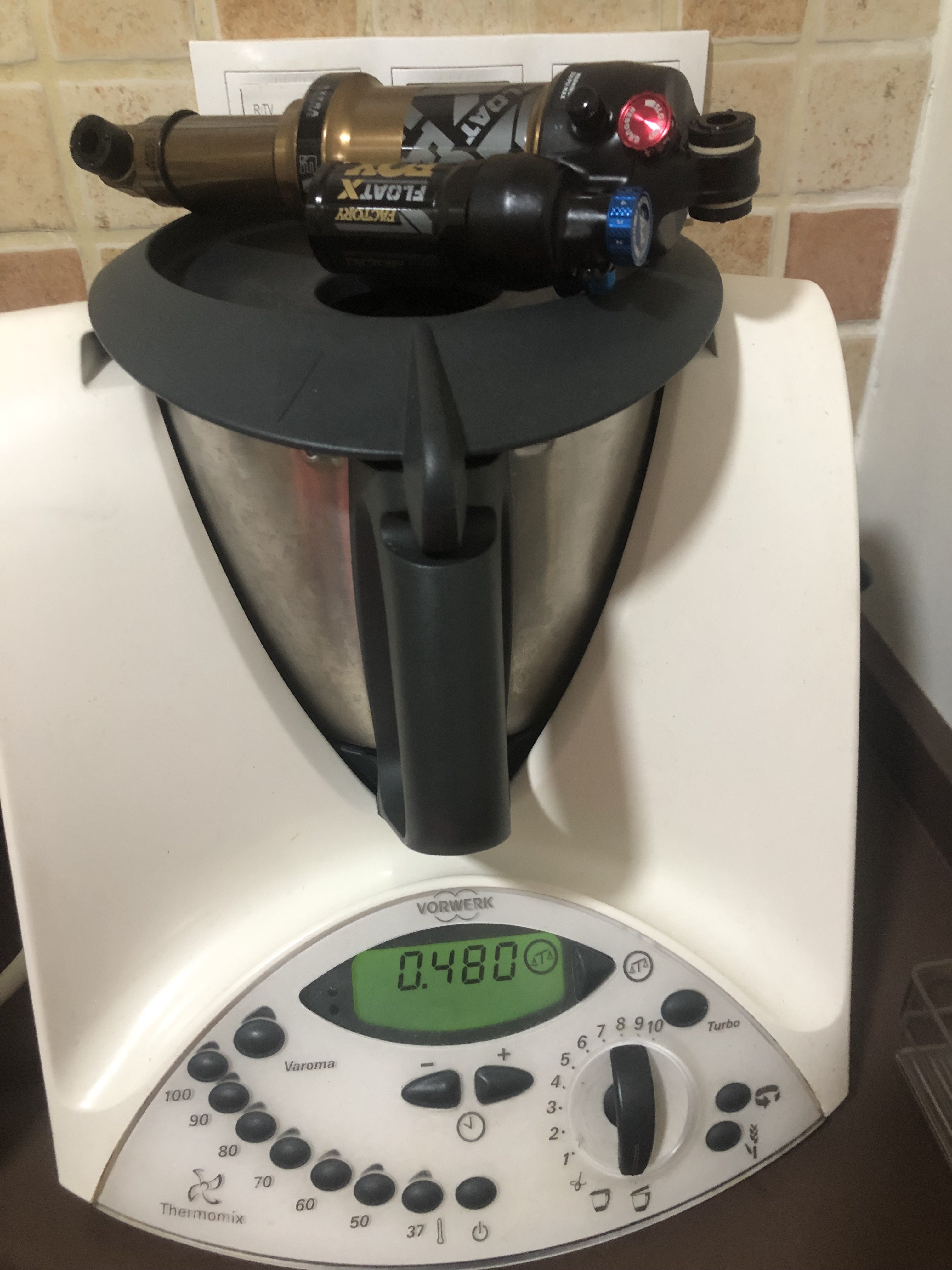

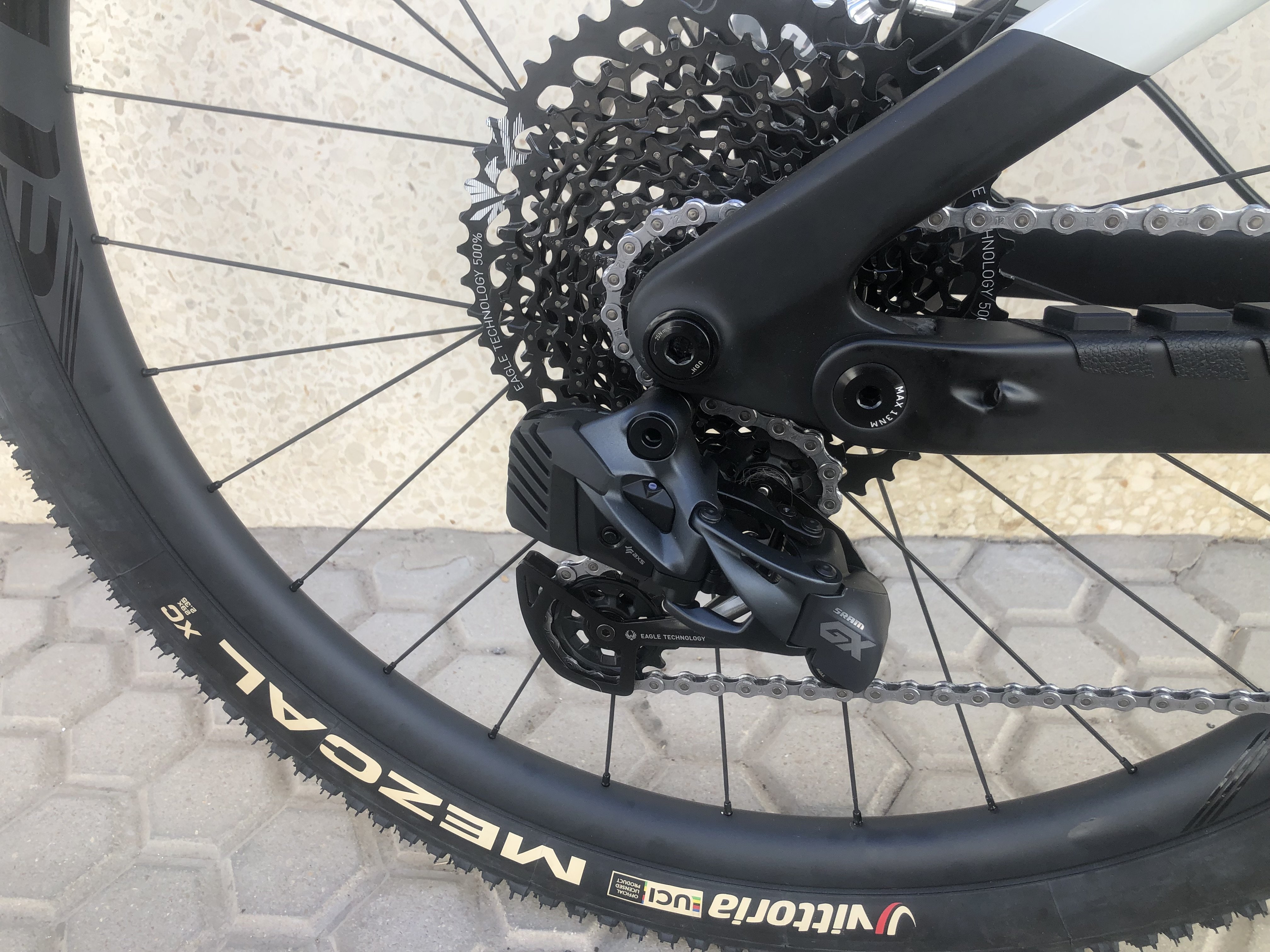

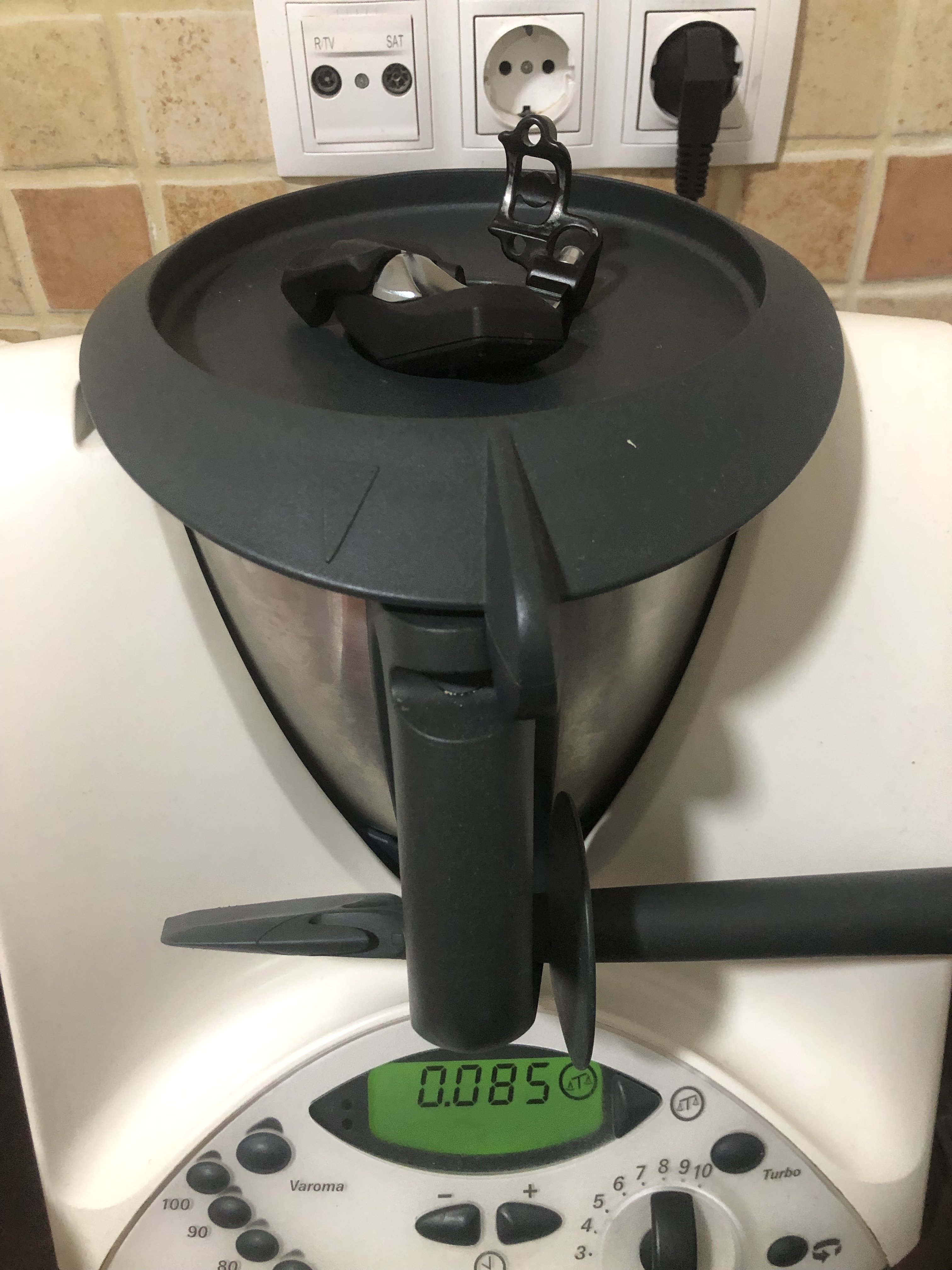

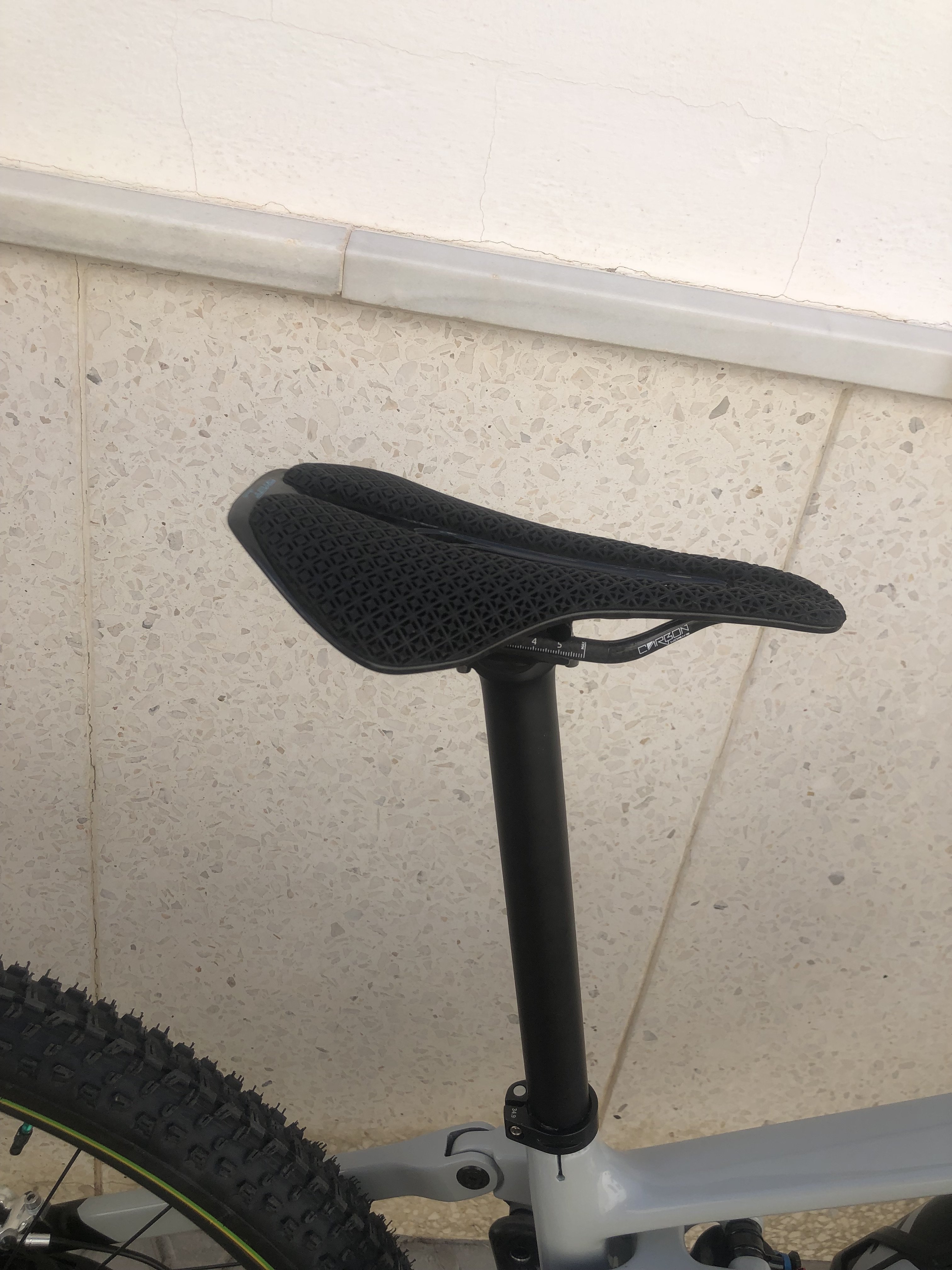

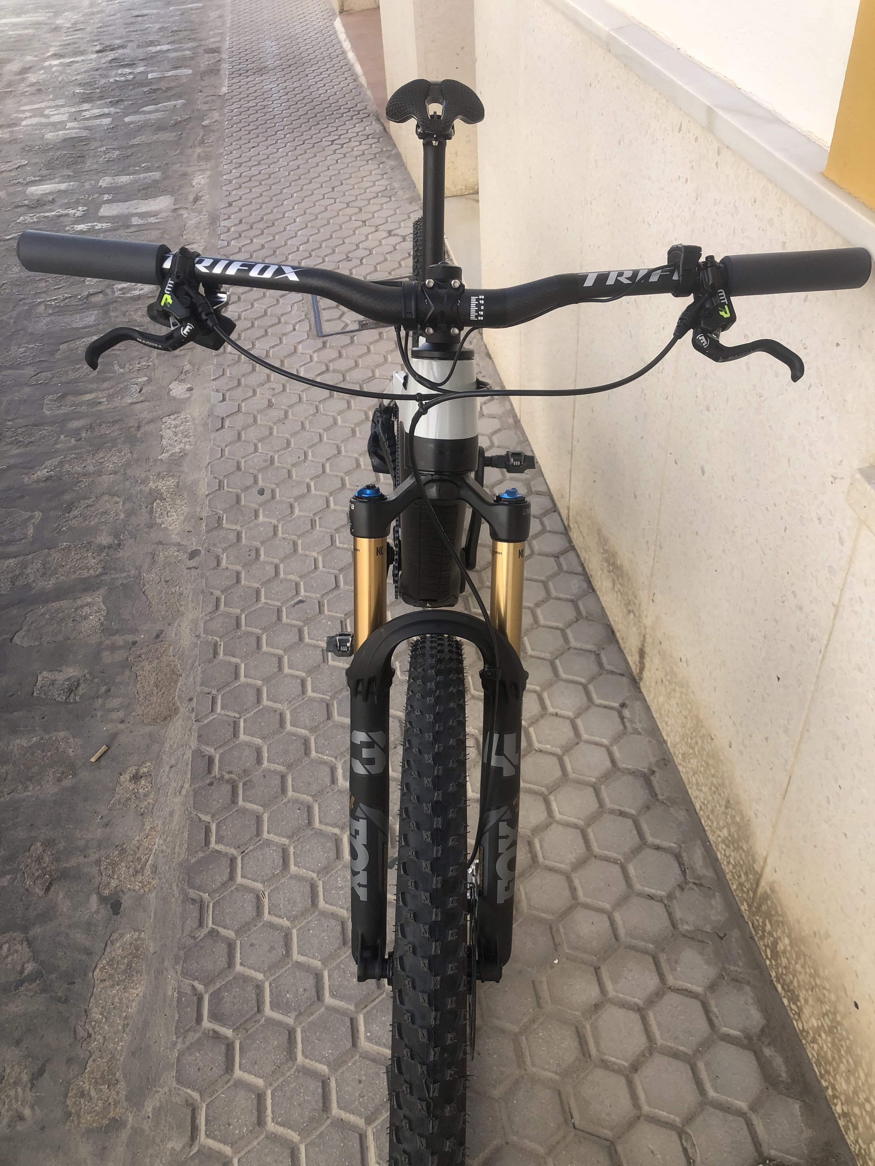

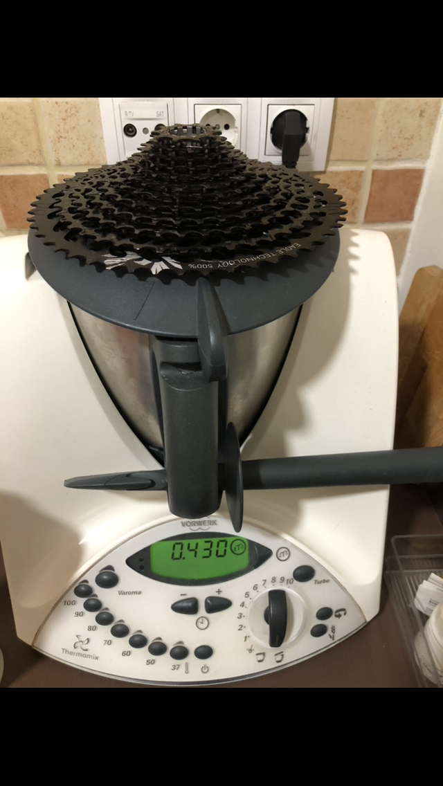

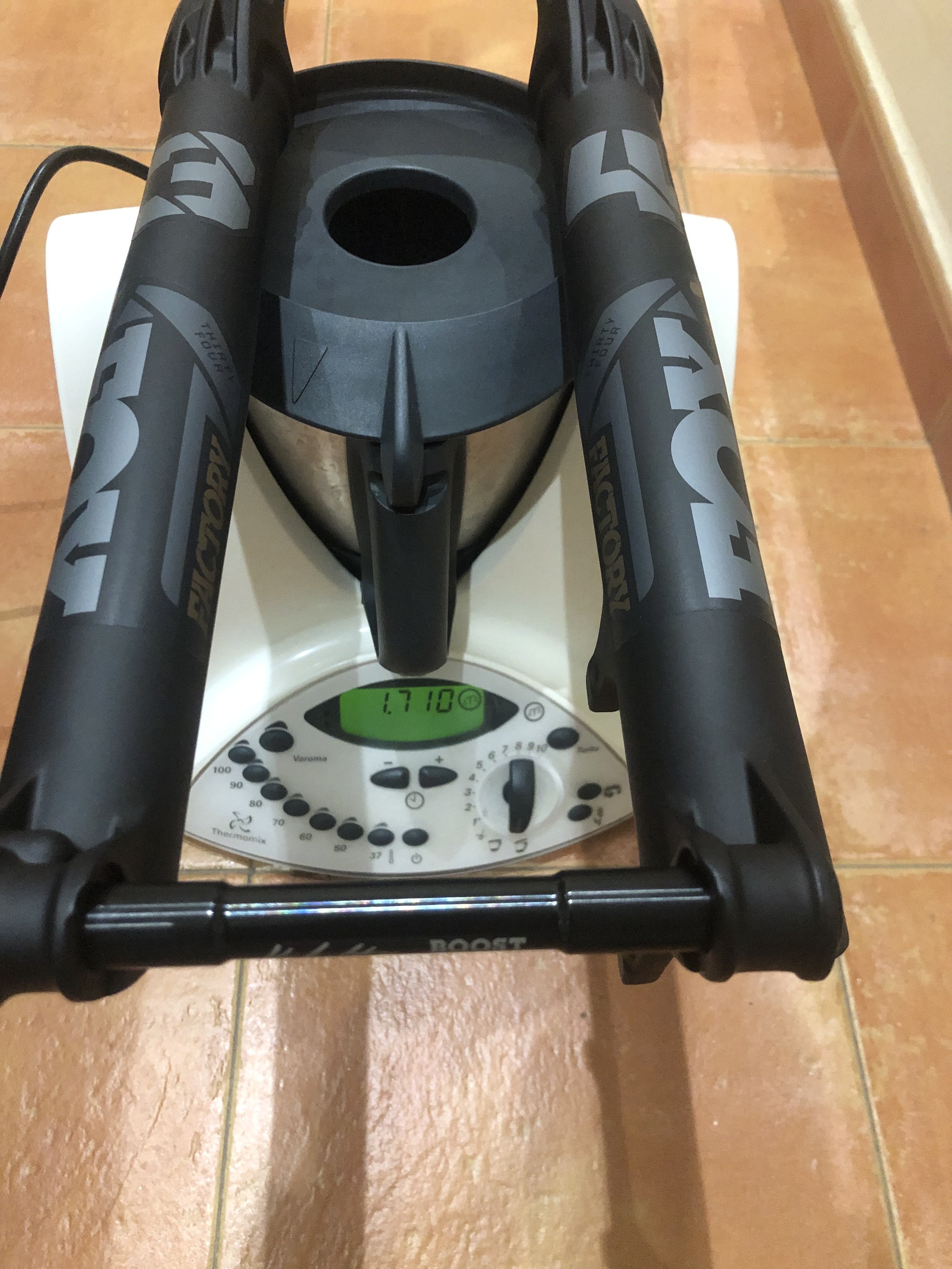

How's the assembly going? I ordered a CEF50 with an 835Wh battery and 48V. I have all the heavy-duty parts, and they're all top-of-the-range. The weight comes out to about 17 kg, size S.

You have really made an exquisite selection of very light pieces. Apart from the frame/engine set, I have so far mainly used what I have lying around in my hobby workshop and also ordered no-name parts from China when necessary. Since I've gone for the 835 Wh battery, I'm now at a little under 20 kg with my bike. However, it is important to me that I retain a bit of the enduro character. With the suspension fork, for example, it's rather difficult in my eyes to get a light and yet stable 170mm fork, at least if the fork isn't to cost as much as the whole set. As a hobbyist, I have now resorted to a Yari RC, installed a Charger shock and fitted the extension kit to 170 mm. The fork now weighs just over 2 kg (approx. 2070 gr.) and for the low financial outlay, that's great. As for the wheels, I'm still considering whether I should treat myself to carbon wheels later. However, the branded models available in Europe are too expensive for my project. I'm still looking at the Chinese mail order companies. I will probably also gradually adjust the weight or performance of the other parts (e.g. lighter cranks, drive sprockets, tires etc.).

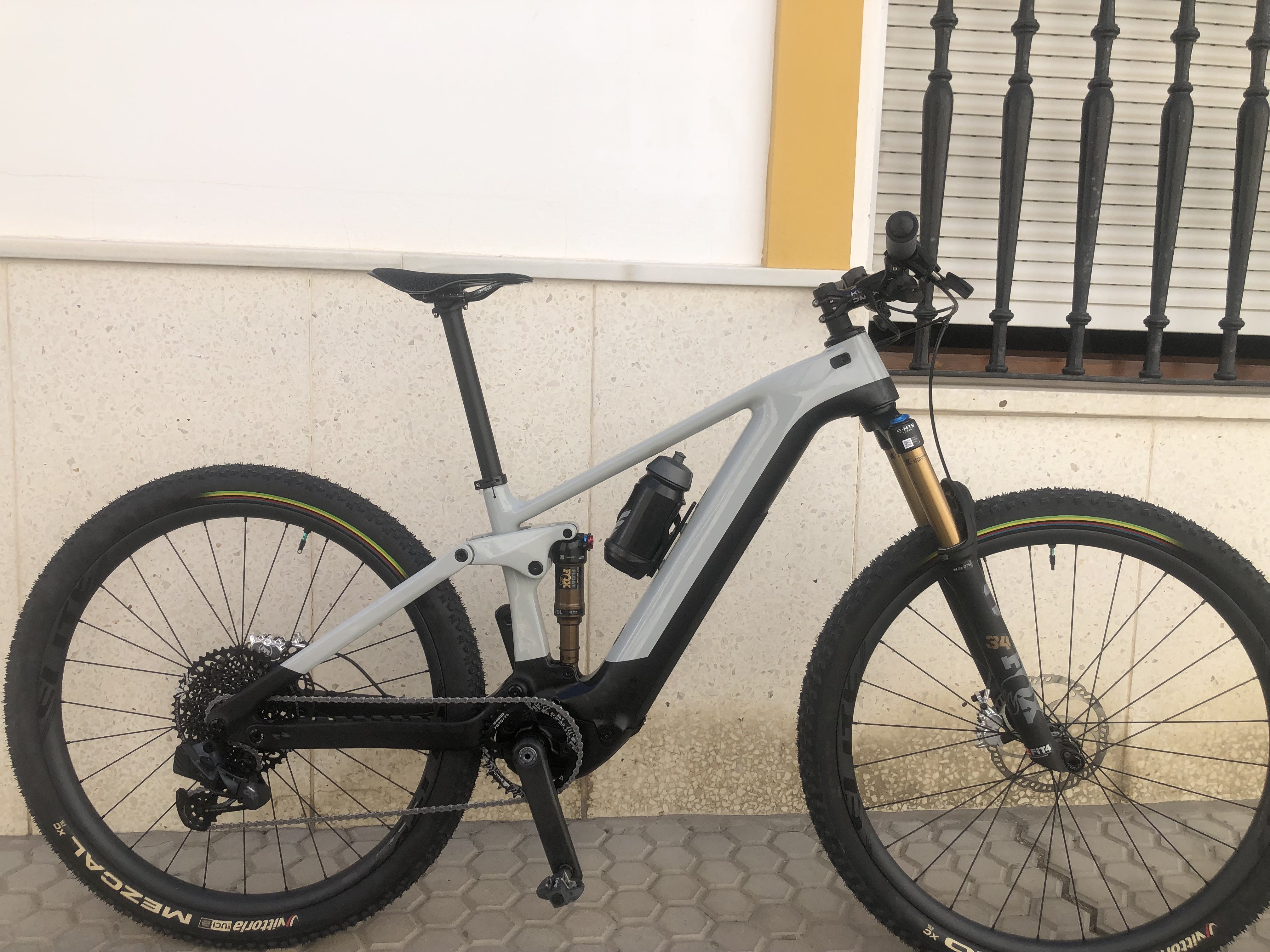

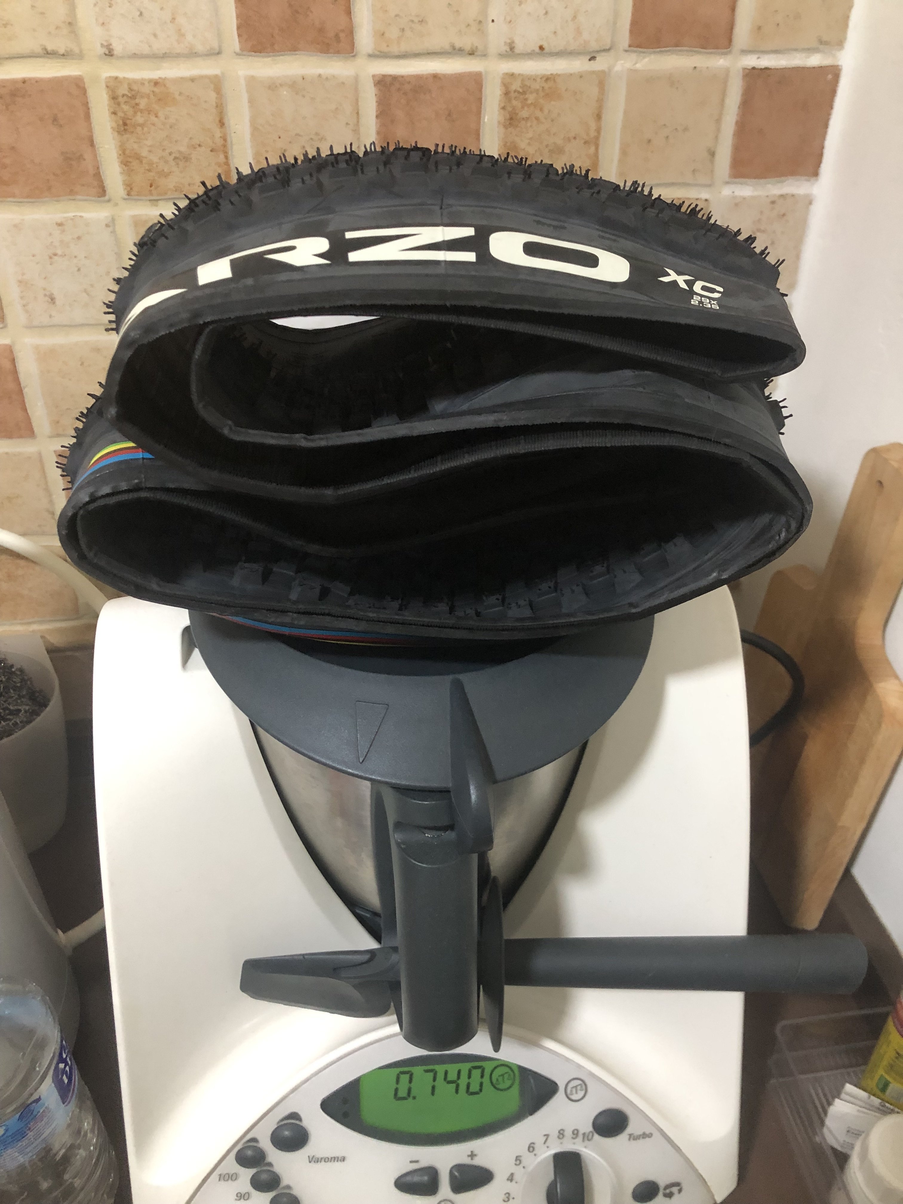

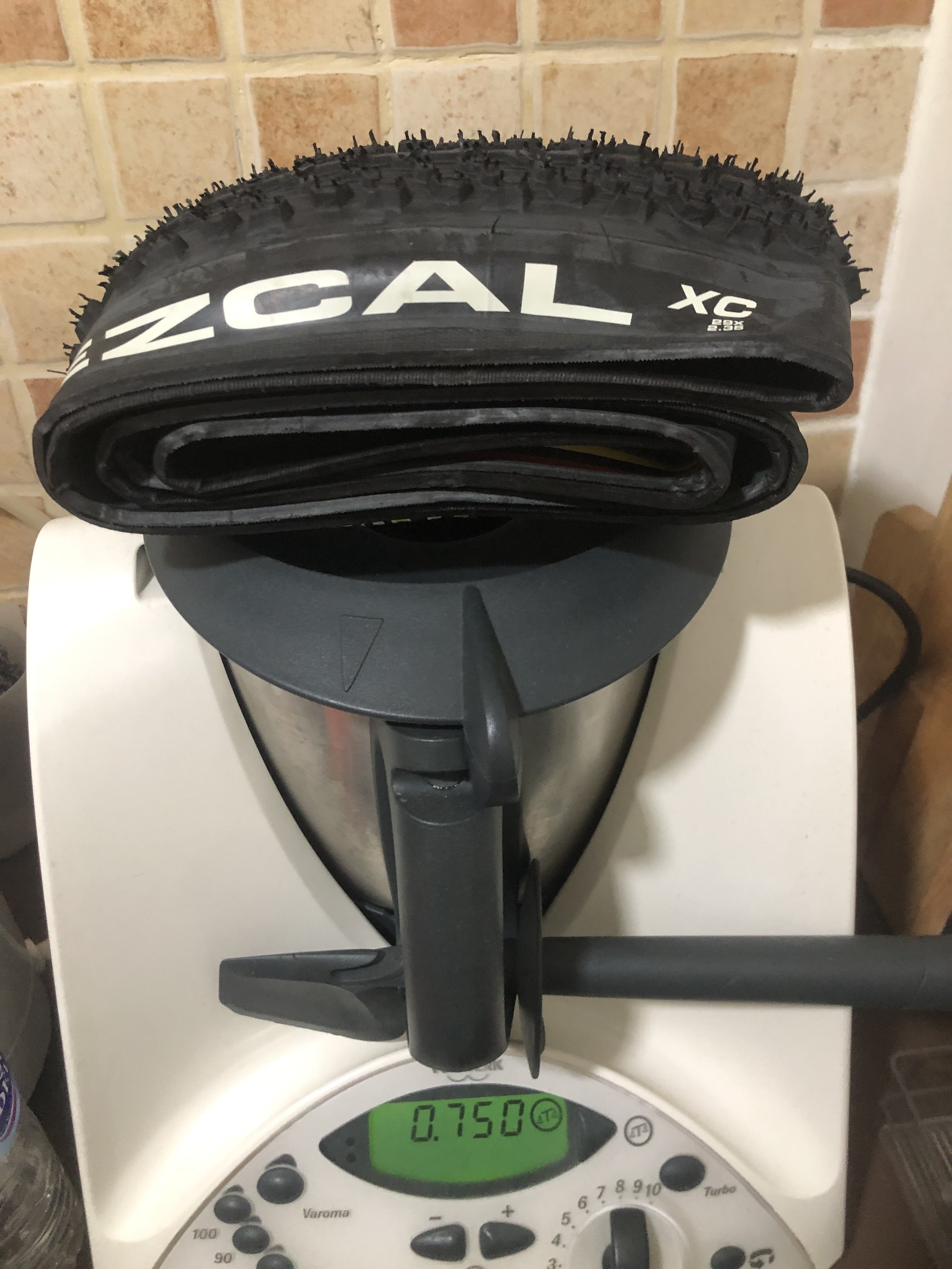

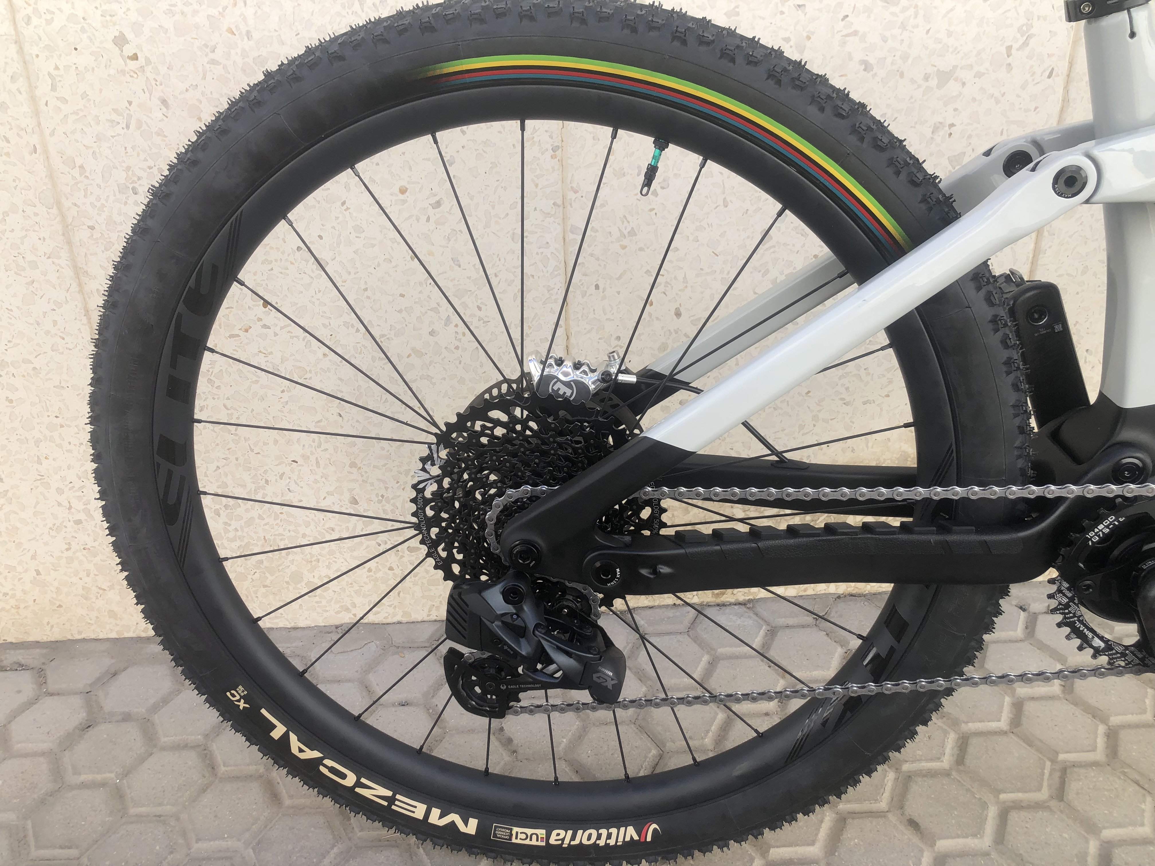

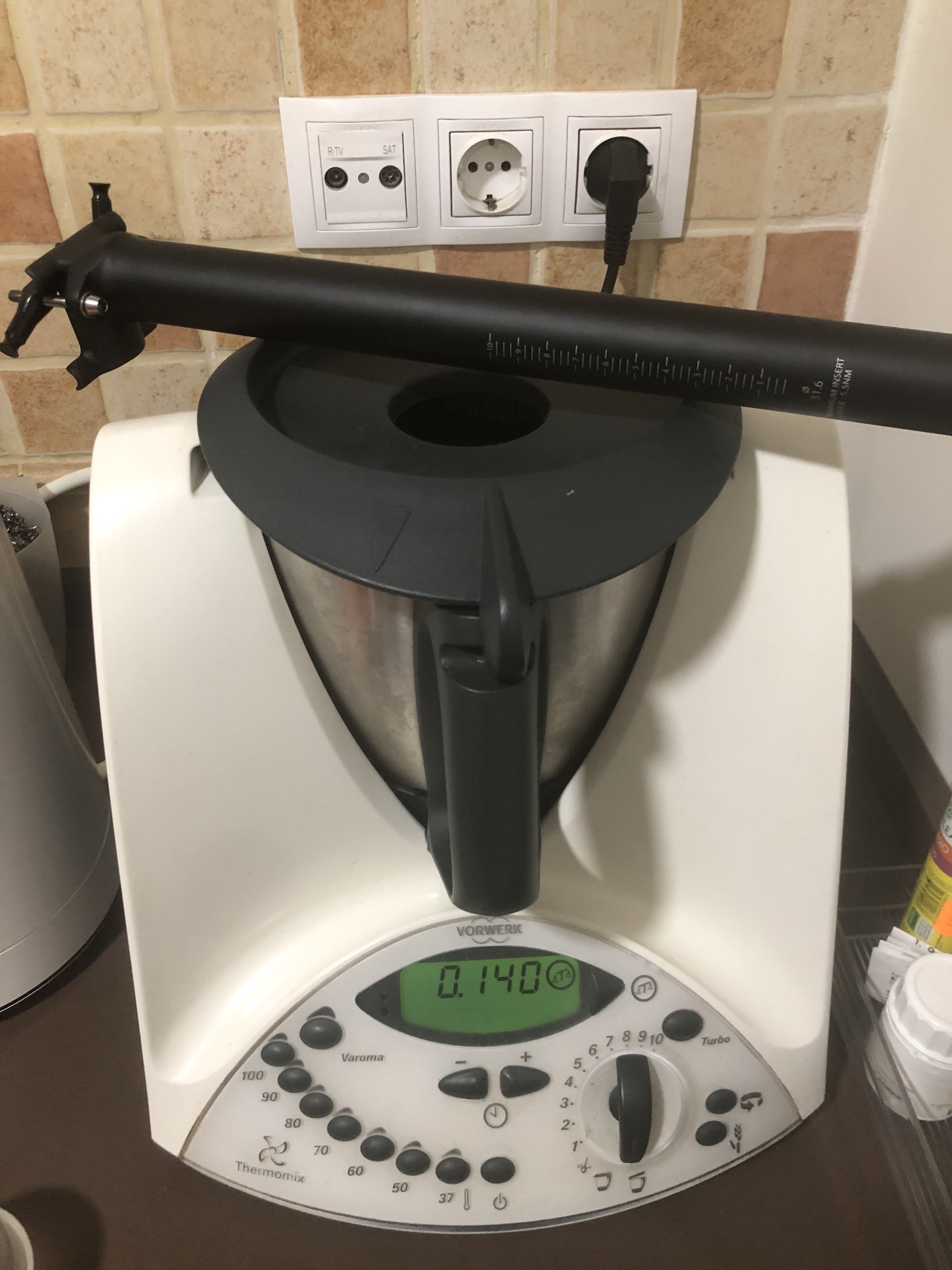

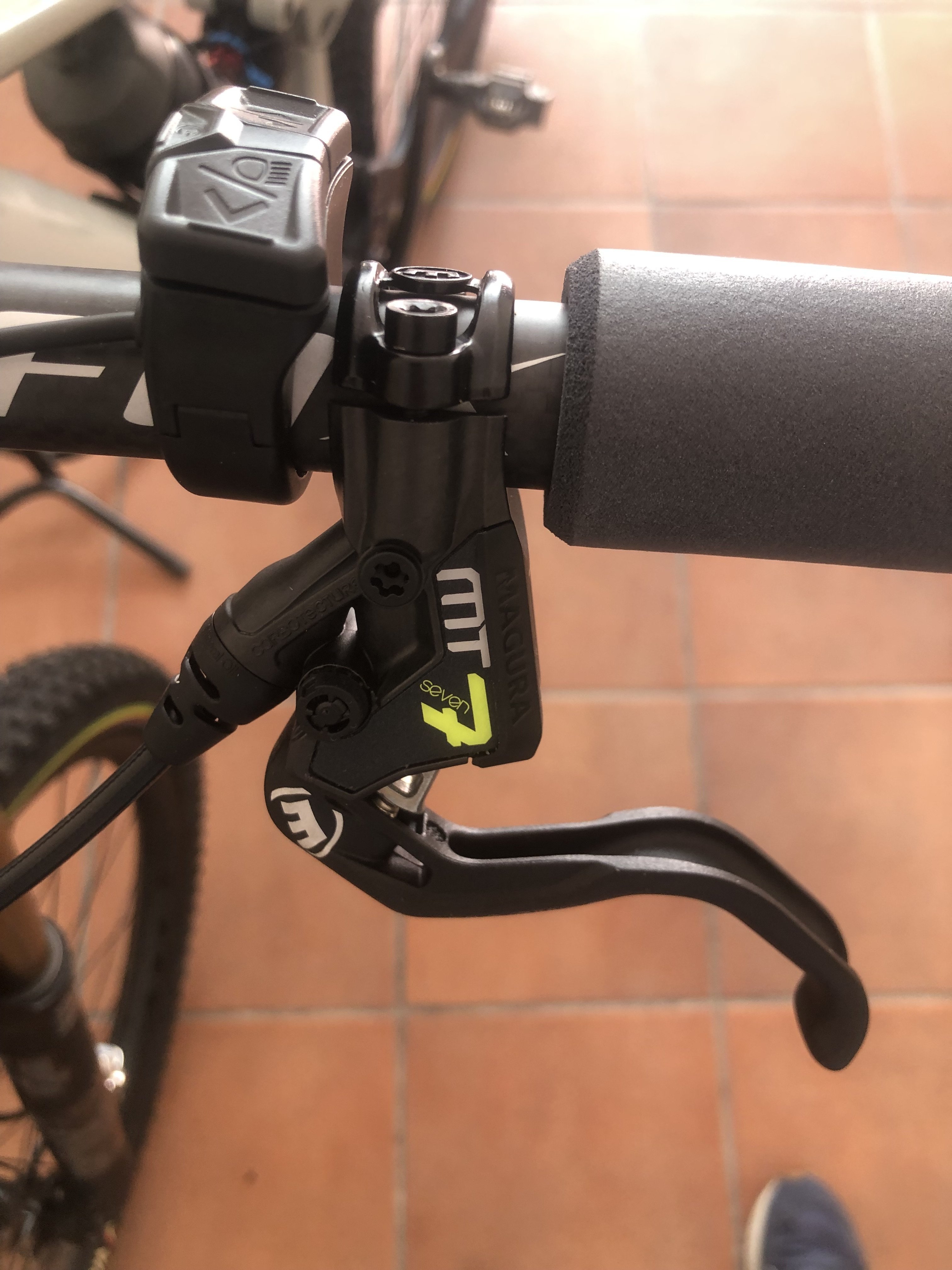

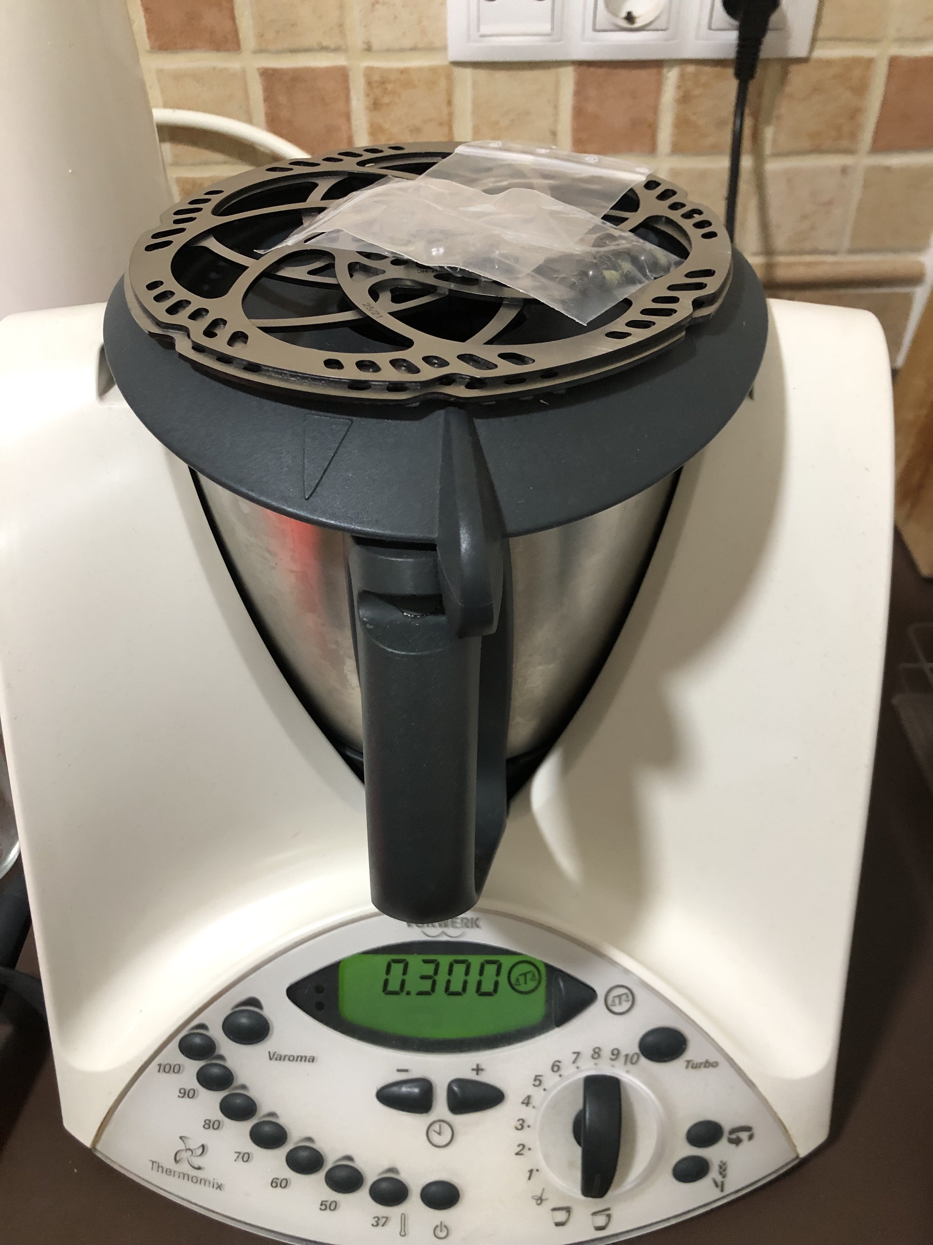

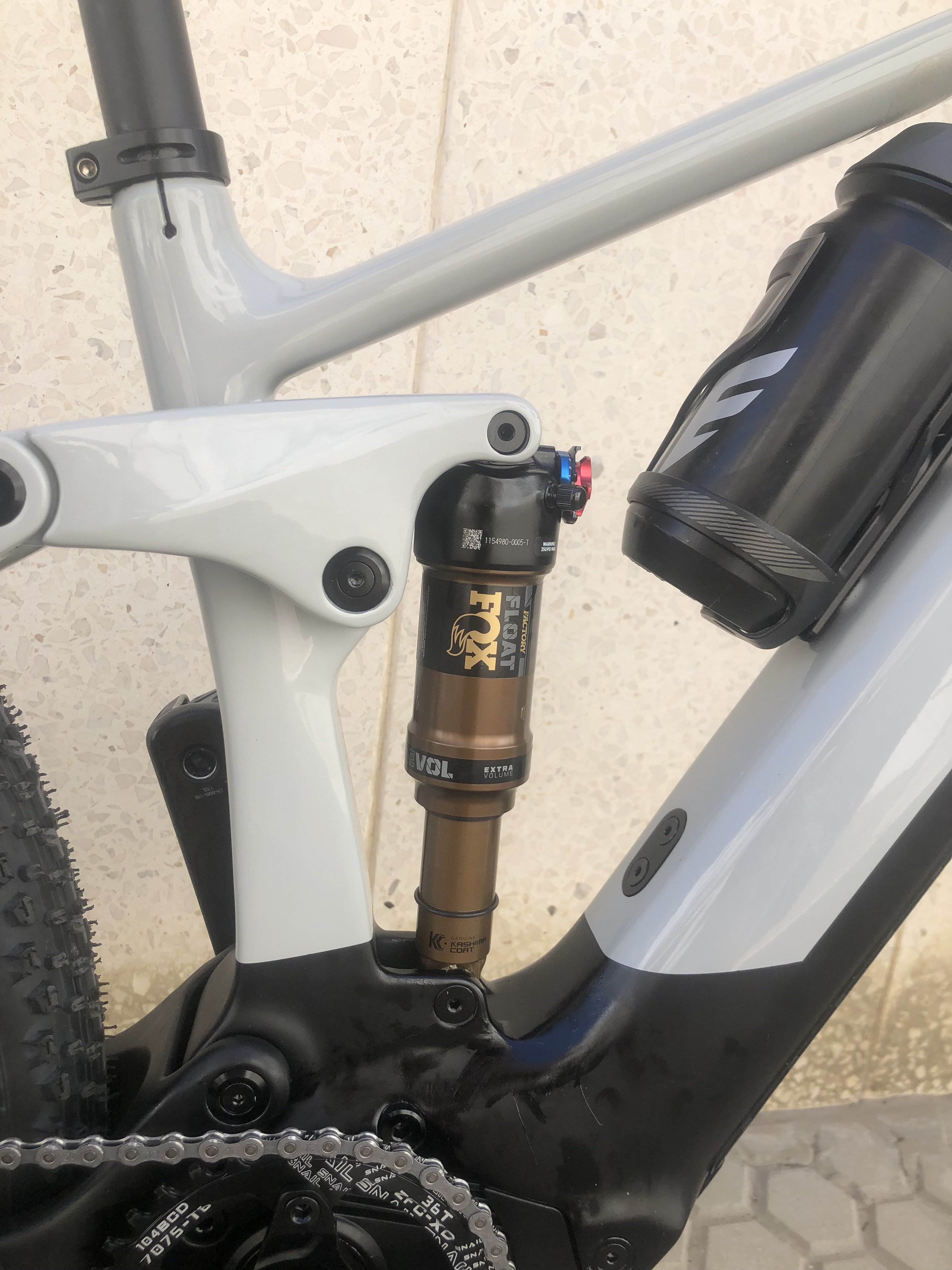

CEF 50
18 kilograms with pedals, boat rack, and water bottle
835Wh
Range test: 160 kilometers, 1200+
