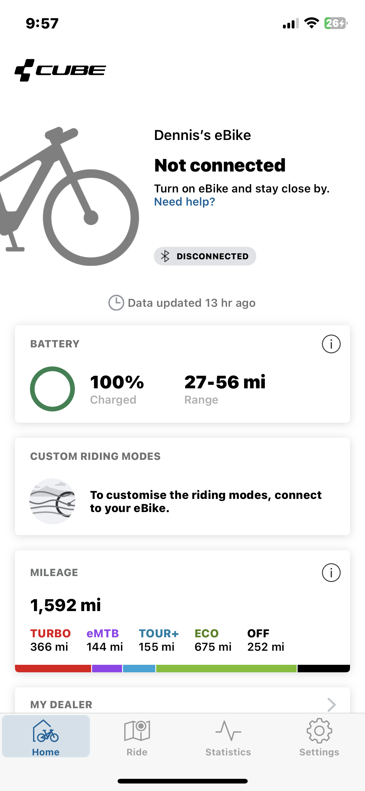

Here's my usage so far.
Tour on road, emtb for most stuff, turbo for climbs I cannot do with my weak legs and spirit.
I wonder if it's worth modification within the flow app of eco to make me wanna use it more but to be honest I'm well happy with emtb mode.

Hi mate, can see your stats on the image are in miles , how do I change mine from km to miles, ? I can’t figure it out ? My kiox 300 say miles, but flow app say KM ? Please help cheers
you have to change your settings on your phone. Its not in the app rather the actual phone settings the location i believe or region it is change to english UK
I not sure about iphone but it works on my samsung I can change to km or miles doing this.
