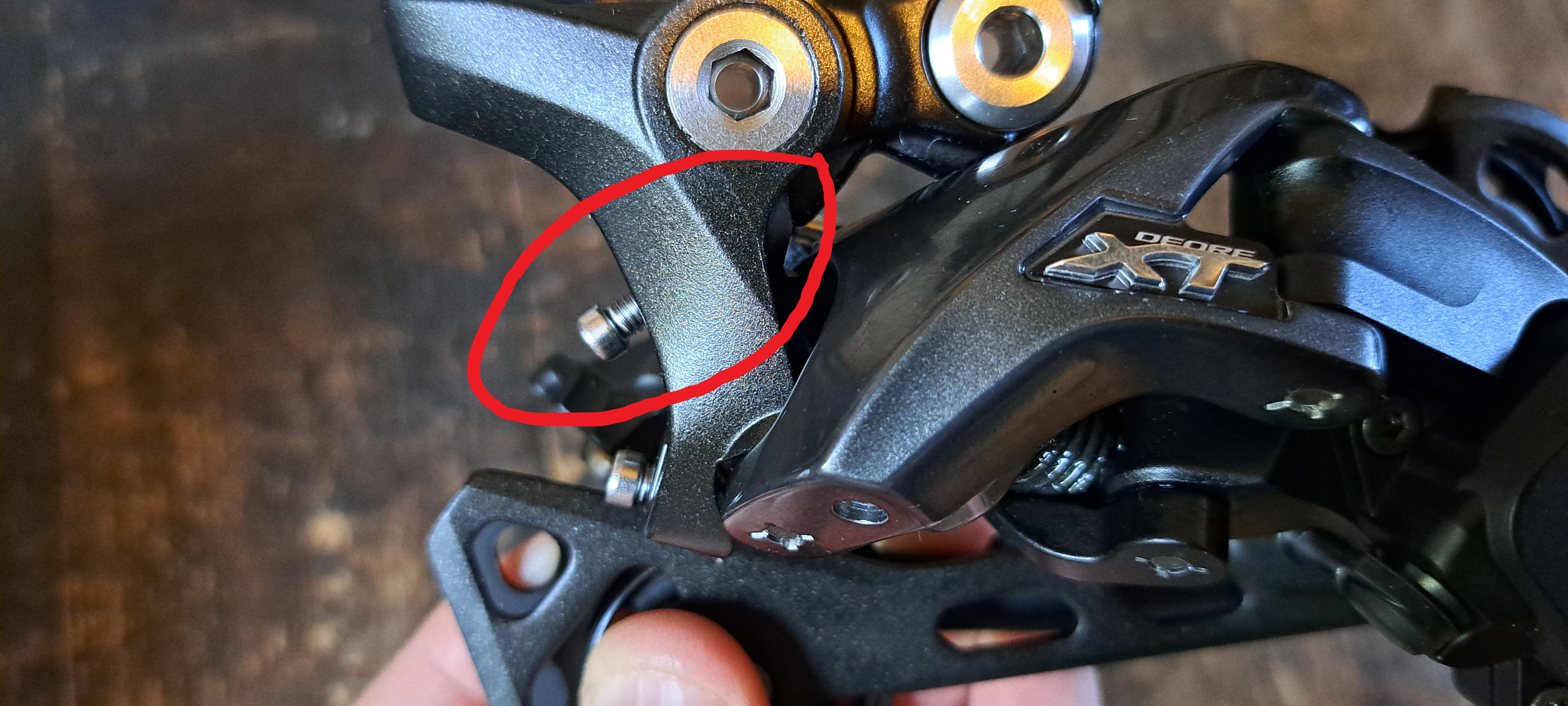

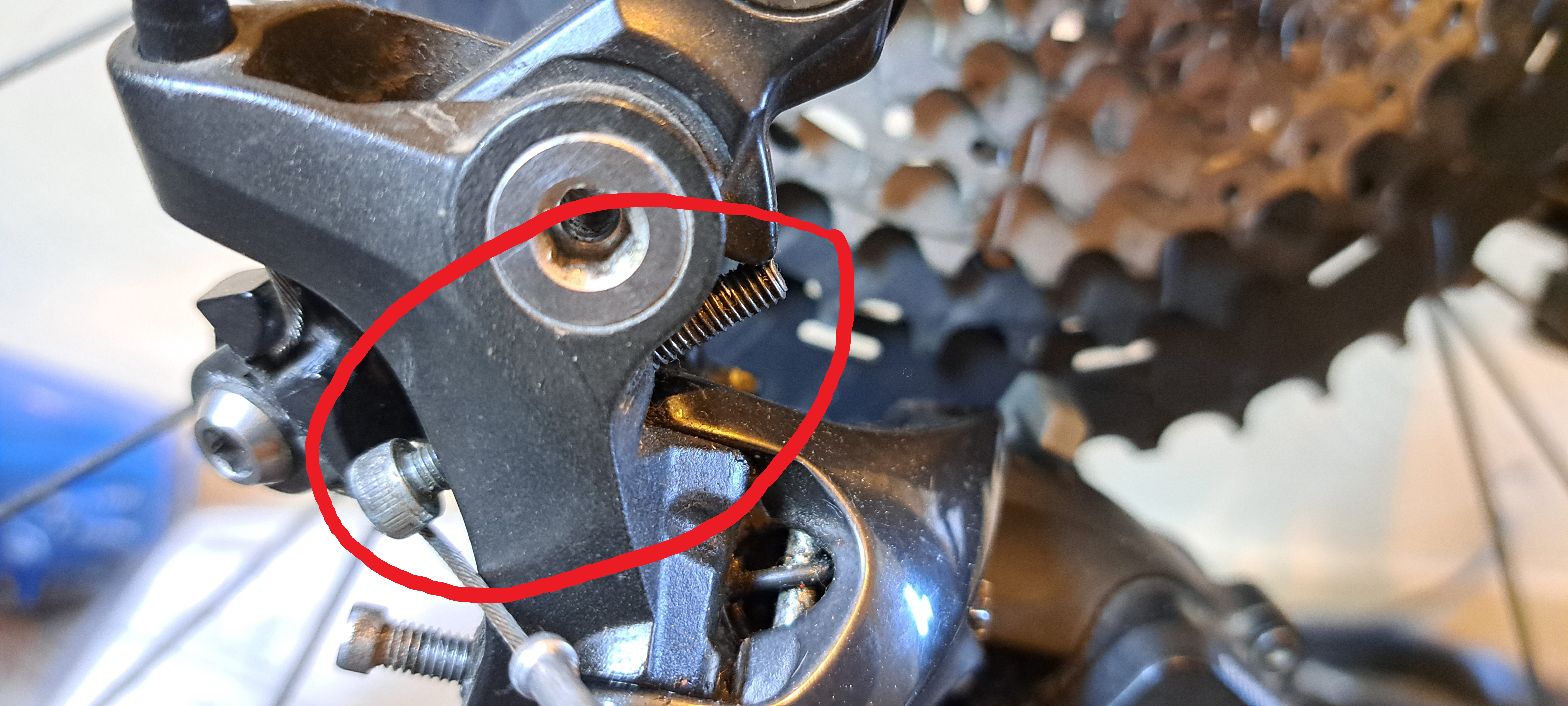

Ended up ordering a new derailleur same model just in case the lbs asks to replace it and when comparing the new one against the one on my bike now it's been modified. derail.jpg
Large bolt on the one installed on my bike by lbs
Have you ever come across that before. Why would they do that ?
